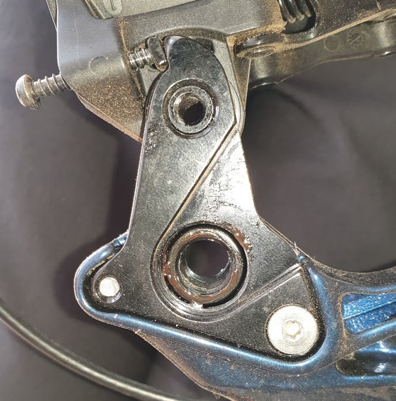

I was looking for a spare derailleur hanger and checked mine, it doesn't look like the SRAM universal hanger. What is it? Looks little bit like Lapierre Pro Race but Stilus one is flat at the bottom. BTW, B screw limit was not set correctly on mine, I had to adjust to get rid of the chain noise at lower gears.

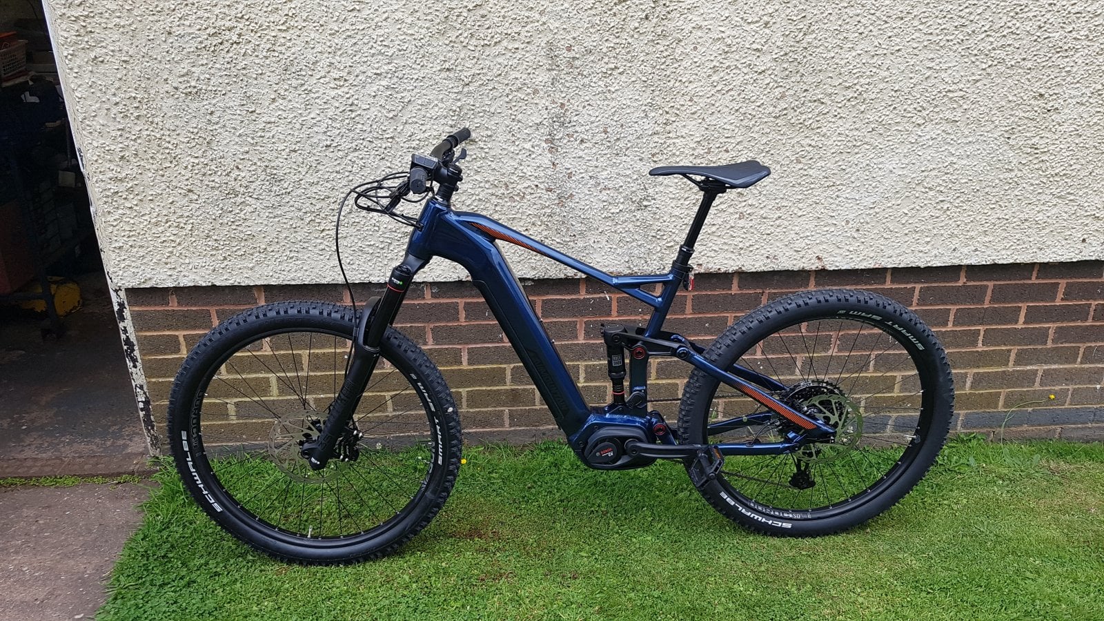

Well it arrived on friday evening :)
spent a little bit of time yesterday fettling.
brakes exercised,bled and calipers centered they are bang on now :)
gear change tweaked and all good now
quick 5 mile bimble and it is a hoot :)
dmr v8's ordered
suspension pump ordered
tubeless valves and fluid ordered
booked in for first week of august for firmware update (first available slot) at local bosch agent currently on du 1.0.2.0
just need to sort mudguards,saddle and grips next.
then build a trailside toolkit and a way to carry it.
Thanks for all the help and info so far i am sure there will be lots more questions to come.
fat and nearly 50 so got a steep curve ahead of me to get the best out of it :)

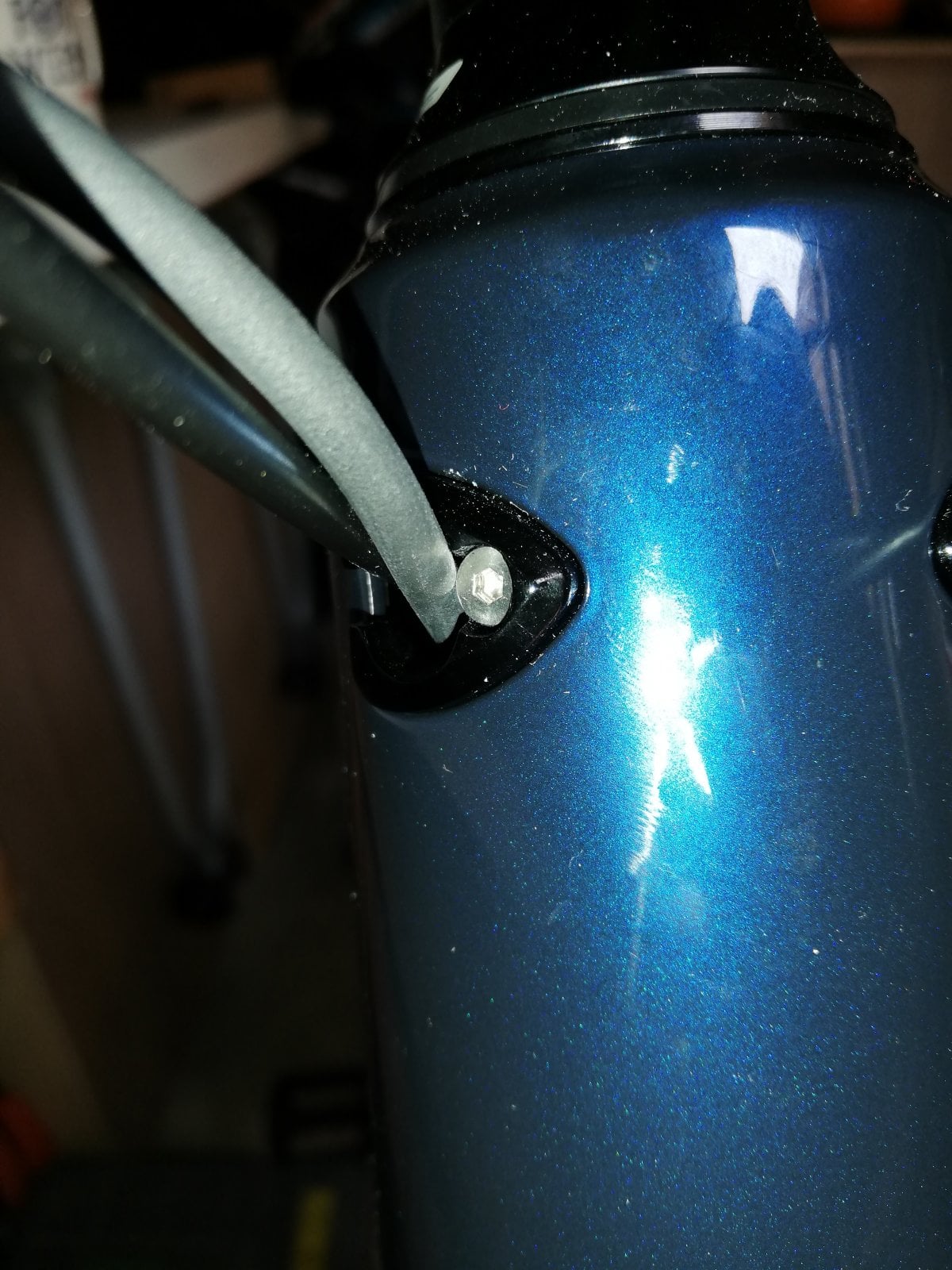

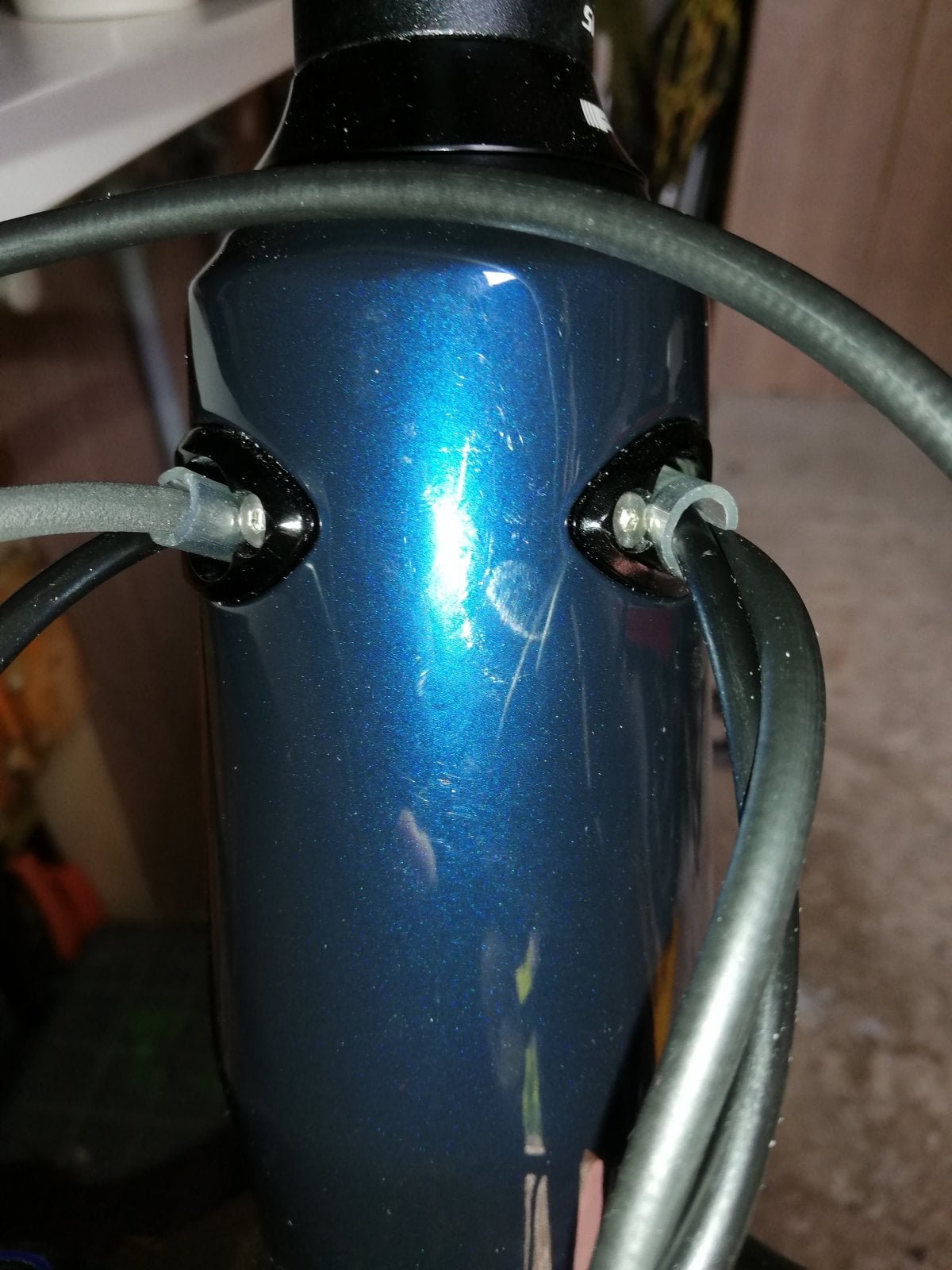

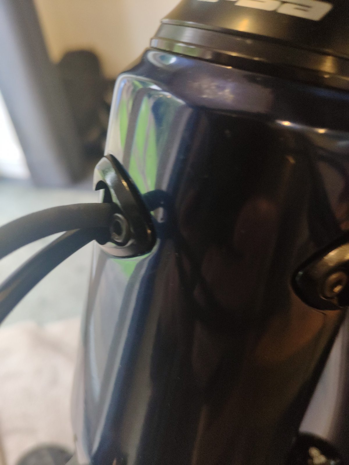

OK, been going over bike even more and have spotted a possible future pain. Not serious but have put a fix together to prevent. It concerns the entry points of the cables as the go into the headstock. There are plastic protectors screwed into the frame, trouble is, the cables rub against the screw edge.

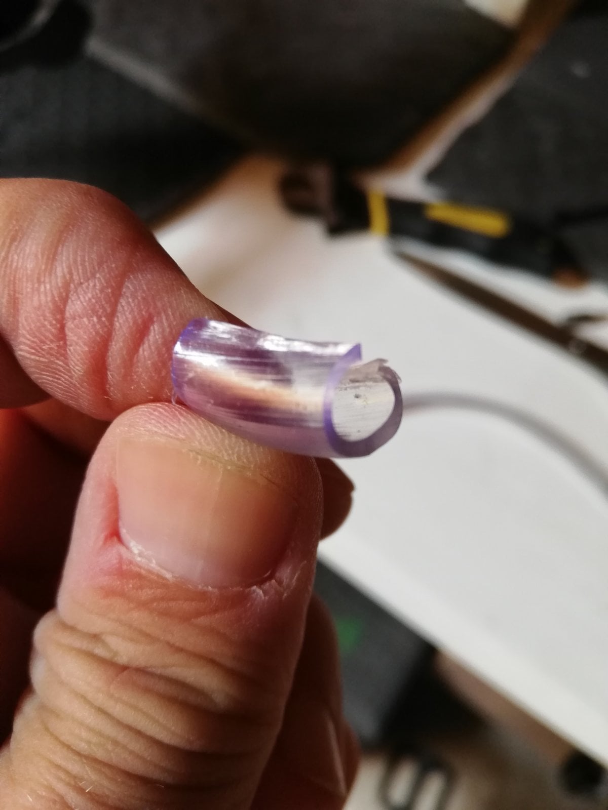

I put a sleeve over the cables and into the holes (photos attached). The rubbing parts could be any cable depending on how they pushed them in.
I used some old car brake bleed tubing I has laying around and it seems to have done the job. Just need to secure them now-could use a number of things tbh.
It may seem a small issue but mine would have chewed the rear hydraulic brake cable-not good!
Check yours out, the photos should give enough idea of what I did, used and the measurements when gauged against my fingers.
Or remove the little knives and fit M3 x5mm Cap head screws.

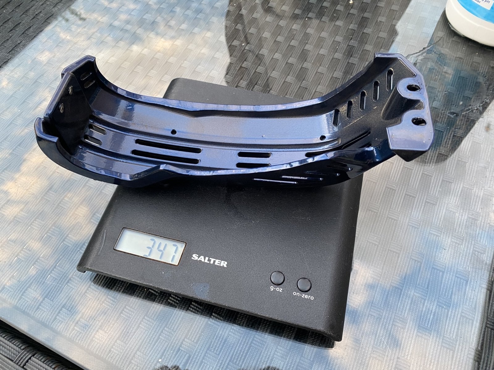

@Rob Hancill given the low BB isn't taking off the bash guard bit of a risk - have to say the bash guard looks to be a quality bit of kit compared to other brands offerings
Give me a few months I’ll let ya know! Ridden a few bikes without bash guards and not had any issues just yet ?
it’s way too heavy for what it is. Simple moulded plastic would probably be better and absorb impacts better too ?‍♂️
