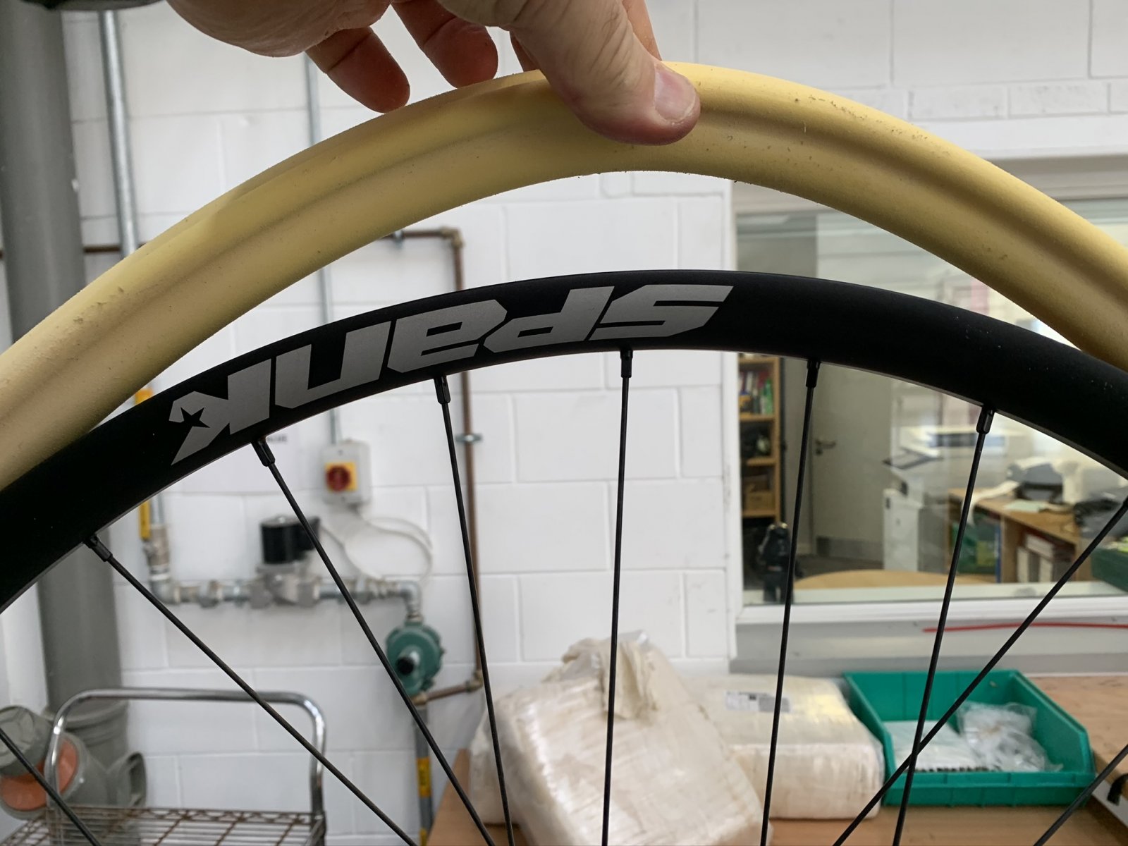

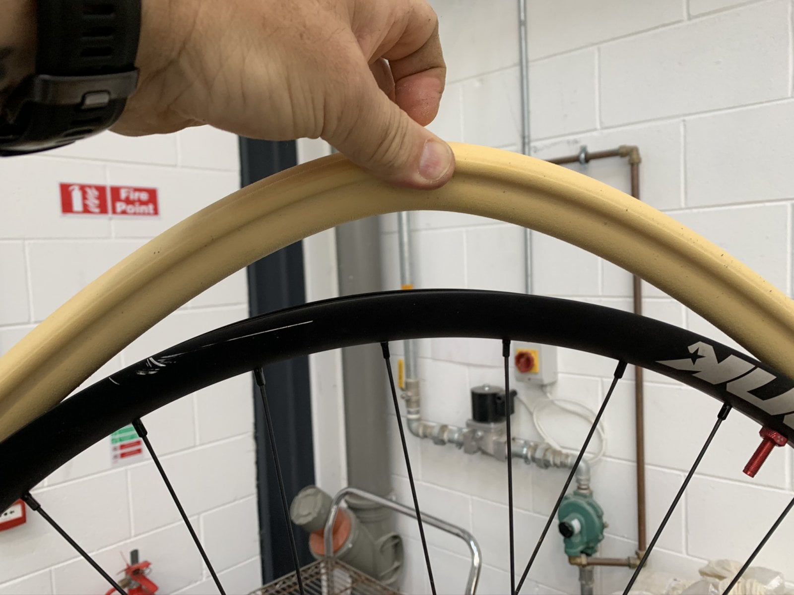

I went from Cushcore to Nukeproof ARD.
The ARDs slot in & out easily. If needed you could whip one out & throw in a tube to get you home.
Cushcore tough to fit, although it does get easier with practice. Not a hope of popping one out trail side though.
On the trail.....if the Cushcore is considered the bench mark at 10/10. (& they really are superb!)
I’d give the ARDs a 7.5/10.
The Cushcore’s really felt like an extra 10mm of suspension on my Levo & offered very tangible sidewall support. The ARD’s don‘t offer the same level of cushioning or support but so far....they‘ve done everything I’ve needed them to do. No punctures yet (admittedly not out as much as I was pre Covid) & they’re working well. Whilst they don’t match the Cushcore on the trail, you know they’re there & they inspire confidence.
Given the ease of fitting, the huge cost differential, the ability for trail side removal etc......they’ve won my vote!
I sold my 2nd hand cushcores for more than I paid for the ARDs, so happy out ?
I’m currently weighing in at a delicate 120kg on an XL Levo.
It‘s only fair that I post an update.
In short, I’ve gone back to Cushcore. My initial enthusiasm for Nukeproof ARDs was sadly misplaced.
Pros:
Cost
Ease of fitting
Trail side repair.
Cons:
Less cushioning (Really noticeable on some trails!)
Less side wall support
They stretch.......oh my they stretch!
After not a huge amount of Kilometres.......the bike developed a truly awful noise. I actually pulled into the side of the trail fully expecting to find a cracked frame or something equally catastrophic. Nope.....couldn’t find anything.
Long story short.......both ARDs, front & rear, had stretched & were literally hammering around inside the tyre.
Was so delighted with the ARDs initially, but for me......they‘ve proved not to be up to it. So.....I’ve thrown more money at Cushcore ?‍♂️

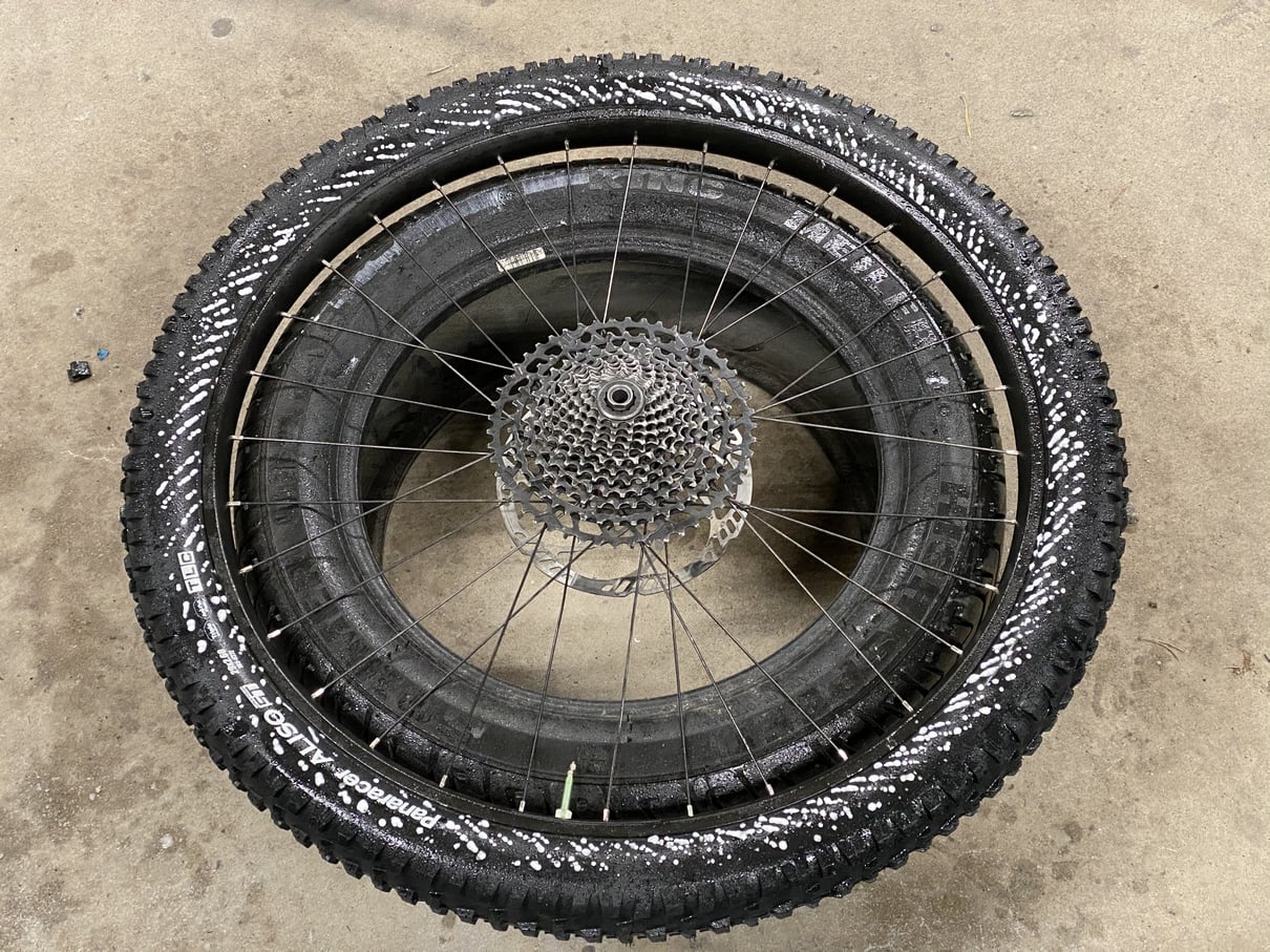

This has been said in the Cushcore installation instructions but...
Protip: Put the wheel on top of an old car tire. Pushing the bead will be a lots of easier. You don't need actually much force when doing it this way. Without the tire (or big bucket) it's hard (at least for me).
btw. In the picture there's a faulty Panaracer Aliso that wanted to make soapy bubbles.
