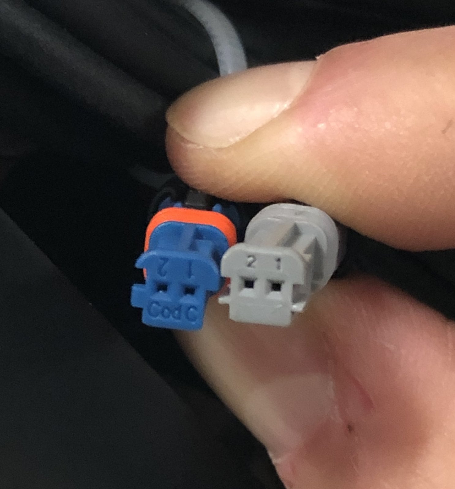

Ok guys, just to provide some updates. It might be helpful for some newbies like me :)
It appeared I was using the wrong connector - the one on the photo is from the flashlight and the correct one was hidden deeper under the bunch of cables so it was a bit hard to reach to it and see it. Thanks to the seller from the ebay where I bought the item for pointing me to the right direction.
Now I'm finally happy with my commute :)

Hey guys.
Has anyone had problems fitting speedbox2 to Bosch active line plus gen3?
It looks as 2-pin connector is a different shape and I couldn't fit it...
I've bought my Cube touring one 2020 e-bike this year if it makes any difference
Thanks,
Alex

Sorry to bump! But I have the Cube Touring One 500 and am planning on installing SpeedBox 3 tomorrow, how is your bike so far, any error codes or issues?
And have you updated the software at all?

Still going great. No error codes. Last ride I thought I had an issue with it but it turned out the magnet on the wheel had moved, slid it back into place and tightened it up and all good again.
