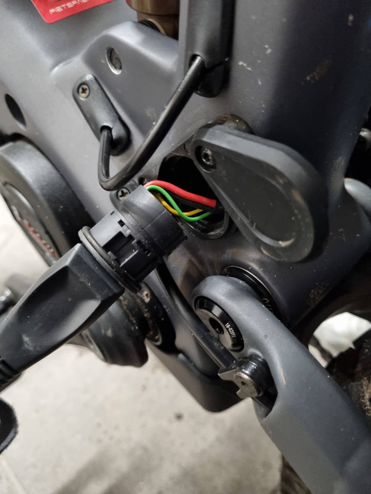

Hmm got the same thing as a few others in here with the charging port coming out after 2nd charge. Was carefull after the messages here but didnt matter apparently...

not sure how the port is coming lose though, i can't see anything how it's actually secured on the back :s

Heres a detailed pic of the charger port. I assume there must be some sort of fragile clip holding that back?
Would that now be laying lose in the motor compartment or what?
Pic taken just after rinse and towel wipe. Thourough wash was planned today. :)

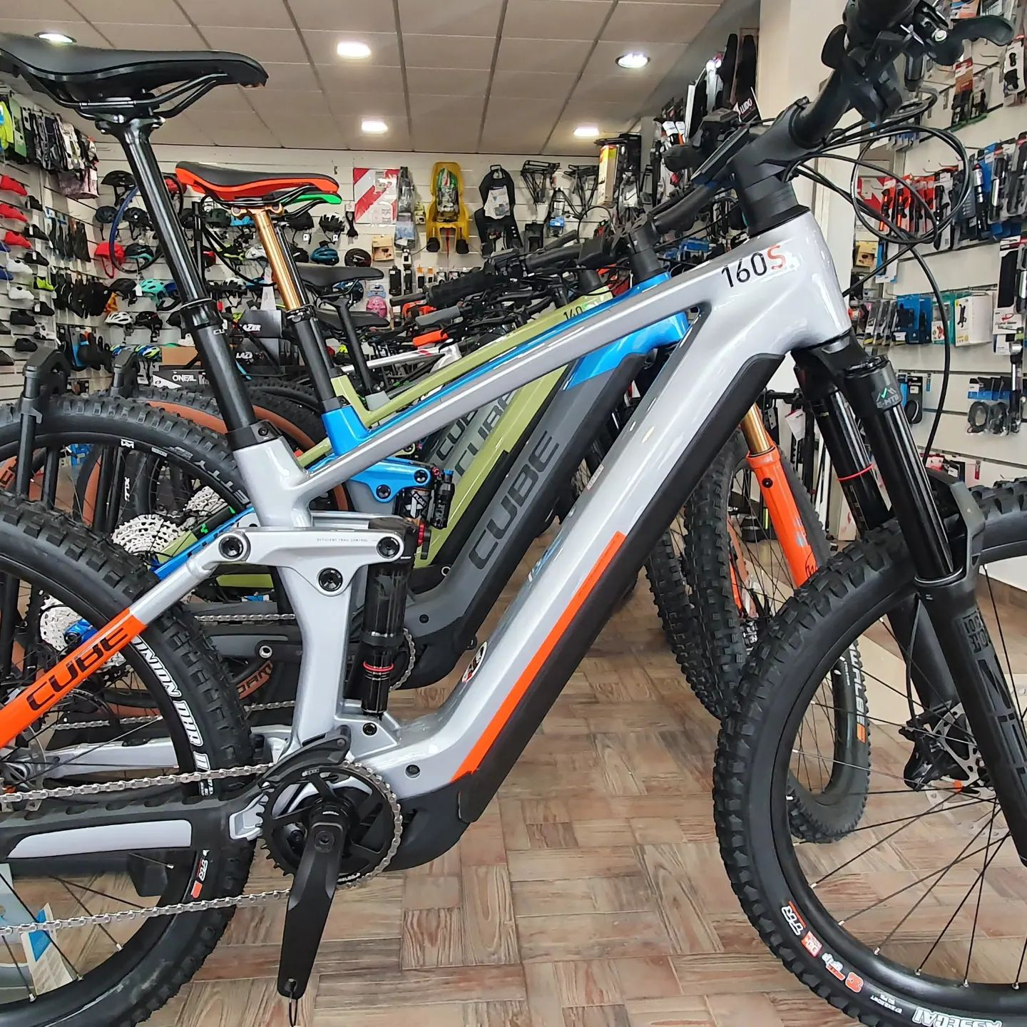

Well that is really weird. That shock doesn't look like the shock pictured on the bike I'm buying from my bike shop, but I've just read the specs and it does indeed say that it comes with the Rockshox Deluxe Select+. All the press pictures I saw when I ordered, had a piggy back shock which now looks like the Super Deluxe Select+. I'm a bit gutted to be honest because I'd have probably upgraded to the TM if I'd have known.
Chris ledger
Aug 17, 2021
447
246
Rotherham
Does say on cubes website spec may change due to availability bit of a kick in the teeth though if you wanted a shock with a canister and still paying 5k
Fixed it myself!
for those who has the same, there are 3 pins that should clamp in the middle section, probably not clipped in correctly by cube.
remove the 2 screws with an 2.5imbus (be carefull as these are butter screws)
remove the port and force the clips in. you could use a bit of glue to keep em in place a bit more or use some electrical tape to put around it.
easy fix

That is definitely not a Rockshox Deluxe Select +
Seriously hope it's not a downgrade after all this time waiting.
that shock absorber is as per description site cube! the photo of the site is wrong! the one in the photo cube site is a super deluxe select with tank! the deluxe select + does not have the tank
