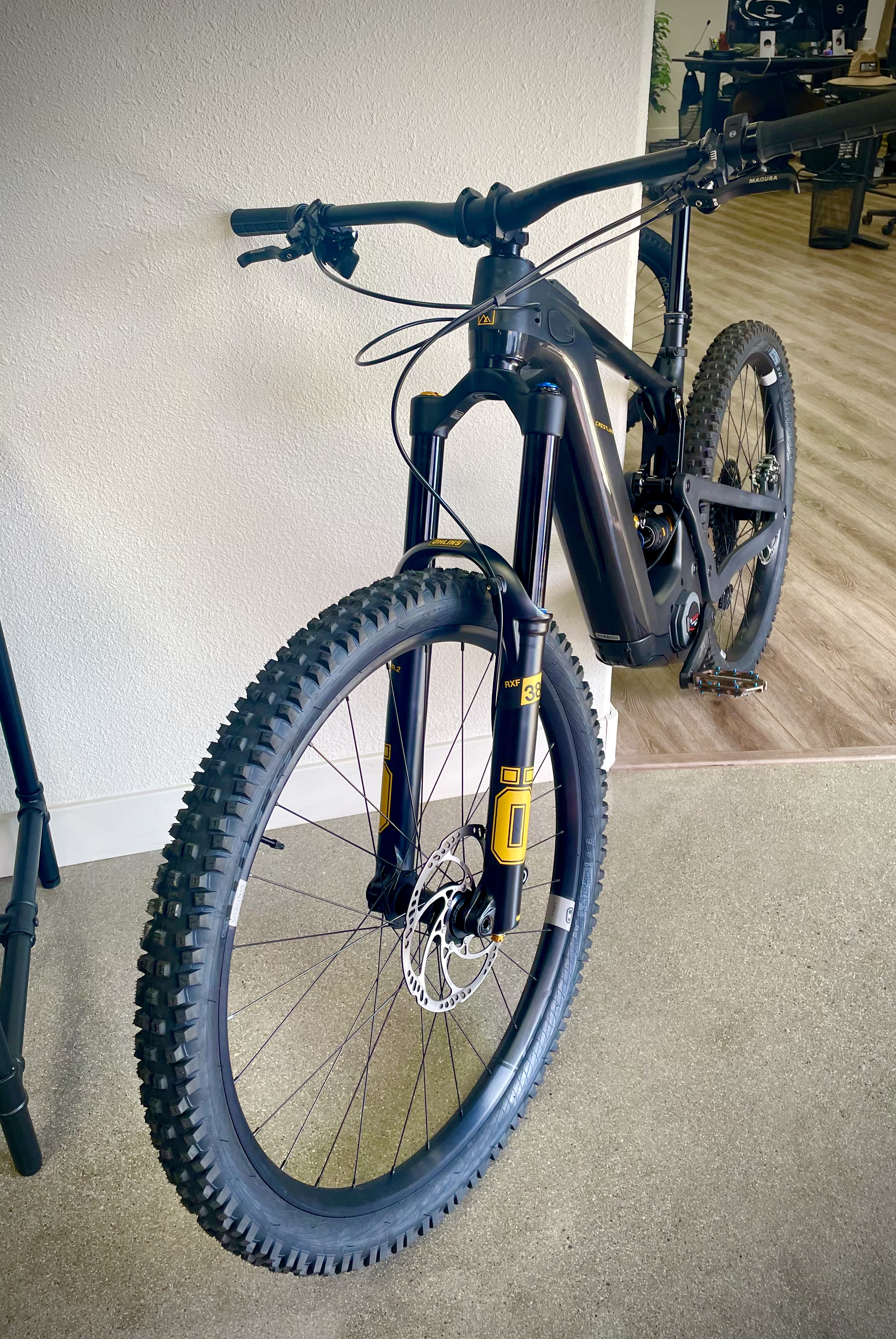

Finally got mine complete and home yesterday. I went with a custom tune on the Ohlins suspension for my weight and the bike itself. Only had time to rip it around the parking lot and off some curbs etc. It’s going to be a beast. Feels super nimble in short travel with the front fork at 170 and rear shock at 150. Once I get some rides in I may go to 163 in the back by removing the travel spacers but will for sure keep it in short travel mode. This thing is going to be awesome.
The Bosch shift sense will take some getting used to. It shifts kinda clunky and not instantaneous compared to my EP8 Heckler. Not sure what that is about. May just need an adjustment
