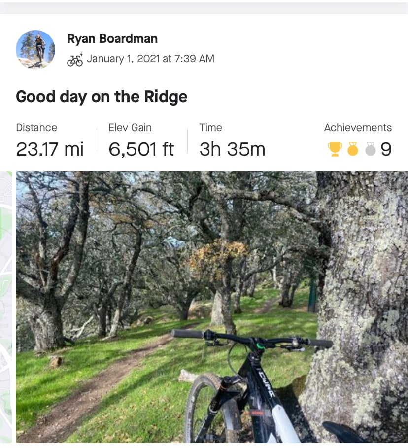

I’ve found that the range when in trail and boost modes sucks on EP8. It’s less than a similar rider on a 500wh Levo in my experience. But when going slowly it can be much better. I did this ride mostly in eco and finished with 2 bars left. That’s nearly 2000m of steep climbing. But to be fair, one of the most fun parts about an ebike is not going super slow up the climbs. So still not a great selling point.

Hi Ryan,
Kudos for that ride! I tried a shortish steep off-road climb with the motor off and the bike is geared to make it doable it but it's sloooow. A Meta in Eco wouldn't be my first choice for 2000m climb in 23 miles!
In terms of the seatpost, I've tried it out of the frame and when on the bike it's torqued to 5.5Nm (which is less than recommended I think). In both those situations it's continued to stick.
BTW, where is the ridge if you don't mind me asking?

Northern Ca, USA. We don’t really have a winter here in the San Francisco Bay Area. Rains maybe once a week and is perfect for riding all other days.

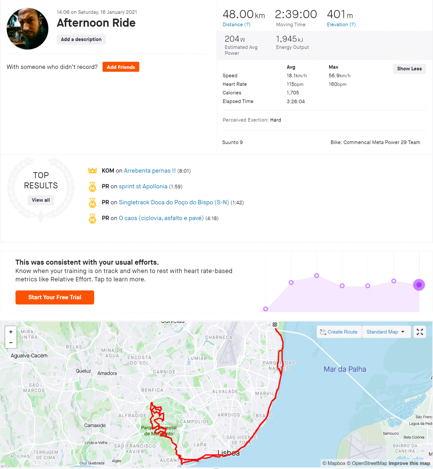

I wouldn't worry too much. This is from my ride from my house to the local hill, and back. All-day in Boost on the flat and Trail on the hills :) Had 1 bar left. It was around 12 degrees Celcius.
I am not the fittest and also quite heavy now with this COVID weight :D 90Kg's

To be honest, I can't be bothered to ride in eco 30 ish kilometers back and forth from my house to the local hill in ECO(yes I am also quite lazy since the lockdown started last year in March :)). I have the second profile for real low power consumption. But for the moment(regular Shimano settings), 48KM is good. Not too much to climb(400mt elevation). But I am sure that if needed, I can squeeze enough power and distance if I plan on a long day in the saddle.
The power profile I used that day, was the "standard" one from Shimano. For long days I have put the following:
ECO - Lvl 1 - 27Nm - Lvl 2
Trail - Lvl 4 - 56Nm - Lvl 3
Boost - Lvl 6 - 70Nm - Lvl 4
Haven't tested it though, as in Portugal we have these restrictions and haven't gotten to a place with longer trails, higher hills. Once we will be back on track or vaccinated, let's see what this beast can do :D
