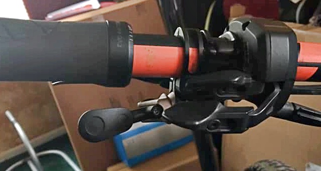

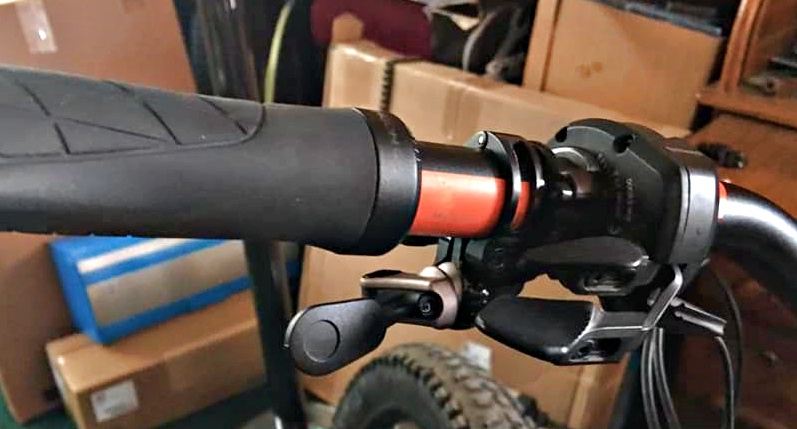

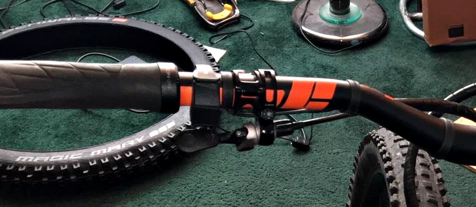

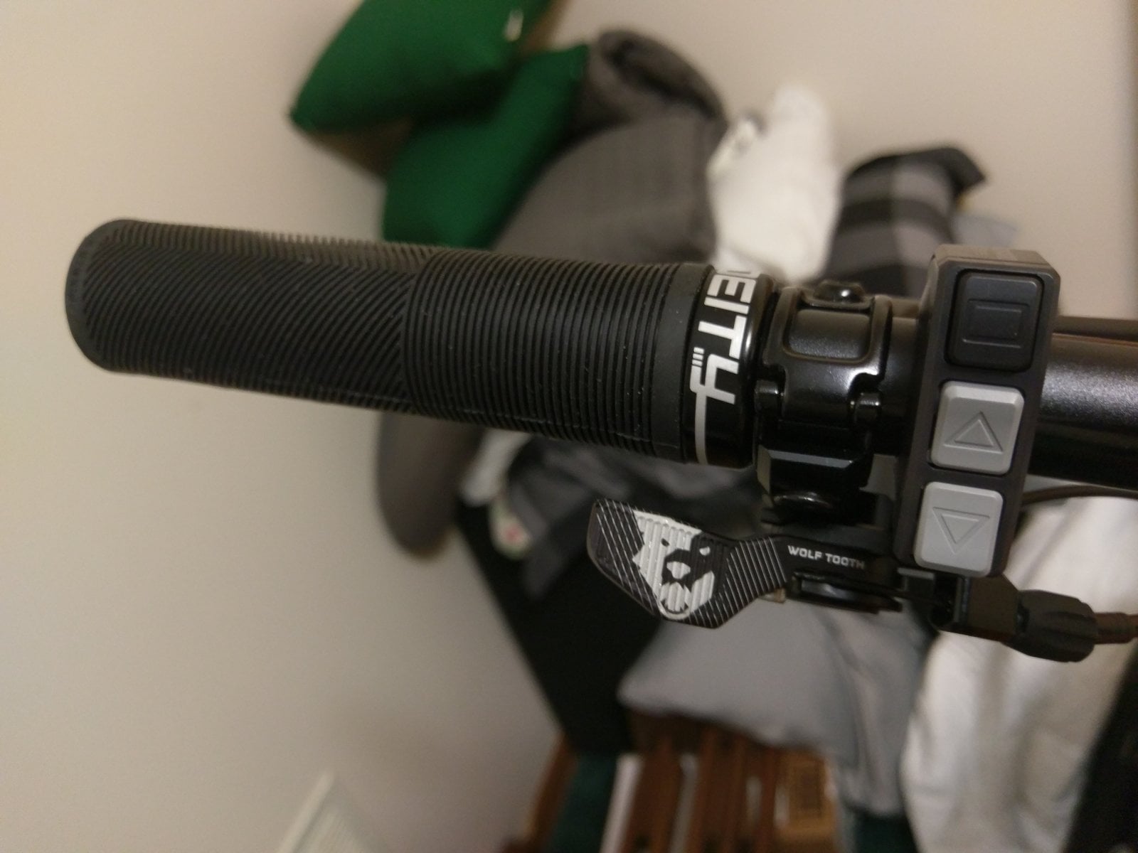

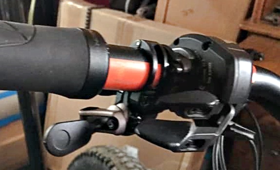

Put my dropper lever in the proper place and moved the mode shifter to the right, actually worked pretty good. The dropper was right under the thumb and the mode shifter was easily pressed. Will work till the E7000 switch is available..

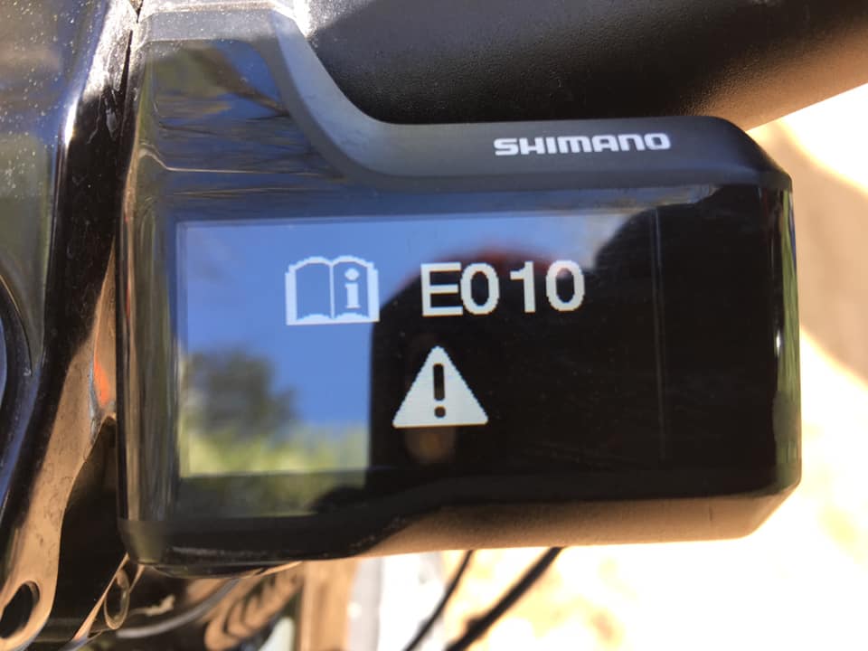

This happened to me yesterday. Took battery off and on. Error would not go away. Luckily I had just purchased a tow strap and my Ebuddy towed me back to the trailhead. Been researching and it seems like it might be the battery connections. Out of town biking trip, lucky it was on the last day and we had a backup E to use.

That’s the code mine started with , then I got wo13 when I re started it . I was Constantly cleaning all connections especially the ones on top of the motor , which seemed to work each time , eventually the codes came to stay and I got a new motor from commencal under warranty . Eo10 seems to happen if I confuse the crank sensor , sitting waiting for a while with a foot on the pedal as if to pedal off can make that appear but it doesn’t stay or cut out .

Kernow did Commencal replace your motor or Shimano. Mine is being sent to Shimano to be looked at. Hopefully will be a warranty replacement.
The motor was returned to commencal , who then sent it to shimano France . They gave me the option to use a uk shimano dealer but I preferred to remove the motor and do the work myself .
Be sure to remove the plastic covers from your motor if you send it off as the new motor comes without them

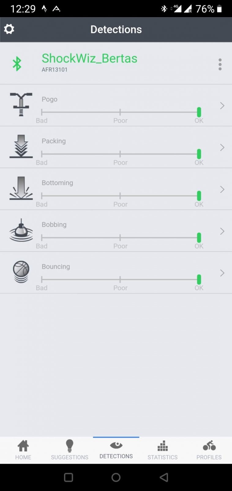

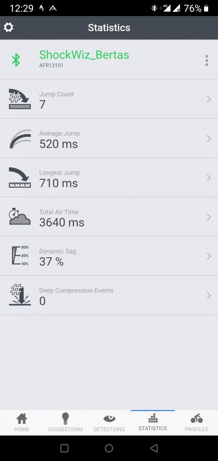

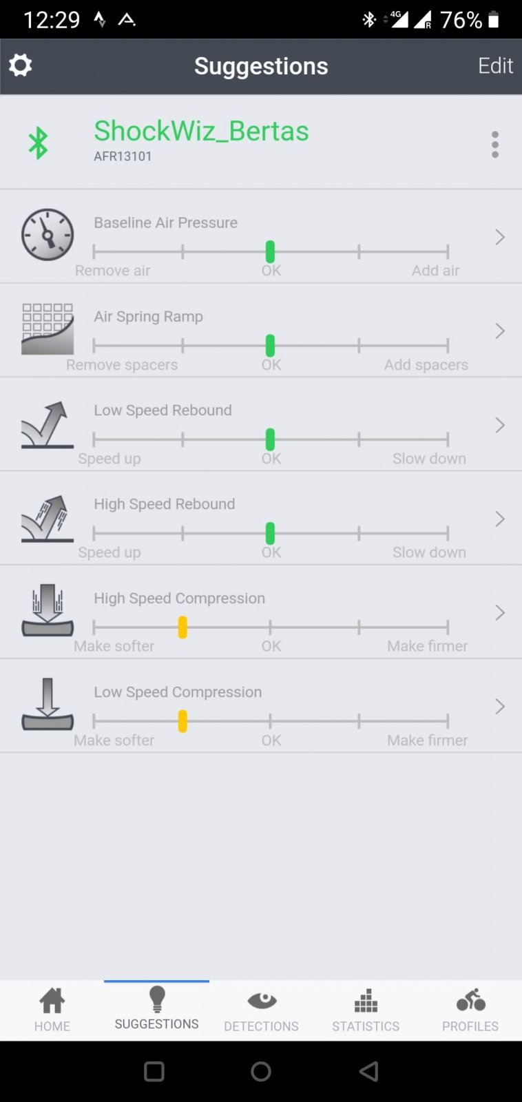

What does the shockwiz actually do tho??
Al-Rider
Oct 14, 2018
72
57
Lisboa, Portugal
It connects to your shock or suspension through the air valve and measures all the pressure variations during a ride. You then get a summary of how your ride went in terms of suspension events and it gives you sugestions for tuning your shock or fork:
