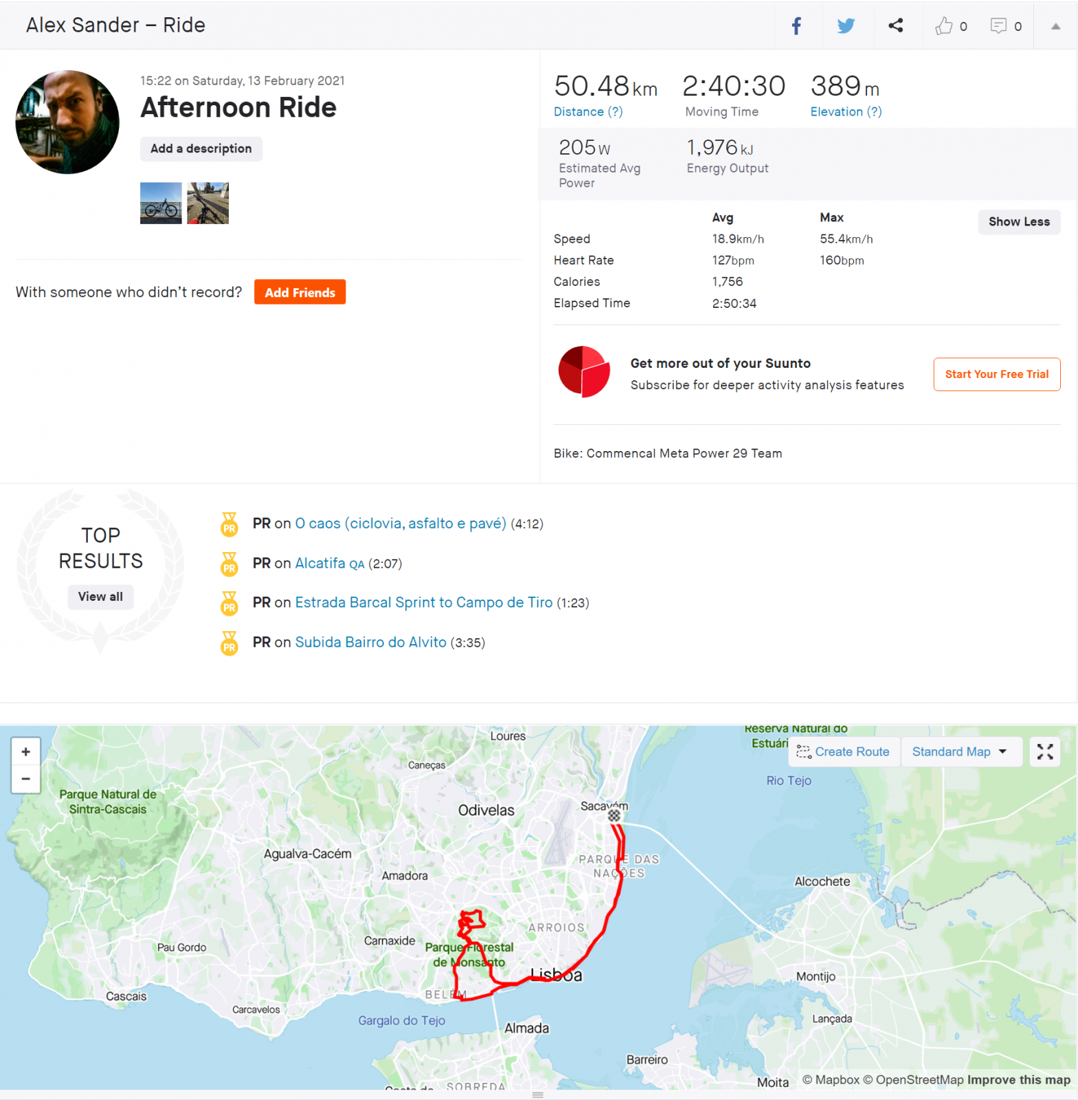

Heya guys, quick update. Had today a 50ish ride in the whole day in Trial mode. So almost full battery for 50 Km's with most flat. Please keep in mind that I am around 90ish kilograms and today was a real muddy day. :)

Did I miss how much charge you had left at the end of the ride?
Whoops :) 1 red bar left and showed me 9km left on the screen. Have to say the last bar goes a lot faster. When it turned to the last bar it showed me 38km left, then until my house, it is around 9/10ish km left. So in 10km, it went from 38 to 9.

sounds like your 50.48Km to almost out of charge in (what I assume are) warmer temperatures is not far off my 40Km in very cold conditions in Trail. I suspect that you might get more range by reducing max. torque in Trail just a little (but that may not be an issue for you)
Still learning at my end...

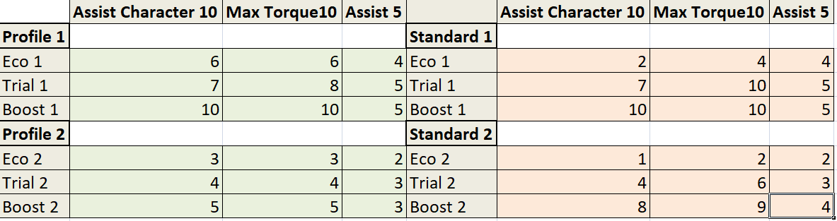

Same behaviour here, I changed the settings, so that I have 1 ECO profile and 1 more powerful profile on the bike. On trail I had this weekend 2 40 ish Km rides with around 300/400Mt climbing, and I used up only 2 bars before coming home. Huge difference.
On theLeft side are the "new" settings, and on the right the original ones. I feel this is my perfect setup (y) If you check your app you should understand the "clicks". On the climbs I dont feel any difference from the Trail to the Boost :)
I haven't messed with the different profiles too much but that's interesting. I still like Boost for short super steep 'step up' type climbs otherwise I agree that Trail is fine for pretty much everything else, especially if you're willing to spin a fastish cadence.
Do you swap profiles mid-ride or do you pick a profile for the type of trail and distance?
So you cant change them mid-ride, but you can stop to change them. You need to stand still for a couple of seconds until you can go into the settings and change. I basically have set it up so that Profile 1 is a bit more powerful and usable for most of my type of rides. If you look @ Eco Mode in the factory settings it has a very low assist. Making the steps between the settings more abrubt. This(in my opinion) makes more sense for me personally. As if I want low settings I could use the second profile.
The second profile is more thought to be for an epic day out. When battery preservation is more important than speed (y) Hope it helps man :)
