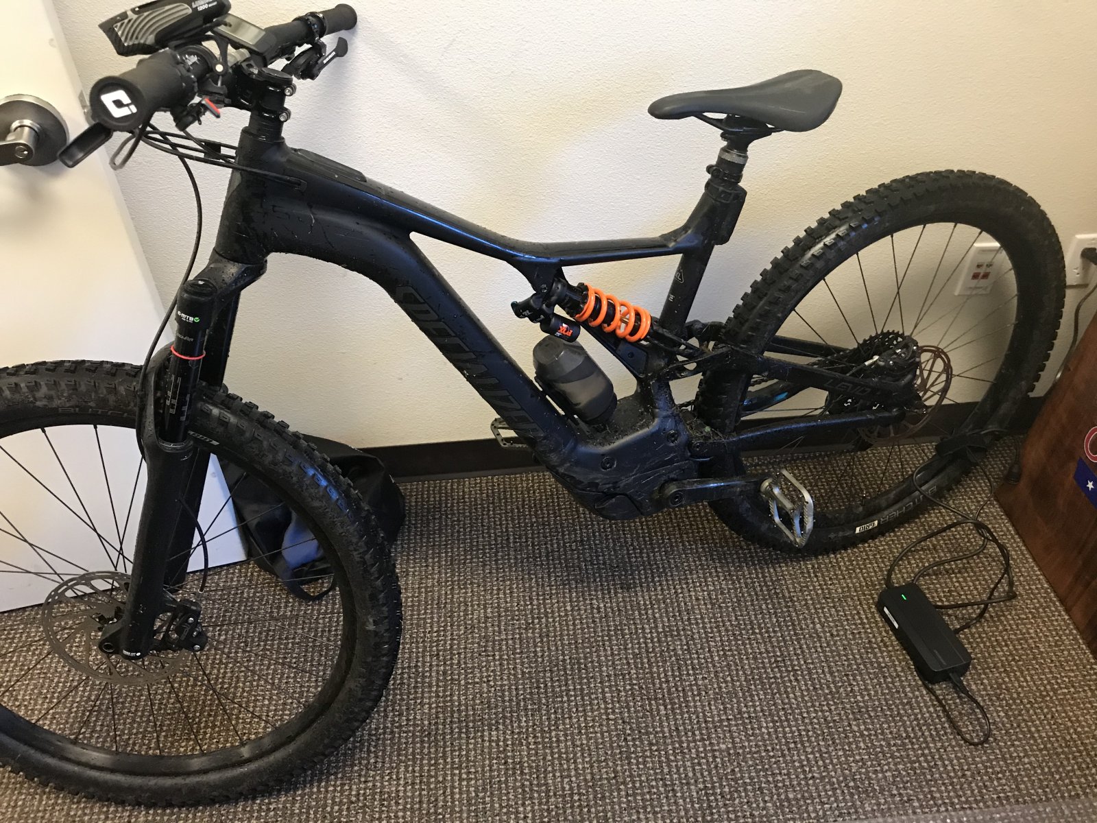

I put on a fox dhx2 210x52.5 with a 500lb sls spring. The ride is fantastic. Only one harsh feeling bottom out but my tire pressure was also way too low. Around 21psi. Harsh rim dinger. Even a few 2-4 foot drops to flat did not feel harsh bottom out.
Might try the cc progressive coil for fun
