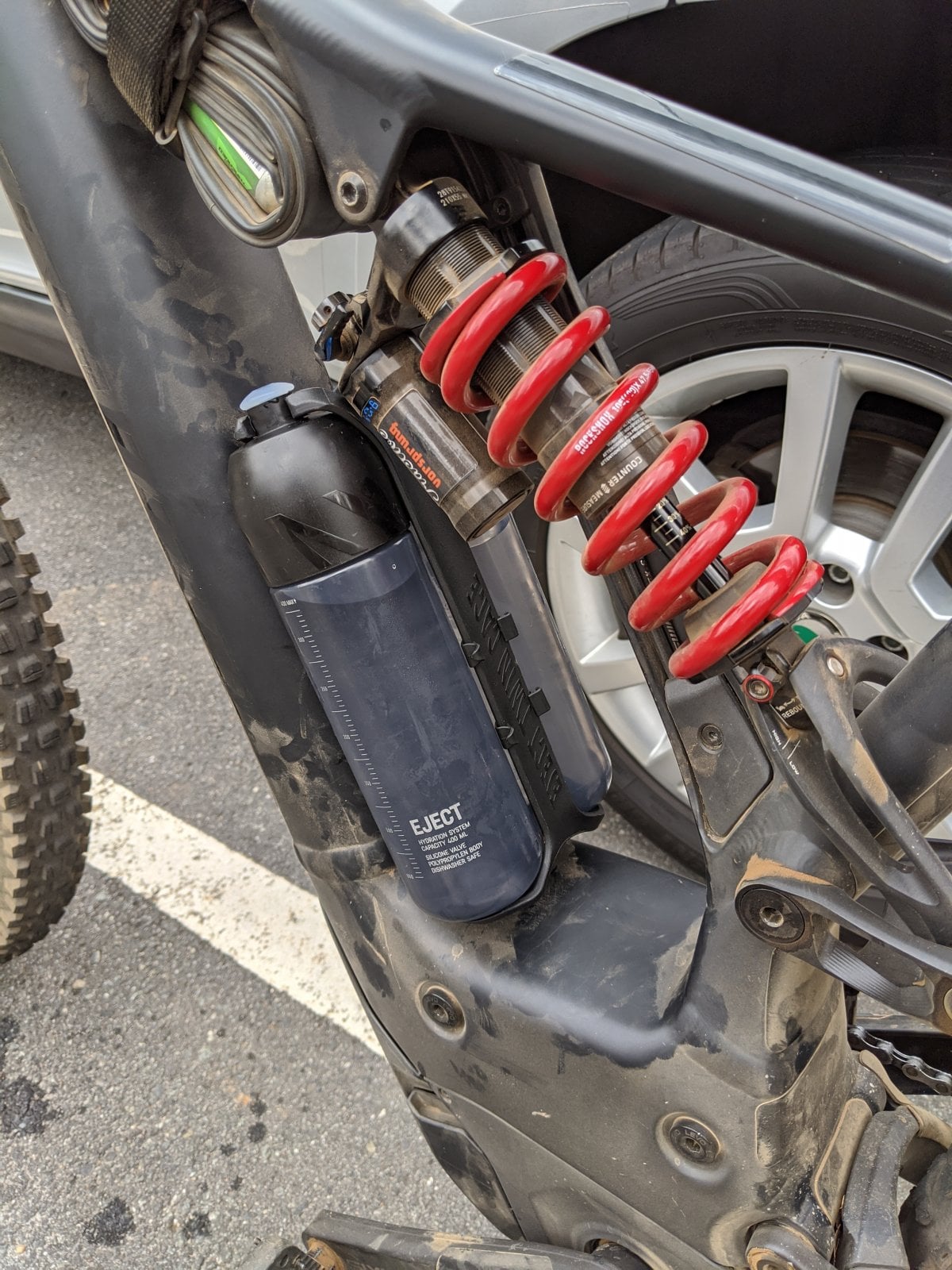

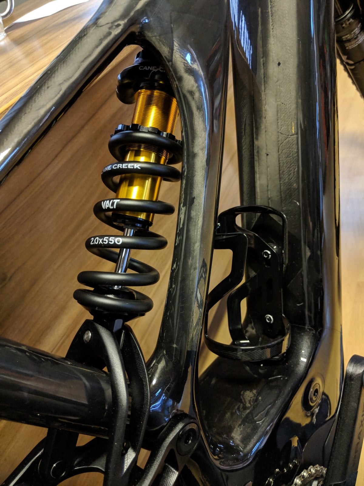

What Fox Bushing kit are you going with to add the Bomber CR rear shock?
EDIT: I called Fox and confirmed we need 1x:
Fox 5-Piece Aluminum Mounting Hardware Kit IGUS Bushing Shocks 6mm x 0.787" 20mm
MPN: 803-03-237

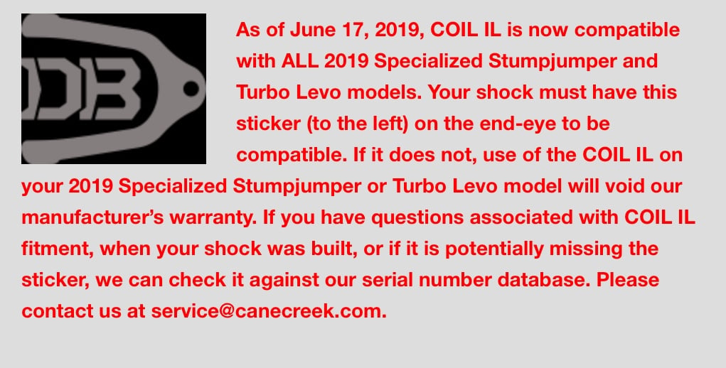

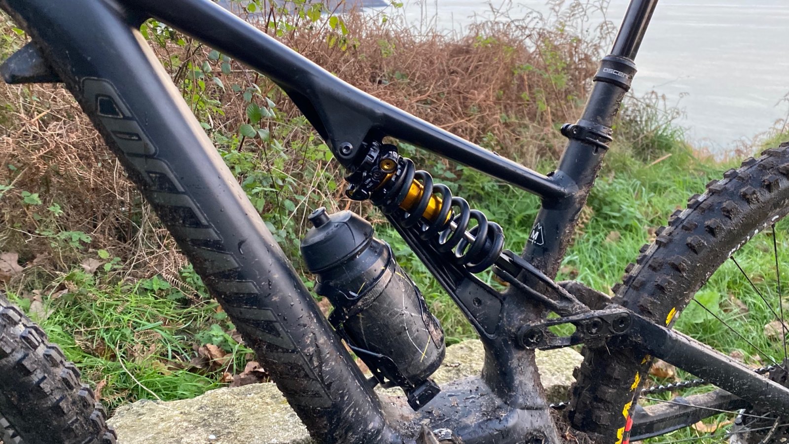

Hi,
i got a DB IL Coil now, and it rides realy plush.
But whats strange for me is that I have to fully close the LRS knob und nearly fully close HSR to get the right rebound speed. The climb switch doesn't change anything too.
It seems like, when the rebound ist to fast, or on a to fast setting, then the climb switch makes everything slower. i think this shoukd be so.
But when everything is on a slow (for me right) setting, then the climb switch doesn't change anything.
So my bike is still luffing when I pedal. I also tried to set LSC to max, but that doesn't help.
So in Austria we have about 8°C now. I think in summer at 35°C the rebound speed will be faster then now... and to fast then in summer.
so what can i do to improve this?
has anyone same problems?
cheers, stefan

Hi,
cheers, stefan
Something doesn’t sound right - on my DB il coil I’m more or less running it on the recommended base tune for stumpjumpers / Levo - and I have enough rebound adjustment to either dramatically slow the shock down or speed it up way too much.
Making these adjustments doesn’t seem to impact the CS for me either. Also, my CS makes my shock very noticeably firmer.
I’d suggest that something isn’t quite right with the shock and it needs to be looked at by cane creek - Are you sure you have the correct stunpjumper / Levo version?
Hi,
i bought the shock from tf tuned. Everybody says that they know what tey are doing - so yes, the shock should be levo specialized :)
how do you setup your shock, can you tell me?

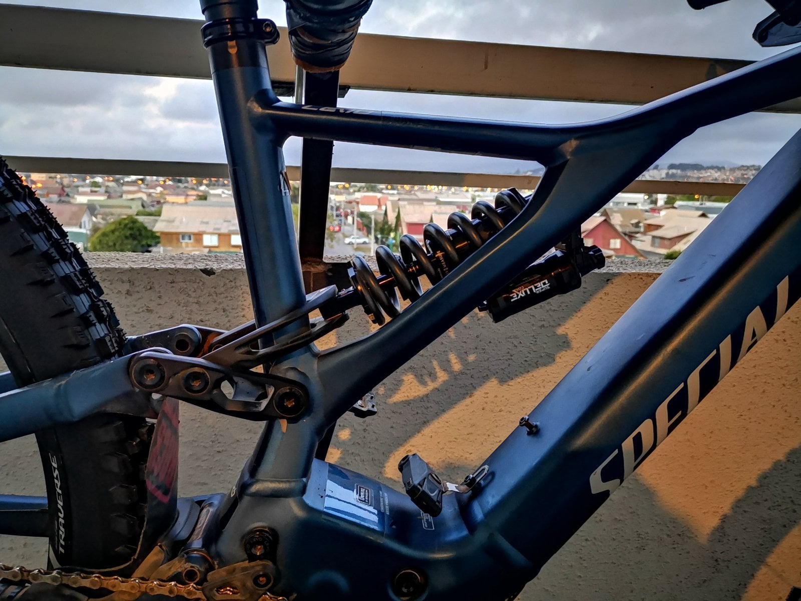

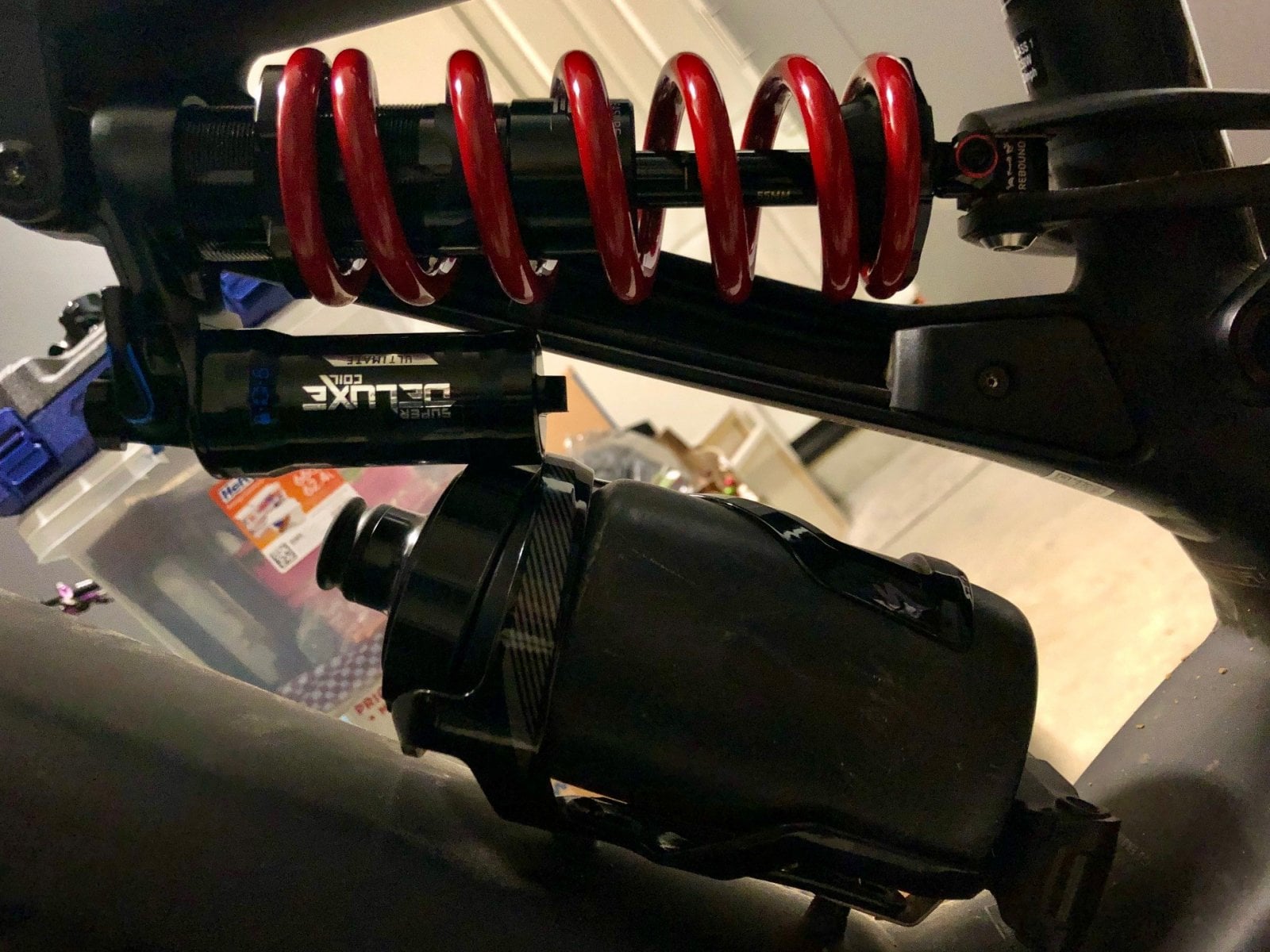

Yesterday I upgrade to a RS superdeluxe ultimate coil, I just rode it in the street and some stairs... it's my second coil shock.... I missed that feeling .. now I have to work out to do Bunny hops hahah it sticks to the ground
210 x55? Been offered one of these but unsure. I've had a dhx2 on my previous bikes and loved them.
Frano
Jul 11, 2019
36
68
Chile
Yes 210x55, I haven't tested in the field yet, but previously I had a RS vivid R2C on a Canyon strive and works amazing.. this new one should be better

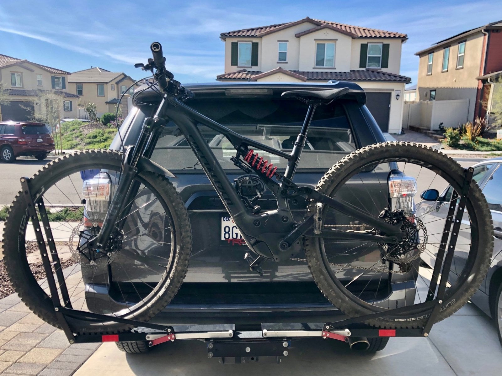

When I check in USA the FOX DH X2 (210 x 55) isn't here or special order? Anyone here in the US have a 1) DHX2? 2) where did you get it if yes (buy link) 3) Who has a DVO? Do you like it? Cost and length? Sorry for the numbers 1,2,3 lol just want to get this nailed down. From what I read, the 600 LBS spring seems like a lot but I guess it's rider weight...
