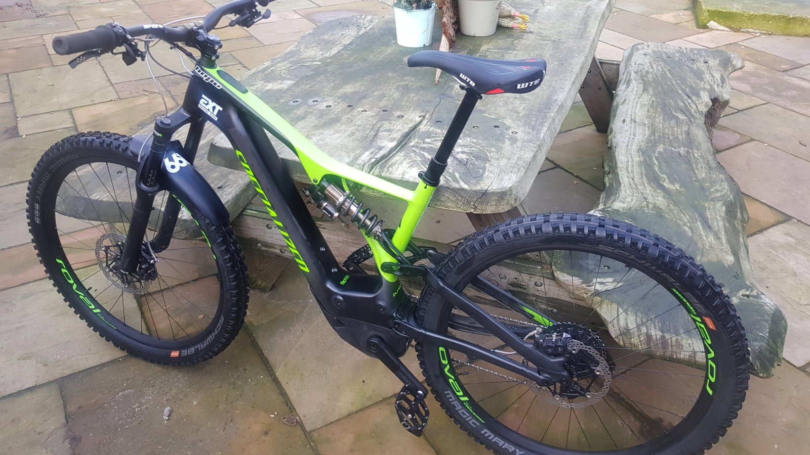

I went with the EXT Storia Lok 3 and have no regrets. Have the new fox 38 up front in 160mm. Luckily I got the 19' S-Works for close to half off in late February 20 just before Covid-19 hit the US and before all the bike shops sold out of E bikes so I could splurge on some components.

I went with the EXT Storia Lok 3 and have no regrets. Have the new fox 38 up front in 160mm. Luckily I got the 19' S-Works for close to half off in late February 20 just before Covid-19 hit the US and before all the bike shops sold out of E bikes so I could splurge on some components. View attachment 43332
Hi, how are you liking that Storia? I have brand new 2021 Levo comp and thinking some upgrades due to next summer enduro racing. Did you use 6x20mm hardware? Did you need to take away bushings from Storia? My dealer suggested Arma as option too. I also find 36 fox is little bit flexy, so any comments about 38 sturdiness and behaviour is wellcome. :) First post here and hello everyone :)

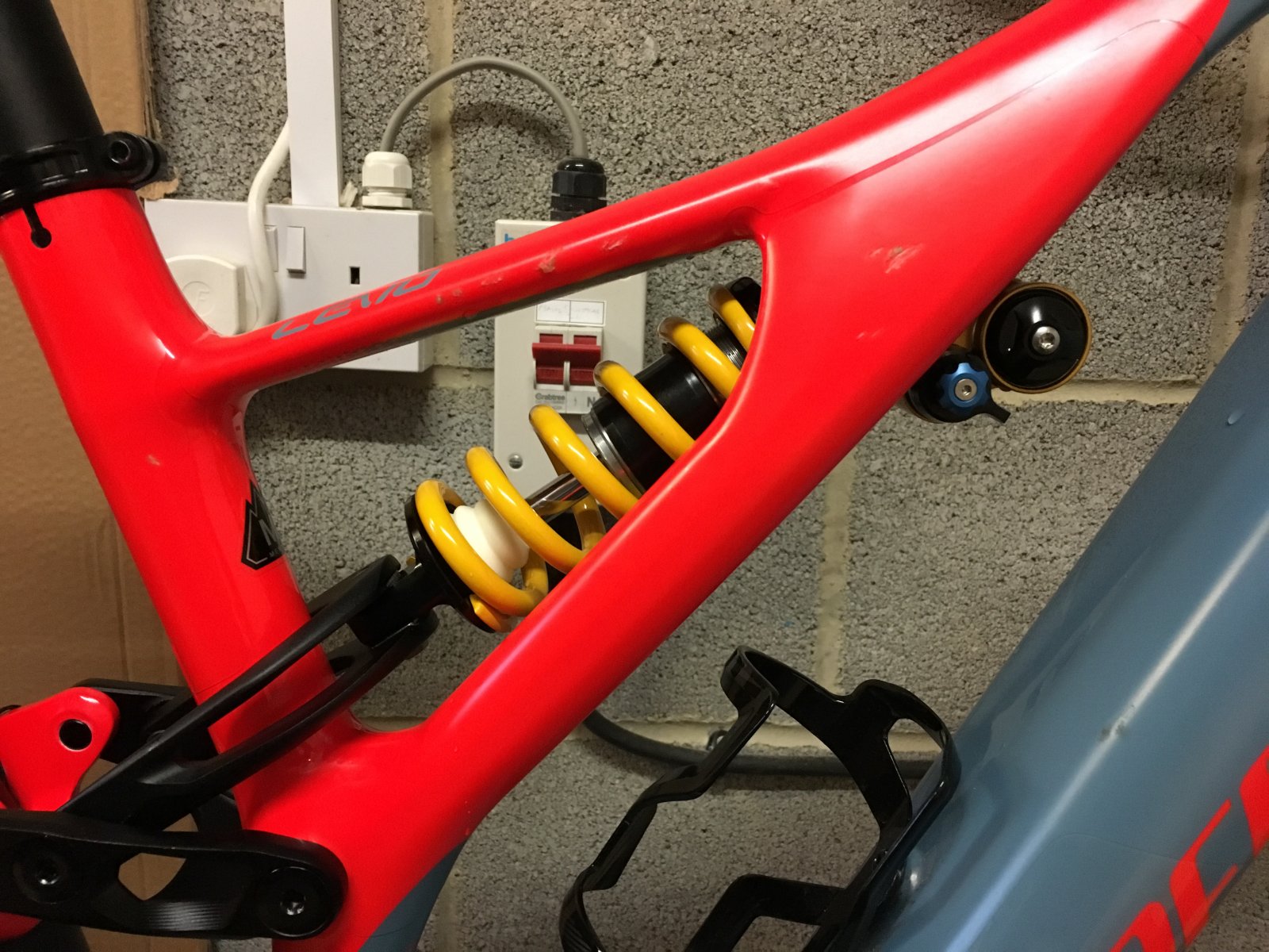

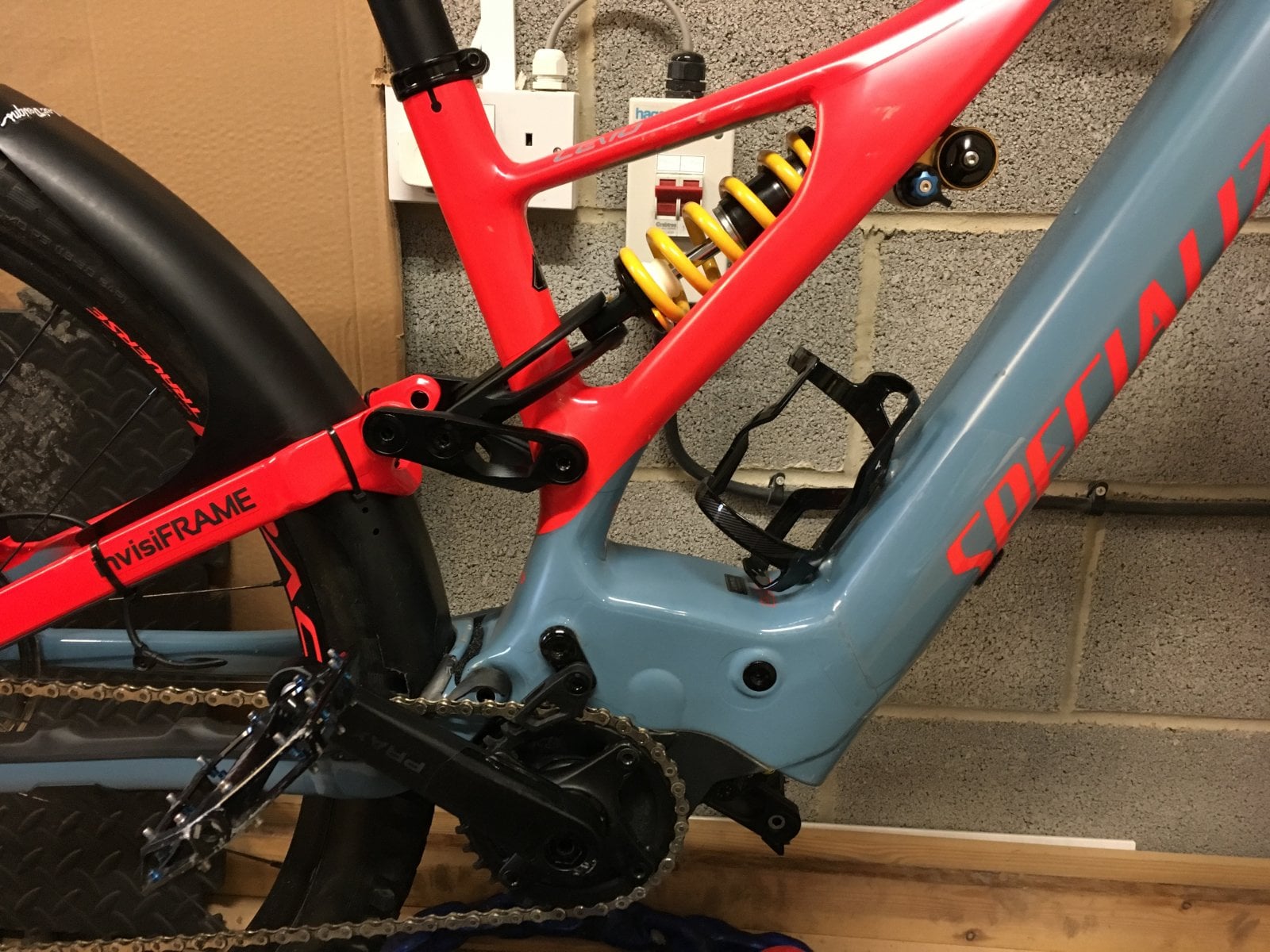

I’m 92kg and using a 600lb spring at the moment. I get 30% sag with two turns of preload on a DHX2. I’m going to get a 650lb spring to give myself a bit more leeway and allow for Christmas “fattening up” :).
Yes I love the Storia it's pretty progressive and paired with the cascade link and the correct spring it works really well. The 38 is so much better than the 36.
