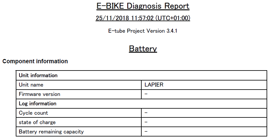

I put the question in the first post waiting for others to chime in to see if there is a real-life difference between charging methods and how fast the battery capacity goes down after a number of charging cycles...
I tried to check how my mistreated batteries are doing, but unfortunately they are not compatible with eTube, no information is available using SM-PCE1 box and a laptop with eTube (it's a rare Snakepower battery):

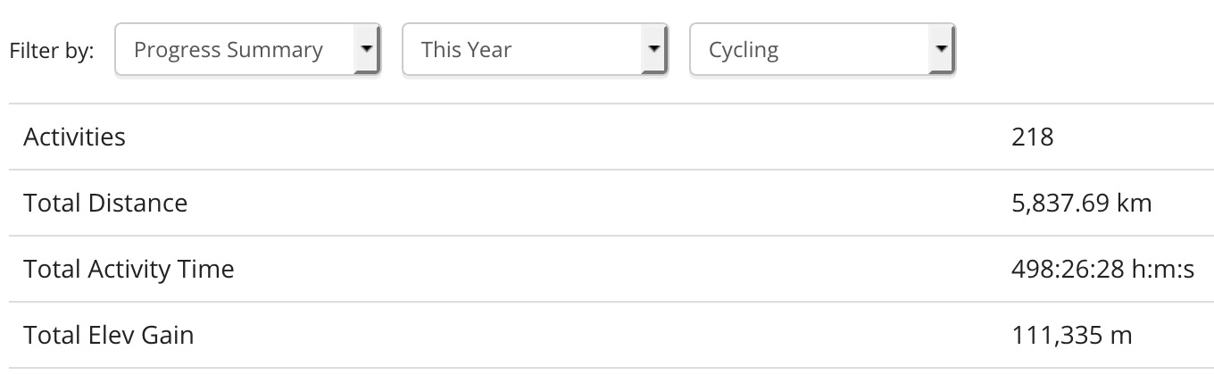

So far this year, I rode 5,837.69km - 3,039.72 with my ebike, and 2,797.97km with my XC and enduro bikes.
(Disclaimer - I don't have a claim on the accuracy of the Garmin Edge 1000 and Fenix 3 and the errands with my city bike are not tracked.)
