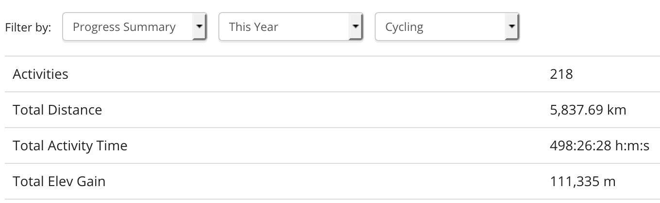

That is a very impressive amount of elevation gain. You're in a very good position to verify my speculation that one fully charged E8010 battery will provide about 1500m of vertical at a relatively constant (steepish 7 - 15%) gradient using 80% trail mode 20% boost mode. Obviously this also depends somewhat on cadence and user input, but I think it's really important to have a solid idea of what sort of vertical the bike will do when planning big rides. I can't think of any single climbs (in AU anyway) that would exceed one batteries capacity, but if I was planning 3 ascents of a 600m climb, I'd need to think about where and when to put on a second battery. I've already been caught short on a climb and pedalling a 22kg bike with no assist really isn't that much fun.
A 10% drop in the batteries capacity would equate to significantly less vertical.
