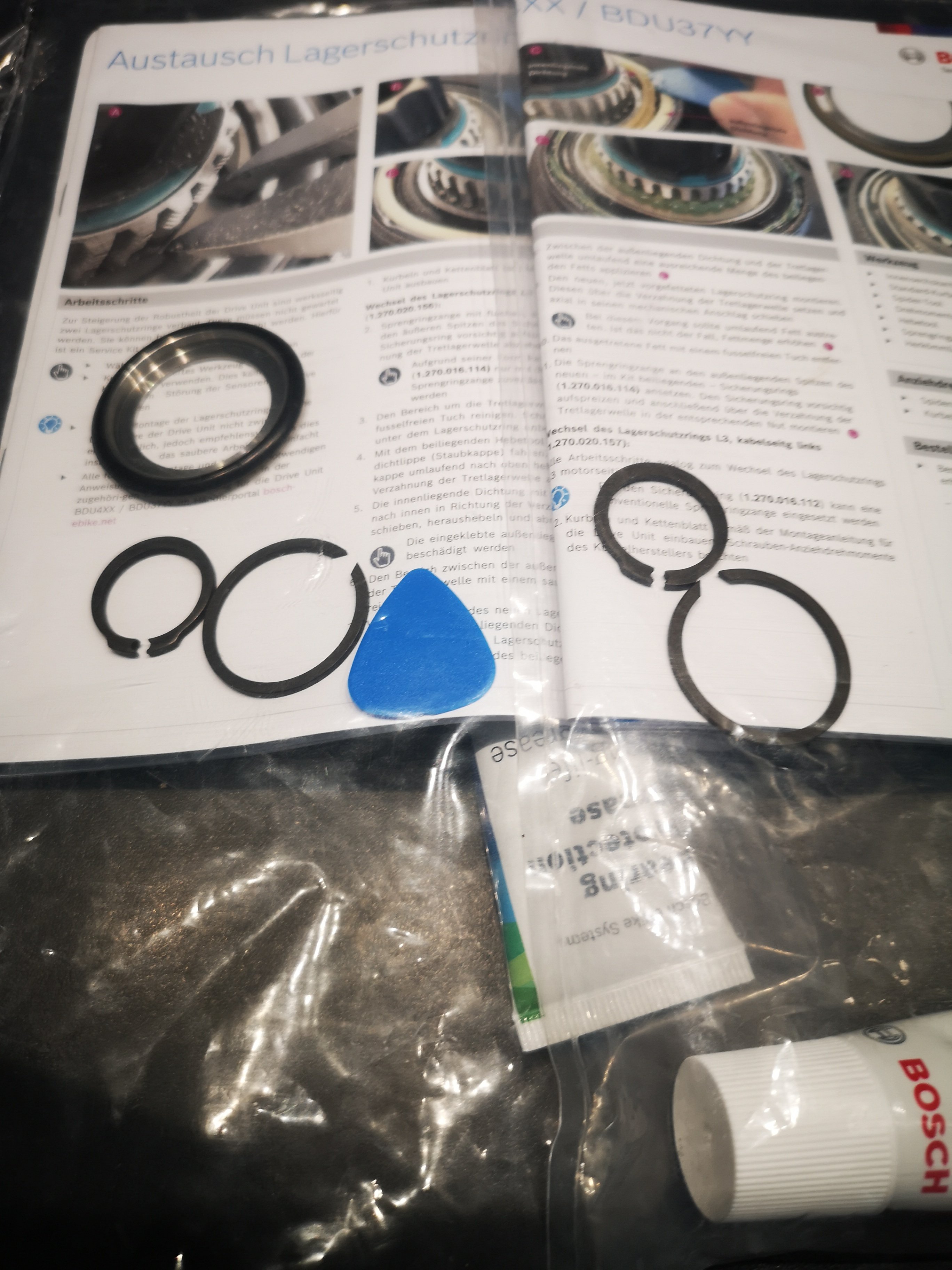

I bought a park tools crank extractor because all the vids say you need one for bosch..
Then I looked at my pedals lol..... oh whyte use self extracting cranks :cautious:
BTW, What's the tool called that has the blue handle and basically a hook for removing stuff?

It's just a pick tool & yep, camera work a bit of an aftethought, the GoPro on the chesty & stray left hand not the most helpful but hopefully the main stages are clear. It was Pete the @Bearing Man who impressed the importance of this job onto me. I'm forever grateful to him.

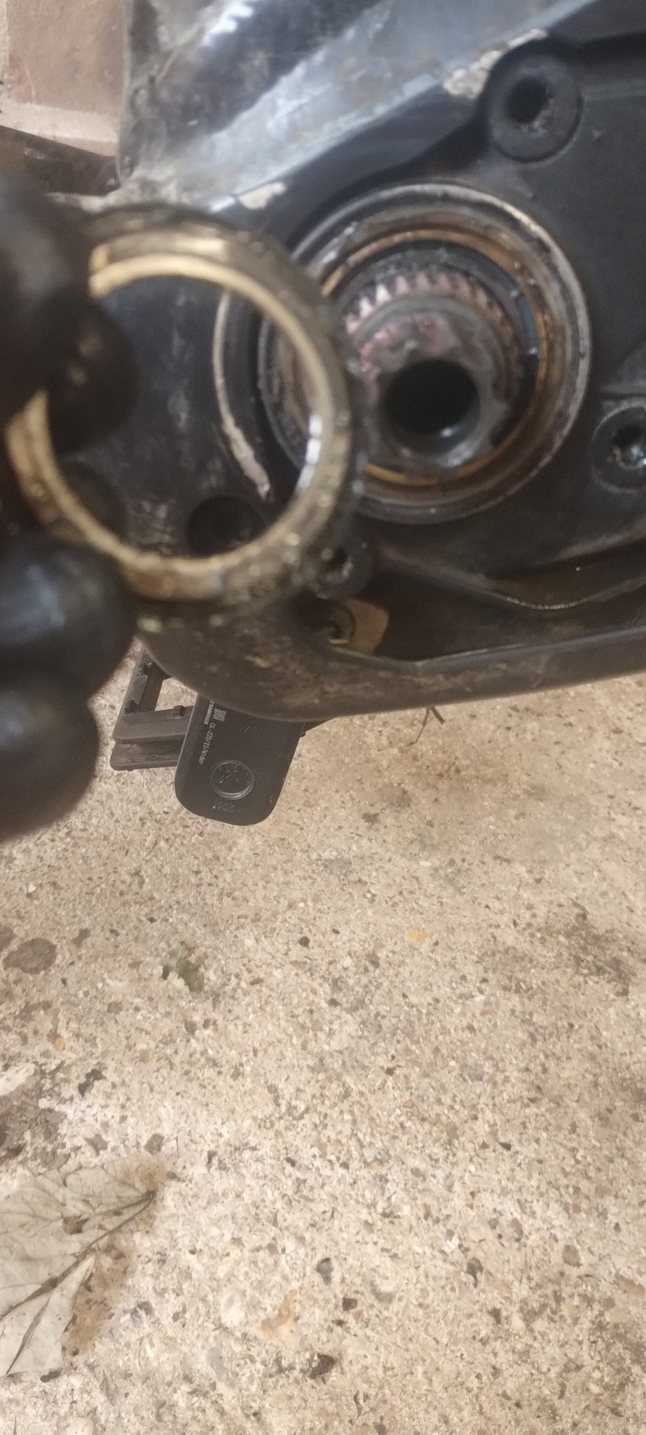

I think you'd judge it each time. The seals themselves are aluminium or steel with rubber covers bonded on to them. They don't wear quickly at all whereas the grease does disperse over time. Can't give a straight answer other than to say my bike has 2k on the clock & I've replaced them once & they're doing fine.

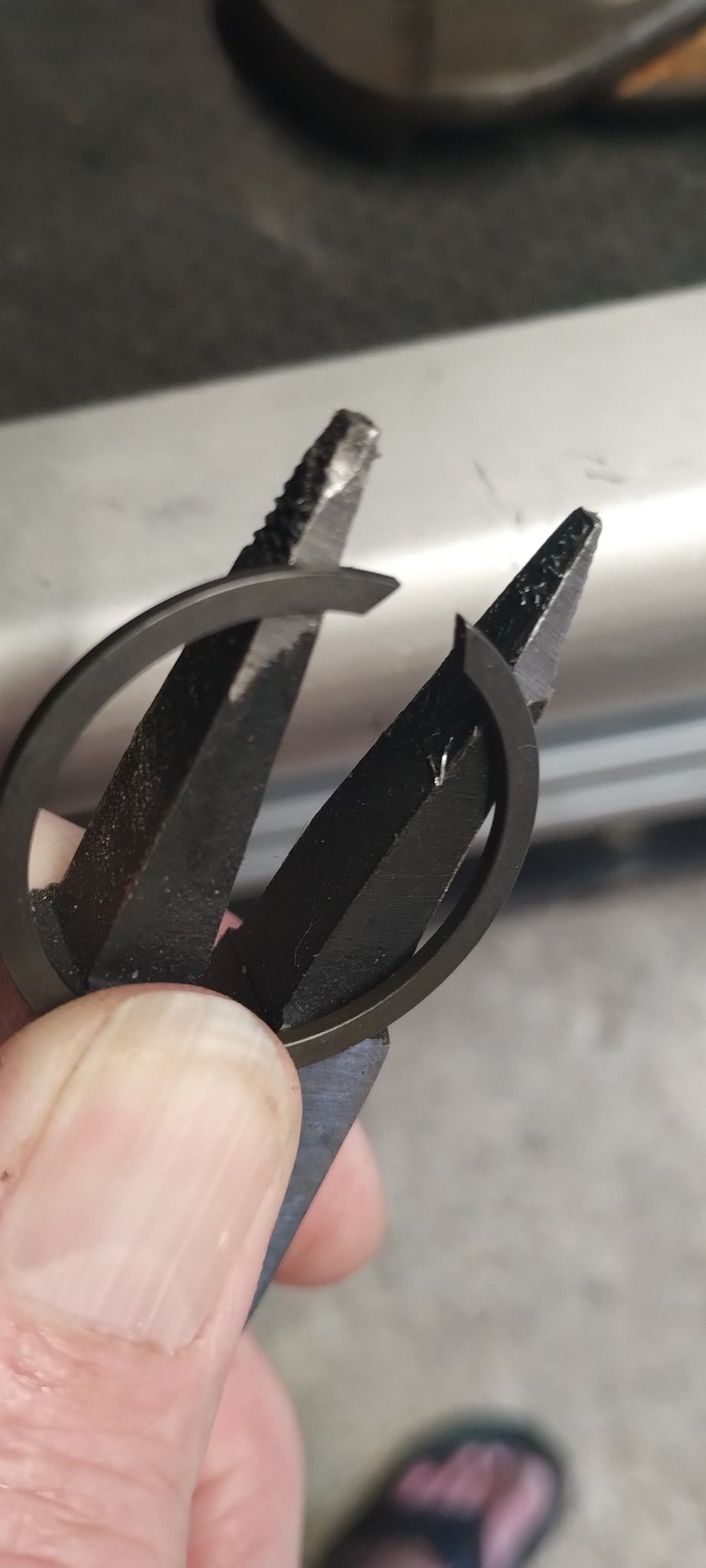

It's not that easy as mine has this very stupid pointy circlips with no holes in em wich are very hard to remove

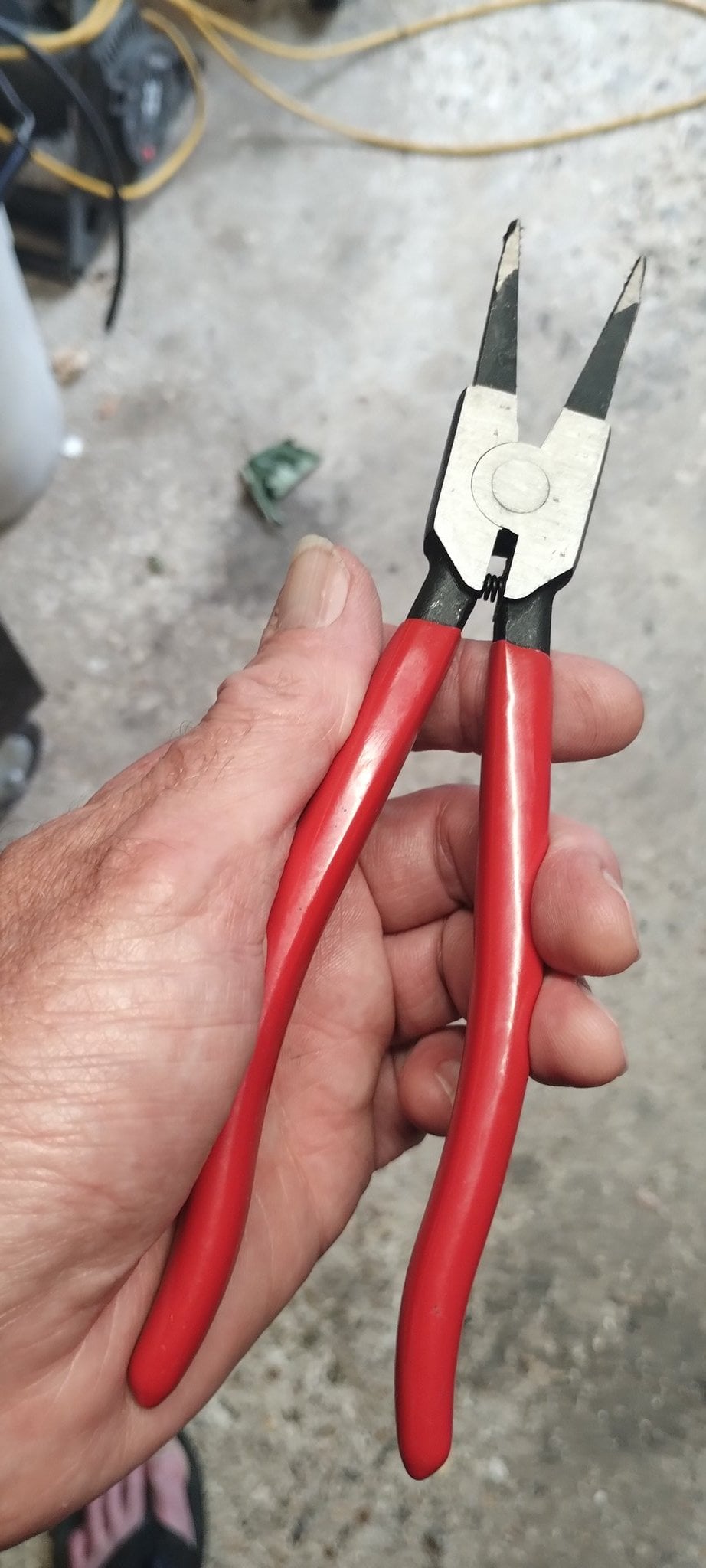

I mention that in the video. The drive side circlip is a different design from the non drive side, on my bike it has bevelled edges which make it awkward to handle. I bought a pair of cheap pliers & ground the tips at an angle to match specifically for the job.

I made a follow up video, closer to the action so you can actually see what I'm doing. Don't get excited, the production values are worse than ever but at least my hand isn't in the way, spoiling all the fun.

Sure. They're some cheapy Amazon or Ebay circlip pliers. I've added the drive side circlip so you can see what I'm talking about. The bevelled edges of the circlip itself tends to make the pliers ping off as you exert force on it, whereas on the NDS, the circlip has a v shaped indentation so that your pliers stay in place. It is a poor design.
If you struggle to remove this in one move, I've found an effective technique is to get one side out of its slot & onto the spindle, where it will stay, then go in for a second try. Once you have the circlip out of it's groove, it's just a matter of expanding it sufficiently to pull it off the spindle, taking care not to mar the thread on the spindle that your lock ring relies on.

Wouldn't know about Shimano motors. Might be something online somewhere. Otherwise, I did this for a friend last week on a Trek with 1000 miles on the clock & the drive side seal cover had separated from the metal inner, so worth checking regularly imo.
