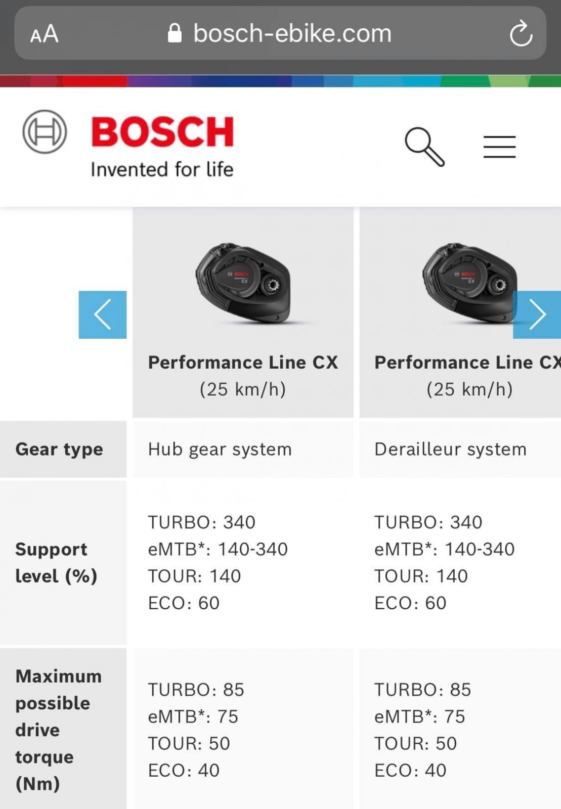

Looks like it only gives max power in Turbo mode;
IMO this is a good thing; it means that for most of my riding range won’t be adversely affected as I mostly use EMTB.
