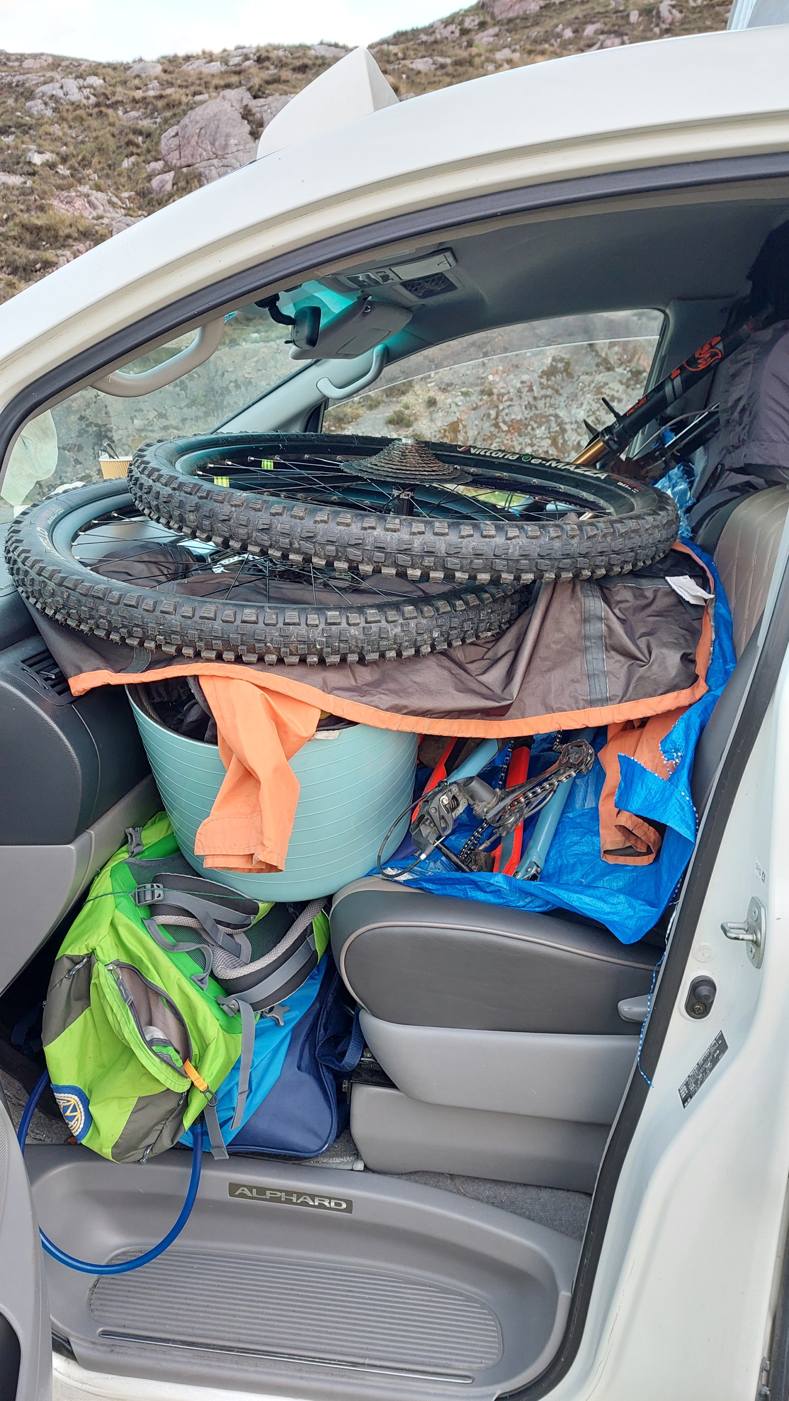

If it's inside it's safer , nobody likes leaving a expensive bike on show. Just tried this tonight for first time in camper.

Binhill, if I broke into that car and saw that pile of parts, I'd just walk away. Too much work for a lazy thief. :ROFLMAO:
Haha Aye but I was in the bed sleeping I can take in back but cramped tried that for a change .Only had van 7 years every days a school day. Oops just remembered the roofs still up.
