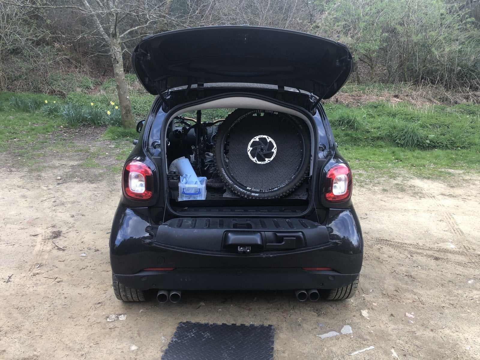

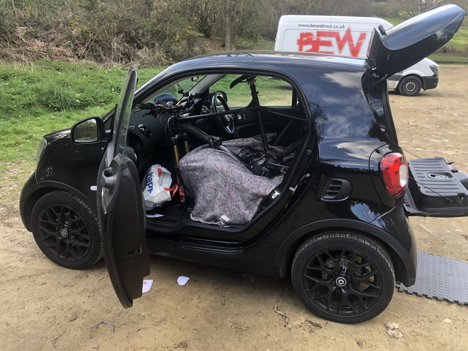

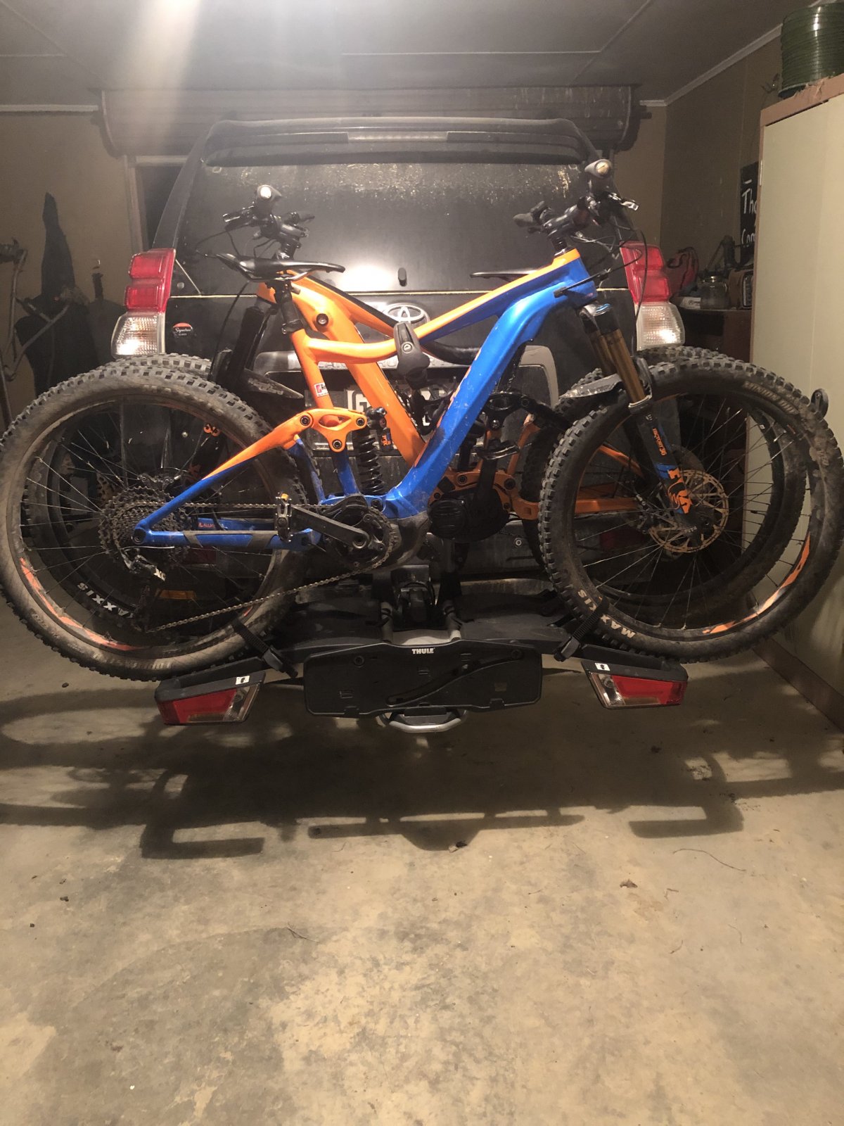

This is my rig

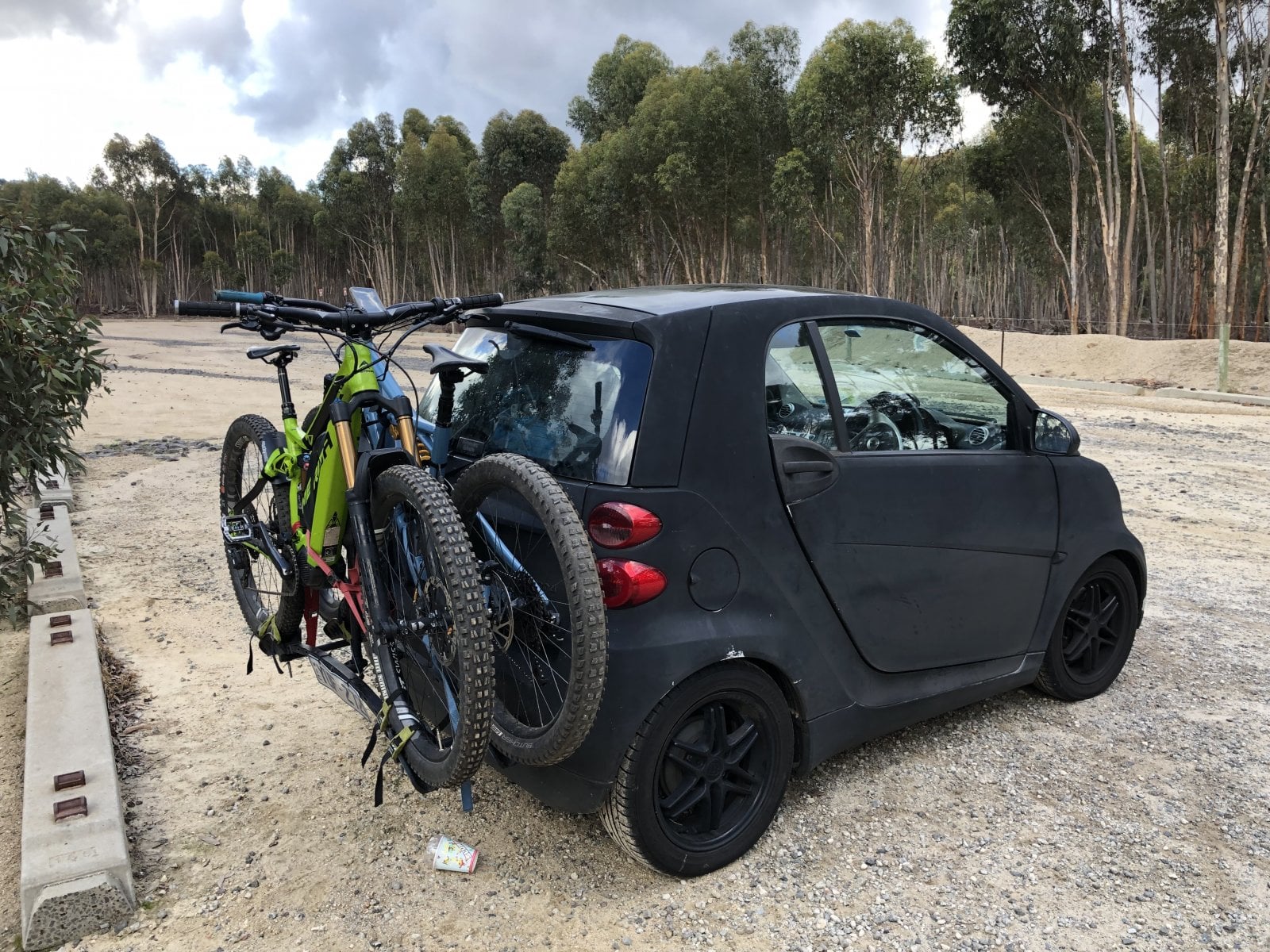

Are those things even type approved for a tow bar?
9,190

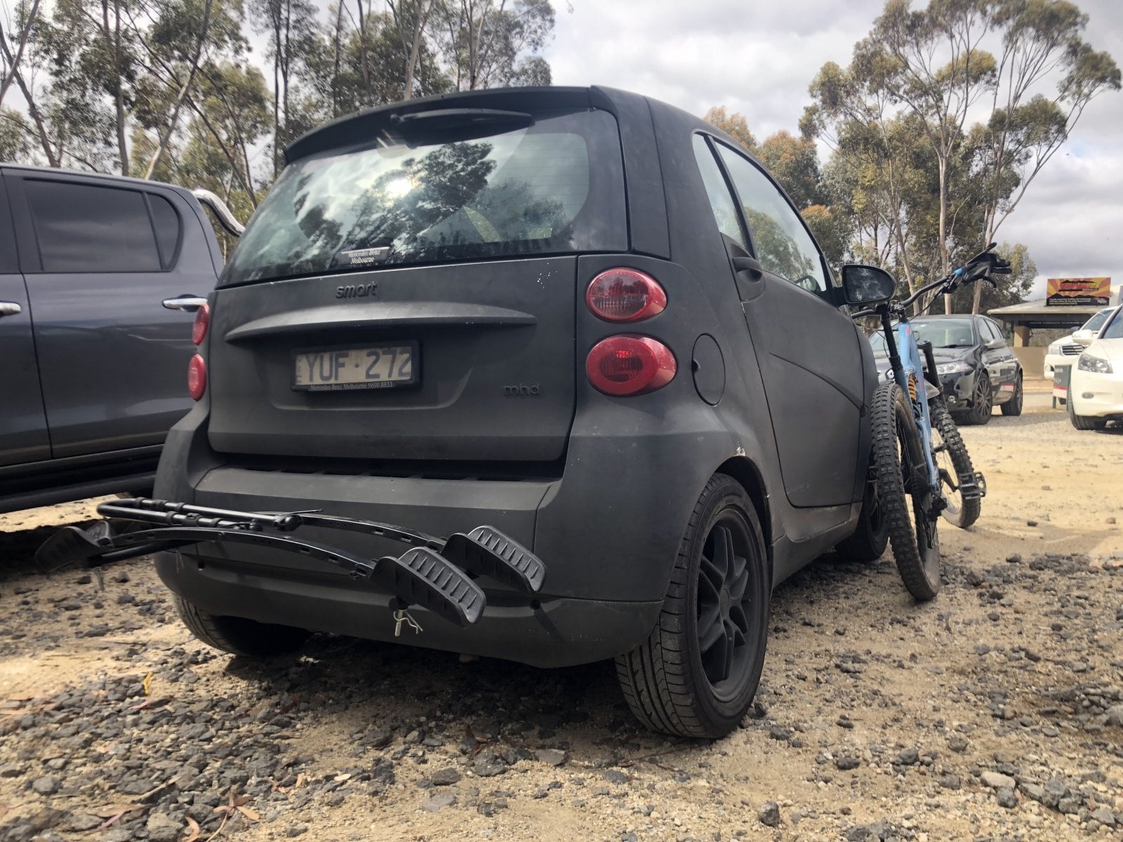

You can’t fit a tow ball or hitch, but there’s a company who makes a bike rack that attaches directly to the chassis.

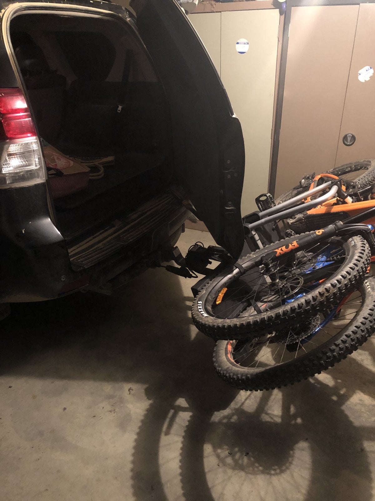

There is a tow ball kit you can buy from Germany that replaces the whole rear support bar which has a square hitch built in.
As for mine I tie a strap back into the car around the cargo blind. That takes up the weight of the bikes! I have stood on each bar and the whole car moves with me so plenty strong

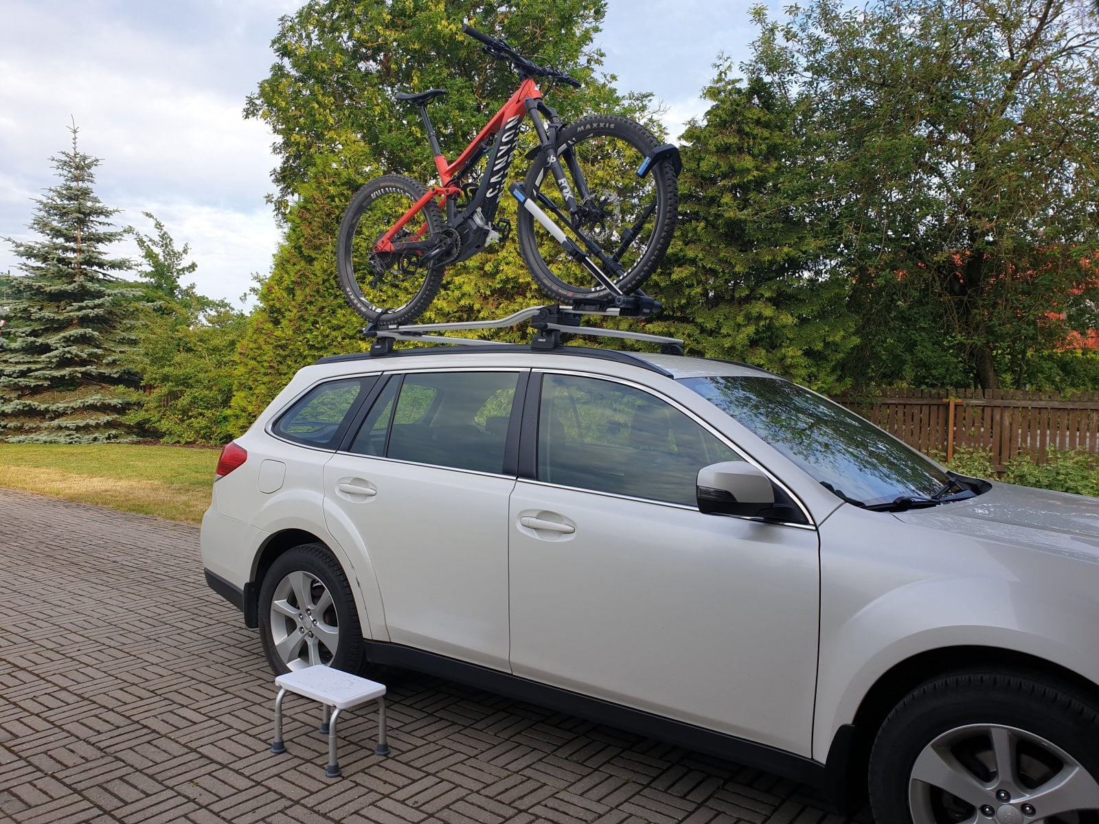

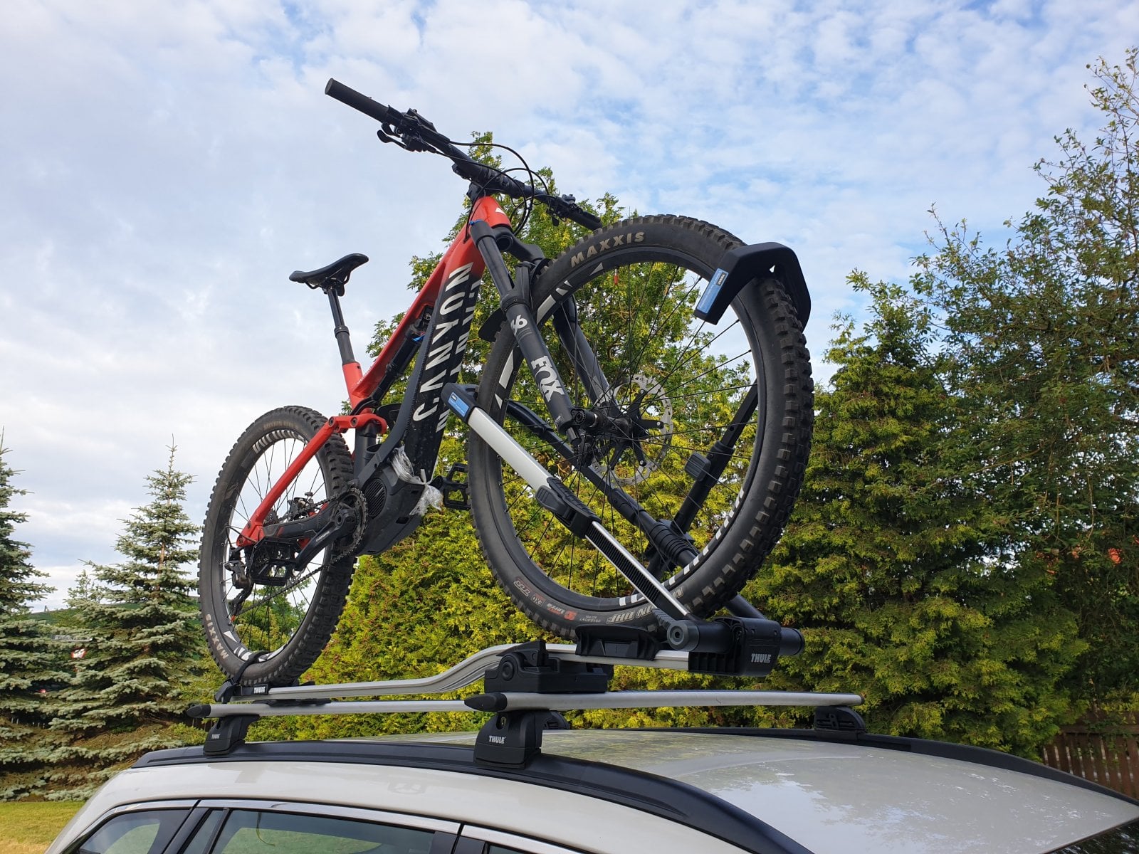

That's my solution with Thule racks. The bike goes up without the battery and small chair is needed to lift it up straight. I use plastic to cover battery contacts. The bike without battery weights 20kg so just in the limit of the rack maximum allowed carrying weight.
View attachment 15514 View attachment 15515
I have one of these (Thule Upride) for my Cube with integrated battery (fat down tube) and another Thule 598 for the missus' Haibike with external battery (down tube fits the 598 downtube clamp, whereas the Cube's is too big).
I don't need a chair to put them on the roof and I find it ok to lift them there. The Upride wobbles and creaks a bit, but both seem pretty secure. My Cube is probably 1kg over the Upride limit without the battery but both bikes are within the roof bars'/car's weight limit.

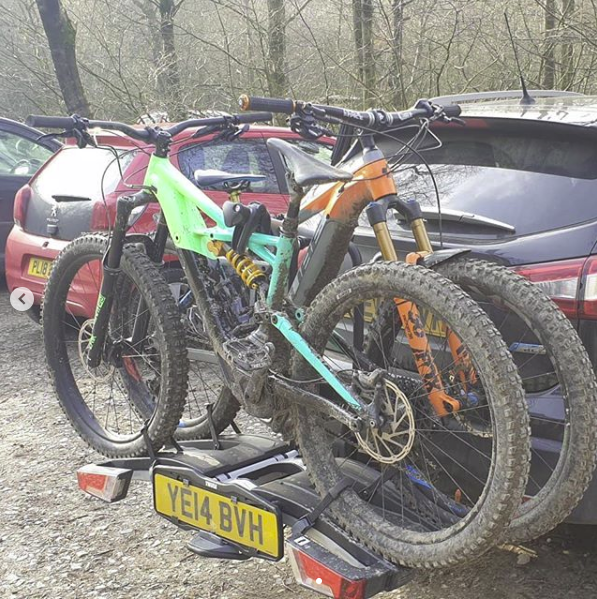

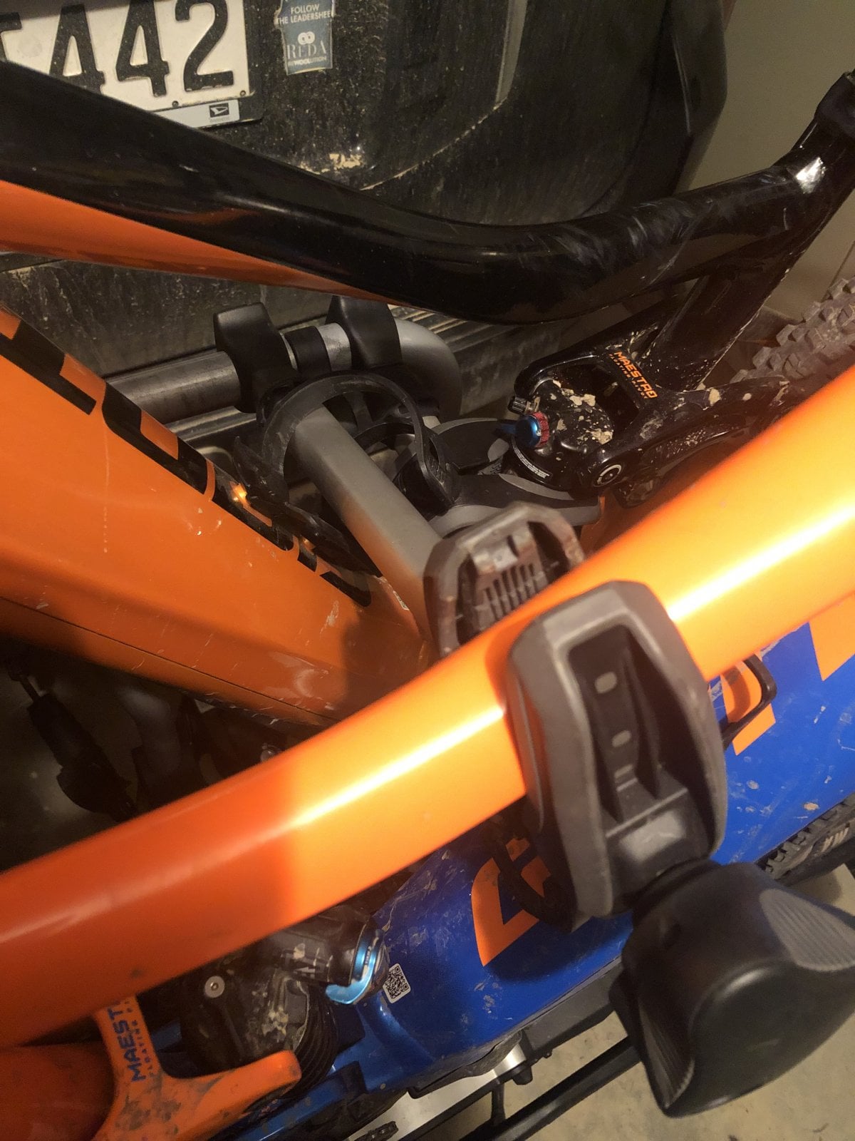

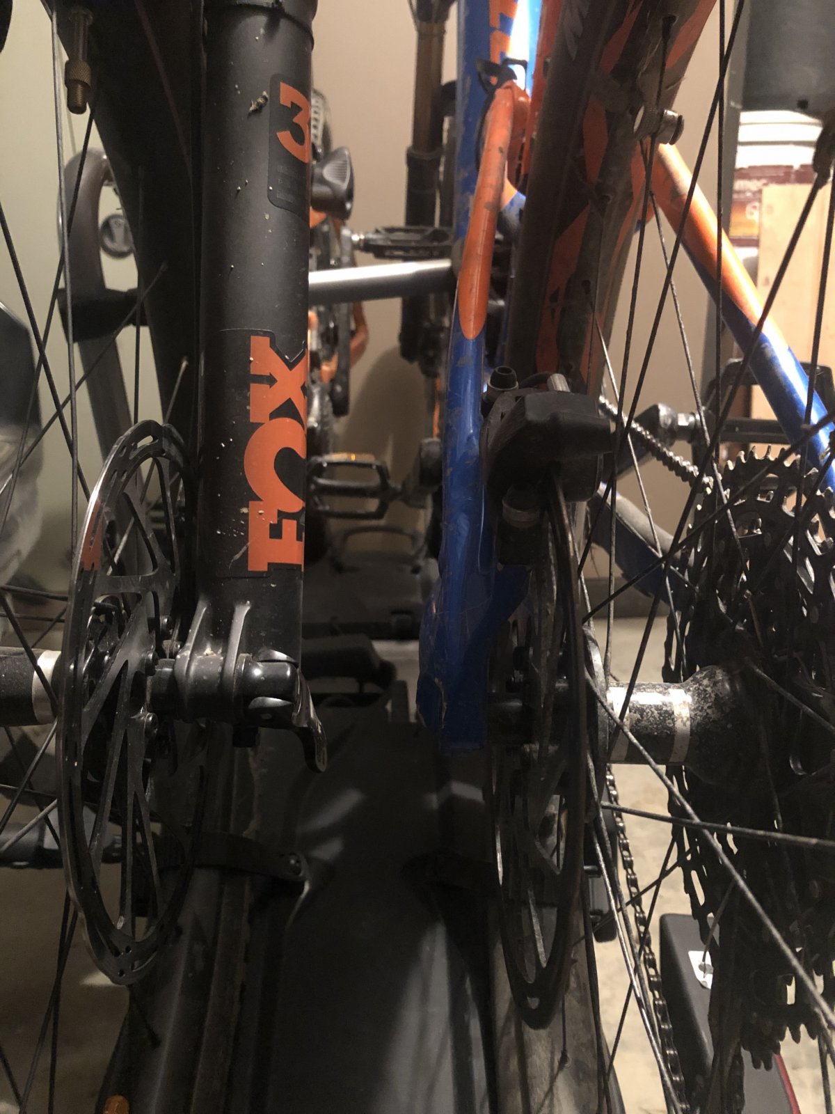

After much debate I got a Thule 932 EasyFold, i still have some learning to do to get the best setup , so far I have the medium frame bike on front and clamp on the shock, and the large frame bike on last withe the clamp threaded through the bottle holder of the front bike, I found it hard to find a good spot for the clamps where the bikes won’t touch each other. I did try a ezigrip ( same as buzz rack) but the clamp wouldn’t reach the large frame top tube. Also looked at yakame hold up but was tight on length and my swing boot wouldn’t work as well. There doesn’t seem like many racks are rated for a couple of ebike.
