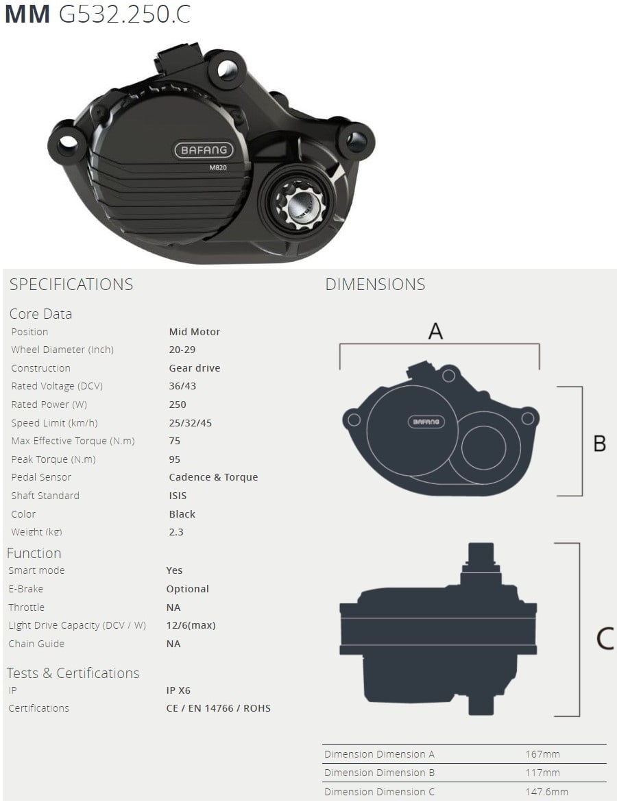

Hey, i'm here.
First, we will develop a frame that uses M820, but the battery also uses Bafang's battery, as for our own battery, it takes time.
the standard battery for M820 is BT F04, 410wh, 43V, about 2.6kgs,
A spare battery site will be reserved at the water bottle cage, but spare batteries may not be provided, and buyers who need it will buy it by themselves
the EMTB frame fit for M820 will not the big travel 150-160mm, only about 130mm in our plan, this model not fit for enduro EMTB, the MAX effective torque is 75Nm, and 120rpm.
rear shock will be 185*55 trunnion mount, also accept the rear shock with piggy back design and coil design.
now only one question ,It is difficult to remove the battery BT F014. Once the battery has a problem and needs to be removed, it may be necessary to remove the motor first.

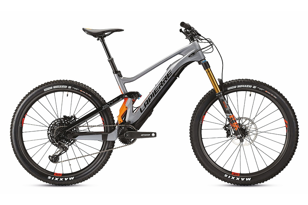

Jim, look at the Lapierre EZesty geometries, fantastic trail / light Enduro bike from a very reputable manufacturer and a bike you should consider as your competitor market leader.
As to 130mm travel, it’s far easier to fit travel restrictors in the shocks than to try and eek out another 20mm once the frame has been designed. 150mm is now the norm for even Trail riders. 130mm though is good in the smaller sizes but give the owner that option by designing 150mm.
170mm bikes are ridden by the wanna be downhill boys and are a different category. I see them on the trail and wonder why you would want such a high BB and slack geometries taking all the fun zippyness out of the trails.

150mm is the next vision, if we can solve the problem of battery, BT F011 now is hardly get it, we can not choose one battery which buyer can not get it in market, so maybe we will make our own battery,
but now in china only Bafang have the battery with 43V, most are 36V and 48V, make a new battery fit for M510 is easy, but battery fit for M820 is hardly.
we will try again.
we will try again.
Use 36v motor than it's easy to make custom battery.

The size of the battery box is limited. If you use 36V, the total capacity will be very small. In fact, it is said that the 43V motor and battery work well in actual use, although everyone is not used to the 43V voltage sign.

I remember in your forum, someone used an M800 motor mounted on an enduro's EMTB? But the effect is not very good.
M800, the max torque output is 55nm, now the peak torque of M820 is 95Nm, do you think the power is enough for 160mm travel?
Jim don't fall into the trap of longer travel means more enduro or downhill bias. 150mm travel on a trail orientated frame means probably 40mm of comfy float through the corrugated trail bumps and the other 100mm would be used on the bigger steps and the likes a trail rider would encounter.
Geometries though dictate how the bike feels, most trail riding will be in single track where you want zippyness, manouverability and feel for the trail, all at slower speeds, everything a down hill bike doesnt want where it just needs stability at speed and strength to take the big jumps and hits.
60Nm is all you need for a trail bike, the Rise is making real marketing gains and yet it is a full weight motor just limited to 60Nm to ensure a better range. I don't get that philosophy where your average rider can simply not go into the more powerful modes to ensure range. To me the whole concept from frame weight, motor weight, smaller battery, smaller and lighter forks, all come into the equation. Does that mean your frame has to be around 2k in weight, probably.
Psst please look at the Lapierre EZesty geometries, an incrediable and very underated all rounder.

Oho, I know the frame you said,
this model is perfect, but the motor is Fuzua, the small motor, so can makethe RC is only 435mm, if use Bafang M820, hardly to so short length,
