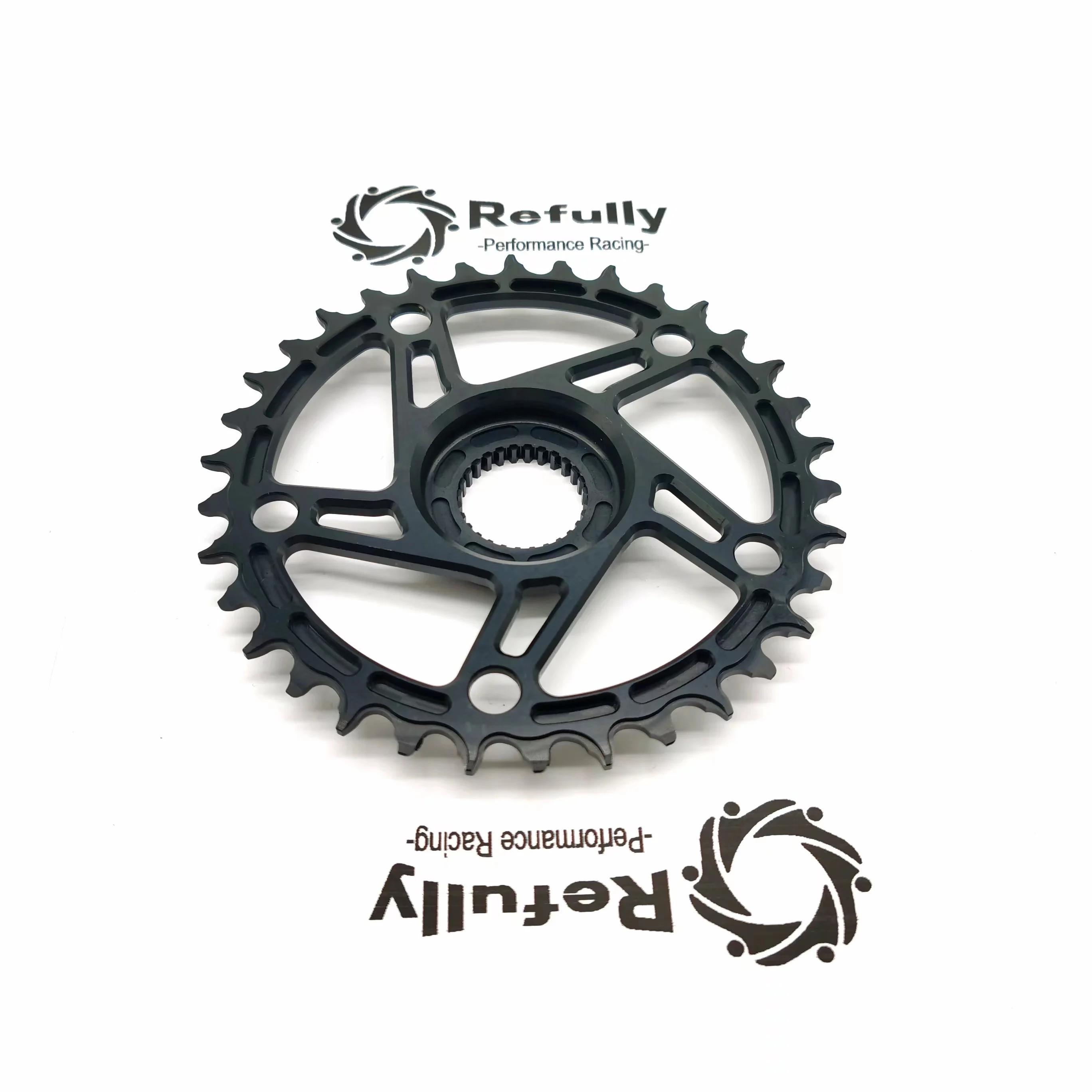

And the same chainring. Whole thing is made from steel, including spider and teeth. It weigths 260g. The matt part is just a plastic cover. It looks to be overmolded.

We can easily save 100gr by replacing it with that kind of spider I guess: https://www.bike24.fr/produits/417588
Edit: or just use this and save almost 200gr

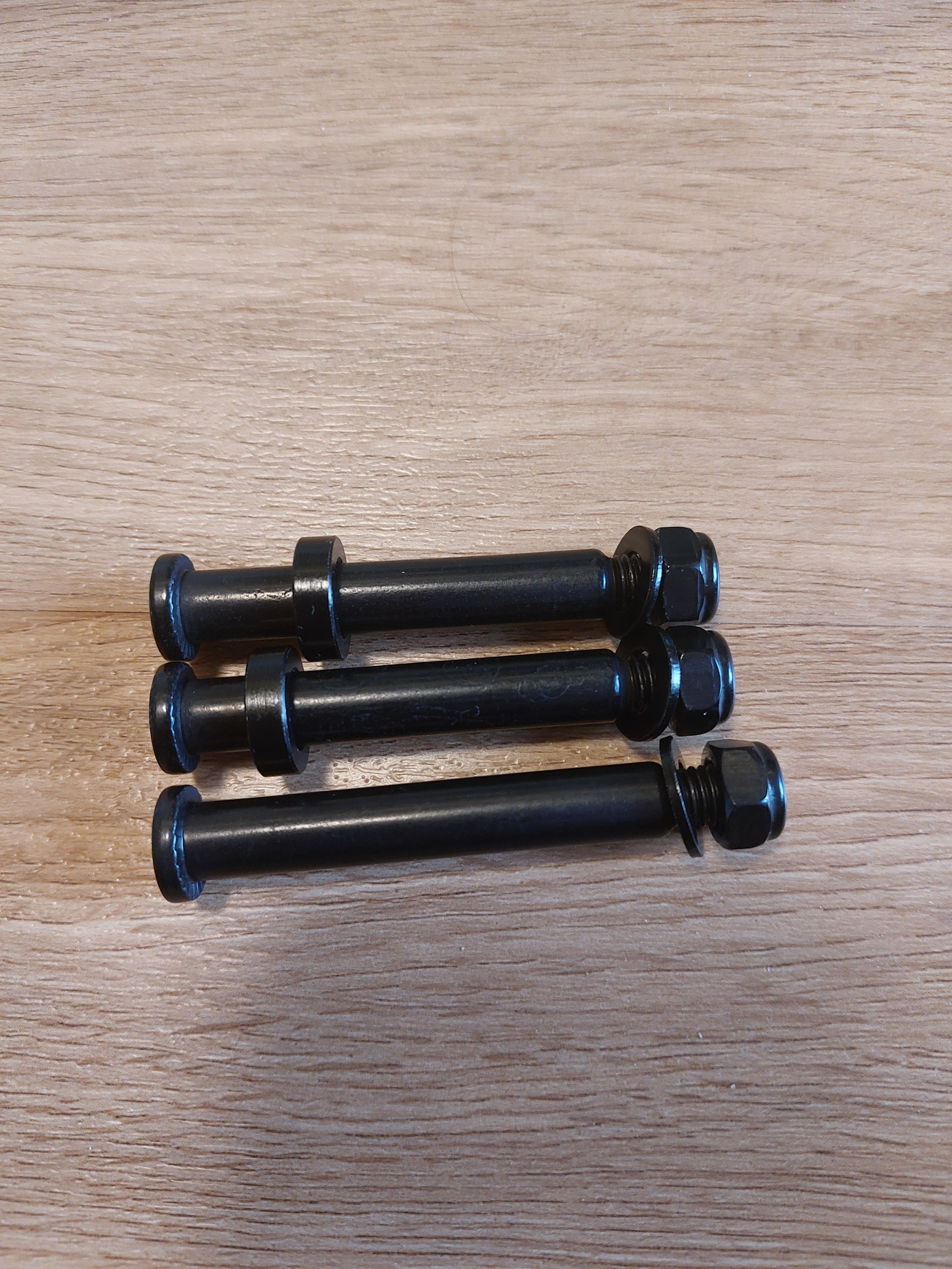

One question:
I received these three motor mounting bolts. One is slightly longer, and two are shorter. Also, there are 3 washers and only 2 thicker spacers. Is this correct? Only 2 thick spacers?
That spider looks reasonably priced. Are you sure, that Bosch gen4 cainrings will fit?
I will probably use the stock one, and change only if I will need different gear range.
I rode a Bosch this weekend and I'd say it's the same offset, but I did not measure anything, only a feeling :)
