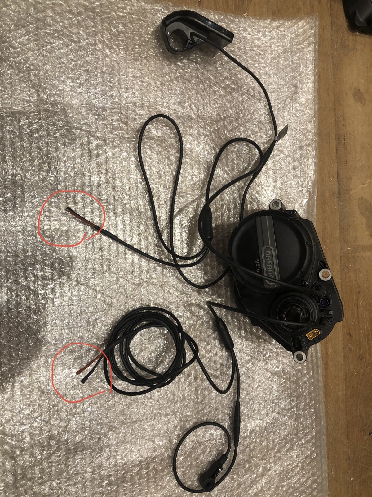

To get this thread back on track, does anyone know what the connectors circled in red are for? Came with my M510 kit.

But that front light cable is useless as gives only 2.5W! Come on Bafang!
I am verry thrilled about that M510 v3.2 - it behaves really great, like Bosh, plus much more power. ;) On Pass 1 with heavy pedalling during acceleration getting 450W.
Still run motor recalibration without chain after new firmware - it can help in smoothnes.
