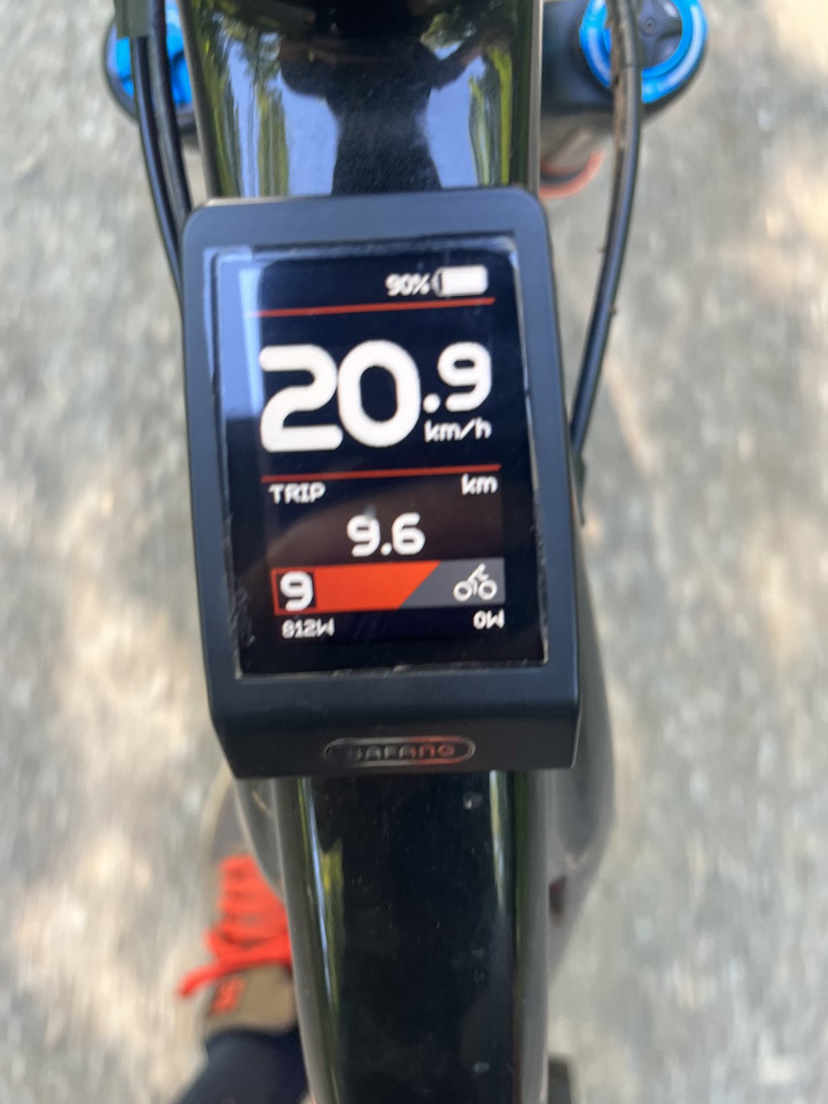

Short ride with the new Firmware. Very good improvements. The engine finally responds to the pedal pressure. In level 9 you can control the power between 200 watts and 840 watts. You can now drive off without a BAFANG minute of silence and it seems to me that the engine is also quieter. No problem with the voltage display because I use 52 V batteries. There will be a longer exit tomorrow for confirmation.

Short ride with the new Firmware. Very good improvements. The engine finally responds to the pedal pressure. In level 9 you can control the power between 200 watts and 840 watts. You can now drive off without a BAFANG minute of silence and it seems to me that the engine is also quieter. There will be a longer exit tomorrow for confirmation.
Thank‘s @Rob Rides EMTB you saved me the weekend 😁👍
No problem with battery indicator in display?

Made a longer ride with steep climbs today. The engine is definitely quieter and doesn't get as warm under load. The best improvement, however, is the now working torque sensor, which now works like the Bosch E-MTB mode. The speed is also displayed more precisely, with the 3.1 firmware it was always 3-4 km/h too much. The voltage display also seems to work, the only unusual thing is that it shows 100% every time it is switched on and only shows the correct value after a few minutes of driving 🤷‍♂️ The max power is over 800 watts 😁
