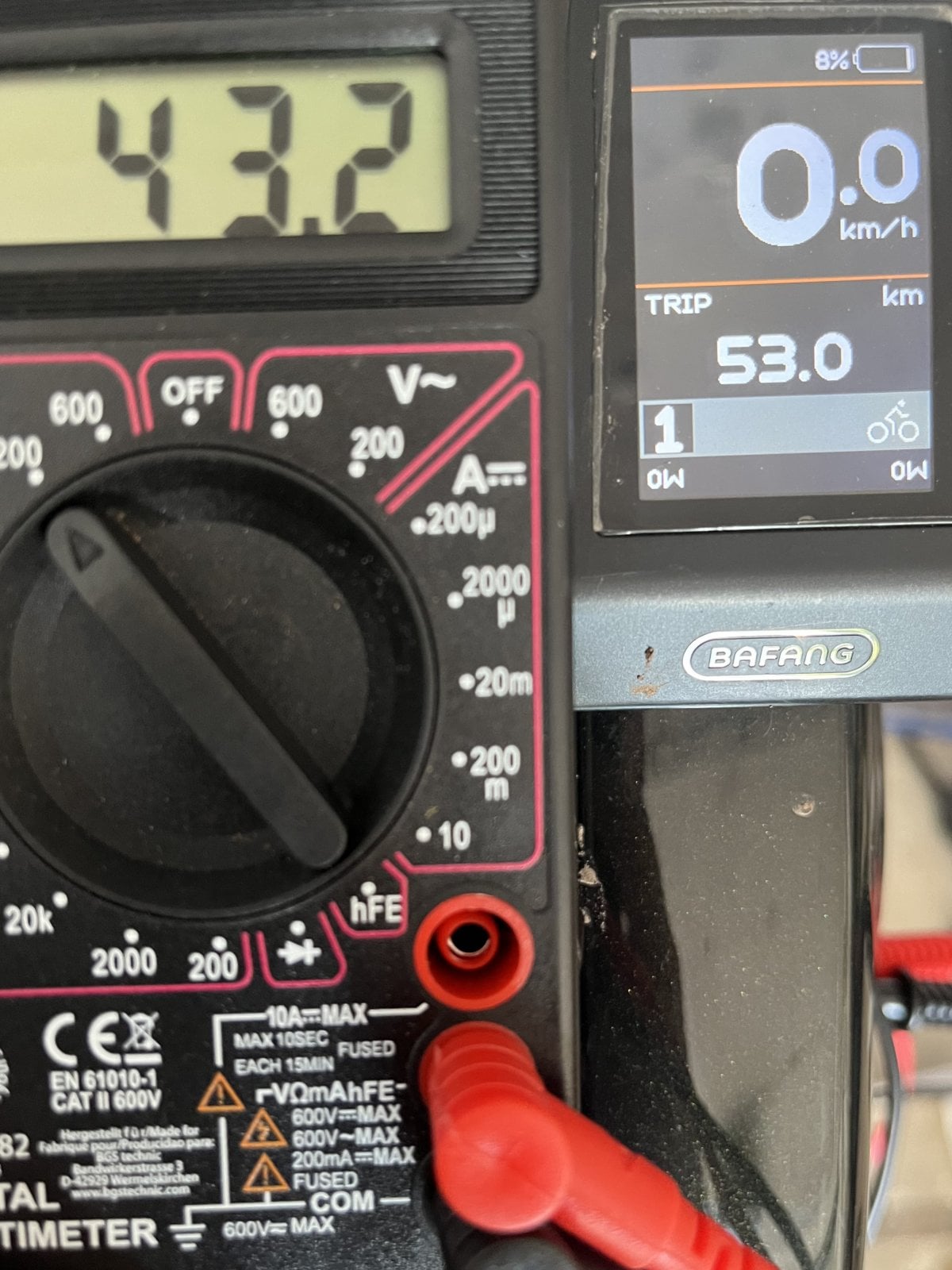

Mine cuts out at 8% and 43 volts 🤷‍♂️

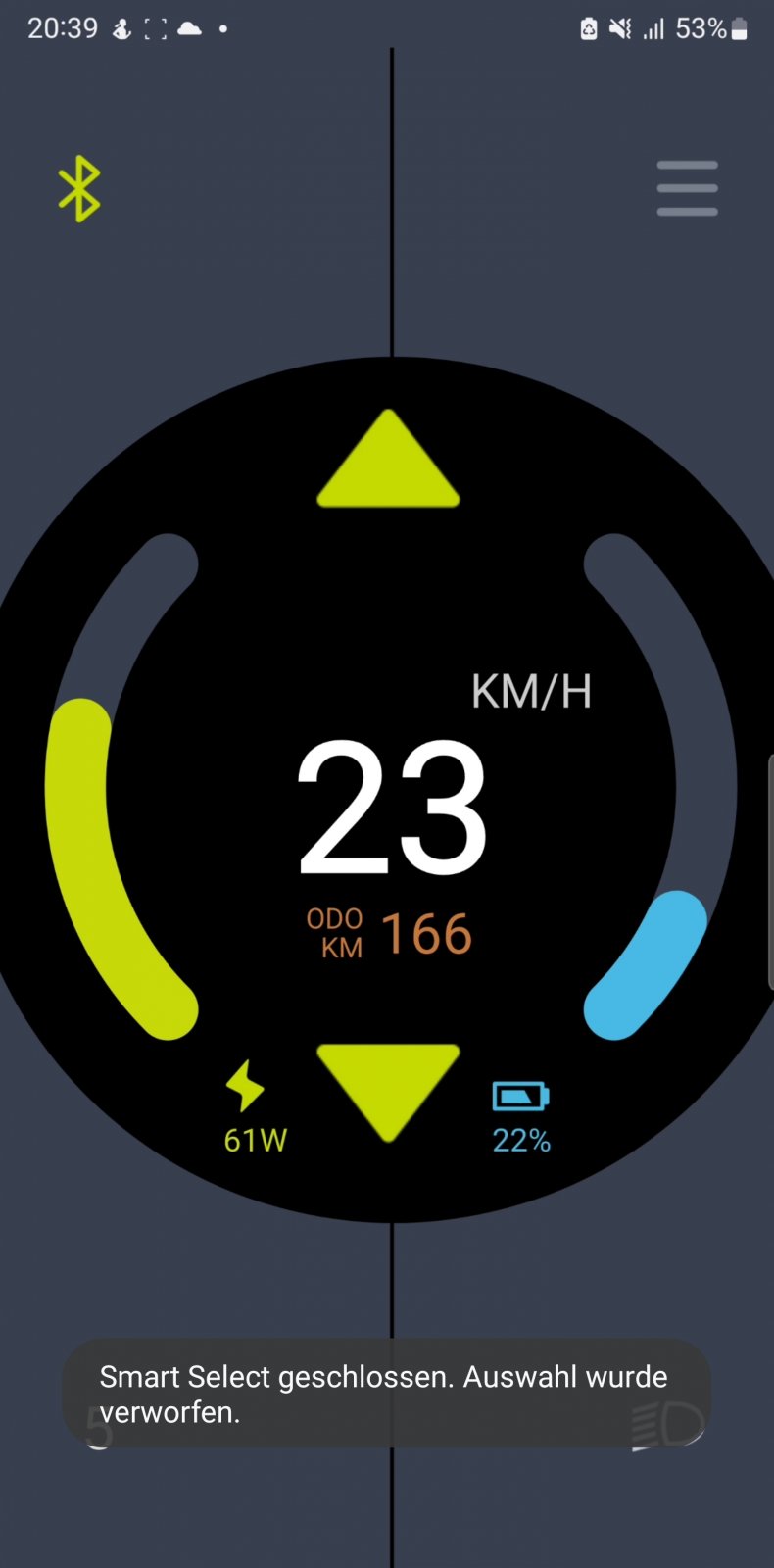

Guys, unbelievable, it really limits from 10% !!! To around 400W. At 5% it is 220W. So bafang has listened to users? I think we just have christmass. ;))
But still very high cutoff, when I measured voltage at 5% it is 47.7V with no current. Too much. Then you leaving too much energy in battery. I dont care if Bafang wants to save cycles in my battery. User should choose how deep he wants to discharge. Like on Uart motors.
And down to 10% it took in peaks 740W!
Full charge and showing 73% - there is some bug.
Will check tomorrow with full batt and maybe will record a video "M510 - Will it burn?" ;))

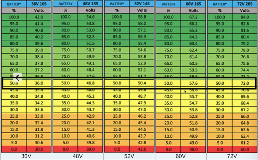

How hard is to make mapping from voltage reading to %SOC? Also developers didnt notice it?
Doesnt 74% SOC match to 14S system, when charged to 54.5V ? That would explain.

I think this is what they do. I mapped the SoC to Voltage multiple times, please refer to my earlier posts here. With my current firmware everything is fine. And yes, if the firmware is done for 52V and wrongly documented, this would explain the behavior!

Fully charged 48V battery have 54.6V and thats 13S. The fully charged 52V 14S batery have 58.8V, just for record.
Yes. Thats what the firmware name is telling, 48V and 14A.
Check the output amperage (for example on display during full power output, just note the max values). Commonly the higher voltage means lower amperage, so its worth to check the firmware is not weaker than standard 48V.

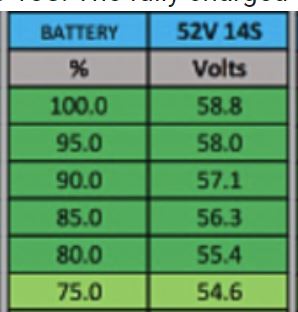

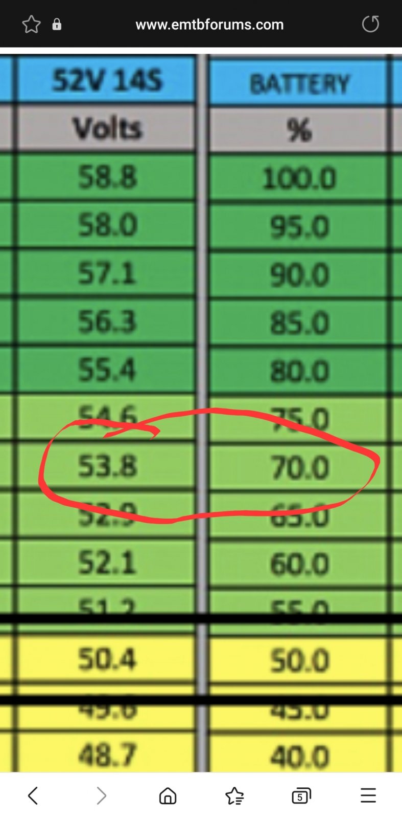

to me bms is set to charge up to 54v according to the table it suits, it shows me 72% of the battery.

So then it explains, it match to 14S system.
Firmware is good, behaves really good, go ahead to flash it.
Thats just a bug of programmers, they didnt change some hardcoded value to 13S in firmware, so it just shows wrong percentage.
Just then also cut-off voltage will be 4V higher. This is the reason why I was getting 740W even on 13% SOC.
If this is 14S firmware, with 13S firmware it can be again 1 or 2A more. Today with fully charged battery I was getting up to 840W! ;)

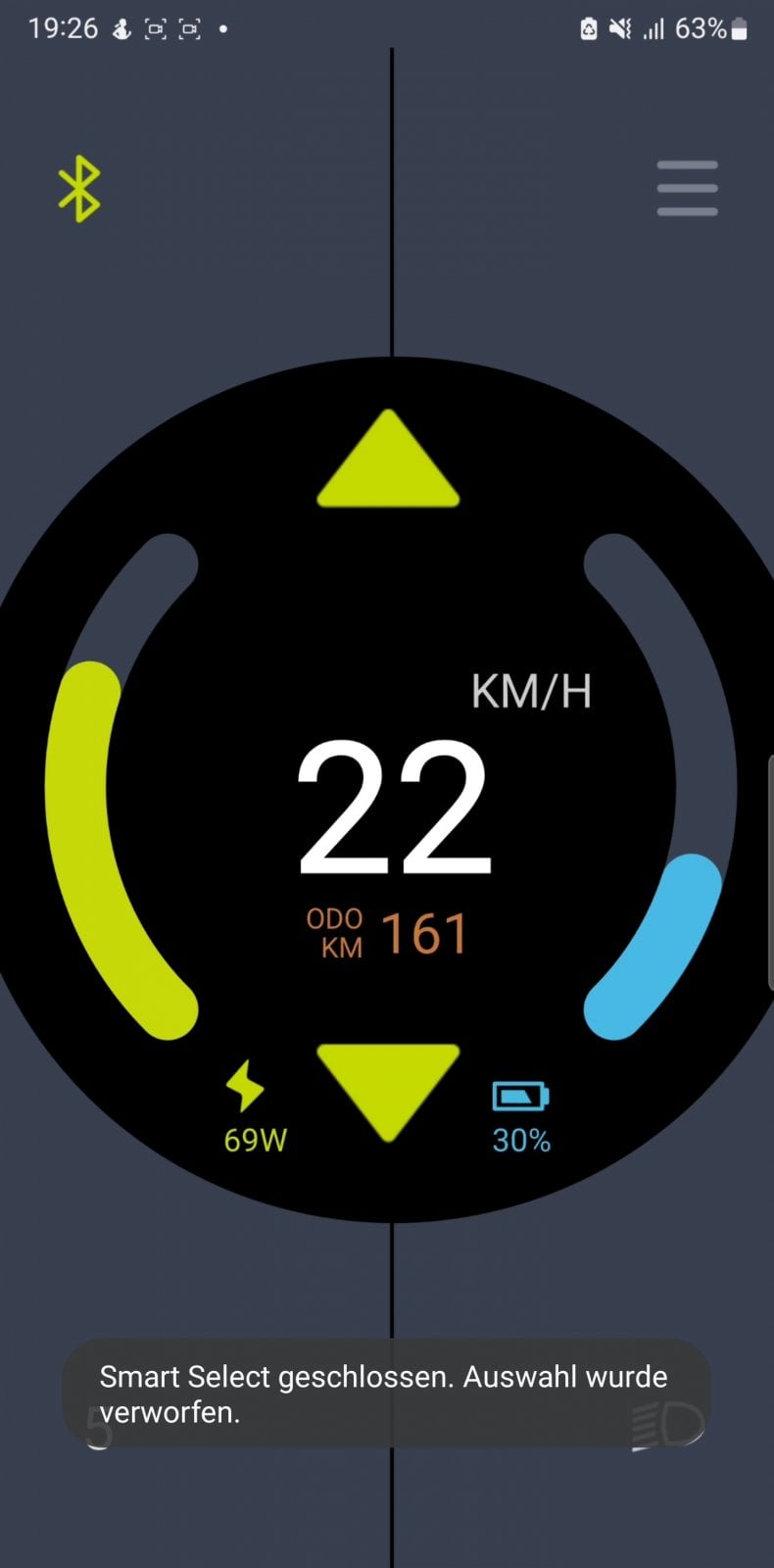

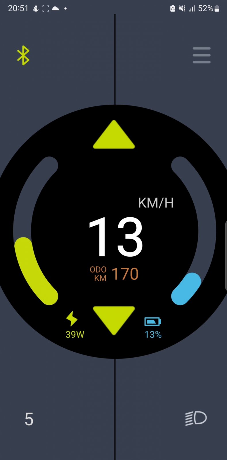

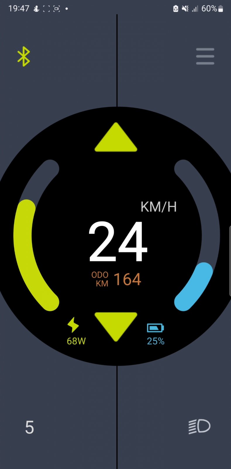

Maximum power I got on level 5 according to the following battery status:
30% 690W
25% 680W
22% 610W
13% 390W
Motor: Bafang M510
Firmware version: CRX10NC4814i101003-1-cs-28-2230-boot3-0-20220517161110-48v-M510

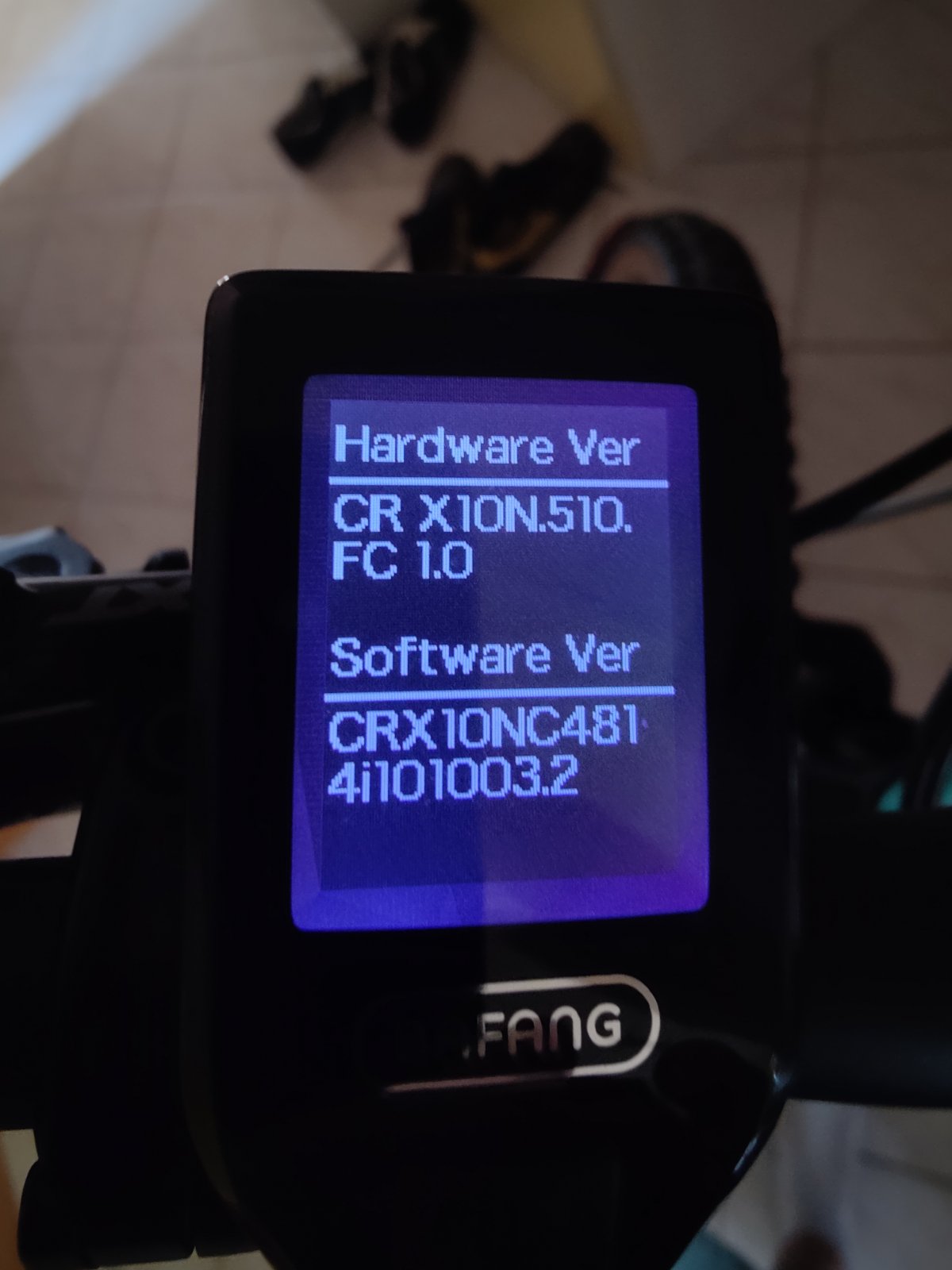

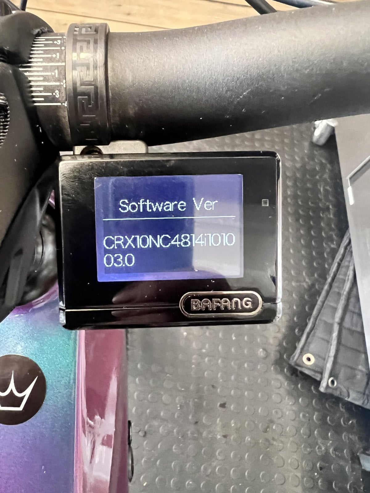

Hi, I did actually try to update it, but I'm not 100% sure the update actually worked. Here's my software showing on the display, which looks like 3.0 (not 3.2), if i am reading this correct?
Hello Rob
Looks like didnt flash. Try again, it should work.
3.2 is Ok, just you wont get all the juice from battery (firmware is setup to 52V battery).
If you have contacts there, can you ask them for 48V firmware and report the bug, pls?
