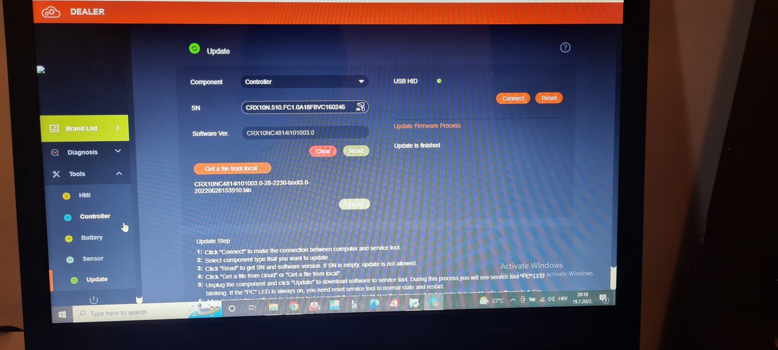

So last firmware (48V v3.0 date: 20220628 )is not uploading for me with my motor. :( Rob, I guess you will be now able to upload to your motor. Finger crossed.
I can definitely upload versions 3.1 and v 3.2. What a mess. ;)
Mine can't update too, Bafang oh Bafang :D

Which means bafang can have 2 different microcomputers used (or some change on PCB) and you need to have correct firmware compiled for specific board/chip. This first byte can determine what firmware u wanna flash, if does not match with hw, controller will refuse to flash.

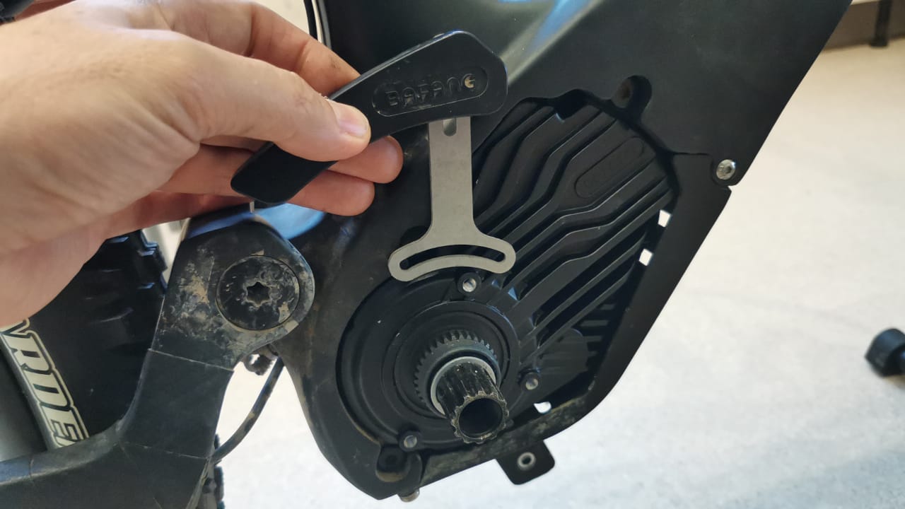

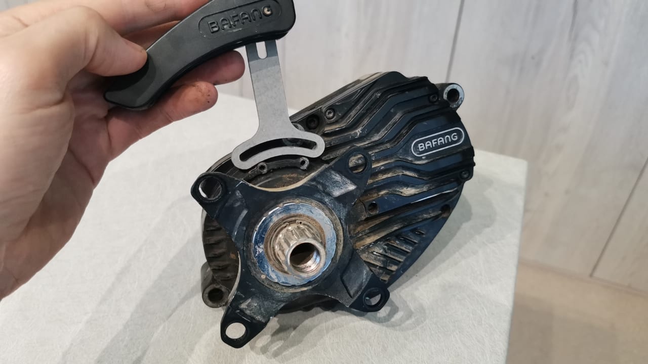

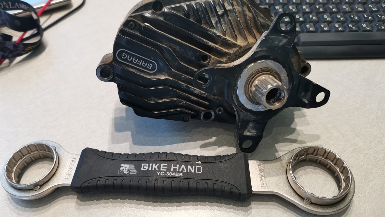

LAnton
May 12, 2022
558
467
Russia

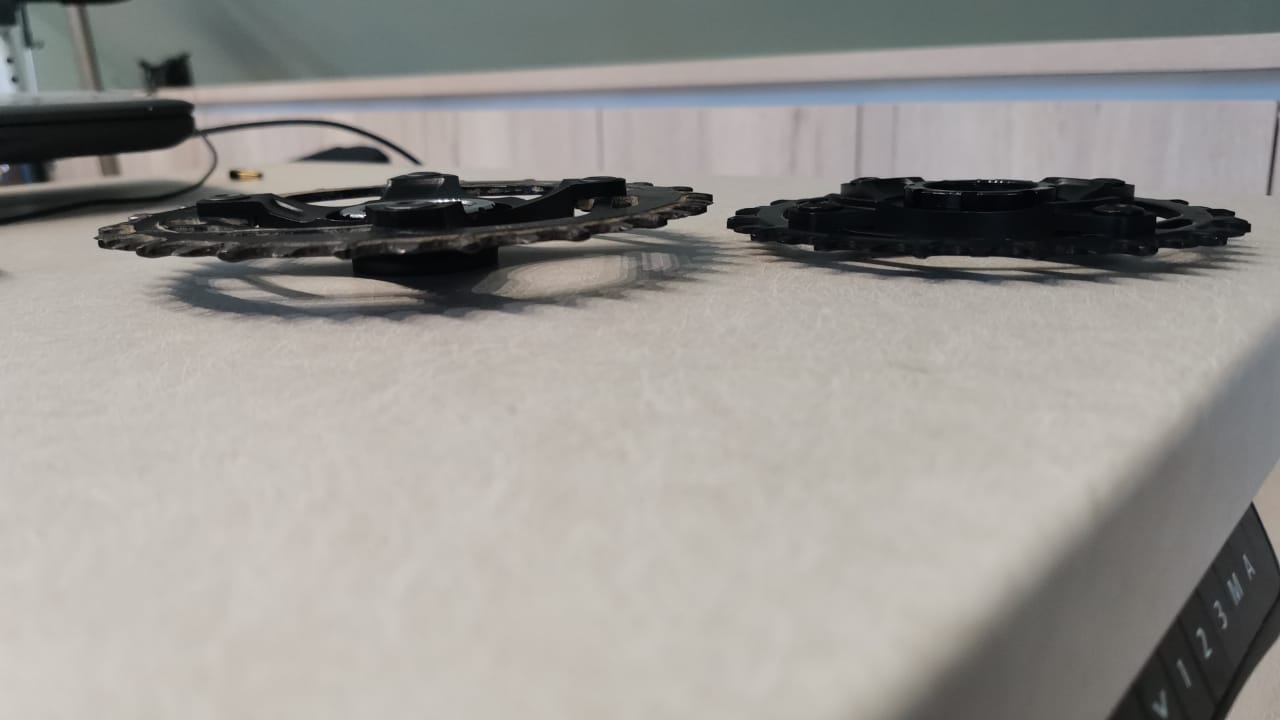

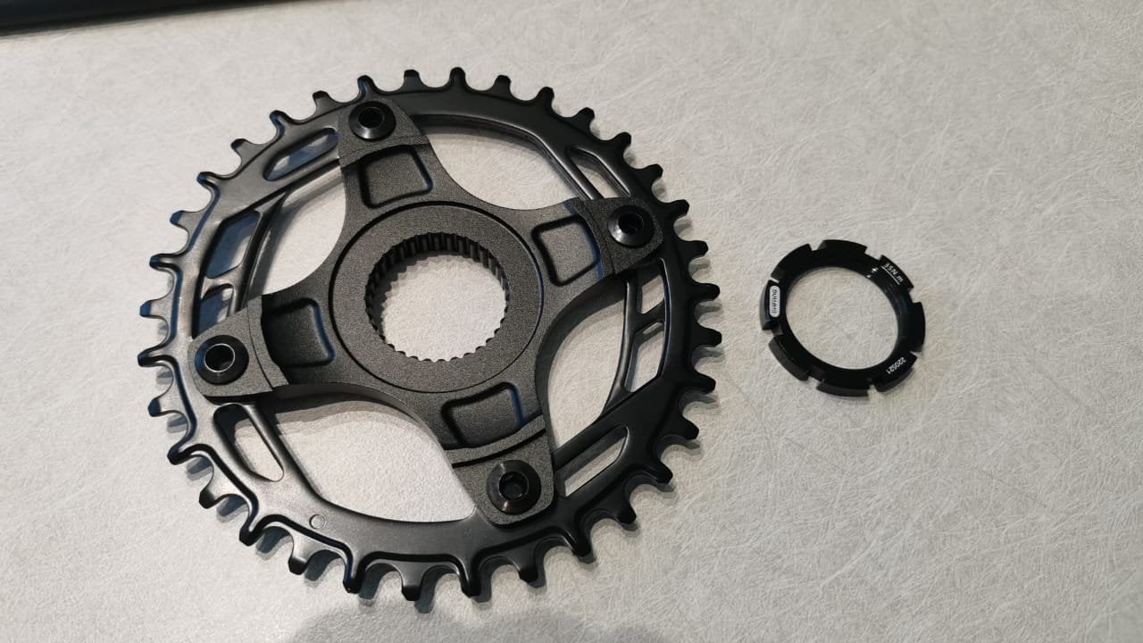

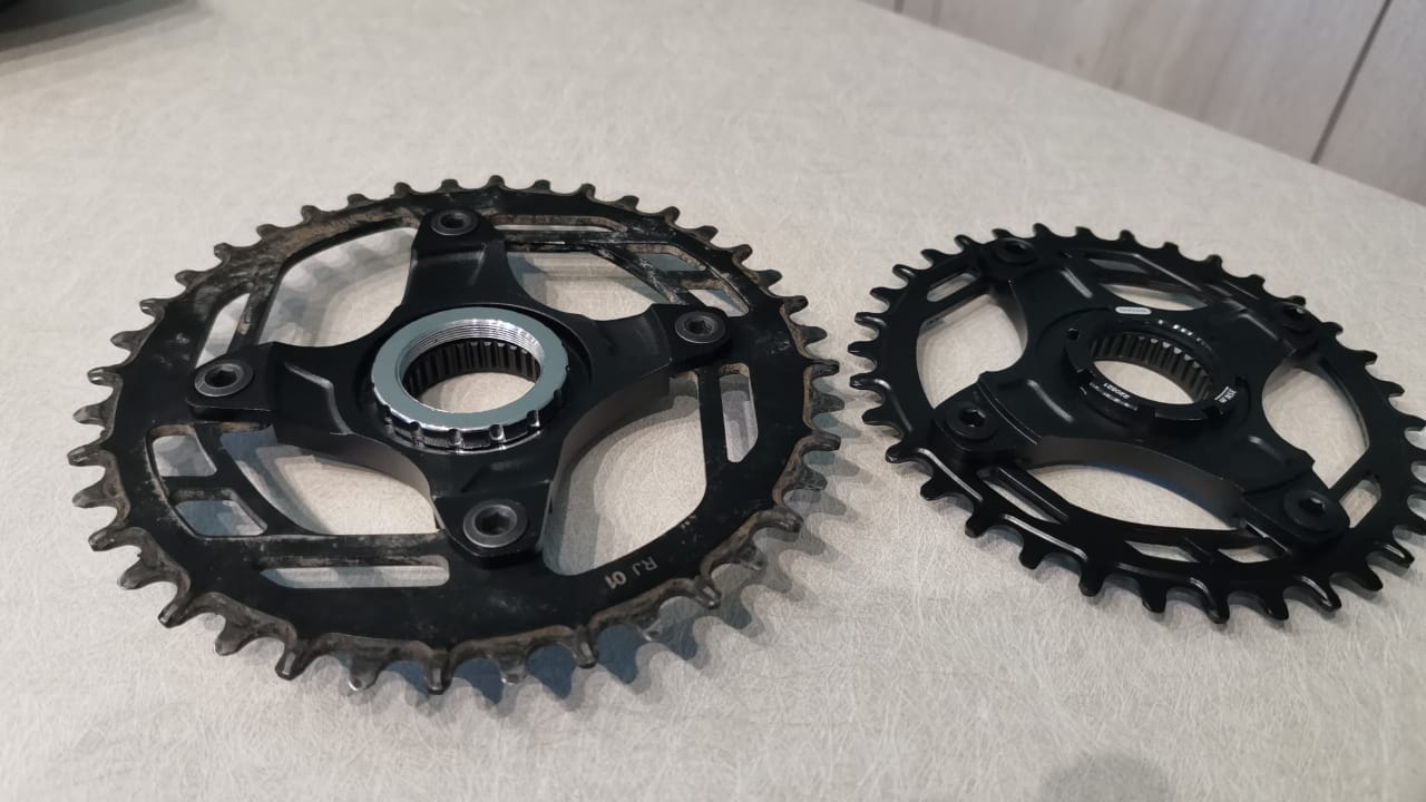

I found the differences between the M510 and the M600. The M510 spider is moved closer to the carriage.

Russia
Sorry guys, but this Thread is named "Bafang m510" so here should be discussed the new motor. Posts regarding the old m500 should be placed in a different thread to not mess it up ;)
I'm just writing about the M510. Well, I bought a complete set, not just the motor. I have an old M600. I'm comparing the M510 and the M600. Otherwise I wouldn't have the necessary details.

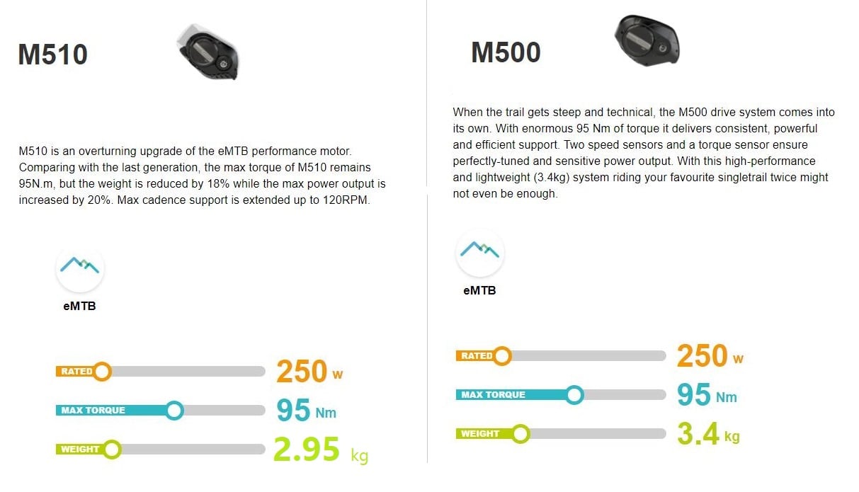

Maybe this key
M510 and M500 and M600 have the same dimensions,M510 VS M500, not only one weight (2.9 kgs vs 3.4kgs ), The main difference is the instantaneous output power, M510 can be 120NM, but M500 only 95NM,
M510 48V can fit for battery 48V and 52V (Bafang‘s engineer said). because the new battery BT F25 all are 52V, no 48V again,
@LAnton is right, chainring, some nuts different from M500/M600. so if u buy M510 kits just put all the accessories kit with it.
