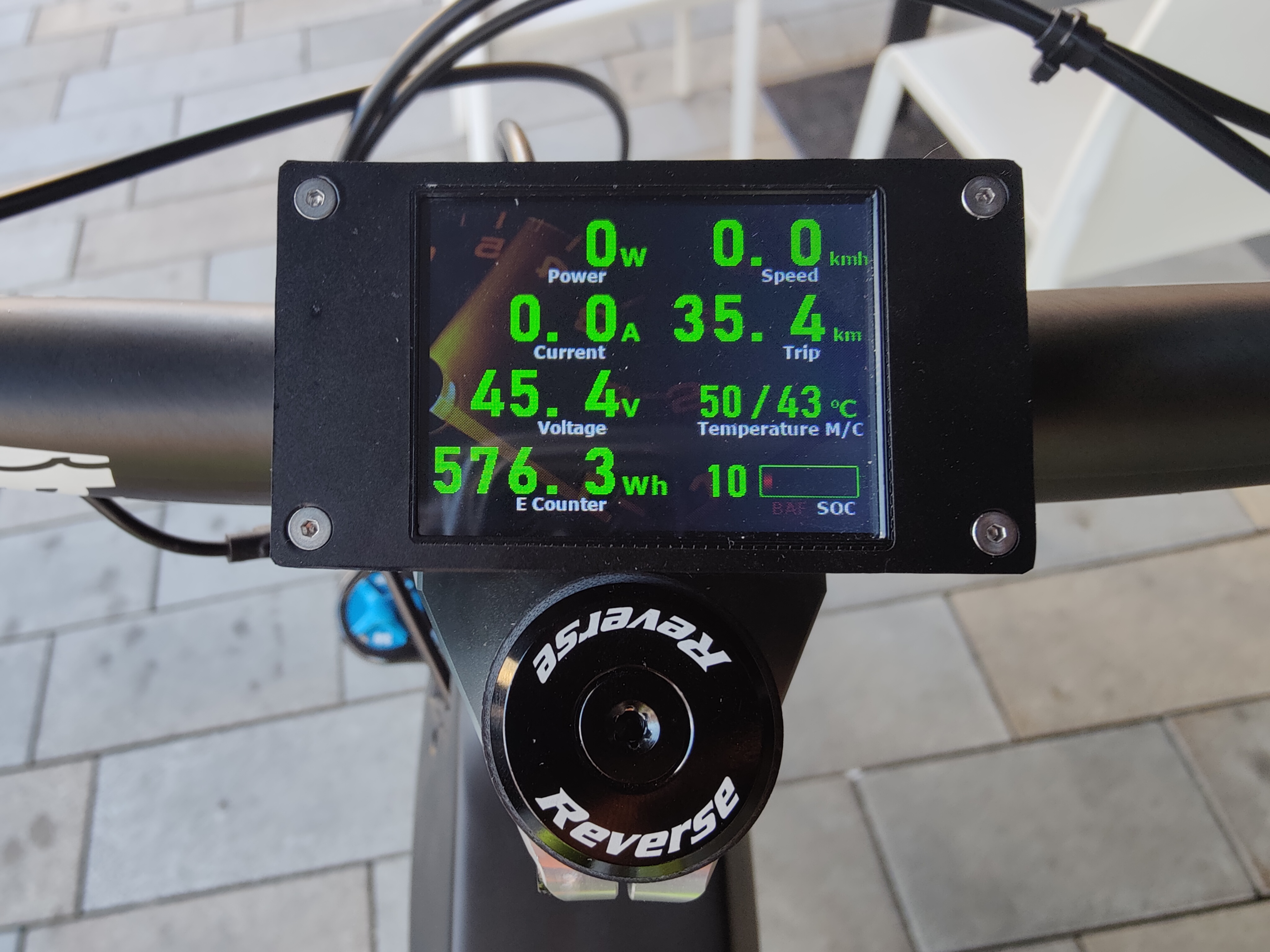

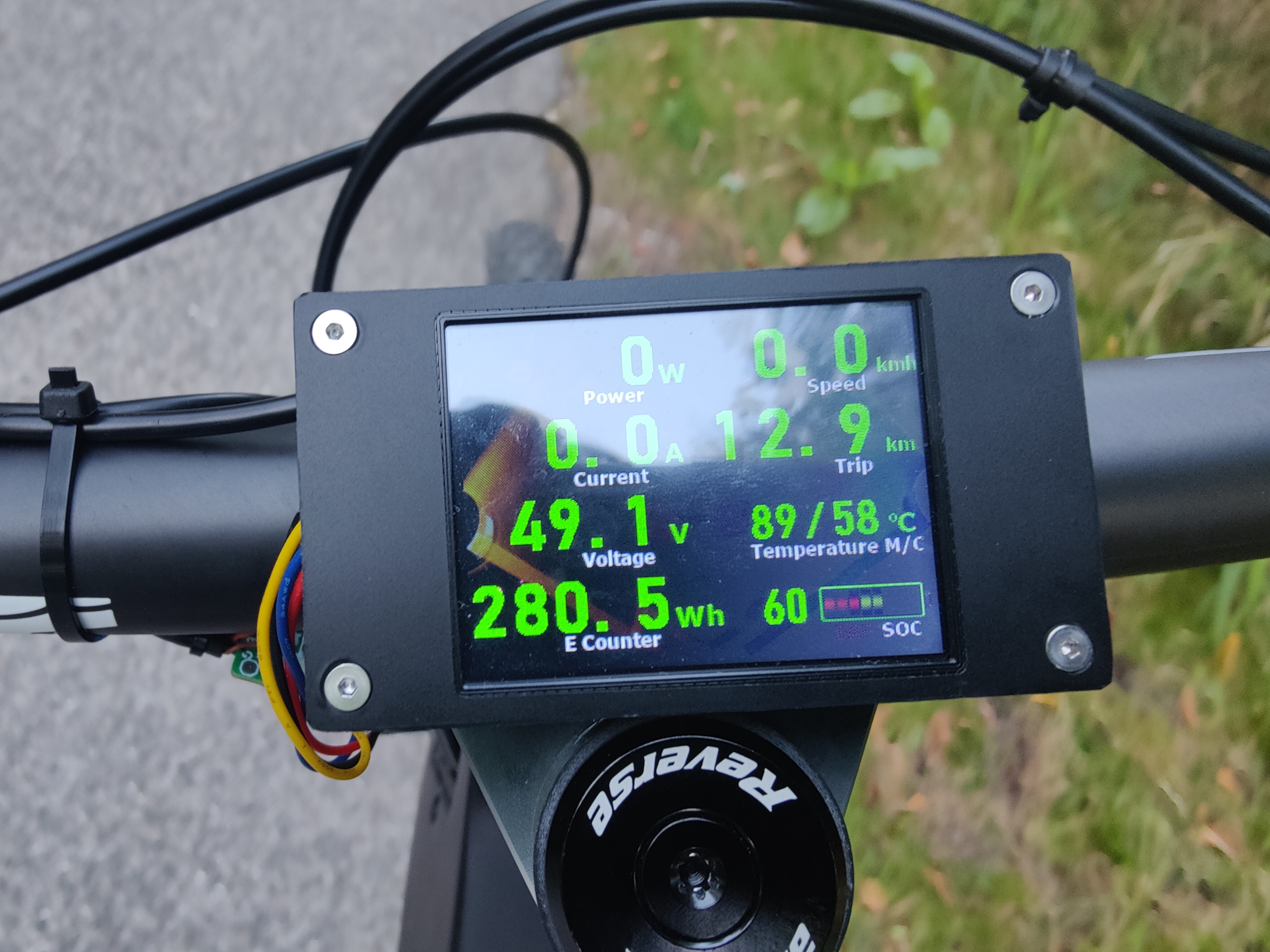

Update after a test ride firmware v10.1 48V
Looks like temperature is not raising to rediculous numbers as with FC1.0
89C max, in a hot weather could go over 100C.
Consumed 576 Wh (840Wh nominal) till 10%. Mostly at full power.
So stil high cut off. Its 3.4V per cell at 10%. :((
Throttle is hardcoded to 32kmh and seems to me also power is hardcoded: 50,75,100,100,100%
Unlucky, power limitation starts at 25% SOC (to be confirmed) and linearry ramp down. Cca 7A at 10%SOC

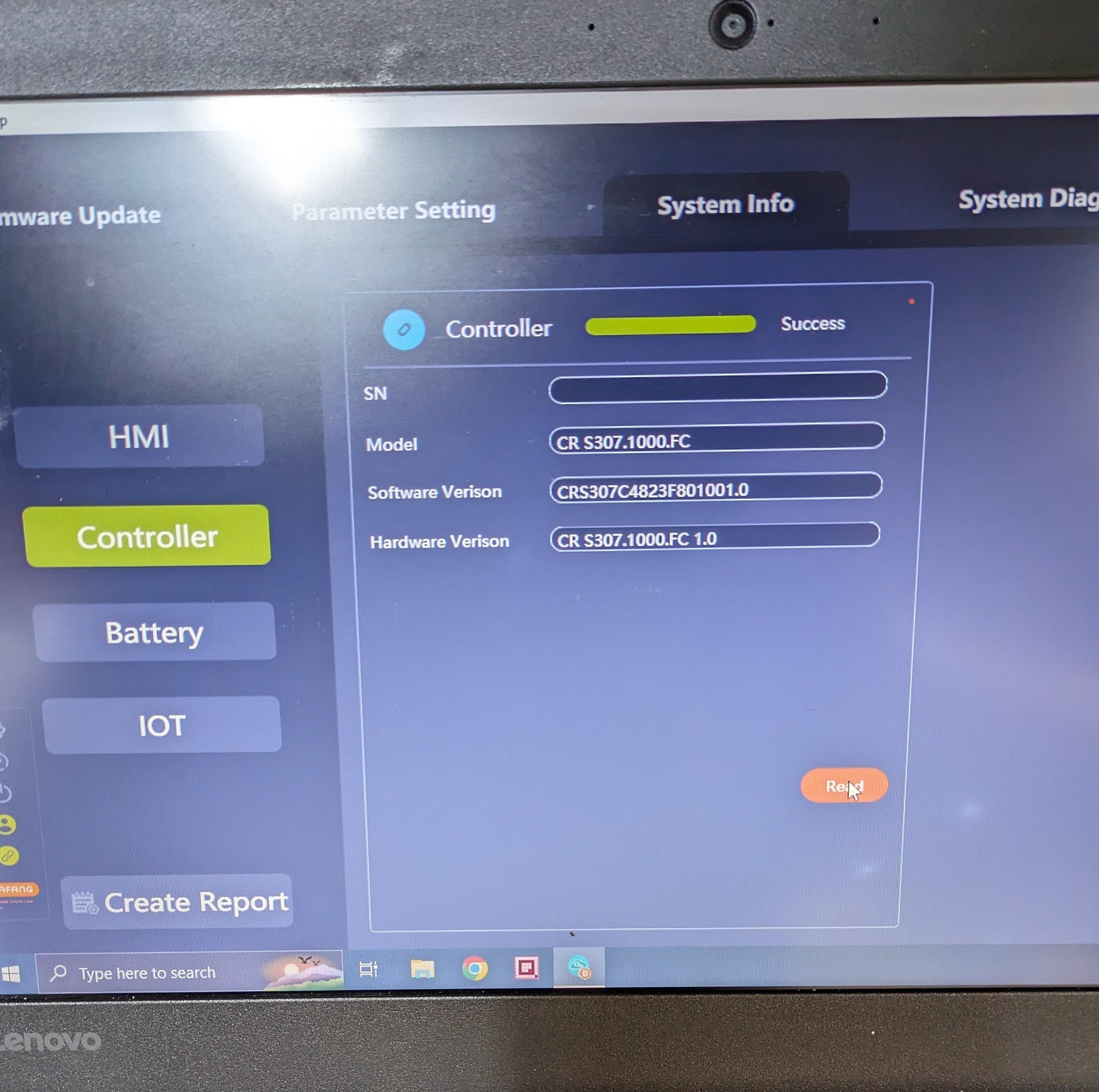

Hi Dado,
I recently recieved a new replacement controller from Chili Shen for my M510 (F2.0)but it had wierd numbering when viewed by Besst tool.
When i queried this , they said it was correct but if you look up that part number its an external controller. Anyway, the bike would not turn on. I then flashed this with MMG522C4814F802010.1-CR X10N.510.FC 2.0, hoping this would solve the issue but it came up with error 30 so i assume this is not the correct firmware. Does any body have any clue how to resolve this? Chili is being less than helpful on this together with returning a brand new motor with a speed sensor fault but that is another story.

Hello Simebru.
Definitelly not a M510 controller -CRS307. I am surprised you managed to load there M510 firmware. :)
Take a picture of your controller pls.
I am sure this was just some mistake, Chili knows what looks like M510 FC2.0 controller. She would send you correct one, she is fair.

Hi Dado,
It is exaclty the same, even down to the PCB numbering, thats why i flashed the M510 firmware, thinking it was just a BESST glitch. This is now my 3rd controller.... I have ordered another one from elsewhere. I will be interested to see Bootsdave resolution.

Hmm, Bagang can still surprise. ;) They must have load CRS307 bootloader into m510 controller in a factory. Wondering it has same firmware boot code to be able to flash M510 firmware. (Saw it just on old motors: M420 and old M620 has same bootcodes).

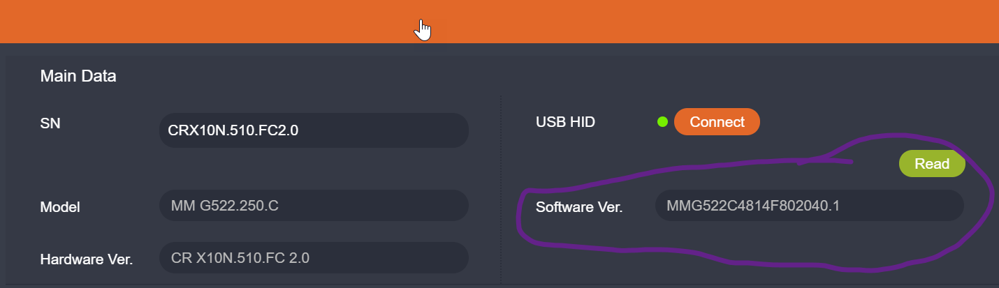

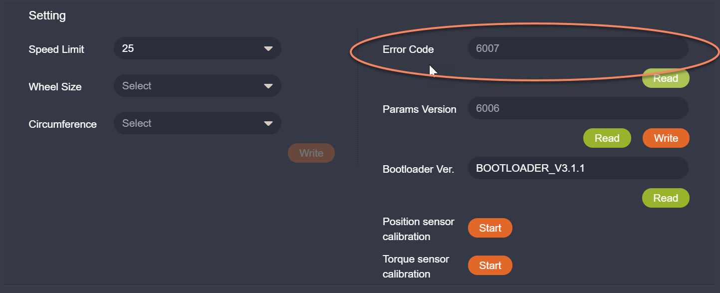

Gentlemen, Greetings. Does anyone know this FW that is installed in my controller?
Decided to replace the controller in FC1, haven't tried it on the road yet. What is the best FW for FC2 in your opinion?
Does anyone know what the error field is and what the error means?
Thanks in advance.

Hello Iscnader.
So looks like some new firmware. Again a big jump in a version number. Official bafang for M510 FC2.0 is v10.1
6007 is a CAN ID, not an error. Basicaly it is a request ID to get error messages from a device. This did not worked on any motor for me. Display is usually storing error log with bafangs.
