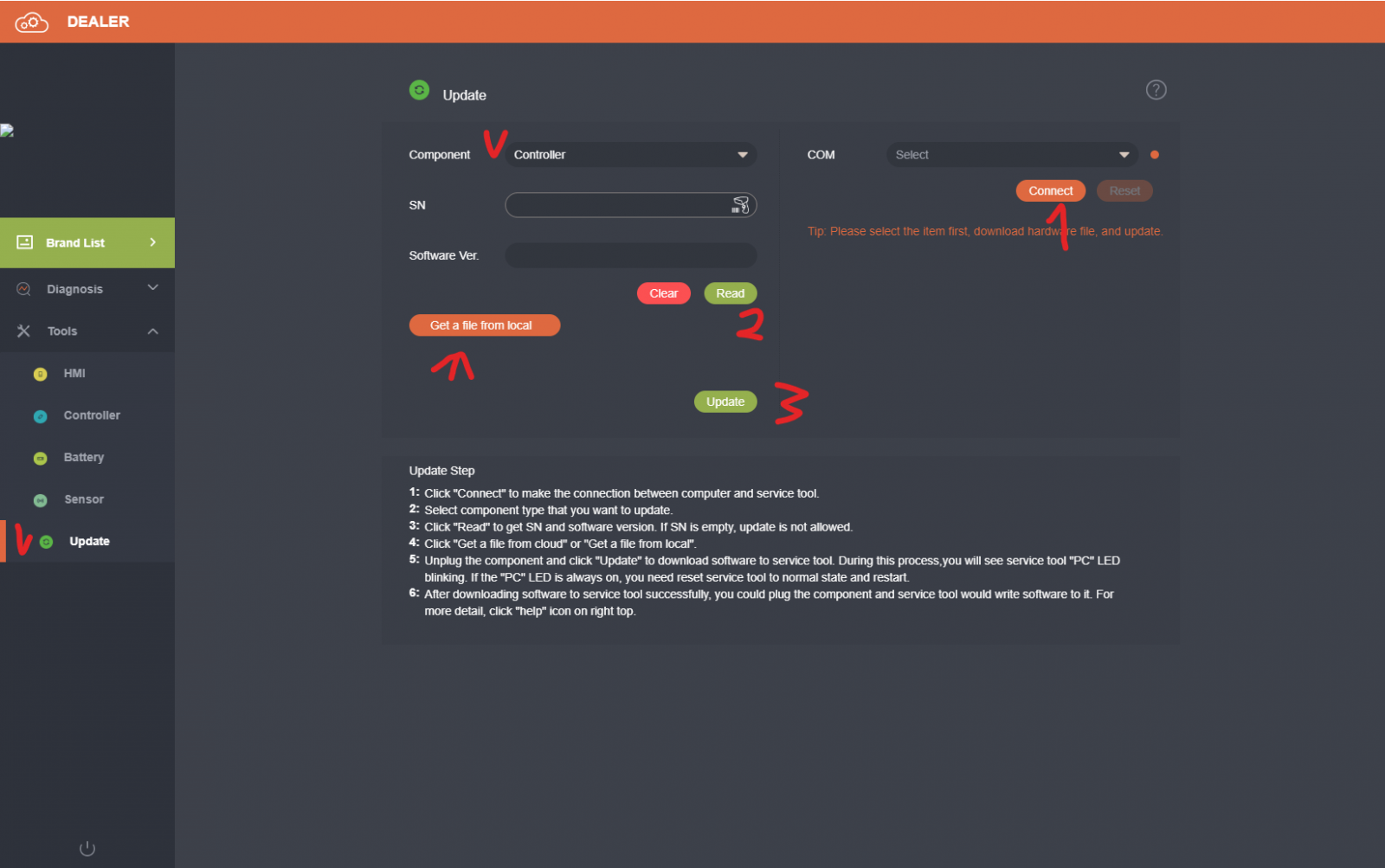

working as intended, and now run the besst (do not close the cmd with script).
next steps:
a. upload and pick file
b. after beeps - unplug the besst cable from bike. NOT usb from besst or laptop, but BESST connector to engine (single plug)
c. wait few seconds then connect and update will proceed automatically
d. click 'reset' after beep
Thanks again for Your help! My BT arrived a minute ago! Could You please quickly tell me how to connect the BT to the bike? Do I unplug both the display connectors and plug in the wire from the handle bar unit into BT, and the wire coming from the frame also into the BT? Thanks for Your adivce!

Yes, this triangle plugs (are for CAN). We're waiting for your feedback @thaeber
after update procedure you may 'read' the name of firmwre and check its corresponding to CRX10NC4813i142015.8 version

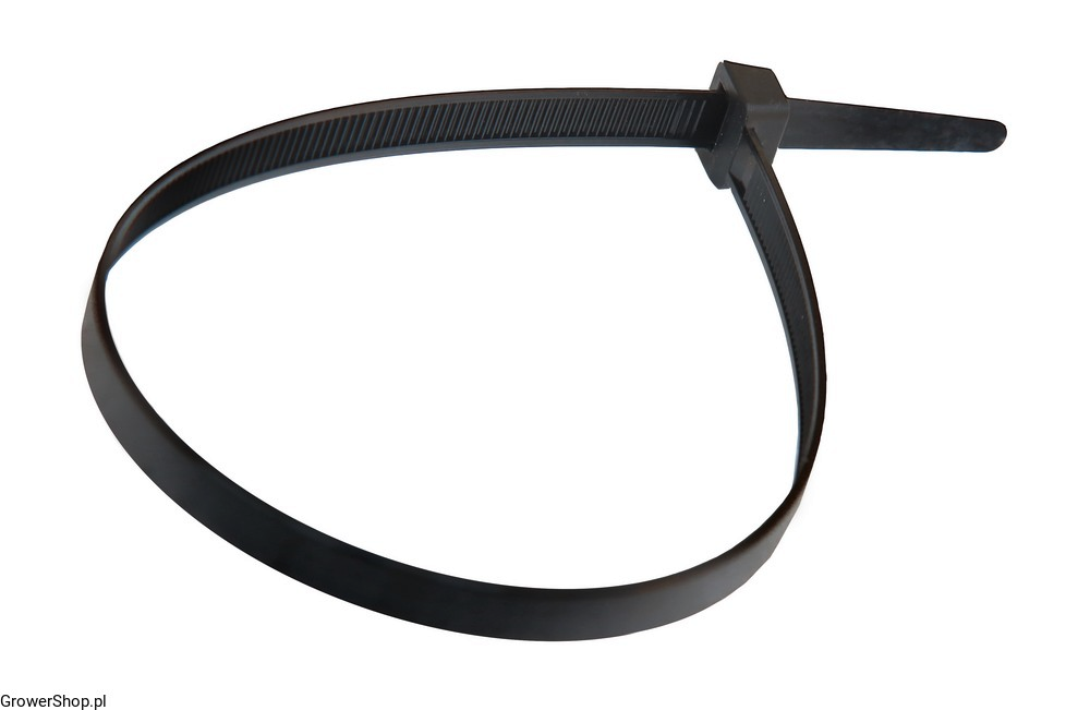

Completed! Everything worked fine, thanks guys! But now I‘m f***ed becaus my display to motor cable seems to have a defect. I get Error 30, when I slightly bend the cable closed to the display plug, it‘s working. It‘s looks like its not the connection to the display but the cabel itself. Any idea where to get an replacement?

I would look on aliexpress or write to Bafang, however - check the plug connection to the display - maybe its just not correctly plugged (i mean you need to push it to the end).

I know its workaround but you may bend cable to position when it is working and keep it in this position by this, or silver-tape till you get new cable.

Thank You very much mate! I installed the zipp tie option already before You postetd it :) hope that works! I‘ll try to get replacement asap. Thanks for the contacts!!!

I just returned from a longer test ride. The zip tie bugfix worked with no problems. 42 km and 1.300 hm accomplished!
