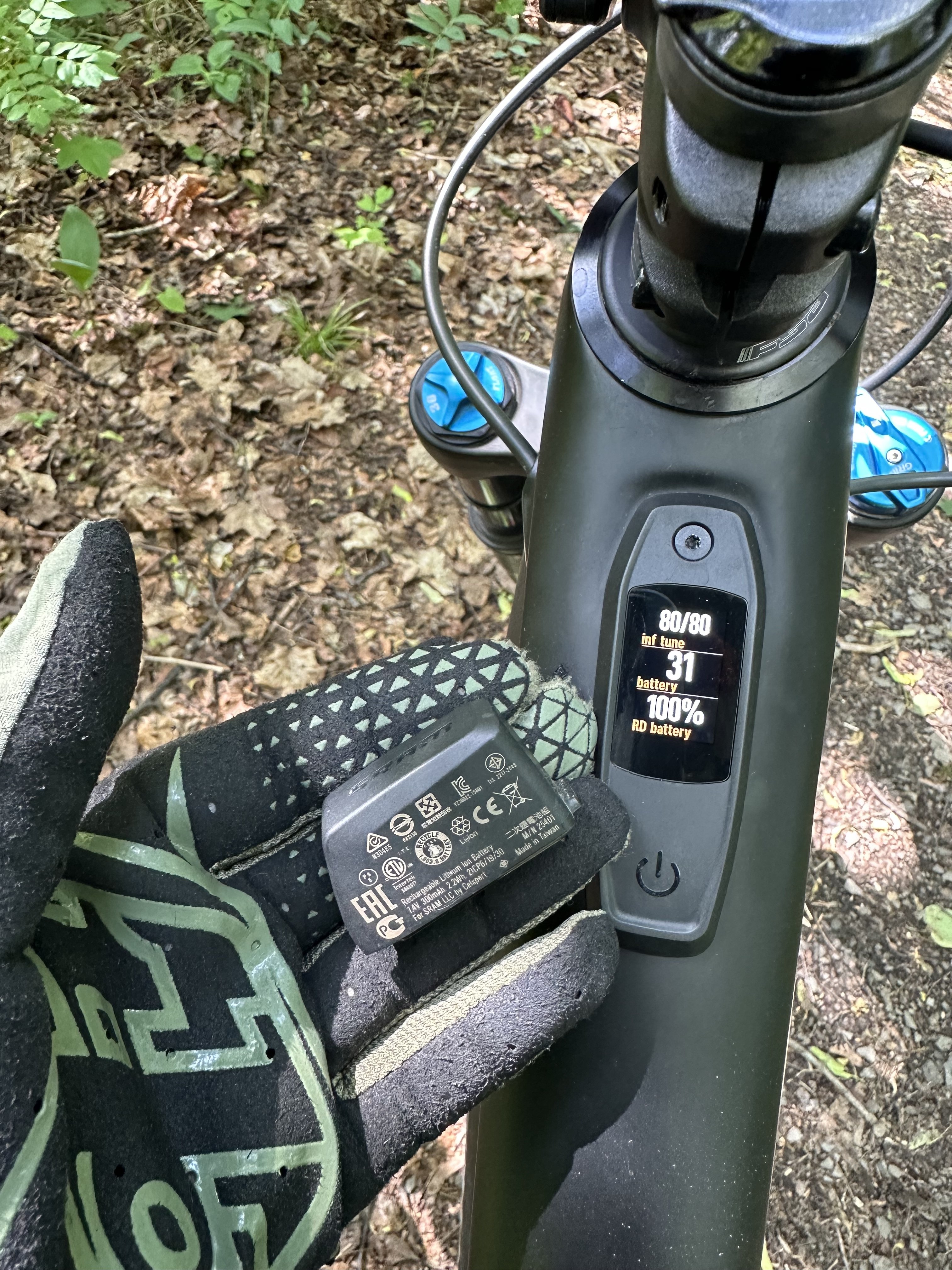

My SRAM gx eagle transmission connected to Mastermind shows 100% charged all the time even when I disconnect the battery.
The gears is showing correctly.
What am I doing wrong?

Yes it's wireless but how can I move away from the bike to see when I ride and look at the mastermind 😂

Maybe I didn't explain the problem properly and you are right it should show 0%.
On the Mastermind display the battery shows 100% when fully charged, after riding a couple of days and when I remove it. AXS app is paired with the new black Specialized app so everything else is working including which gear I am in.
As seen on the screenshot the motor battery drain is working and correct.
Maybe it's a bug in the new spech app?

I'm pretty sure every pairing/connection is done correctly since I can see gear change on MM display when riding and when I stop and remove the battery MM display shows --- instead of which gear I am in.
Anyway I now got a support ticket at SRAM so hopefully the problem will be solved.
