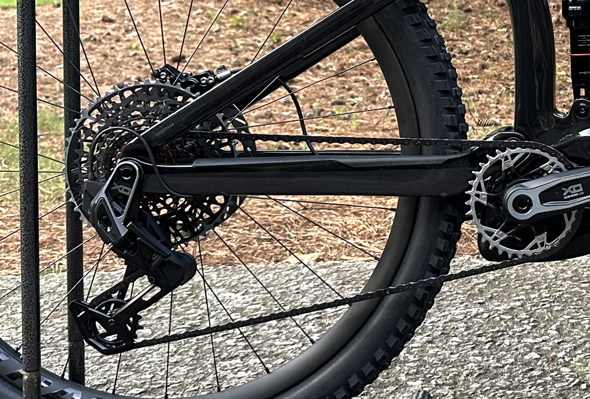

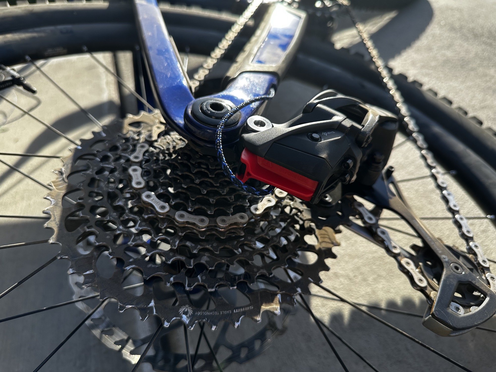

Although this is not a Bosch bike, Trek has wired the new GX T-type too....I have the X0 T-type on my Rail and it too is wired. That said, I wish the cable to the dummy battery didnt hang out as far as it does...I have tried shoving it back in but eventually it slides out...Im afraid it will become a snag-device at some point!
View attachment 122952 View attachment 122950
Very interesting! I’m going to send that photo to SRAM and see what they say!
If there’s too much slack wire, you should be able to take the bash guard off and take up the excess from the motor end.

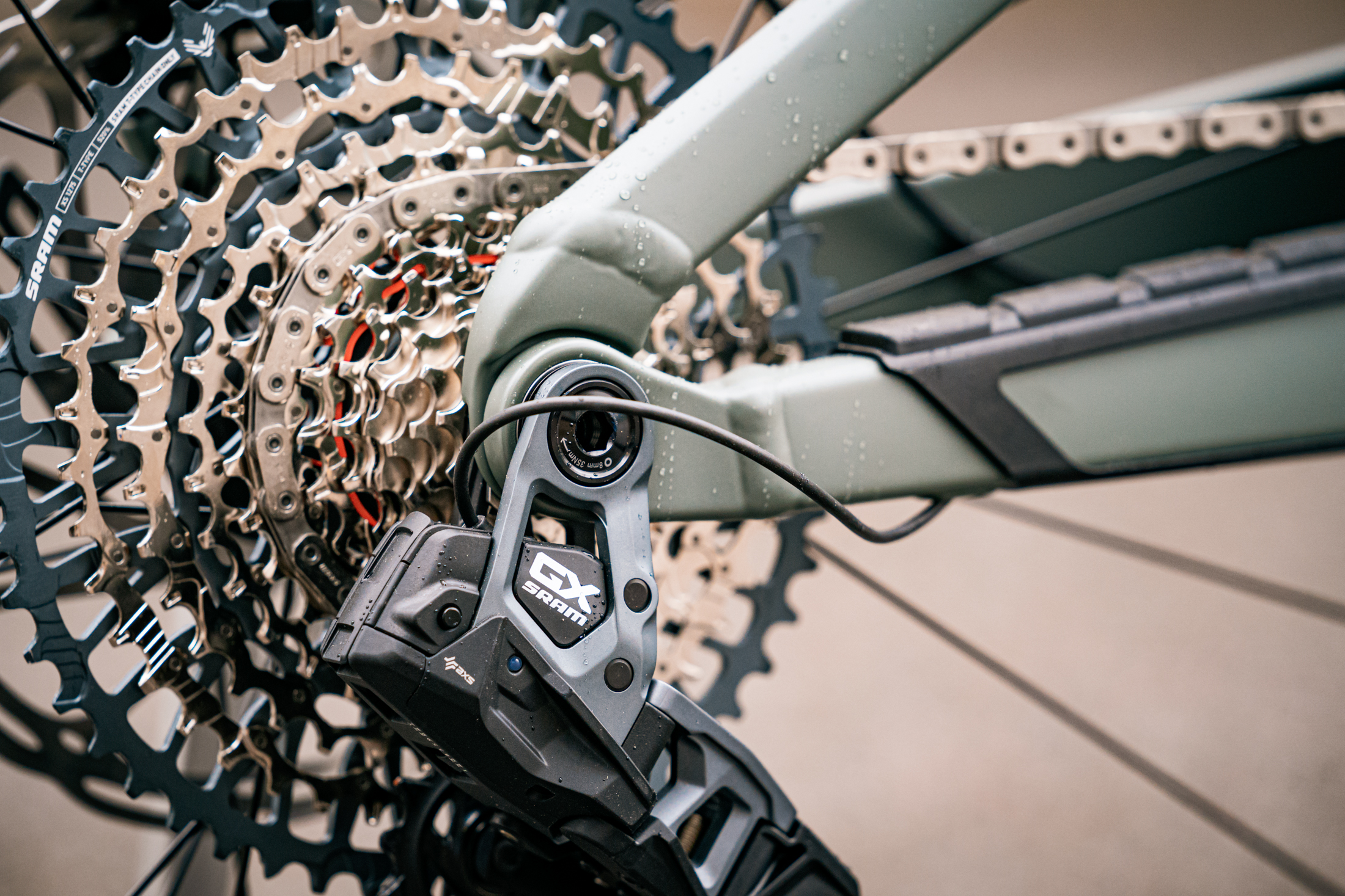

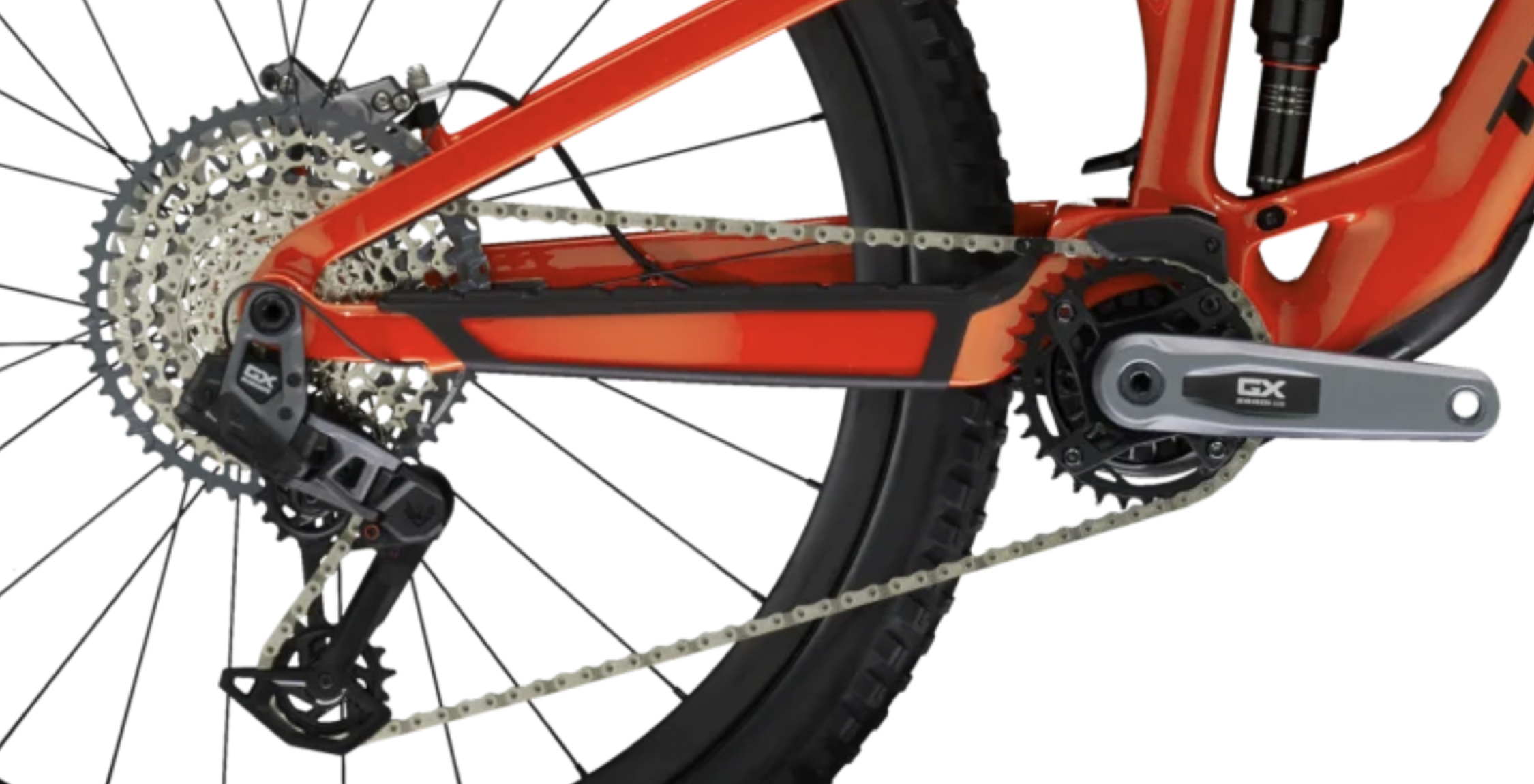

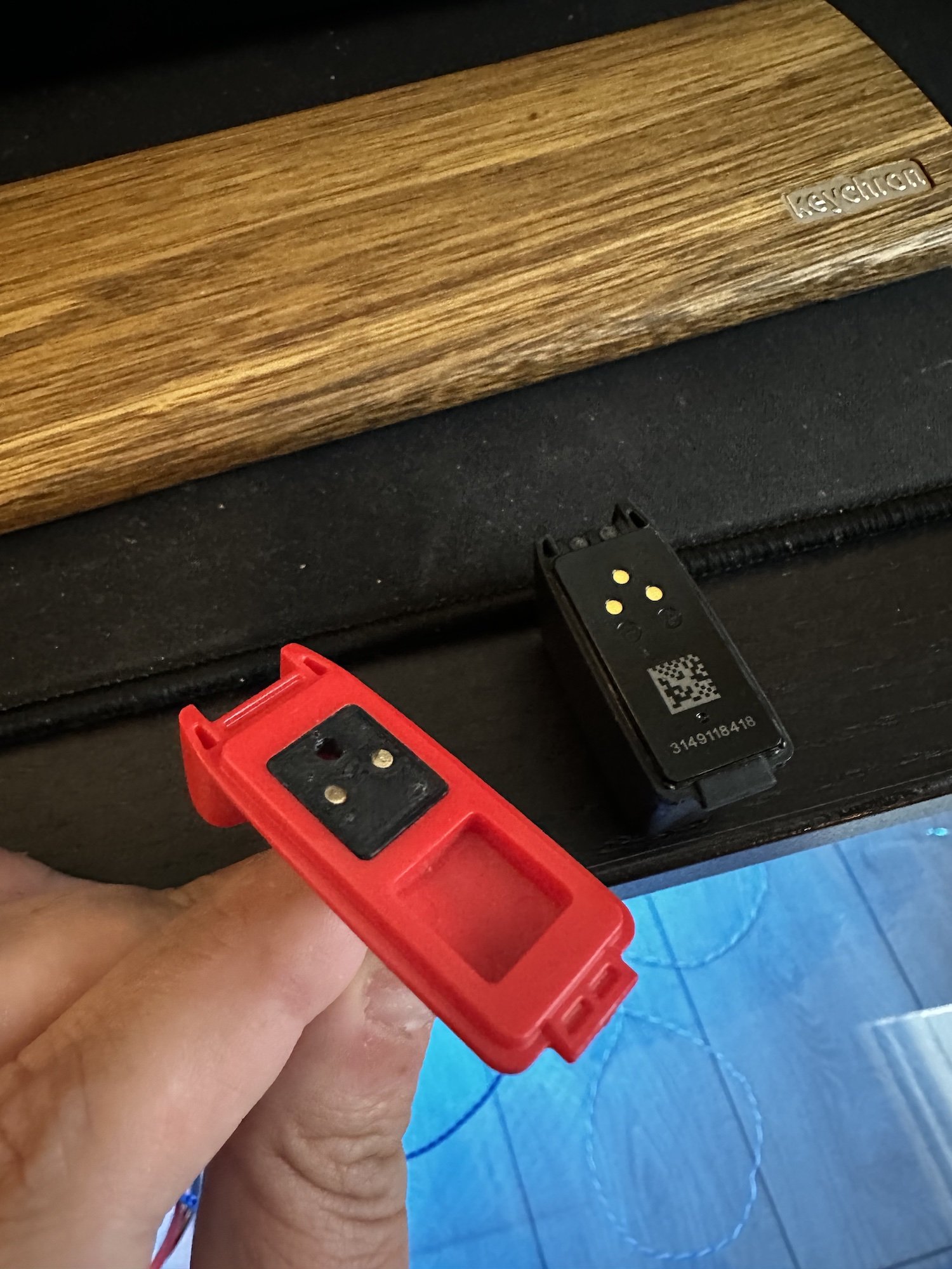

My Rail came with this, but I've replaced the AXS non-T-Type with GX T-Type which tucks the battery away differently to the XX/XO derailleurs. Unfortunately, the wired dummy battery can't be used. I'm hoping there's another version in the works that will suit GX.
Are you willing to sell it? I recently upgraded to the XO T-Type and I have been trying to purchase it for months. I got a call from the LBS today and basically told me Trek/SRAM are not willing to sell me one after I have purchased the Smartbox and AXS cable from Trek.

My trek exe 9.9 came wired with Axs xx1. I’ve since swapped to xx t type and have been using the same battery connection cable to the main battery. Currently my bike is waiting for its third rear mech as 2 have failed to wake up after been left for a week. the first rear mech was replaced by the shop and I’ve sent the second one in for check up to sram.
im going to fit the third one this week when it arrives but I’m going to fit a standard battery and take the cable out. The cable connection is the only common denominator and I can’t believe that 2 xx rear mechs have been faulty. I’m wondering if the cable is,, for some reason, overloading the xx mech and destroying it. It’s my only explanation.

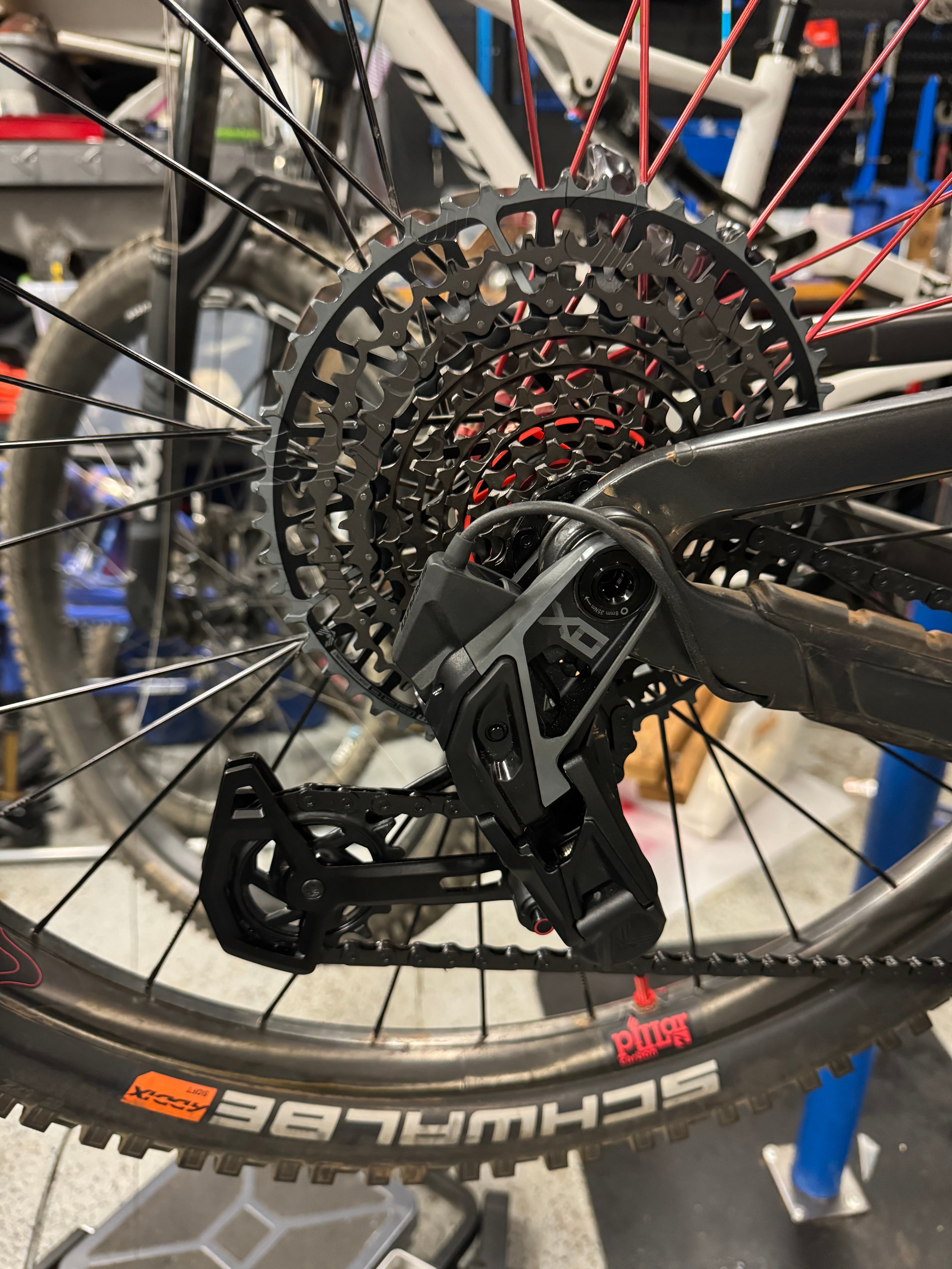

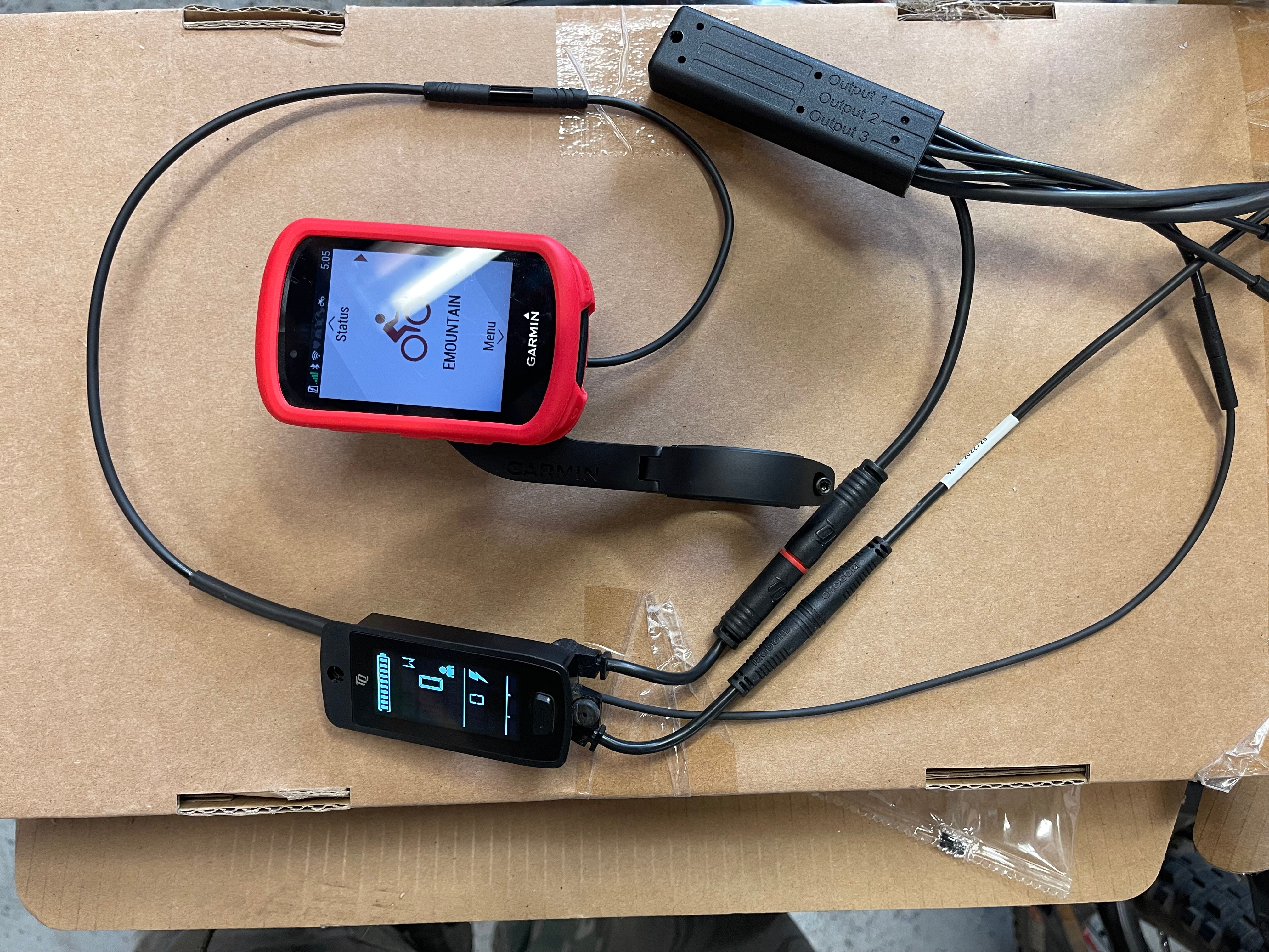

I checked the voltage on my AXS battery fully charged was 8.4v so it looks like it's a 2s battery. I have been trying to source the correct cable for months now from Trek and SRAM for my Ex-e but I keep getting the run around and nobody can tell me what the part number is. After seeing the cost of that extender linked in this thread I took matters into my own hands and made my own.... So far I have tested it with a bench power supply at 8v and it works great! I ordered a regulator to step down the 13v coming from the TQ smart box to 8v and will wire it in and go for a ride later this week. So far it looks promising. I have my garmin wired in to charge off the bike too from the pogo pins on the back of the device.
View attachment 130931 View attachment 130932 View attachment 130933
NICE!! Did you 3D print that?

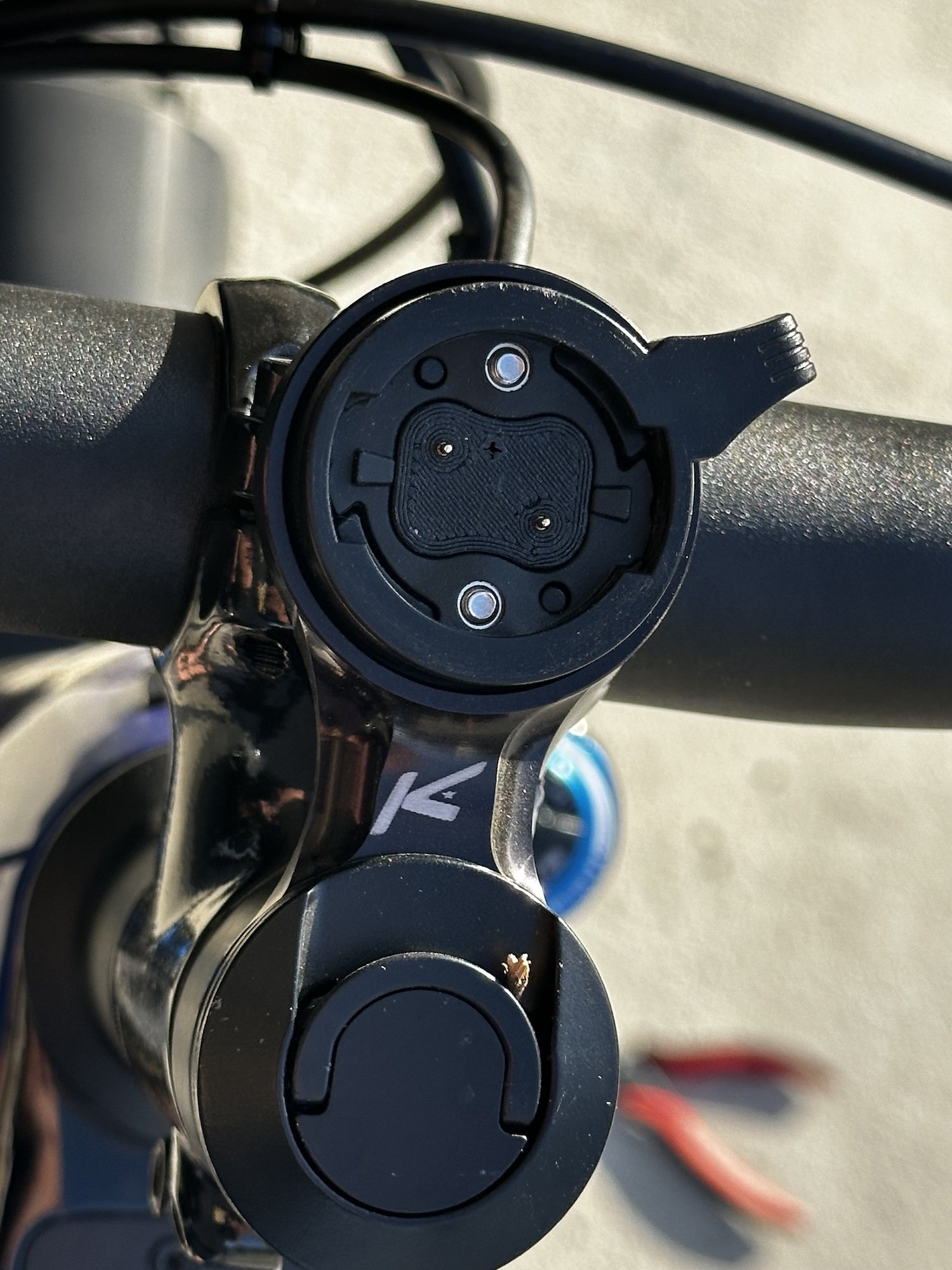

Can you please share the link to that charger? Doesn't looks like Garmin Power Mount. Or is it self-made? Thanks in advance.
It's a bit of a custom hodgepodge. So I had to Dremel out the center of the K-edge mount to make room for the 3d printed pogo pin holder and then purchased the garmin power pack mount. Garmin does now sell an off the shelf solution for this part though.

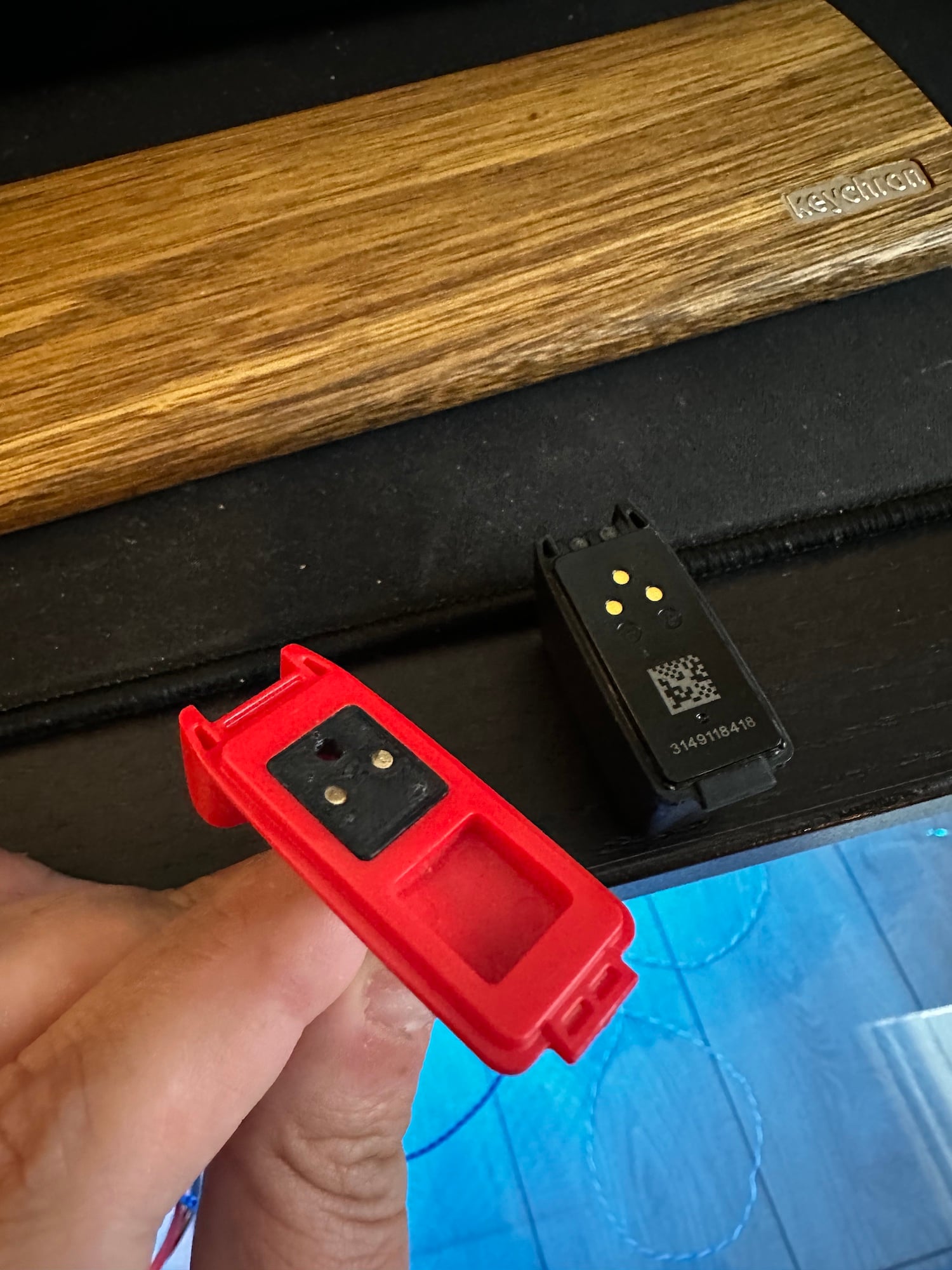

I forgot I was following this thread. I did some custom stuff with the TQ system in the Fuel EX-e last fall. Custom wired Power Edge mount to the TQ Smart Box Output 3. I also have the only modified 9.5 that powers the SRAM XO Transmission (hopefully someone can prove me wrong.) I sourced the battery adapter from an Australian Rail owner that upgraded to the GX Transmission which uses a different battery type. I tried for months talking to Trek and SRAM but could not source the part. IMG_8113.jpeg View attachment IMG_0201.jpeg
