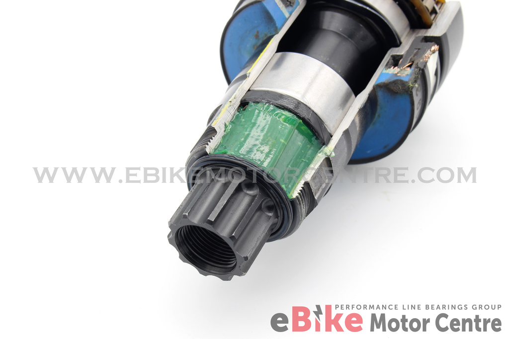

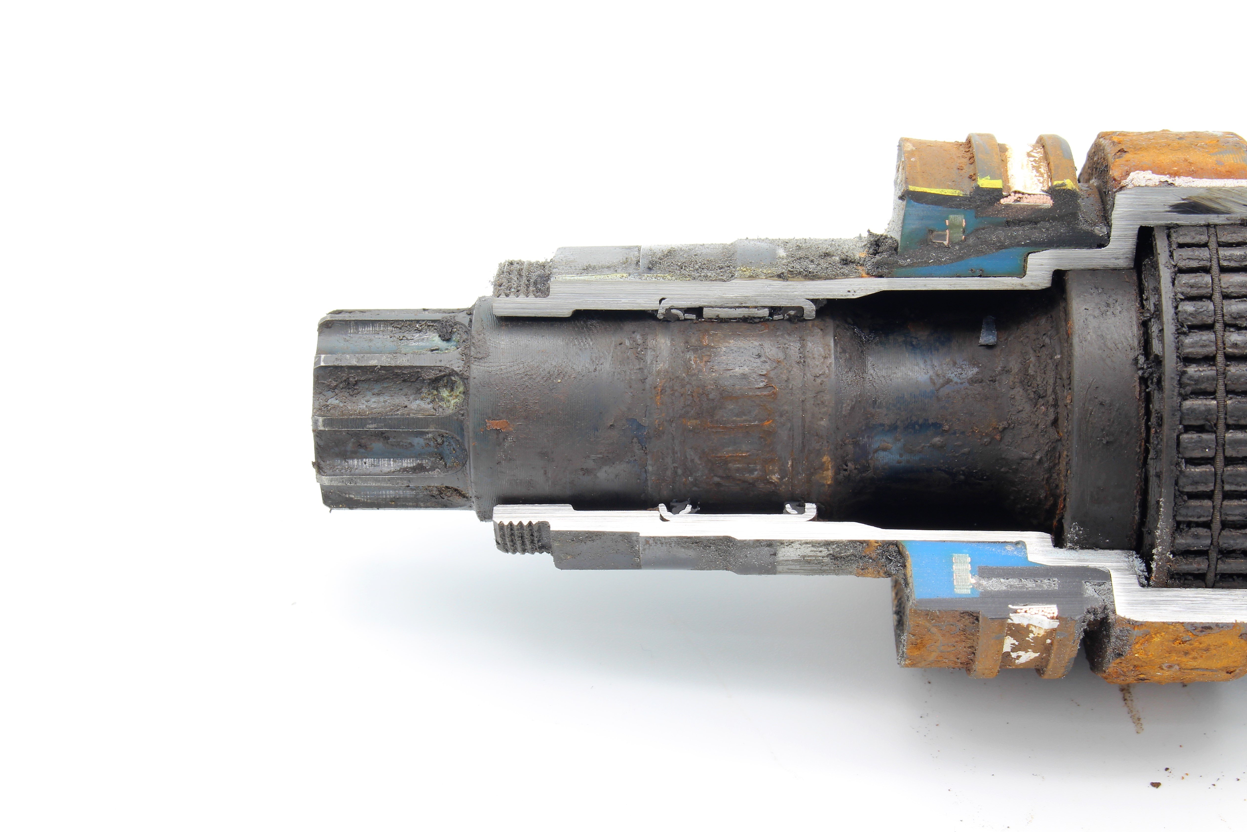

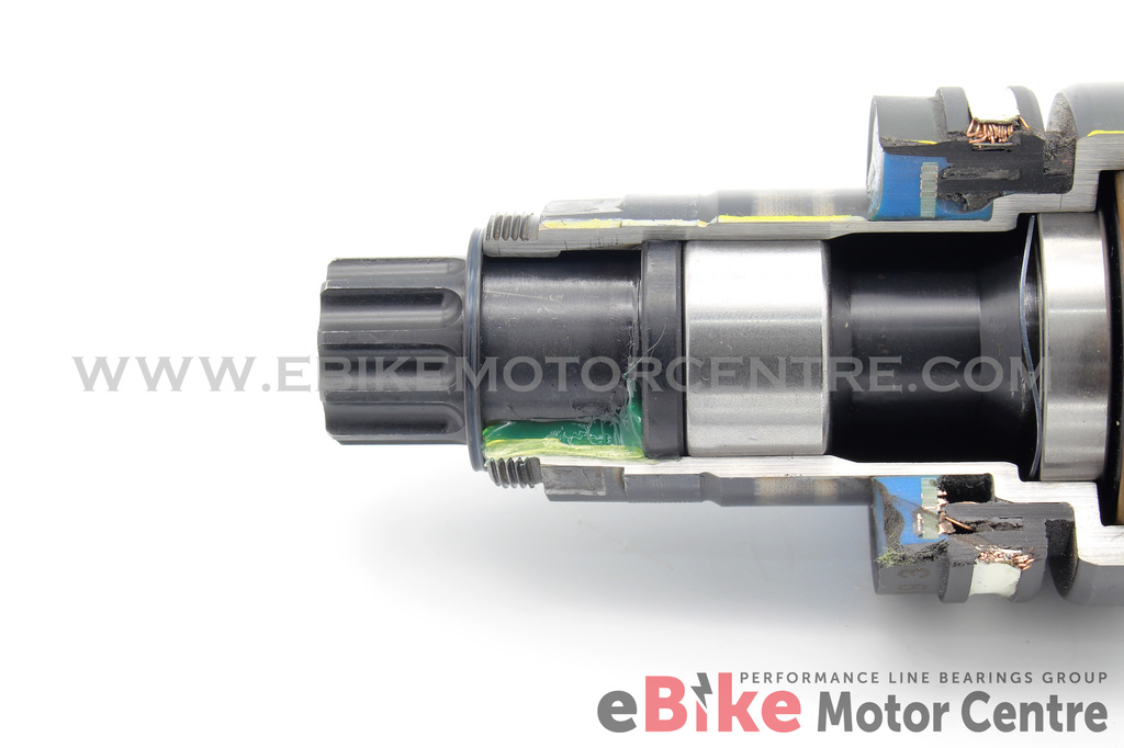

As the maker of this video I thought I better point out a few things before you change your mind about owning a Levo.
First of all, for every motor that fails, thousands have no problem at all. 99% of ALL ebike motors fail due to water or dirt ingress. Many new ebike motors use a sprag clutch bearing and whether a sprag bearing or a ratchet and pawl, or a clutch needle roller bearing are used, if you have a hard enough pedal strike, something has to give! It's much better to replace a simple bearing rather than replace a whole drive gear assembly!
No ebike motor is waterproof. Some are slightly better sealed than others, but seals add friction and friction = low battery range. Less battery range than your competitor equals less sales.
I do have to correct you on your statement "They use waterproof grease as part of their bearing 'upgrade' because of above, i.e. they have no fix for water intrusion."
Below is a photo showing a cutaway of a standard Brose motor and a cutaway of one that we have upgraded, you will see that it's not just about the grease, we do add a lot of extra sealing. In fact there are 5 layers of sealing shown below.
People ask us every day, what motor is the best? My answer is always the same. Personally, I think you should buy a bike with your heart, not your head. A bike should be something you love to look at when you walk into the garage, as well as smile every time you ride it! No motor is perfect yet, but if motors failed as often as you read about on forums, we would be a lot busier than we are!
