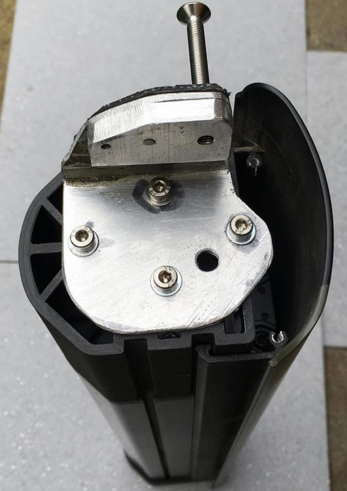

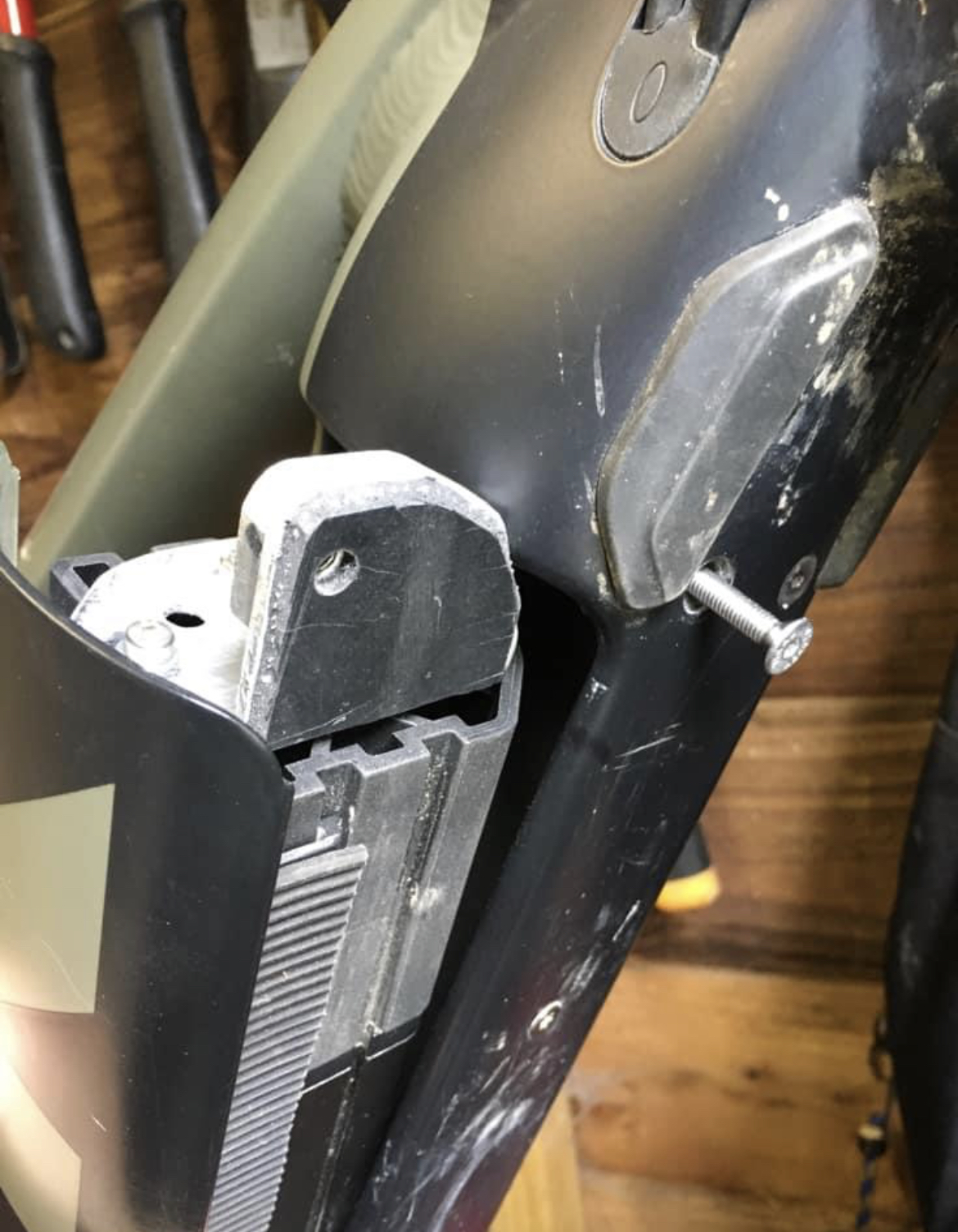

I saw a post on FB, I think from the original designer, where the bracket had been thickened by adding another piece of aluminum and only using one bolt. The thicker section looked to be at least 20mm thicker, hence a longer bolt through the frame and a much stronger connection. ( I cant find the picture, I will keep trying to find it)

Found it!

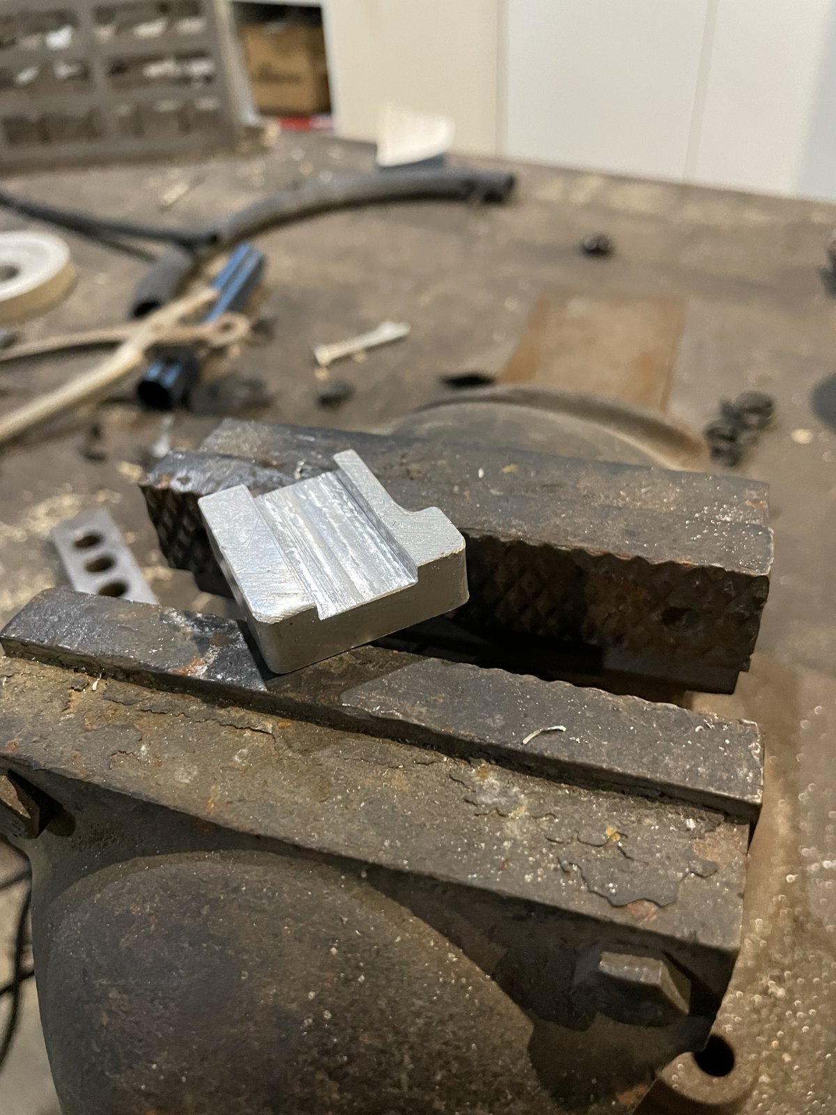

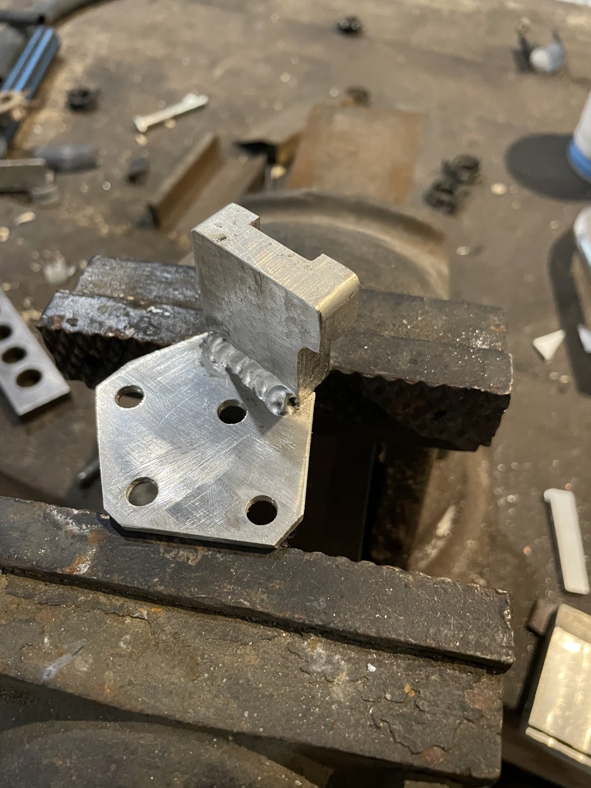

As I was whipping up a prototype today I noticed that none of the previously presented versions include a recess for the cables, the factory lock mechanism has a recess and I noticed a flat plate squashes the cables upon tightening, so if you’re going to have one cnc machined then I’d recommend this addition 👍
View attachment 99530 View attachment 99531
Do you want to make 13 of them?
Arron M
Oct 14, 2021
73
49
Di you want to make 13 of them?
Possibly, there would be a few things to hash out though:
firstly I’m in Australia so logistically it may mean sending over the entire batch and having someone distribute them locally.
Secondly I agree with Fox’s earlier point regarding the thickness of material where the threaded holes are, so we could use a 6mm angle, which may eat into some of the weight savings, or (what my final design will likely be) 3mm battery interface plate welded to 8mm plate where both versions would have a recess for cables.
My prototype is 11mm thick as I was just using scrap I had at hand, but I didn’t do this for weight saving, I’m about to start transporting my bike on the out side of my vehicle and don’t like these stories about battery’s falling out, even though it never has.
Thirdly is everyone happy that if it fits my ‘21 rail 7 that it will fit as well on your own bike?
