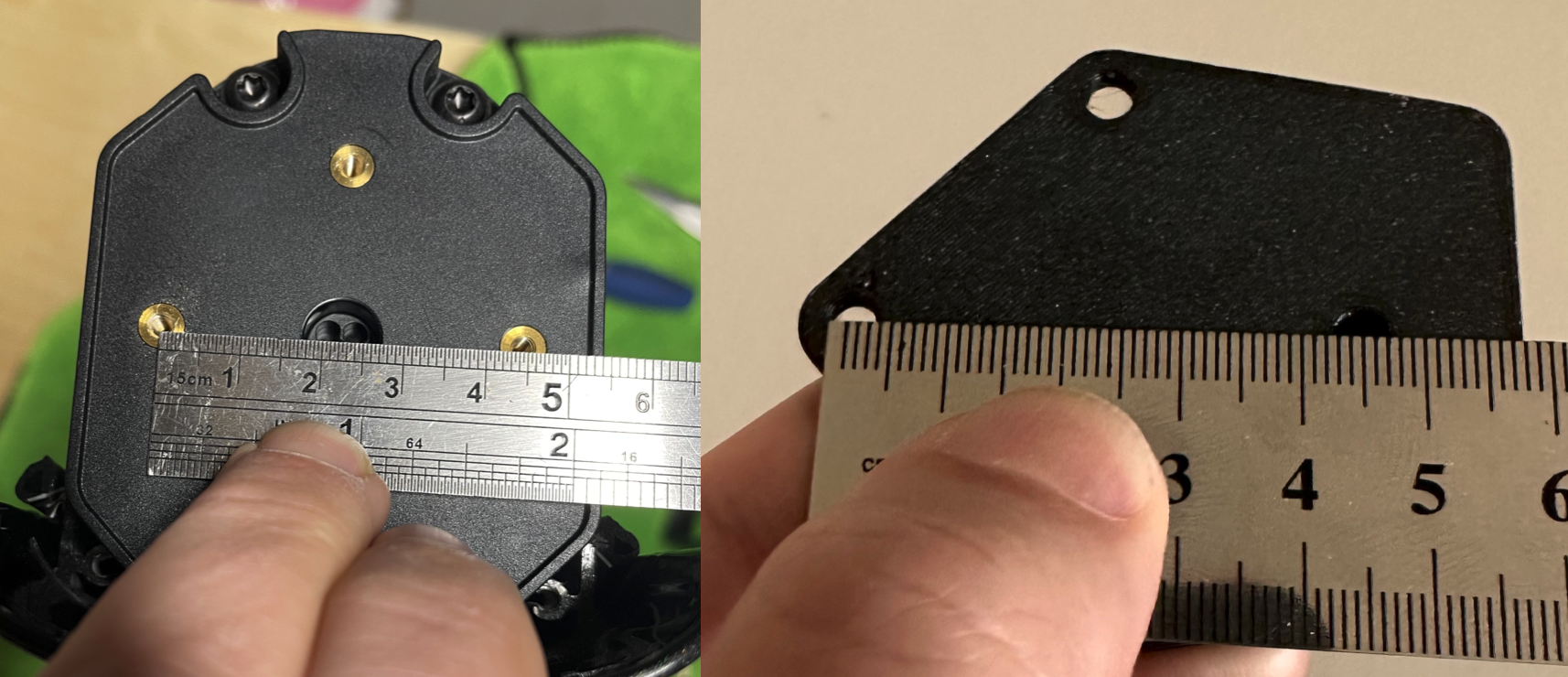

Hi mate, would you be happy to post a pic of the dimensions so i could maybe knock some up.

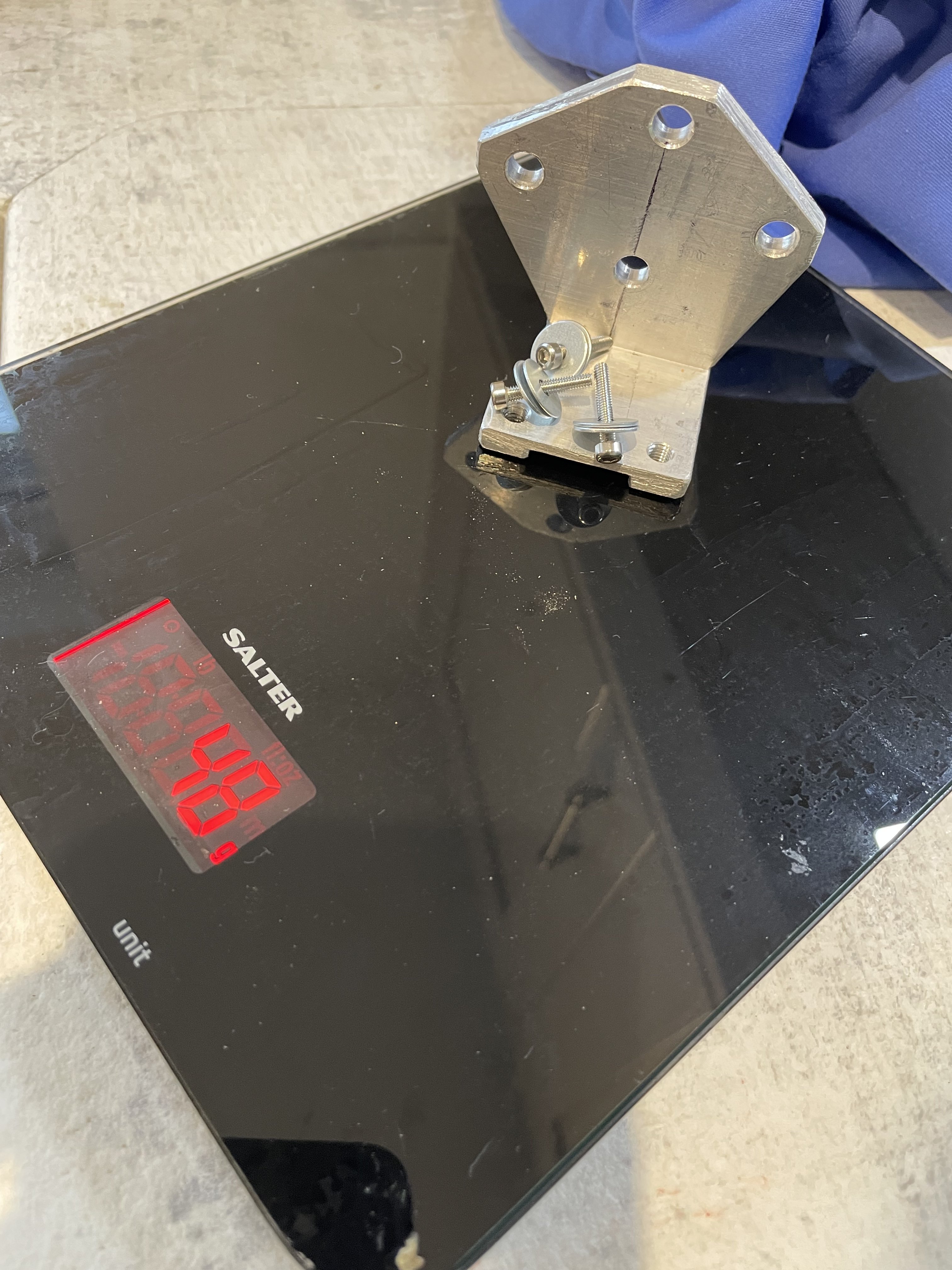

Bracket weight is about 48g
Is there really a need to install the foam
pad? It caused power off issues for me (when used with the OEM battery lock).
I’ve left it out and just use the new bracket. The battery slots right down into the terminal connections (so no power off risk) and I can’t really see how it can rattle with the new bracket preventing any movement.?

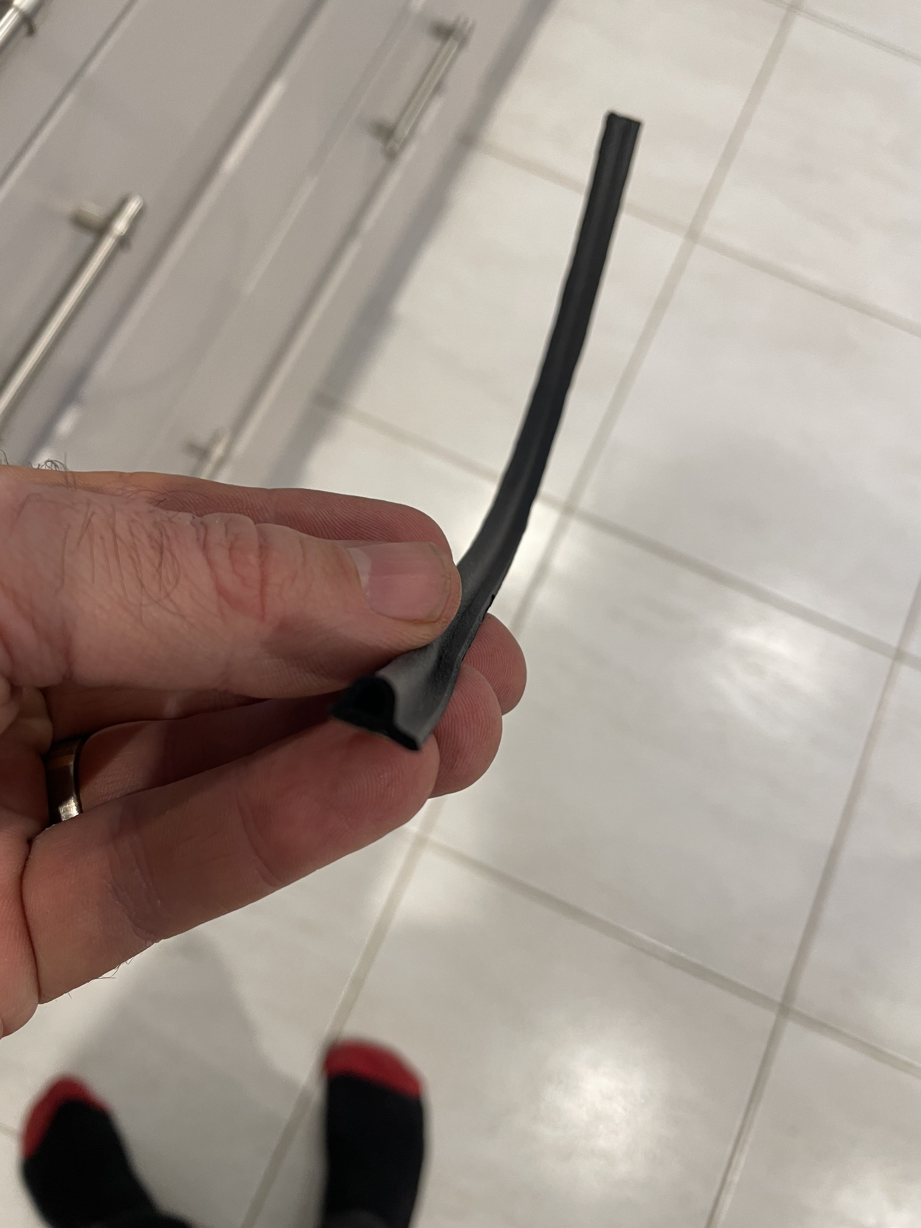

what size is the P foam some of you have used for the gaps on the top and bottom? local or online bought?
Stormguard EPDM Weatherstrip P Profile Black 15m​

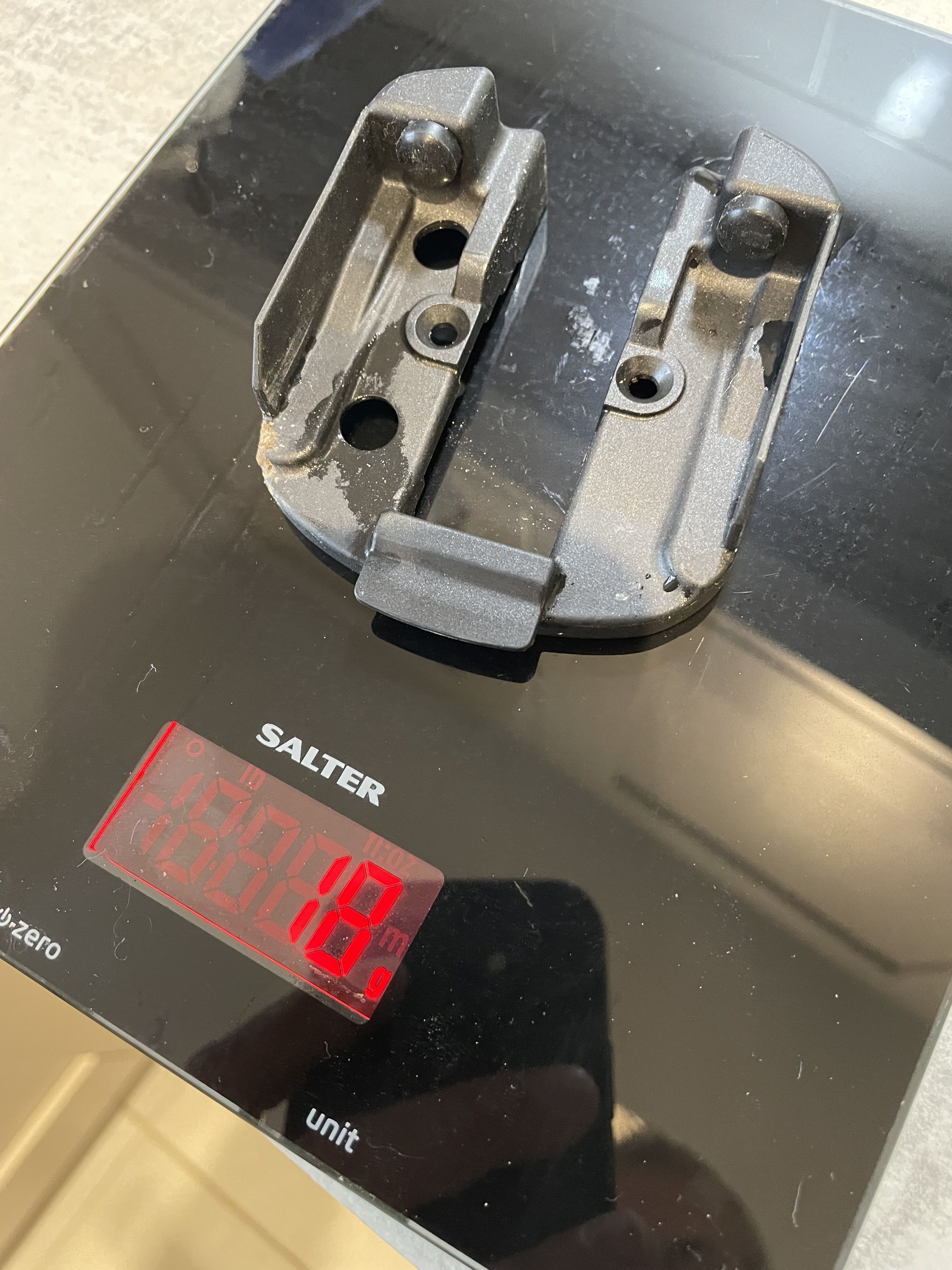

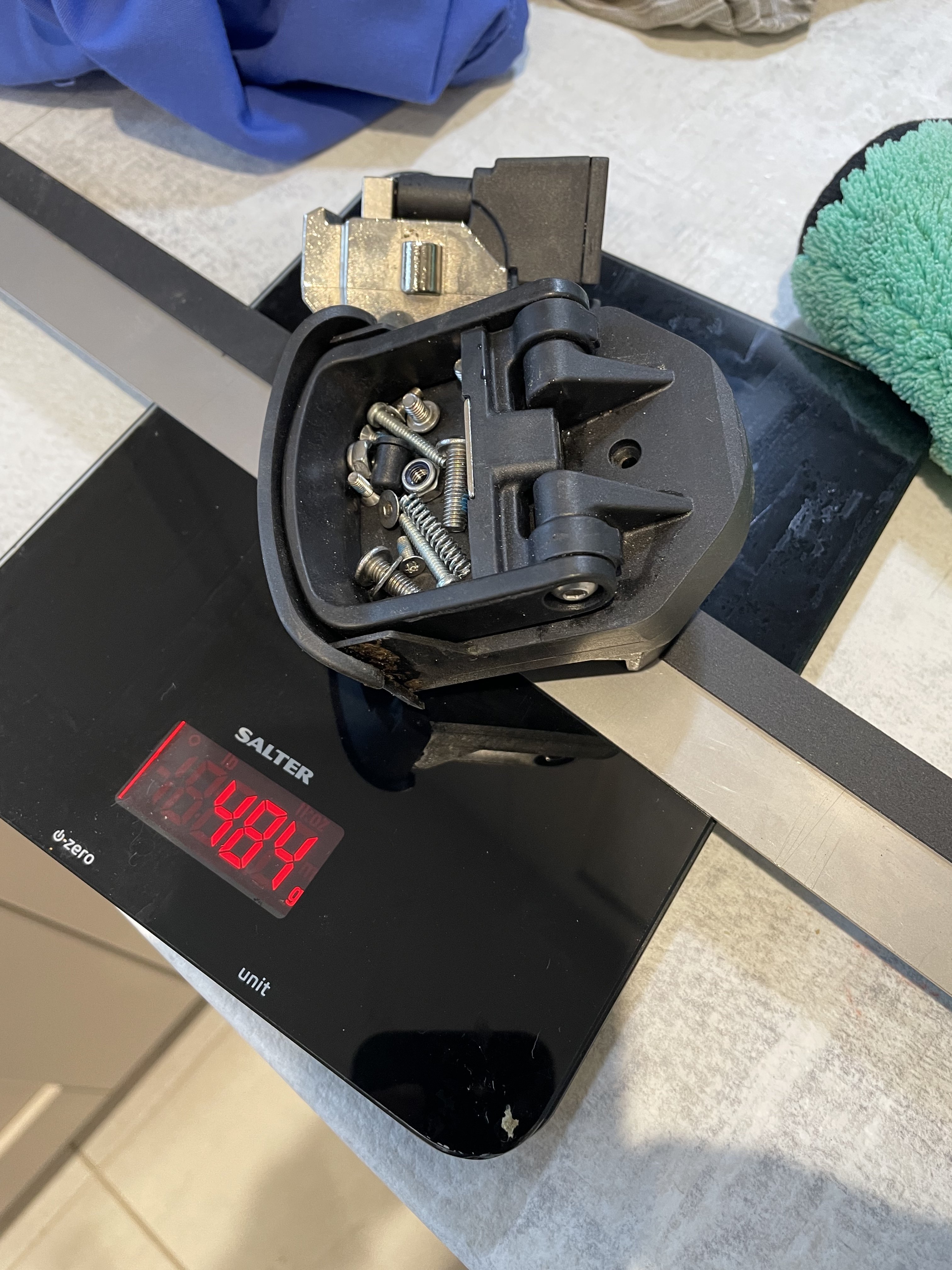

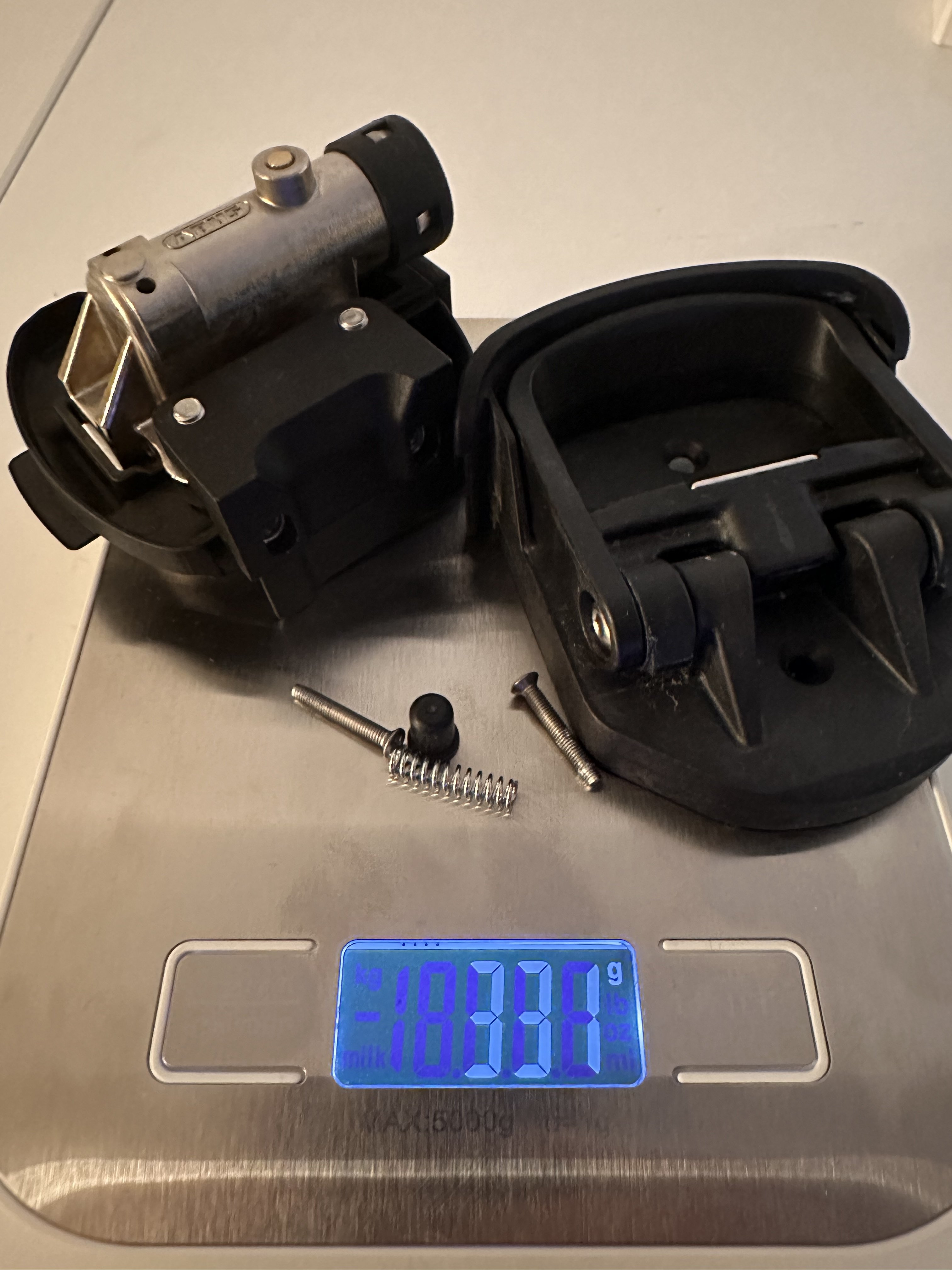

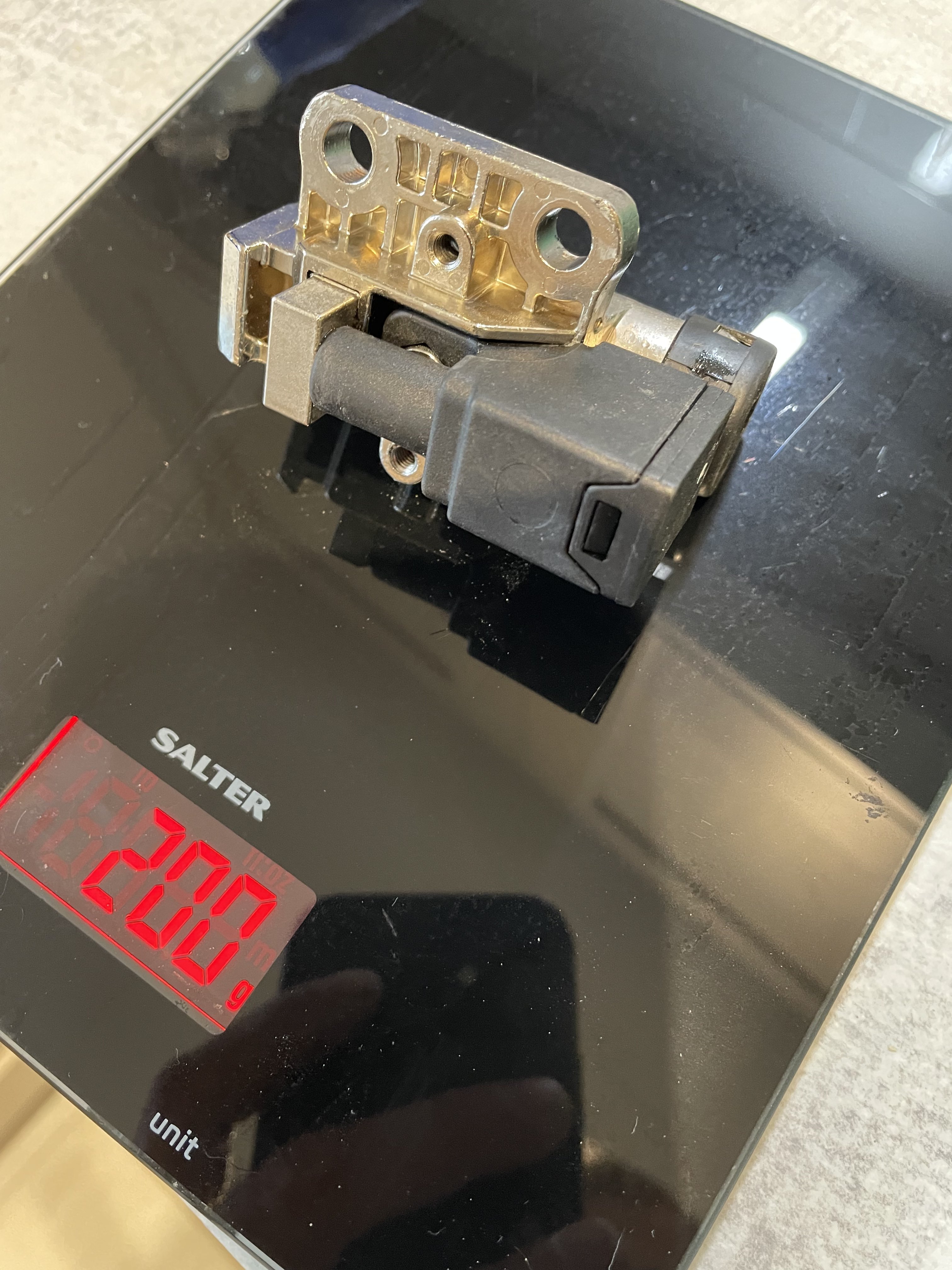

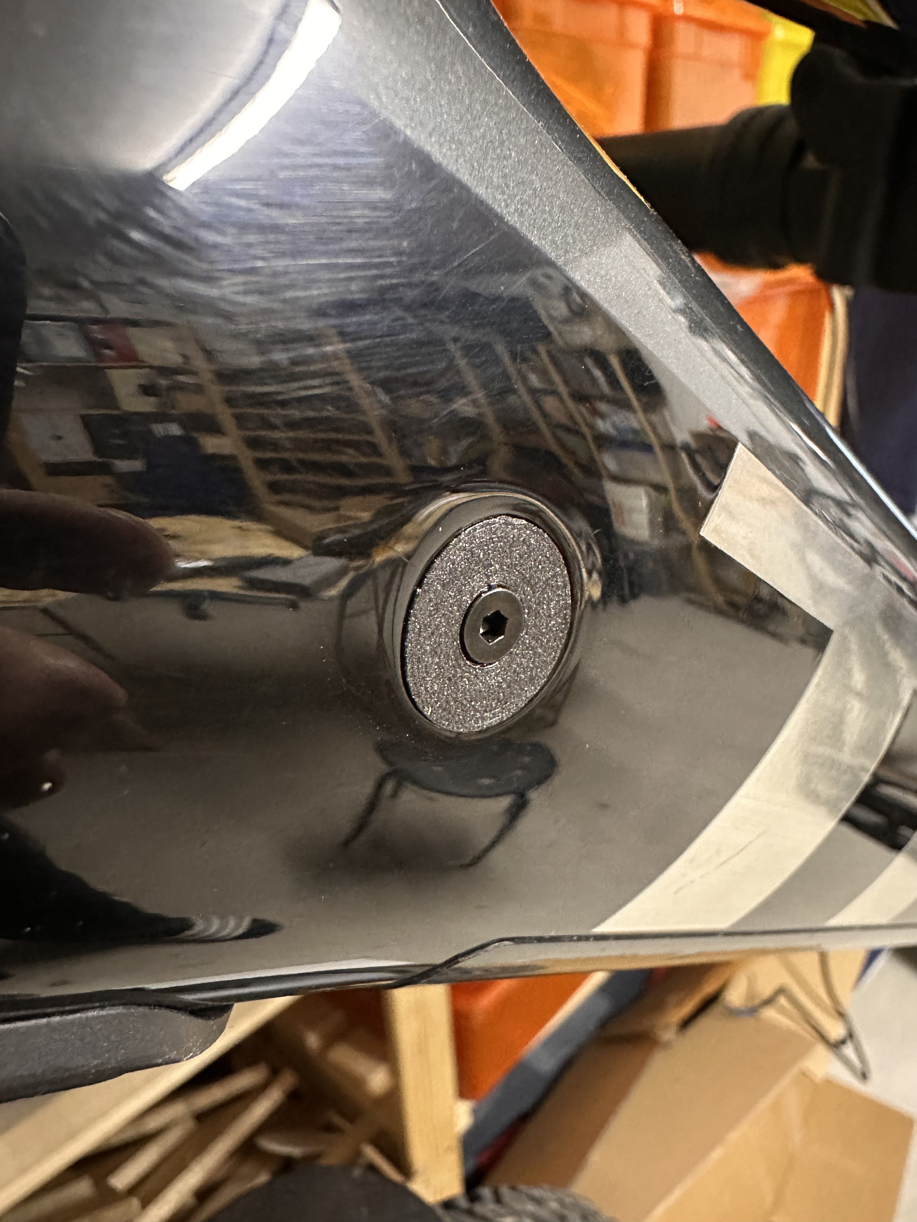

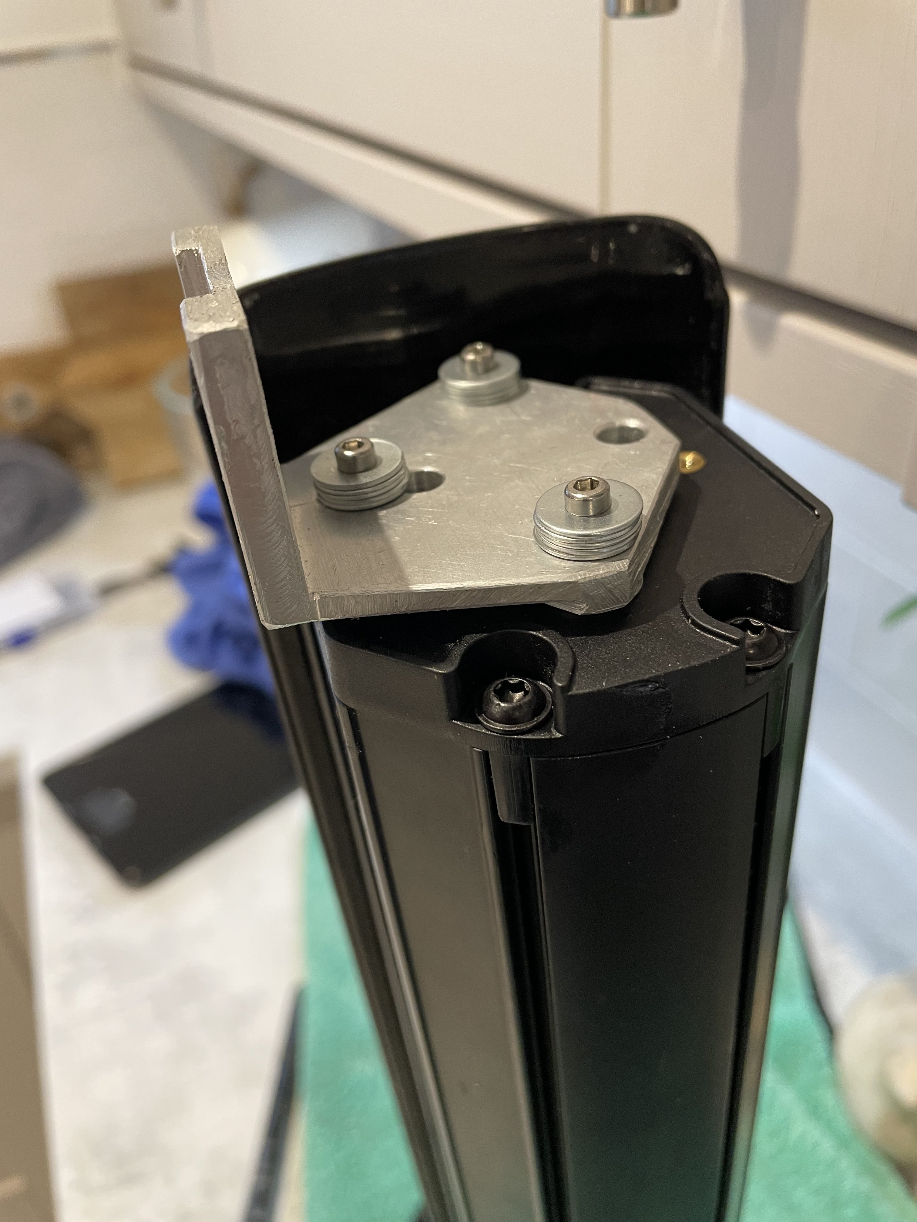

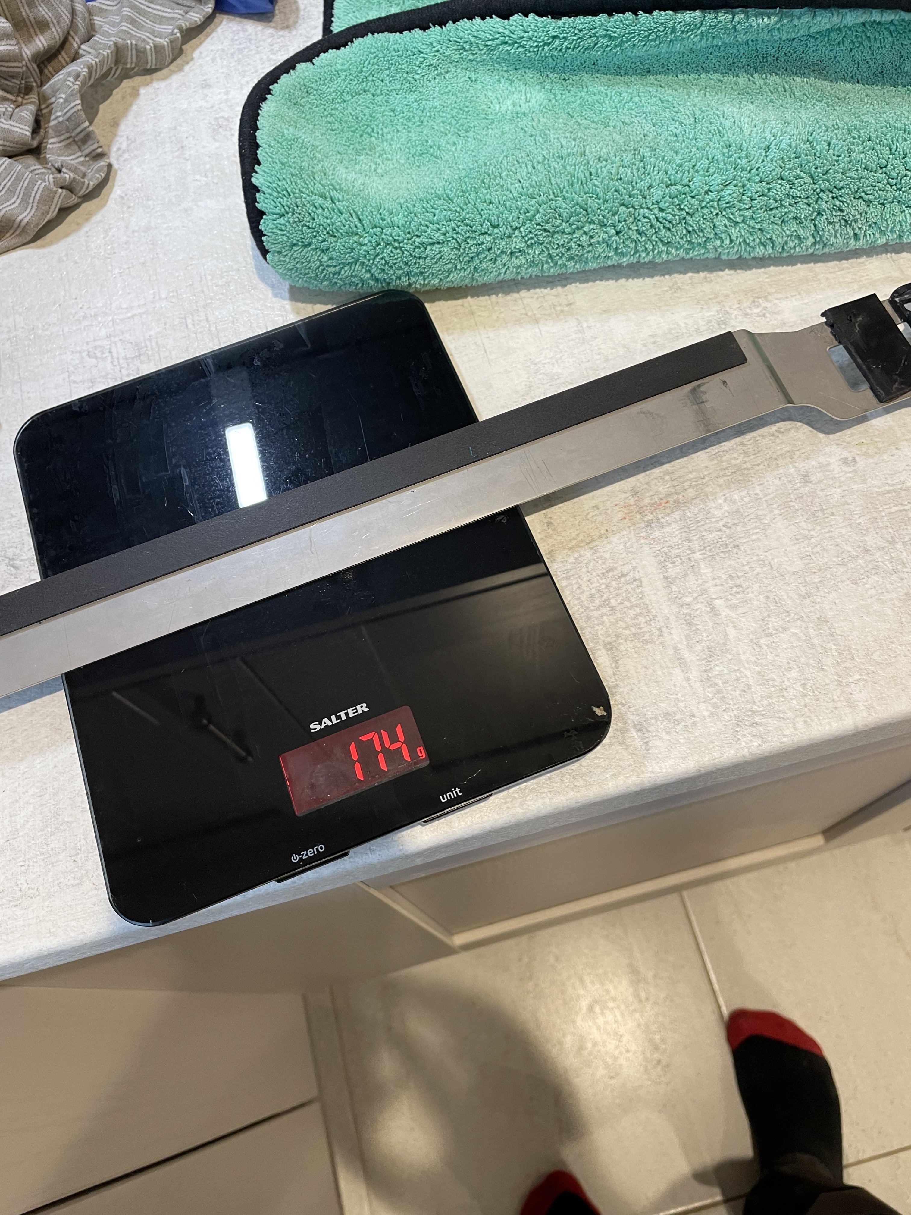

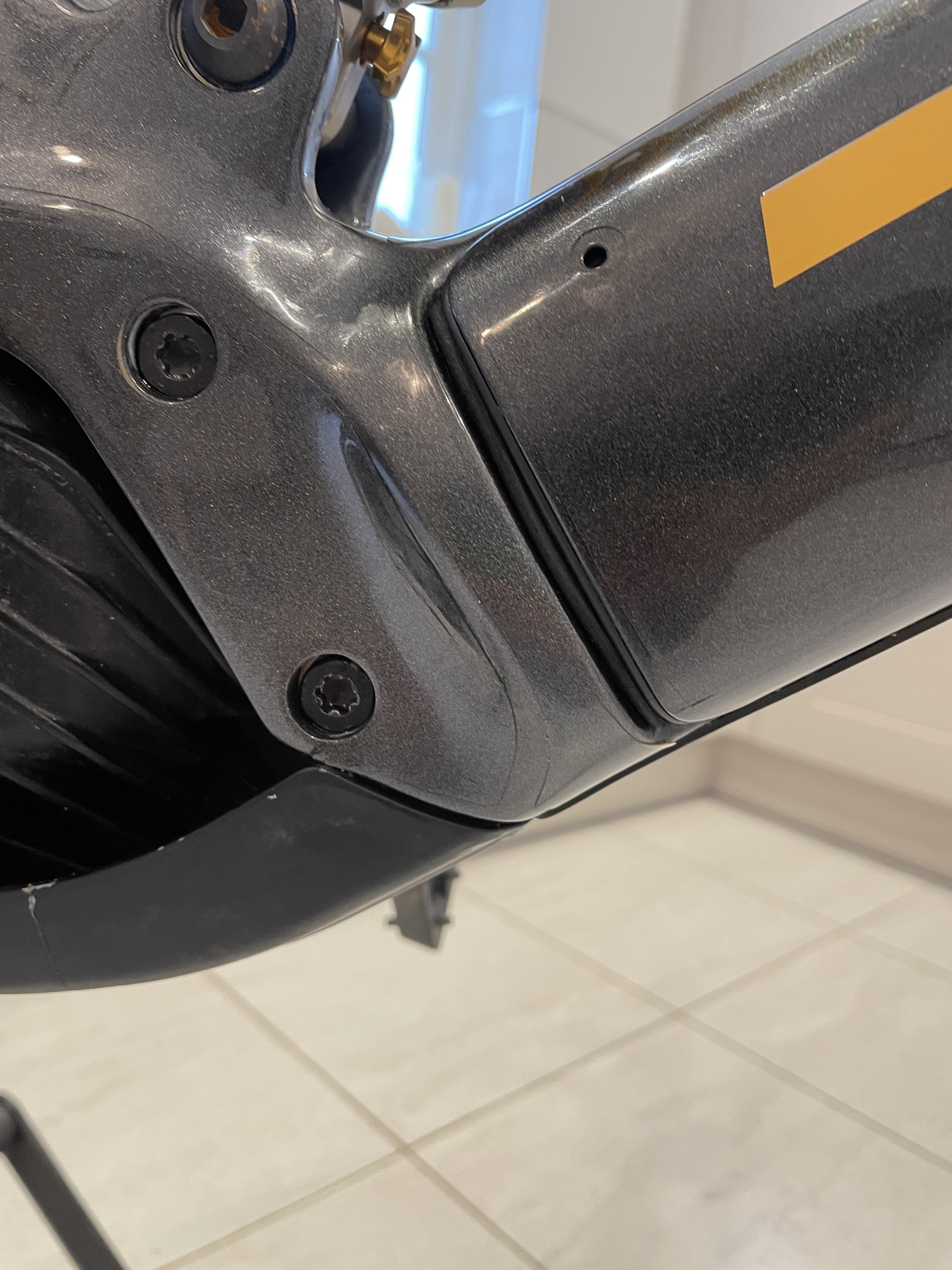

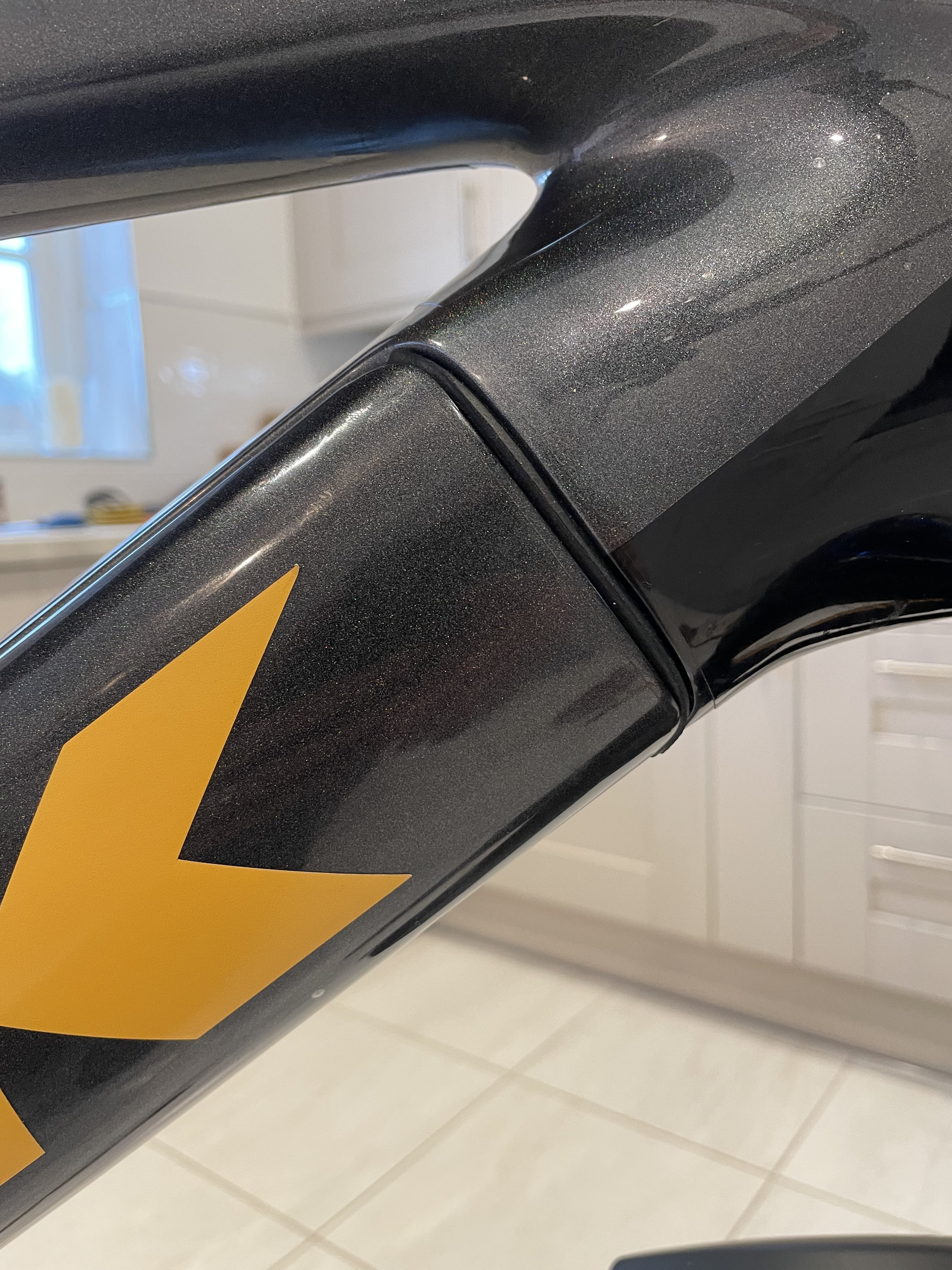

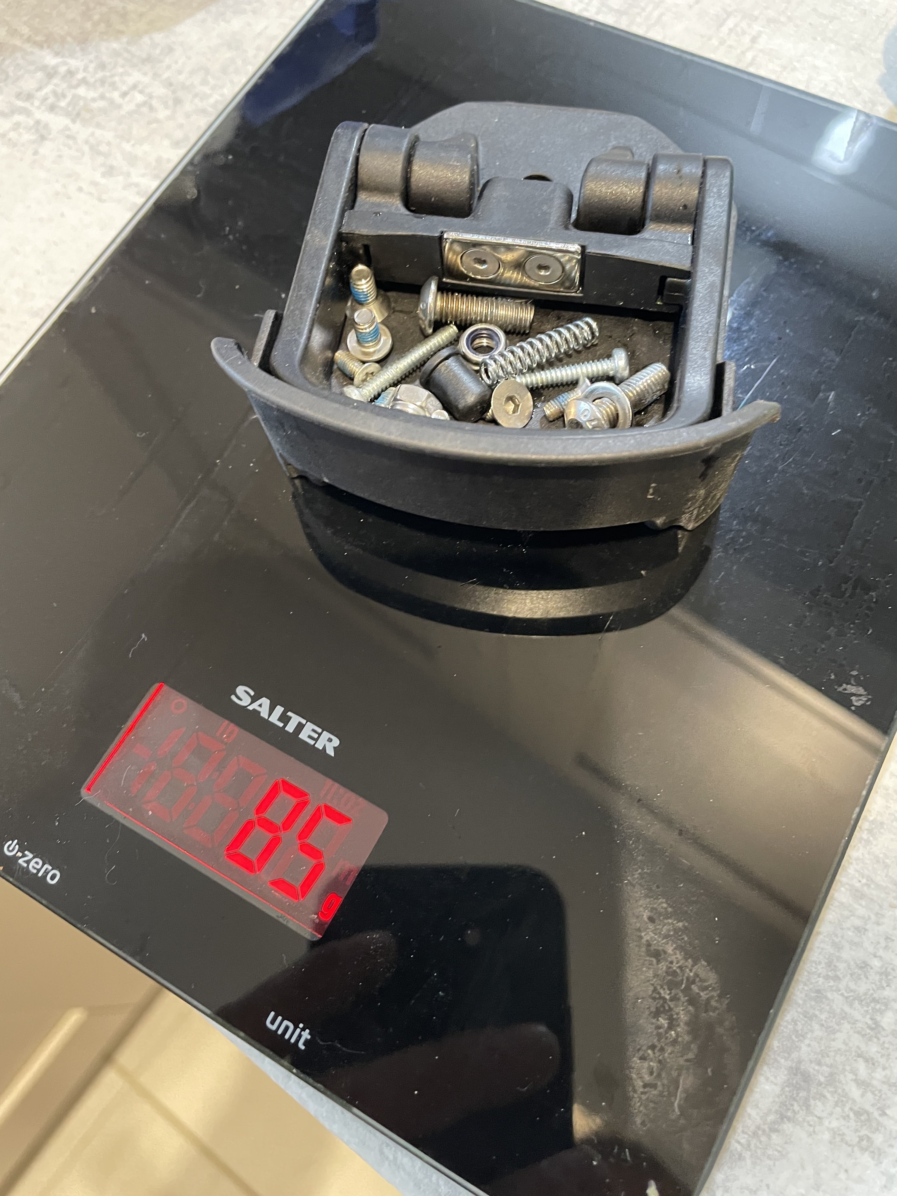

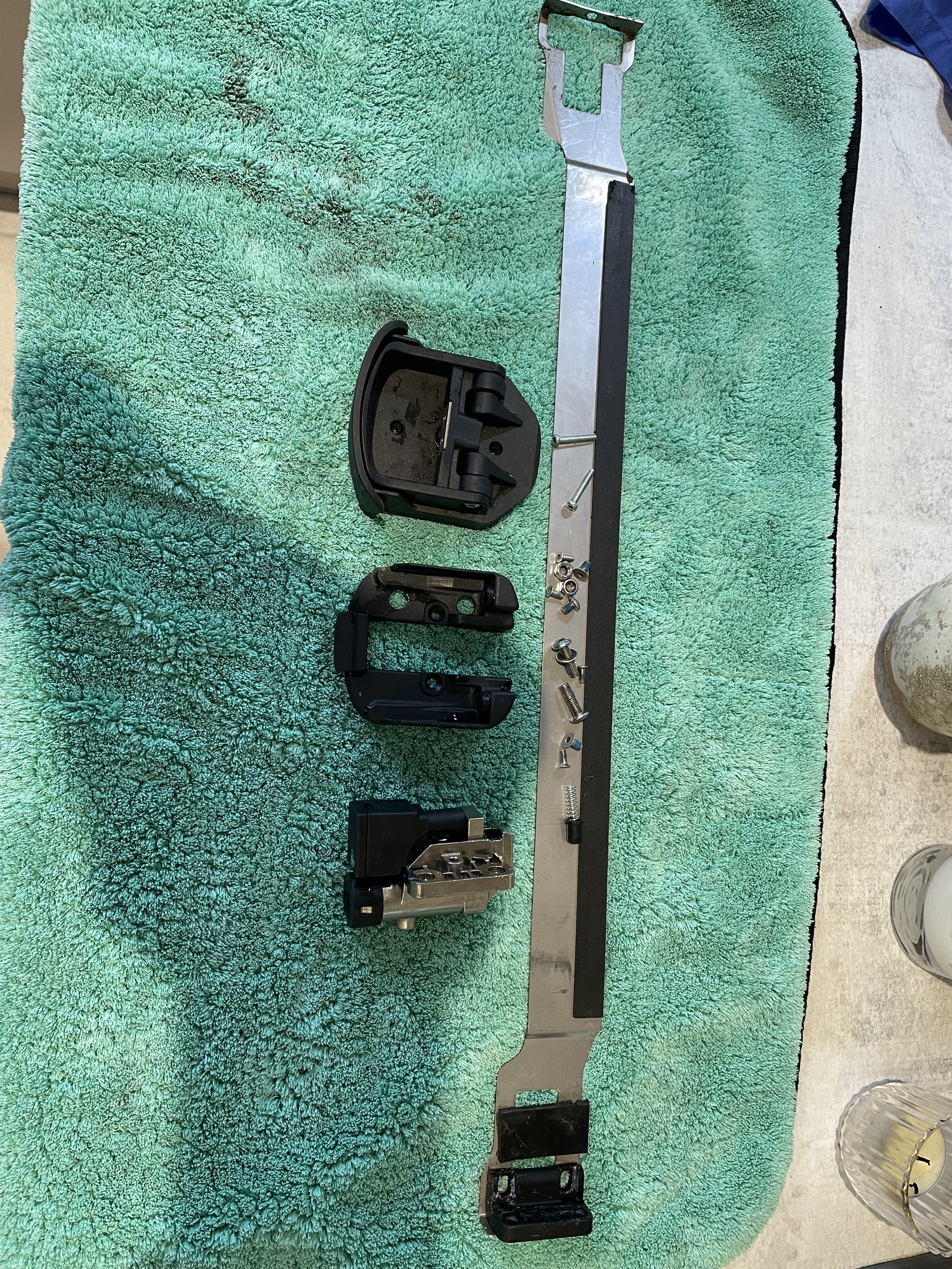

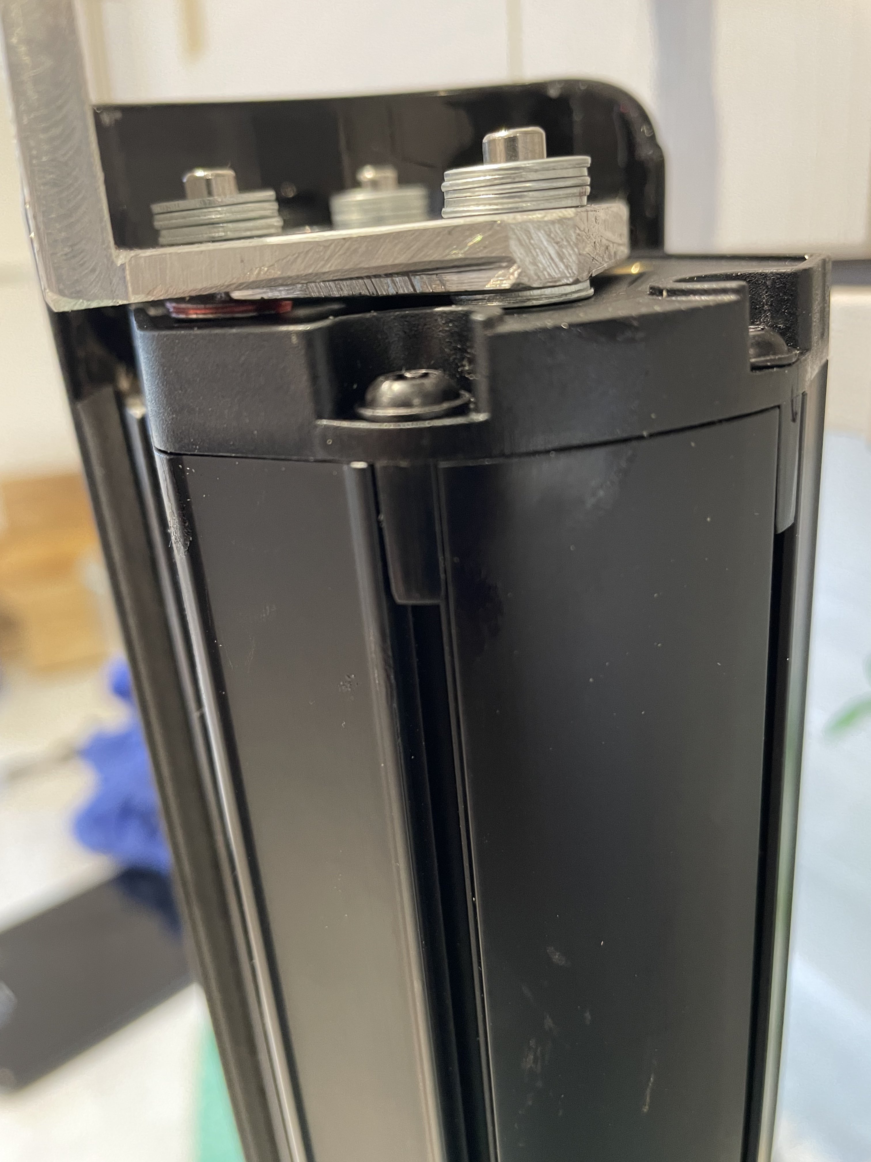

I fitted the bracket today to my 750wh Rail.
Took a while to get it lined up, had to drill one more hole into the bracket to align it to the 750 mounting holes.
There is a lot of stuff to remove. A bit of a faff getting the rail plate off, but not too difficult.
Weights and measures below.
I also used some P rubber to fill the top and bottom gap.
The bad news…. My intermittent electrical issue has returned but I’ll post separately about that.
View attachment 102070 View attachment 102071 View attachment 102072 View attachment 102073 View attachment 102074 View attachment 102075 View attachment 102076 View attachment 102077 View attachment 102078 View attachment 102079 View attachment 102080 View attachment 102081 View attachment 102082

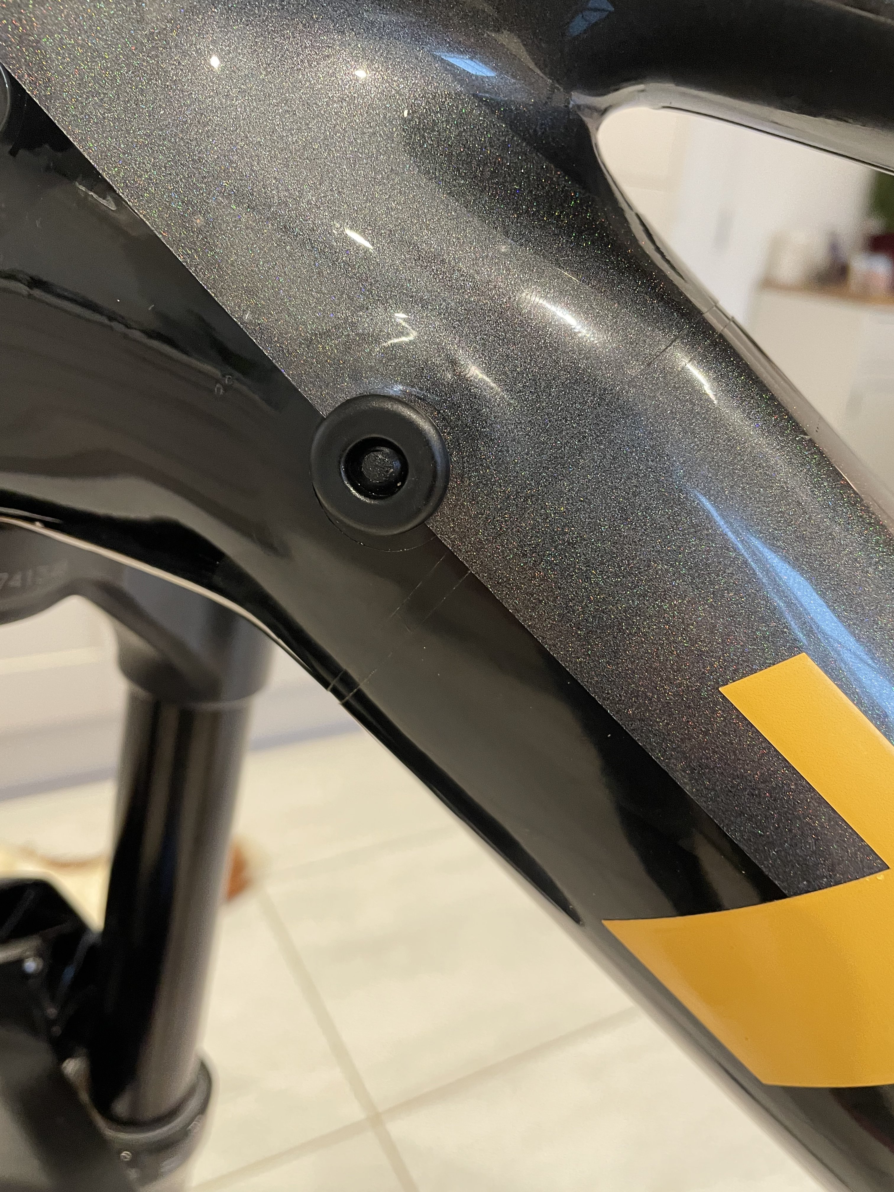

Bro, can you advise me how you get this Block to attach the key hole ?

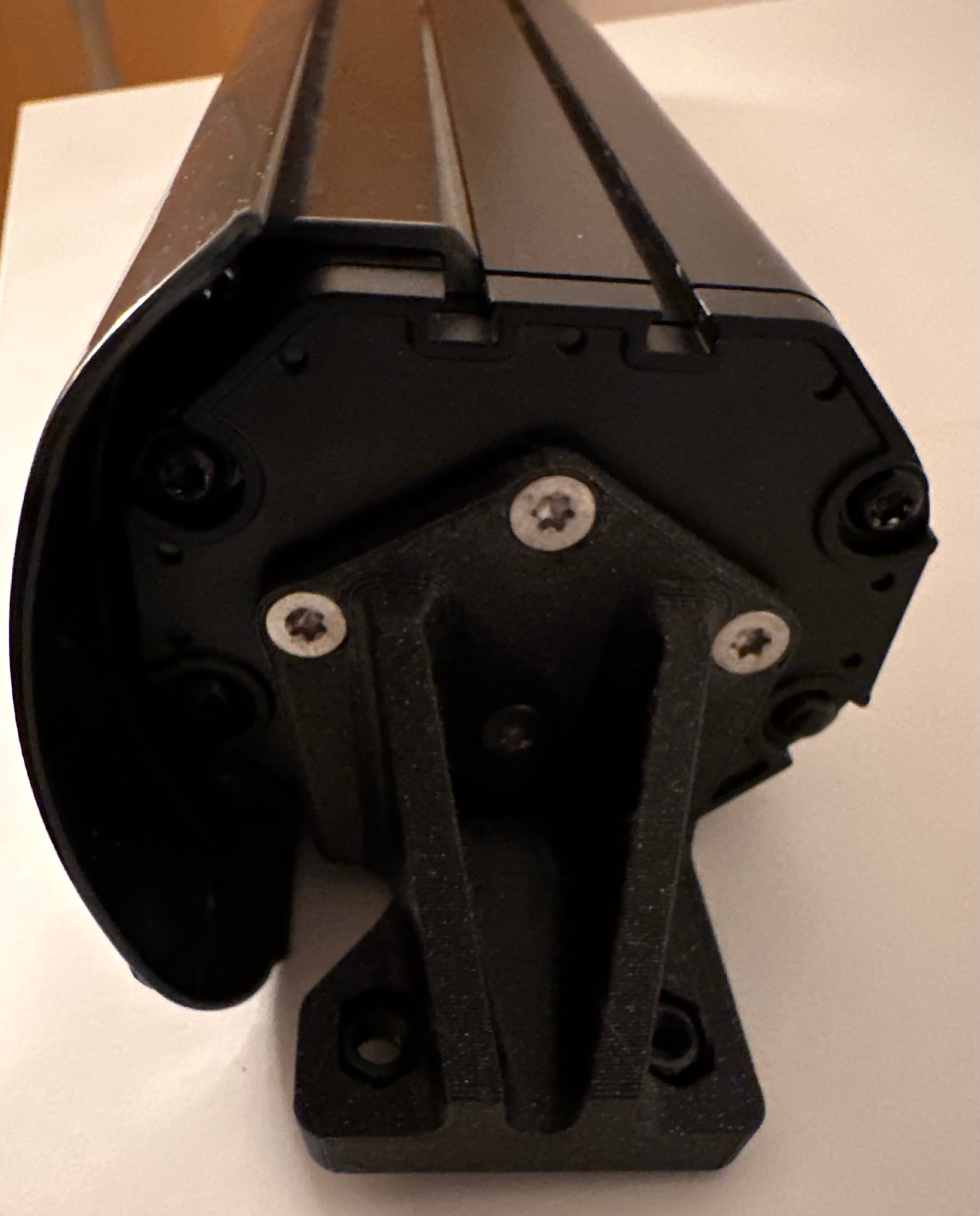

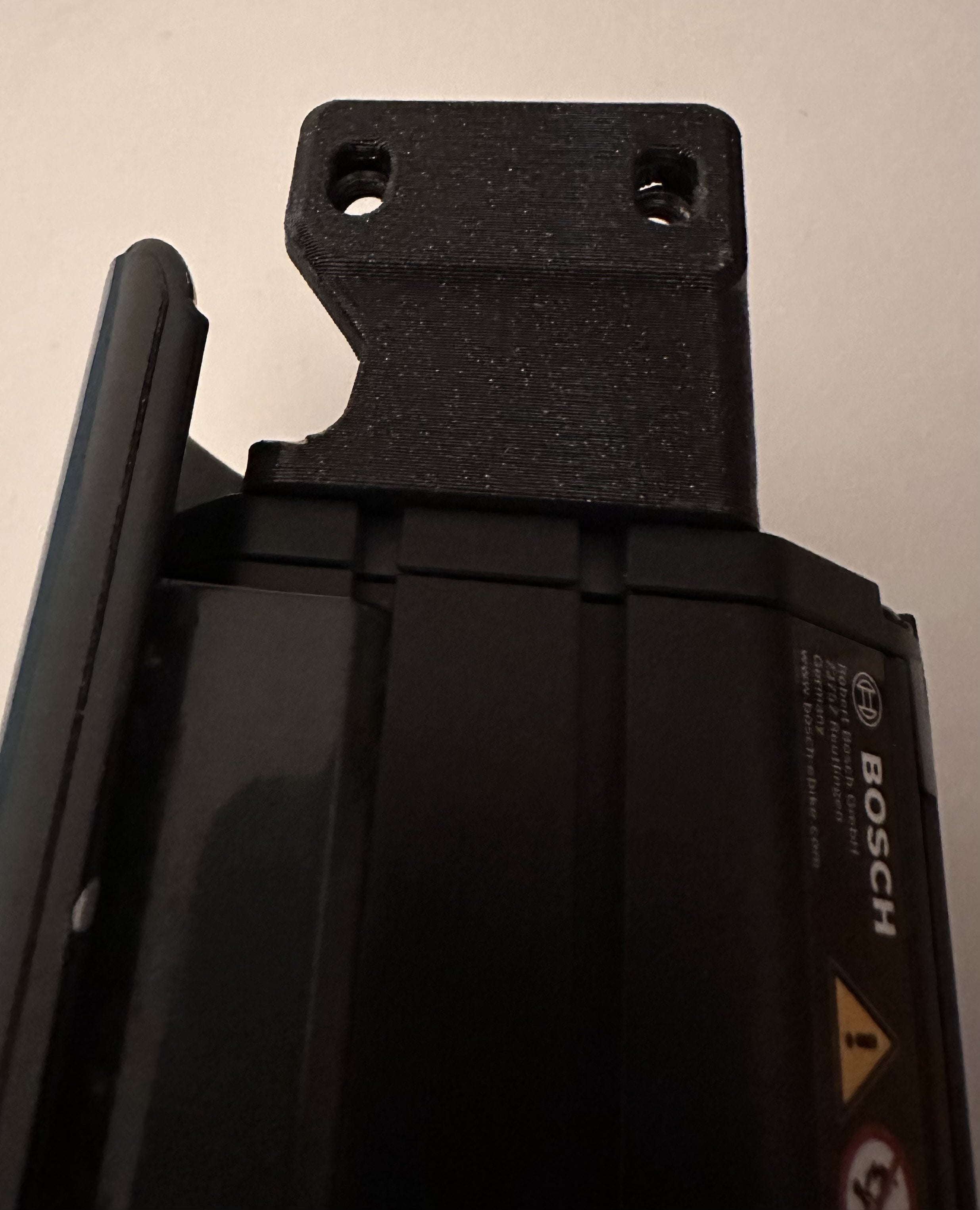

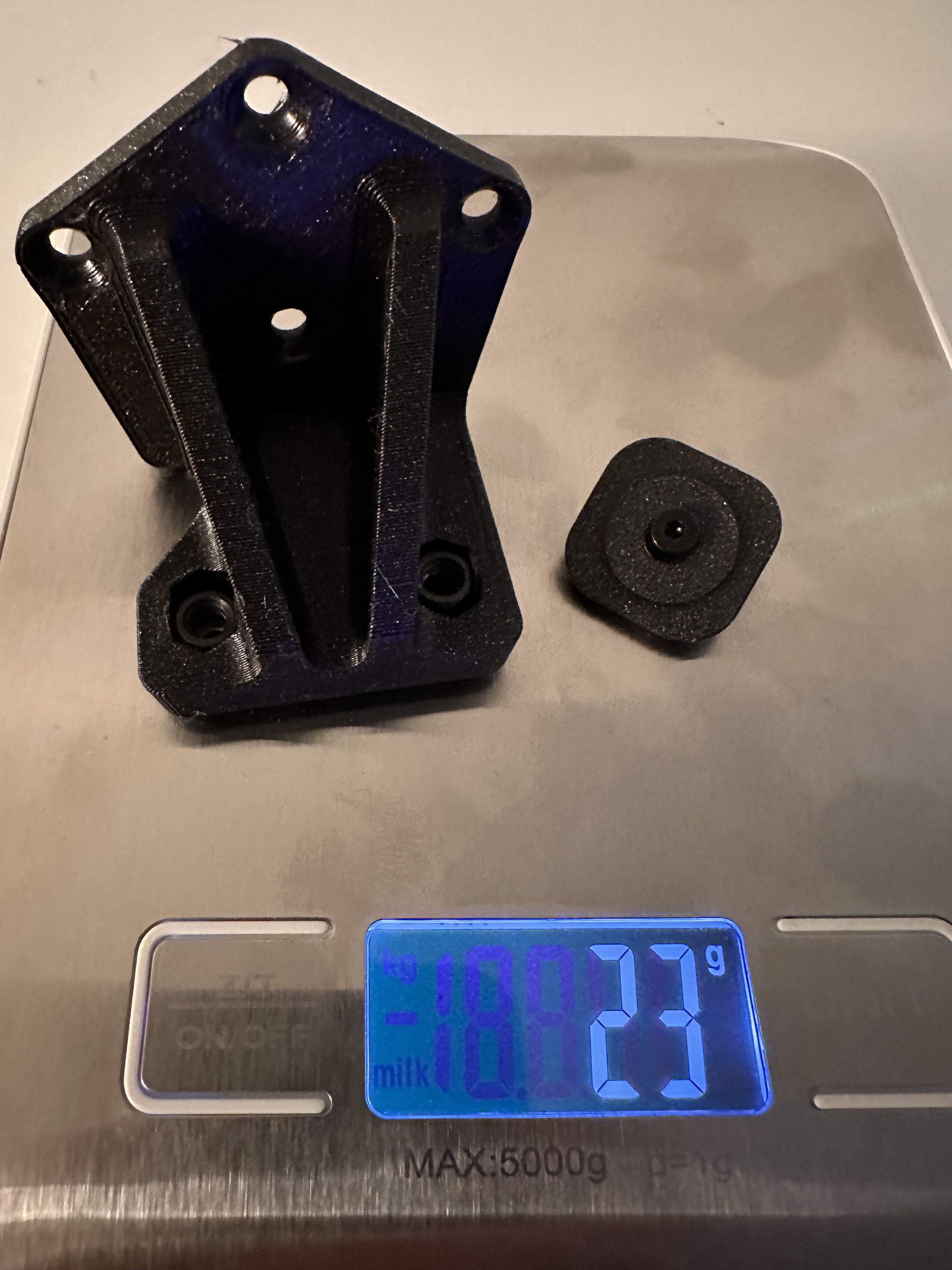

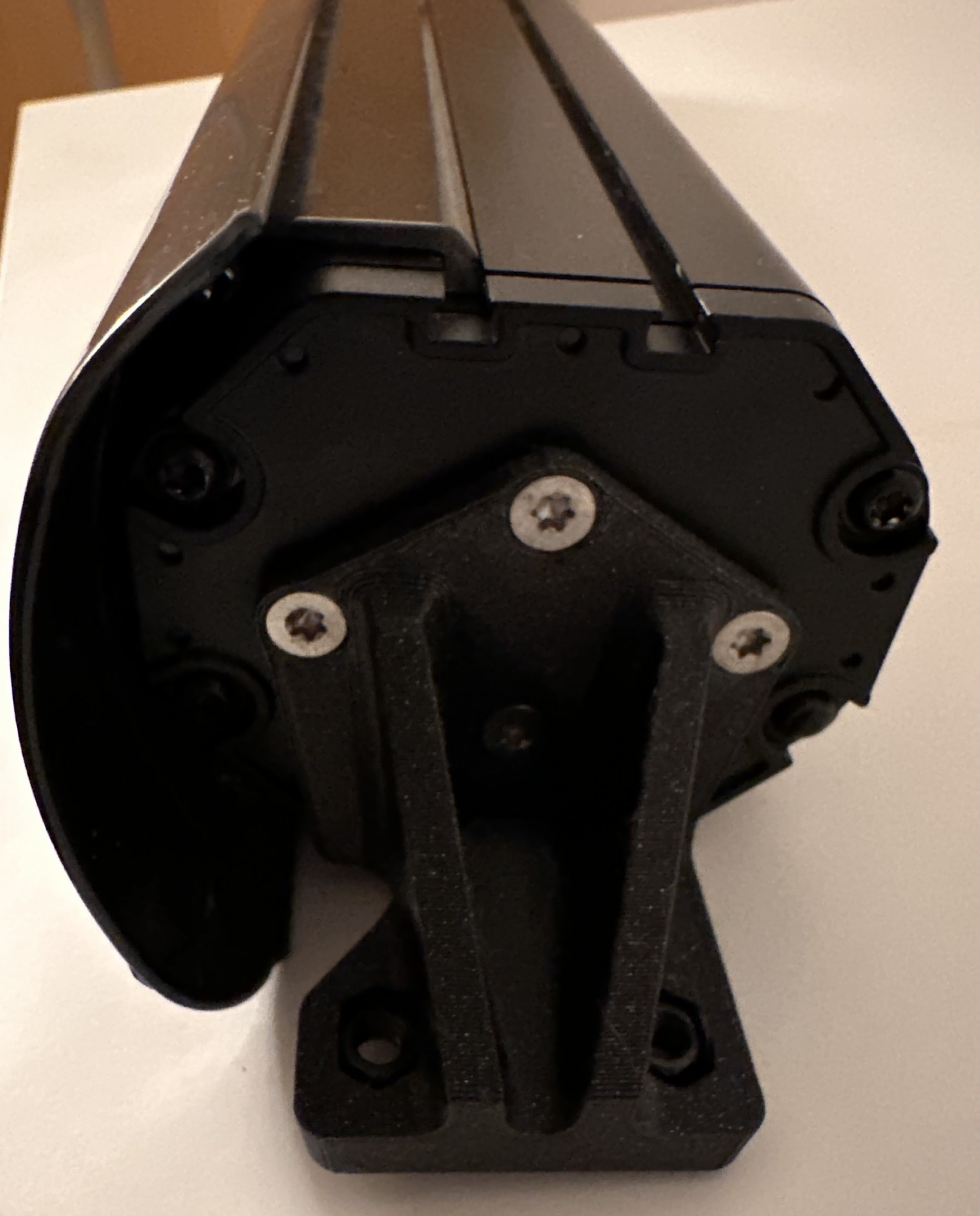

Request for Testers
Inspired by this post, I created a 3D Print Version including the bracket and a keyhole closer. Weight goes from 331gr down to 23gr. So far tested on Rail 9.9 and 9.8, Model Year 2021.
Out for testing on: 2020 Rail 9 - 625Wh, 2022 Rail 9 GX - 625Wh, 2023 Rail 9.8 GX - 750Wh
Drop me a PM, if you would like to test it.
Rules would be:
- I would need your Rail Model, Year, Battery Capacity, as well as your delivery Address.
- Testing audience is limited to the first requester per Model / Year.
- You cover the shipping plus production cost. Total would be for Switzerland CHF 11.0, Europe: 8€ and rest of the World 12$.
- You need a TORX T10, T20, T25H and 2mm allen key as well as some loctite screw lock.
- You will provide helpful feedback. Either a good to go or what would need to be changed to make it work on your bike.
Happy Rail Riding !

Request for Testers
Rules would be:
- I would need your Rail Model and Year, as well as your delivery Address.
- You cover the shipping cost: Switzerland CHF 8.0, Europe: 5€, rest of the World 9$
Happy Rail Riding

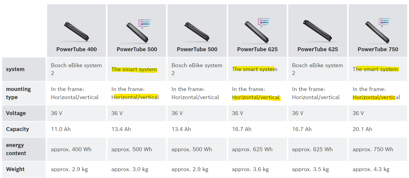

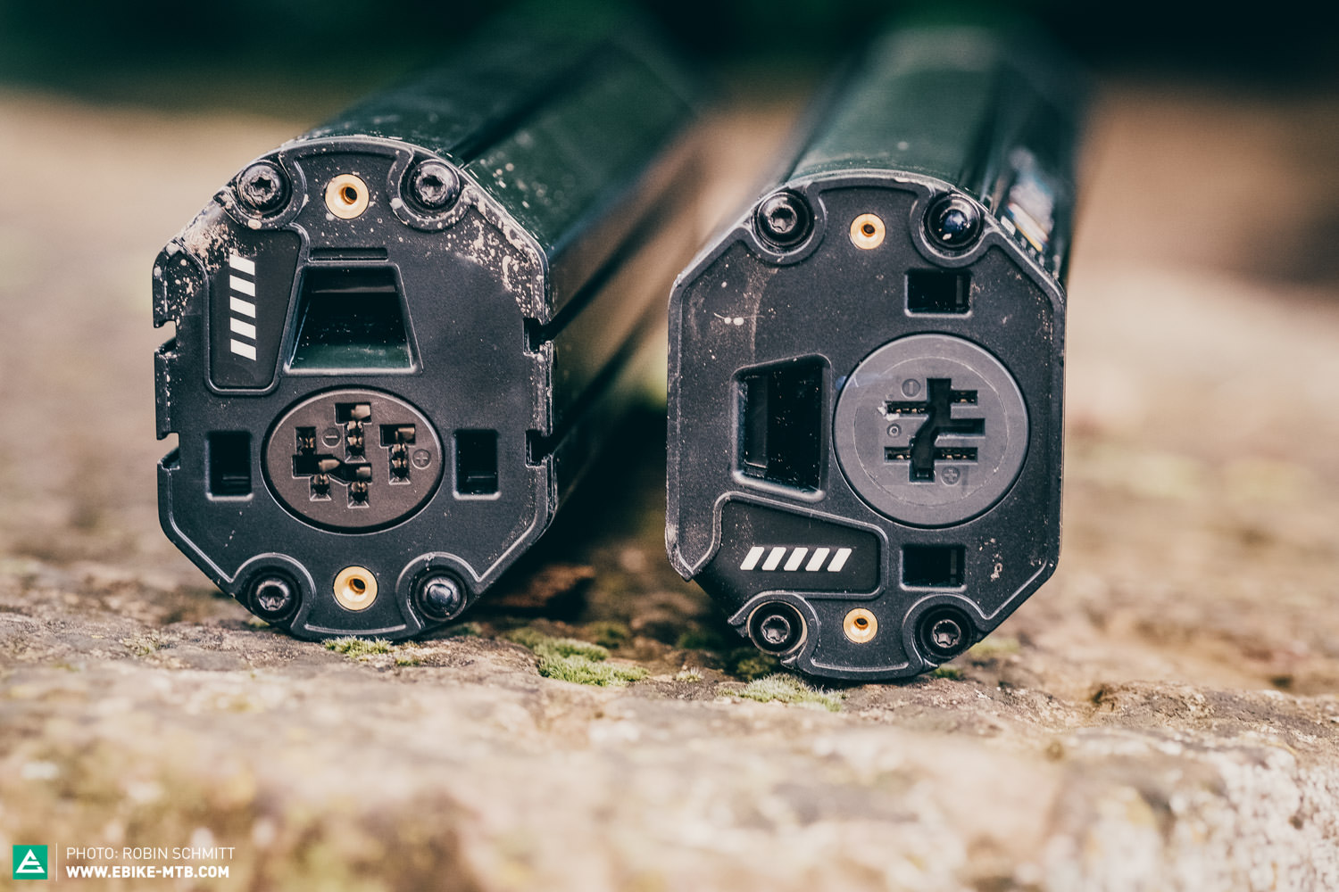

I can tell you from experience, the 750 battery has different mounting hole positions that the 625 battery. So you will need a different bracket design.
Dave_B
Aug 29, 2020
1,470
1,601
Newquay
The two central holes are in very different positions. I had to drill the bracket to get just one of them to fit.
