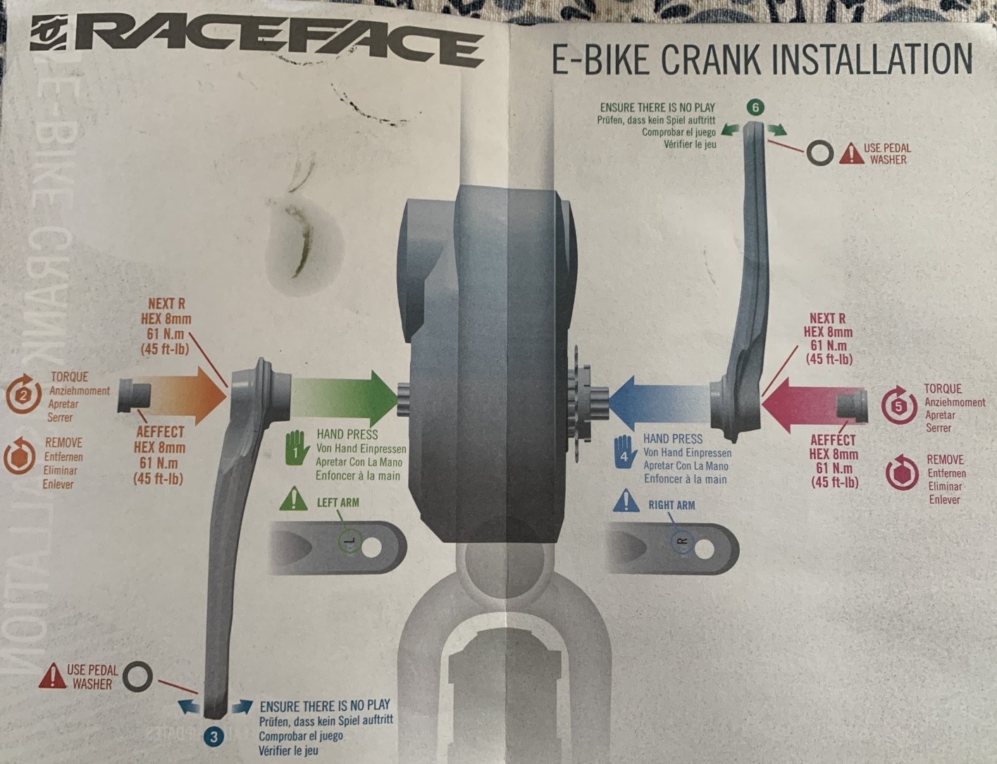

I installed 160mm aluminum e*spec arms on my Rail 9.7. At the end of my first ride (~24 miles), the driveside arm was wobbly loose while the non-driveside arm bolt was just in need of tightening. I contacted e*thirteen to inform them of the situation, stating I had used the original installation instructions as guidence with 40Nm applied to the hardware. They wanted to confirm I applied grease to the spindle and then suggested moving up to 45Nm torque for the bolts. I put the higher amount of torque to the hardware, added some paint lines for visual reference and all seems to be fine now after additional ride time.
I did the same thing and swapped to160mm e13 Crankarms but just torqued by feel and never had them come loose. Interesting that ur driveside was the wobbly side as its usually the non drive side falling off. I did have the original 165mm ND side fall off once.

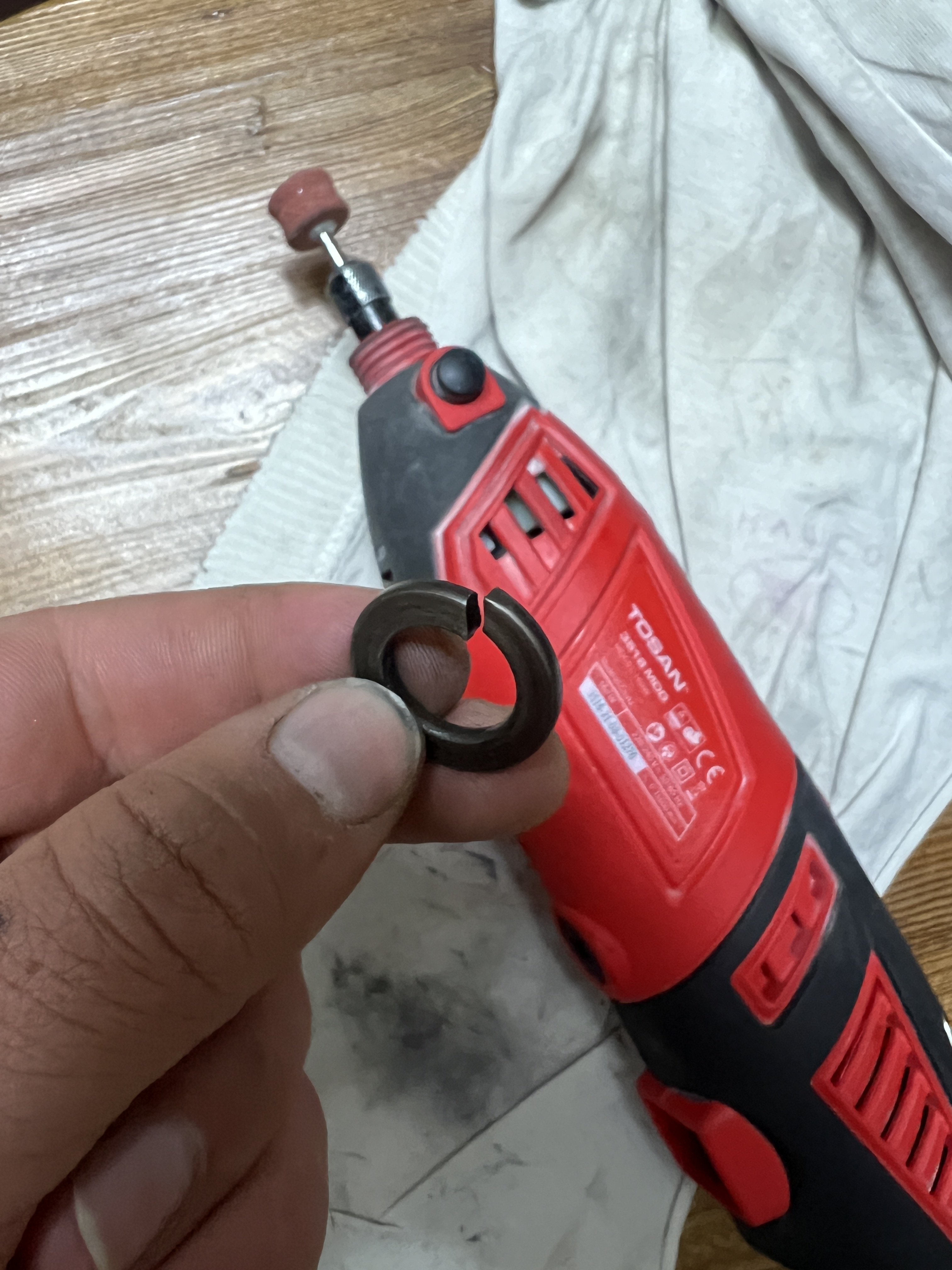

I started havin this issue.
Tighthening to the correct torque, sealant was every time a solution for a few weeks, then came loose again.
So now I tighten to the correct torque, bolt with sealant.
Support in the middle of side1, tap very hard with a big stiff rubber hammer in the middle of side2.
tighten to the correct torque again.
Didn't come loose for +-6 months now.
