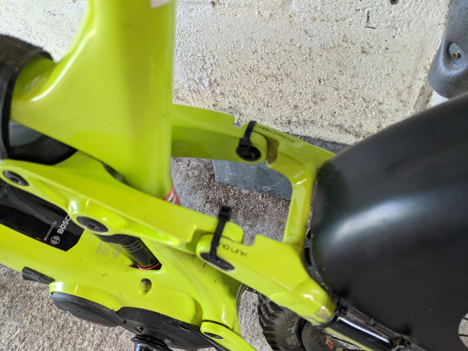

If anyone's wondering about swapping the mino link around and hasn't tried it before - it's 17nm torque. Don't over-grunt it - the bolt shears to protect the frame ( which is a good thing 👍 ).
I used the cable tie hack to ensure it won't come undone and if it does you won't lose it ( also a good thing 👍).
Don't do cable tie up real tight as the frame movement will break it.
I just used some loctite 243 and torqued up to spec... Been ok for 18 months.
