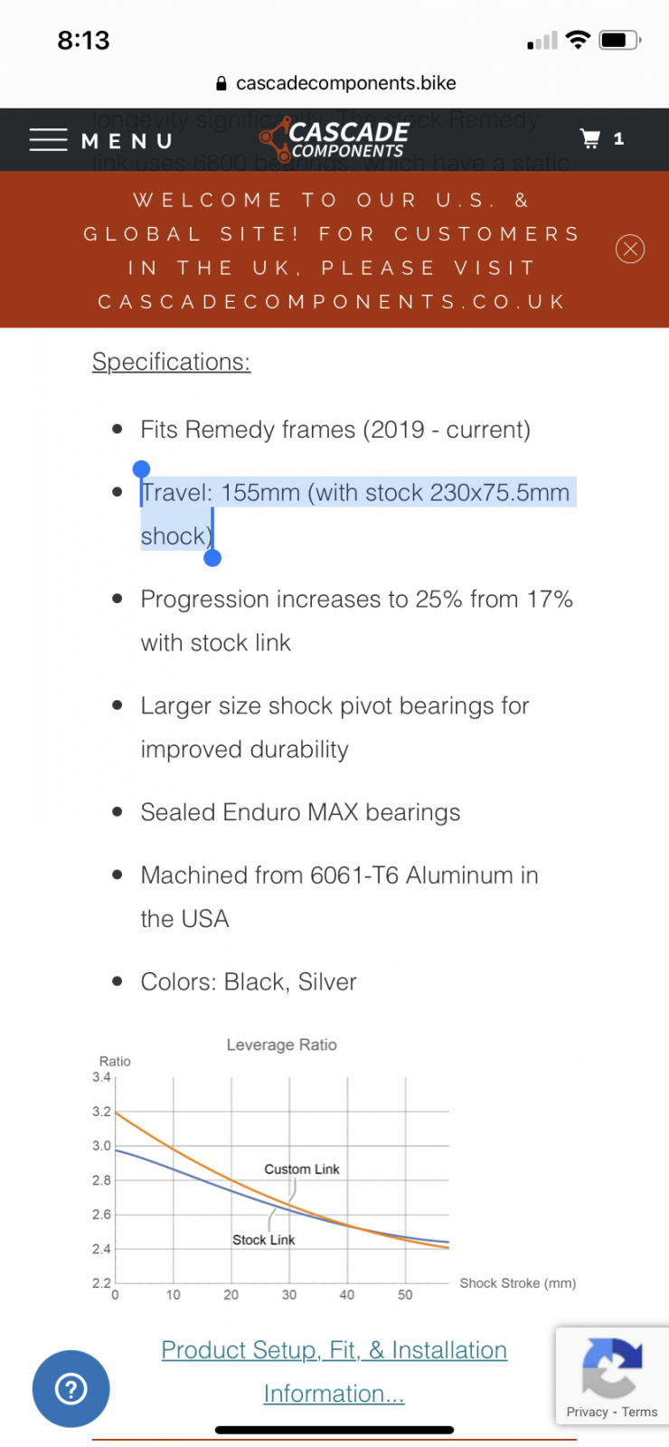

I emailed CC to see if it fit and they said it hadn't been tested. They did say if I bought one I could return it if it didn't work (pretty good). Before I did that, I thought i would ask on here.
For those who don't know it's designed for the Remedy and increases progression from 17% to 25% (good for coil) and increases travel to 155mm.
I've already long stroked my shock to 60mm, which gives me around 157mm, so would interested to see if it gives me 162mm without fouling the frame.
Thoughts?

I emailed them asking if it will fit.
assuming their listed shock size of 75.5 is a typo, as the remedy uses 57.5 same as the rail.

It's a typo.
And I doubt it fits anyway - just because the shock is the same size is no guarantee, the pivot dimensions, spacing & SS mounts would all need to be identical, which is hugely unlikely.
