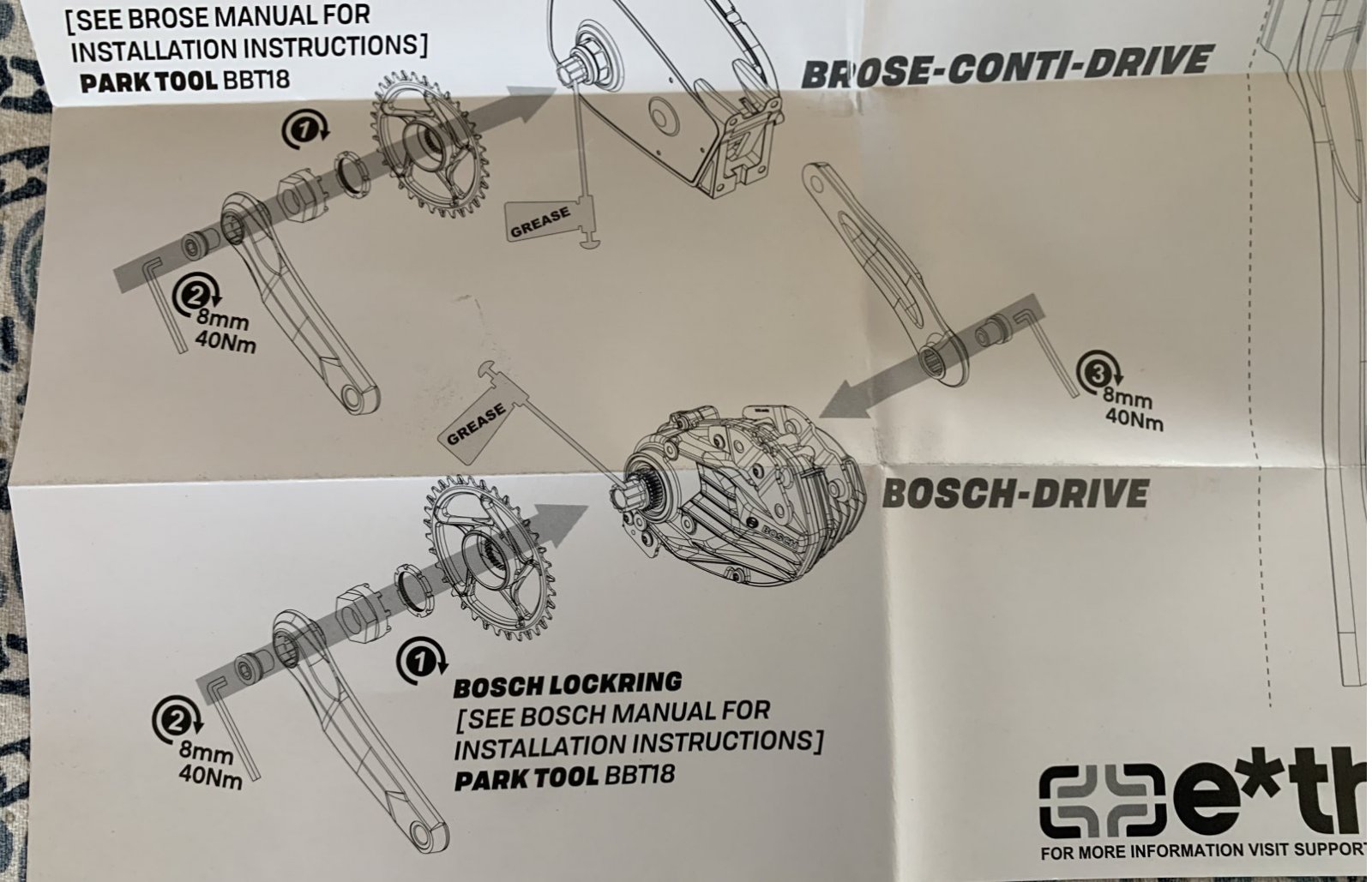

The Rail has a Bosch motor, which is 40Nm. Shimano figures are irrelevant and potentially confusing in this thread.
Yup - he mentioned a Rise as well. Thanks for the clarification though and sorry for causing any confusion. Cheers.

My recommendation is to torque to 40 NM right after you get it, then after a few miles, then again after a few rides. In my experience, it doesn't come loose after that. I do this after EVERY time I pull the crank.

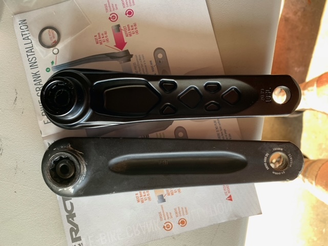

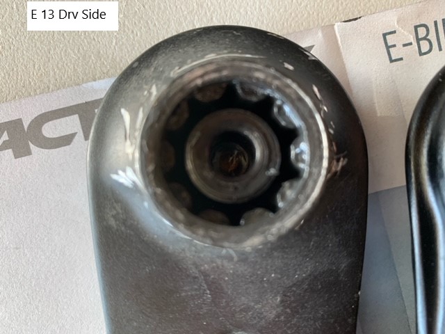

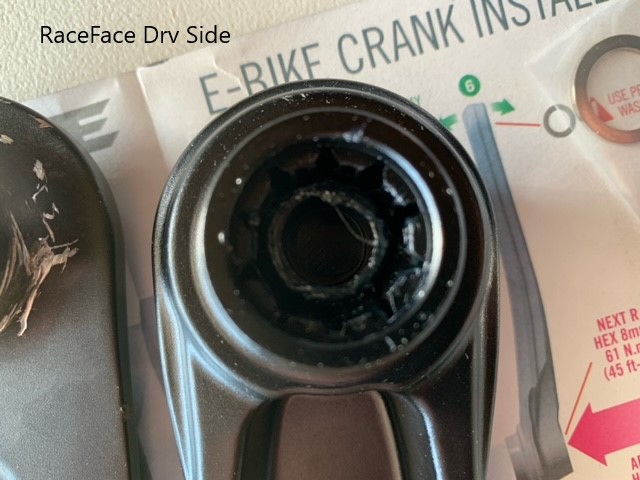

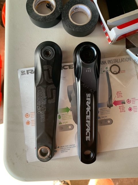

I have replaced the E13 cranks with Raceface Aeffect cranks. So far, so good. The RF Cranks state 45ftlb of torque. I tighten them in stages, cause 45 seemed super tight. All went well, 15miles of hills streets and jumps, not a budge. E13 drive side was needing a tighten 3-4 times during the same ride.
Pics of both cranks below -
Hard to see in the photos, but the RF crank has much tighter tolerances in the splines and gap between the bolt.

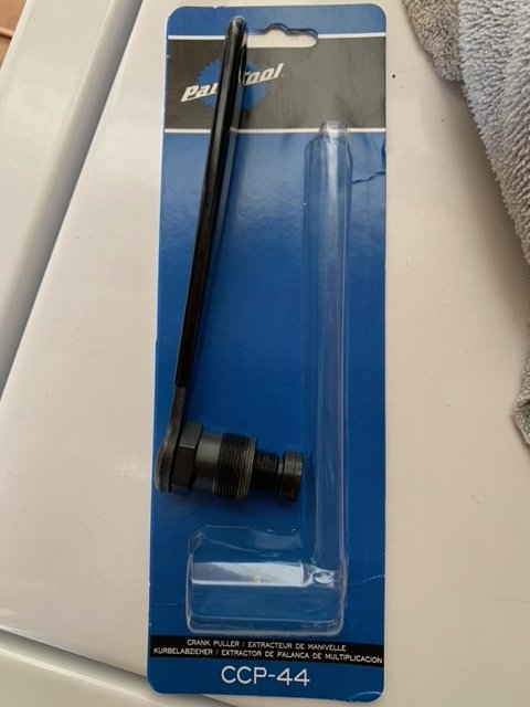

The non-Drive side needed a puller to come off - $17 - pic of tool attached
