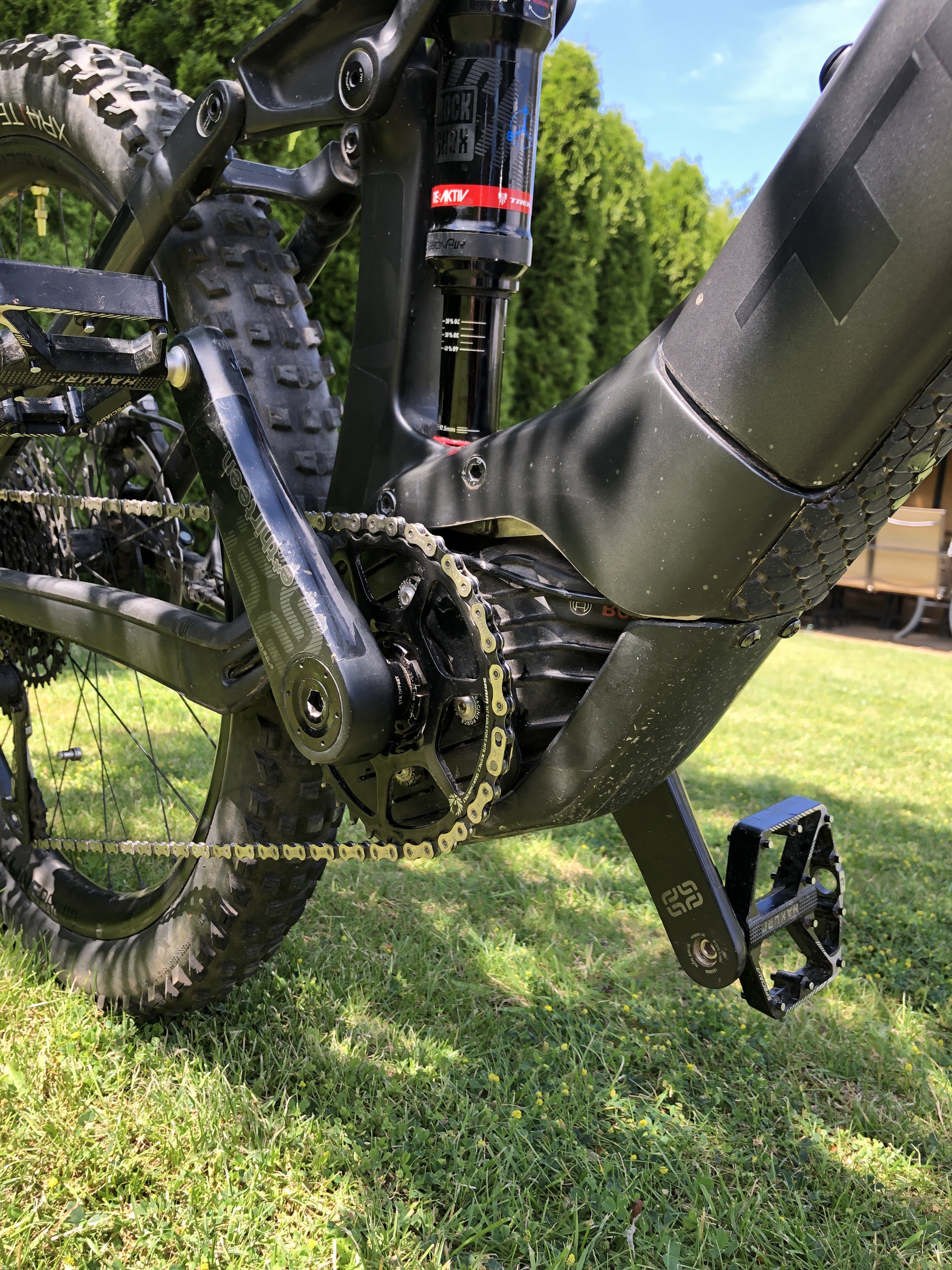

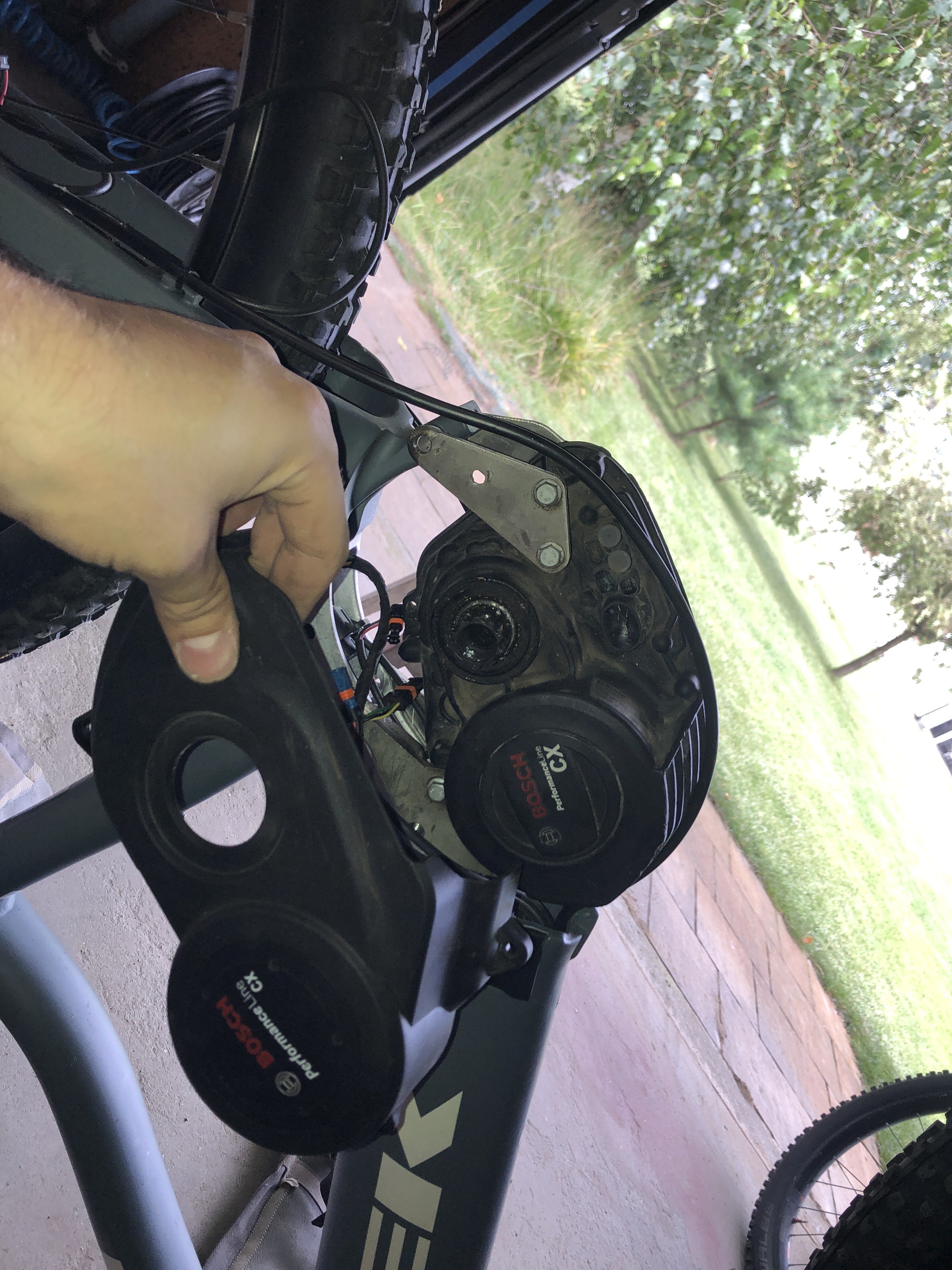

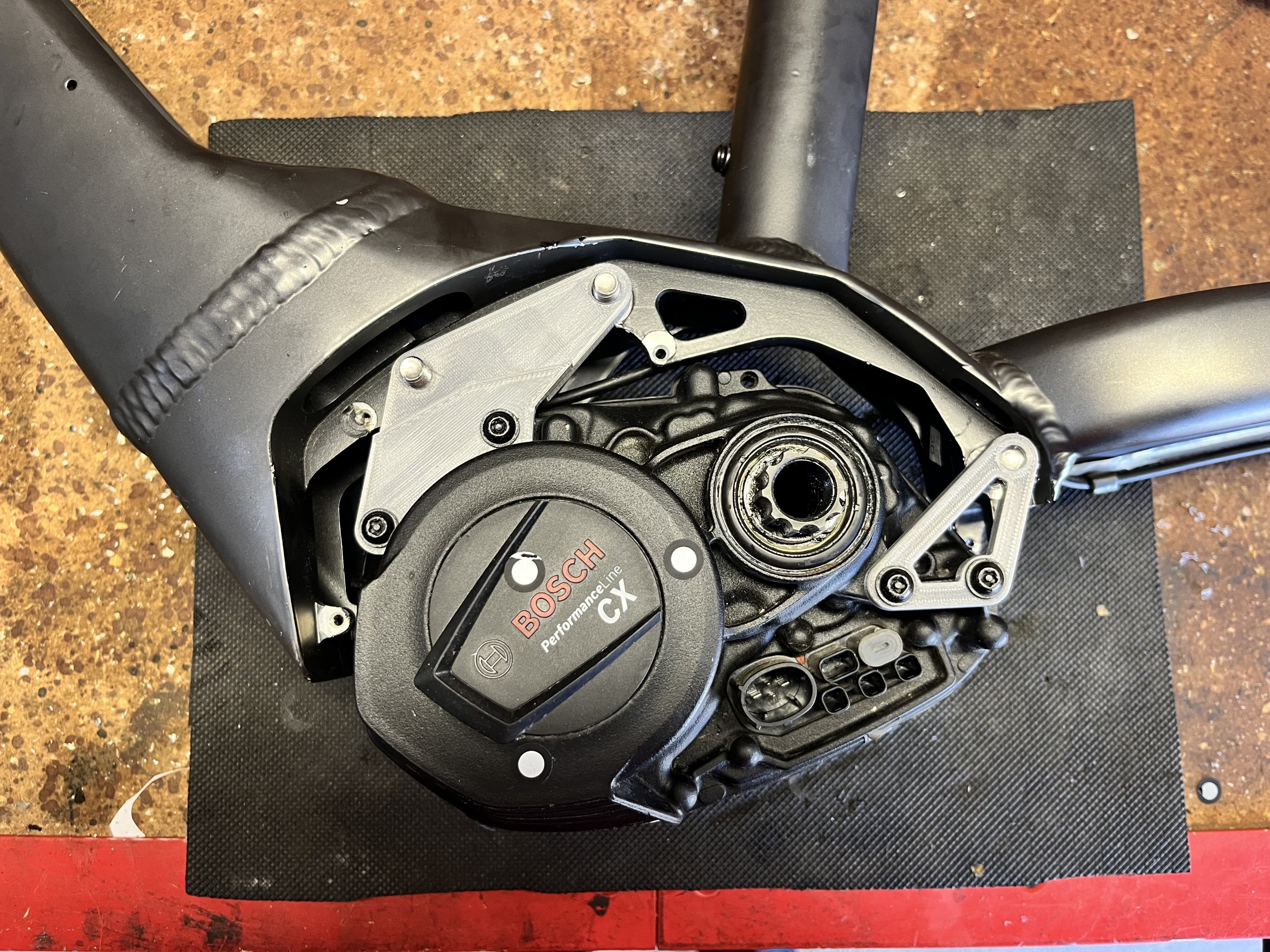

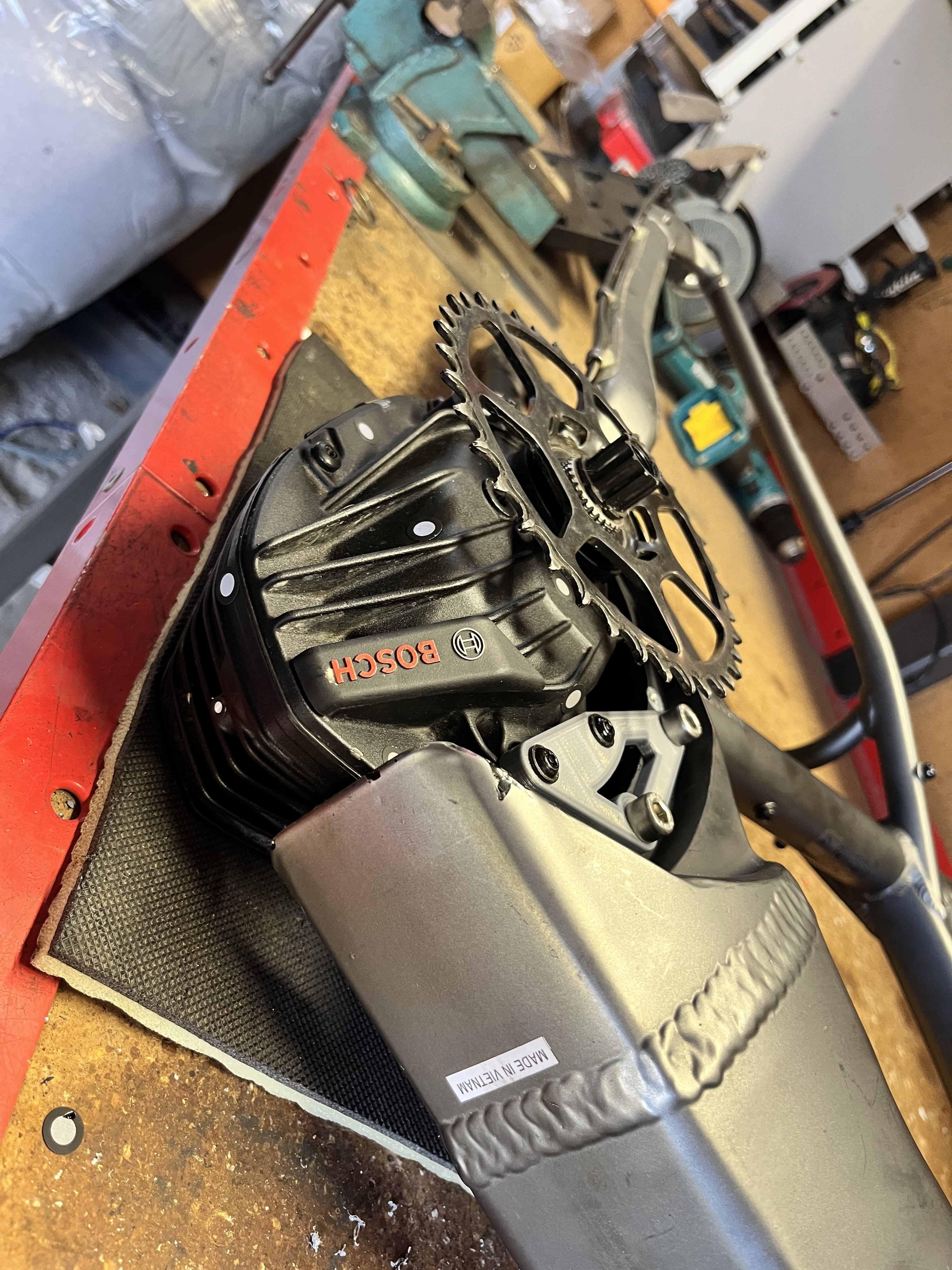

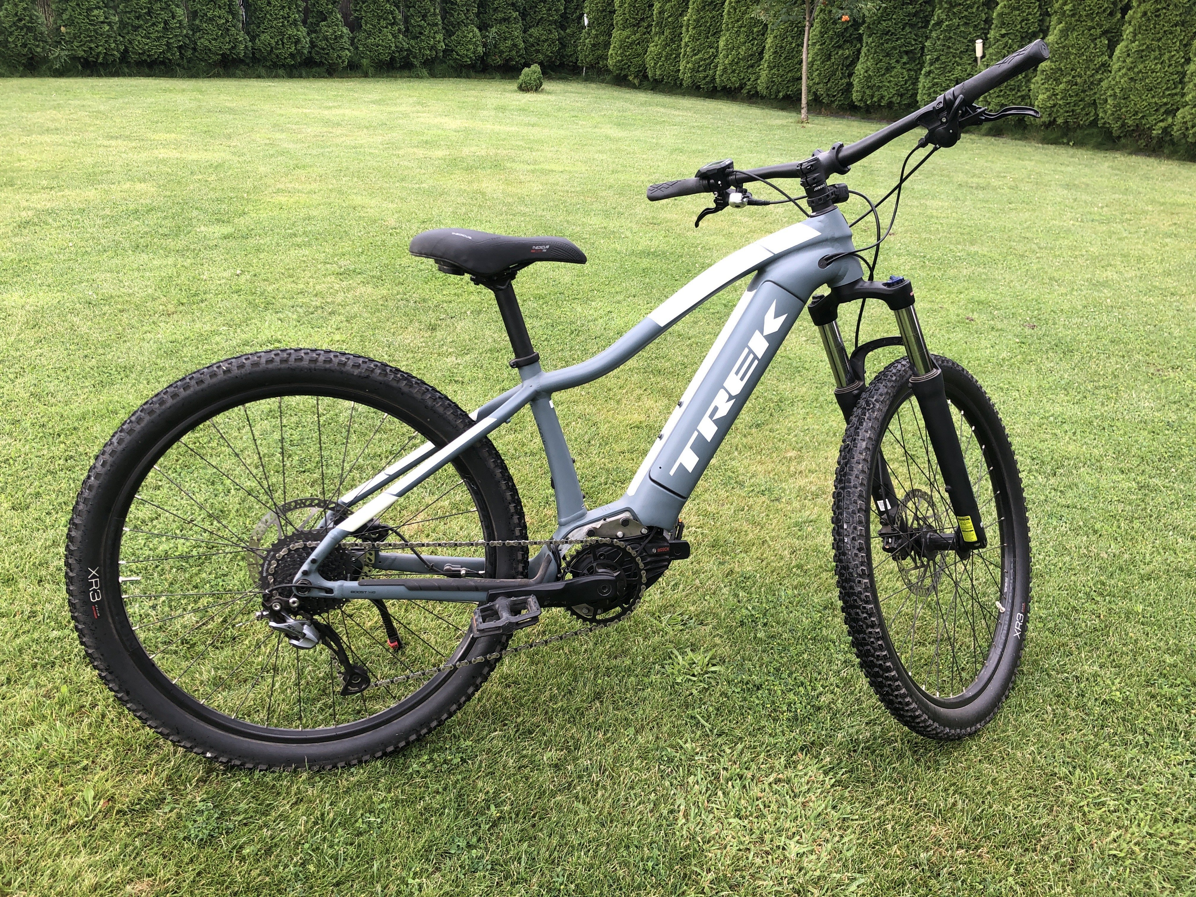

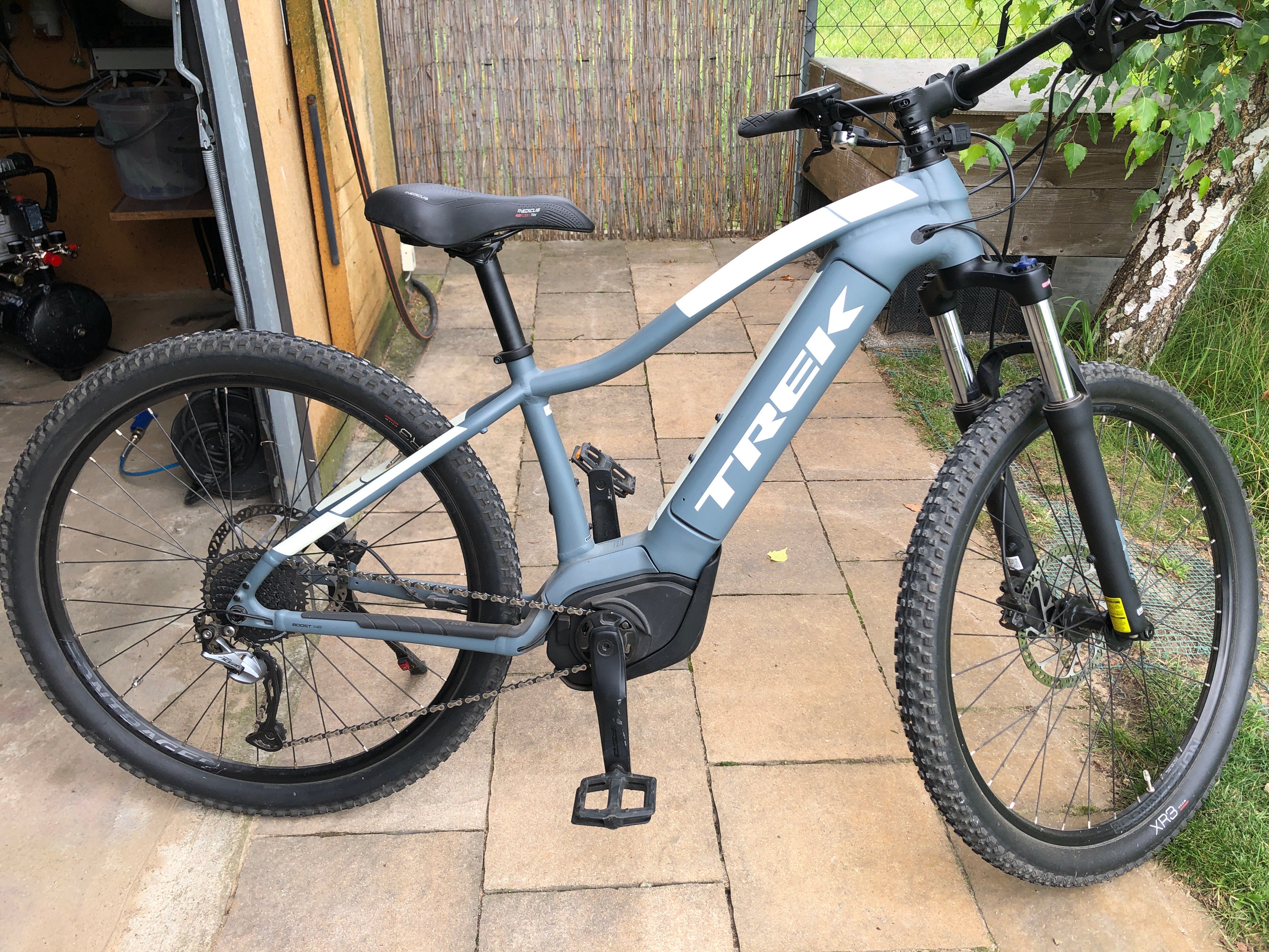

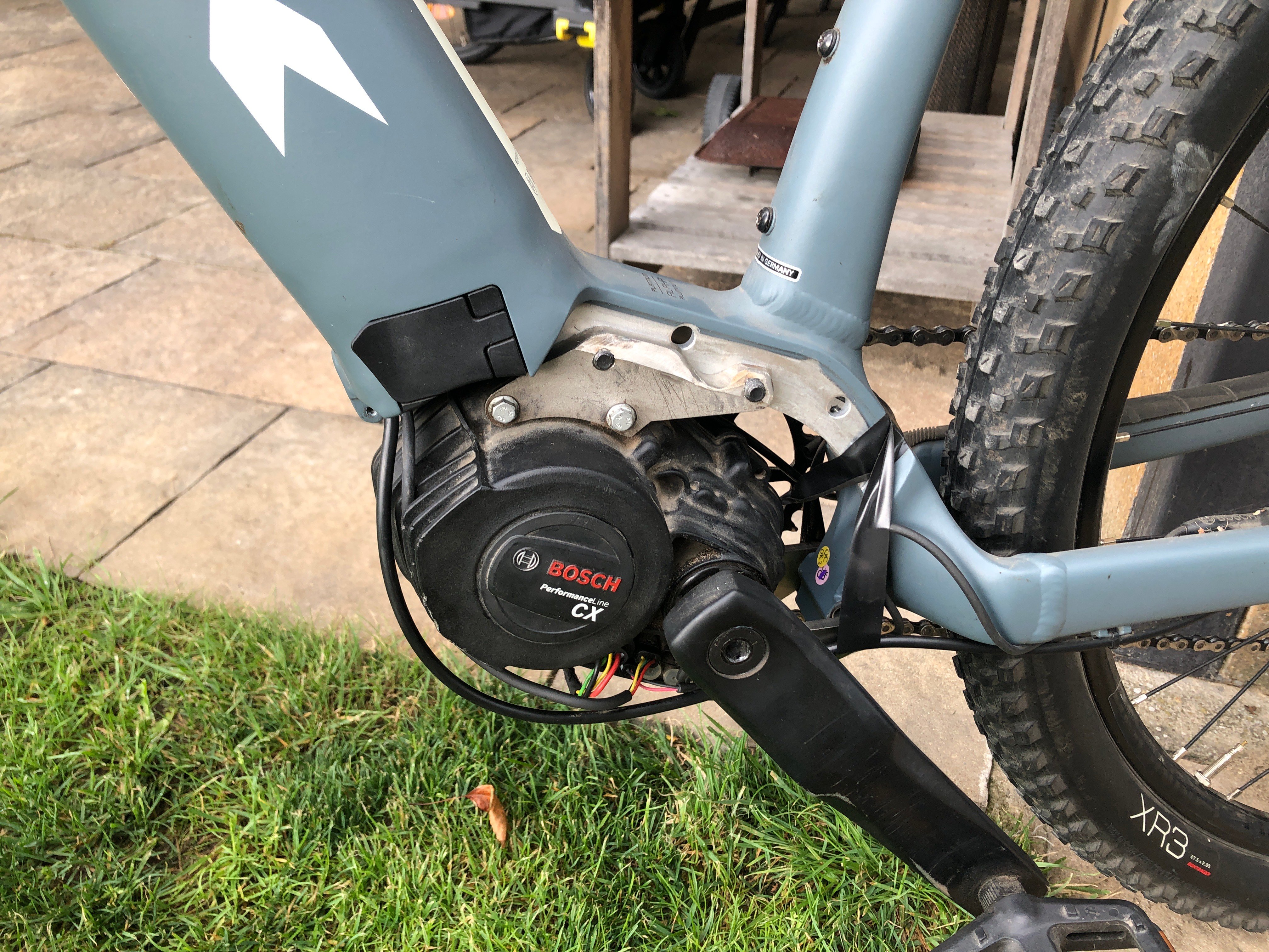

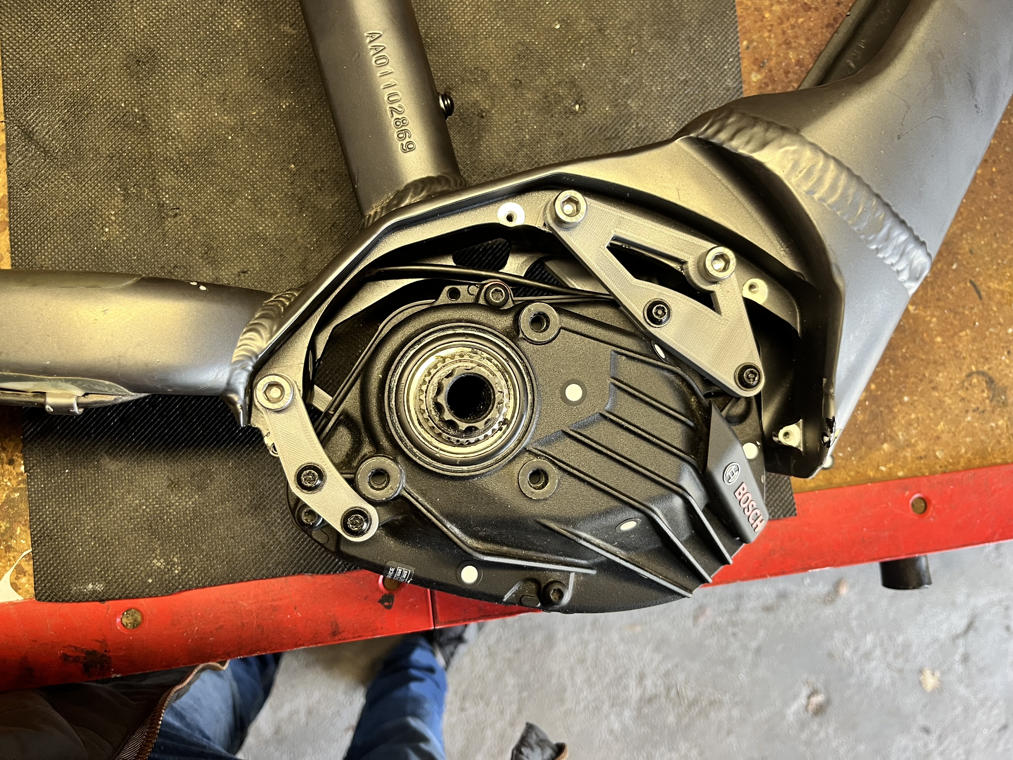

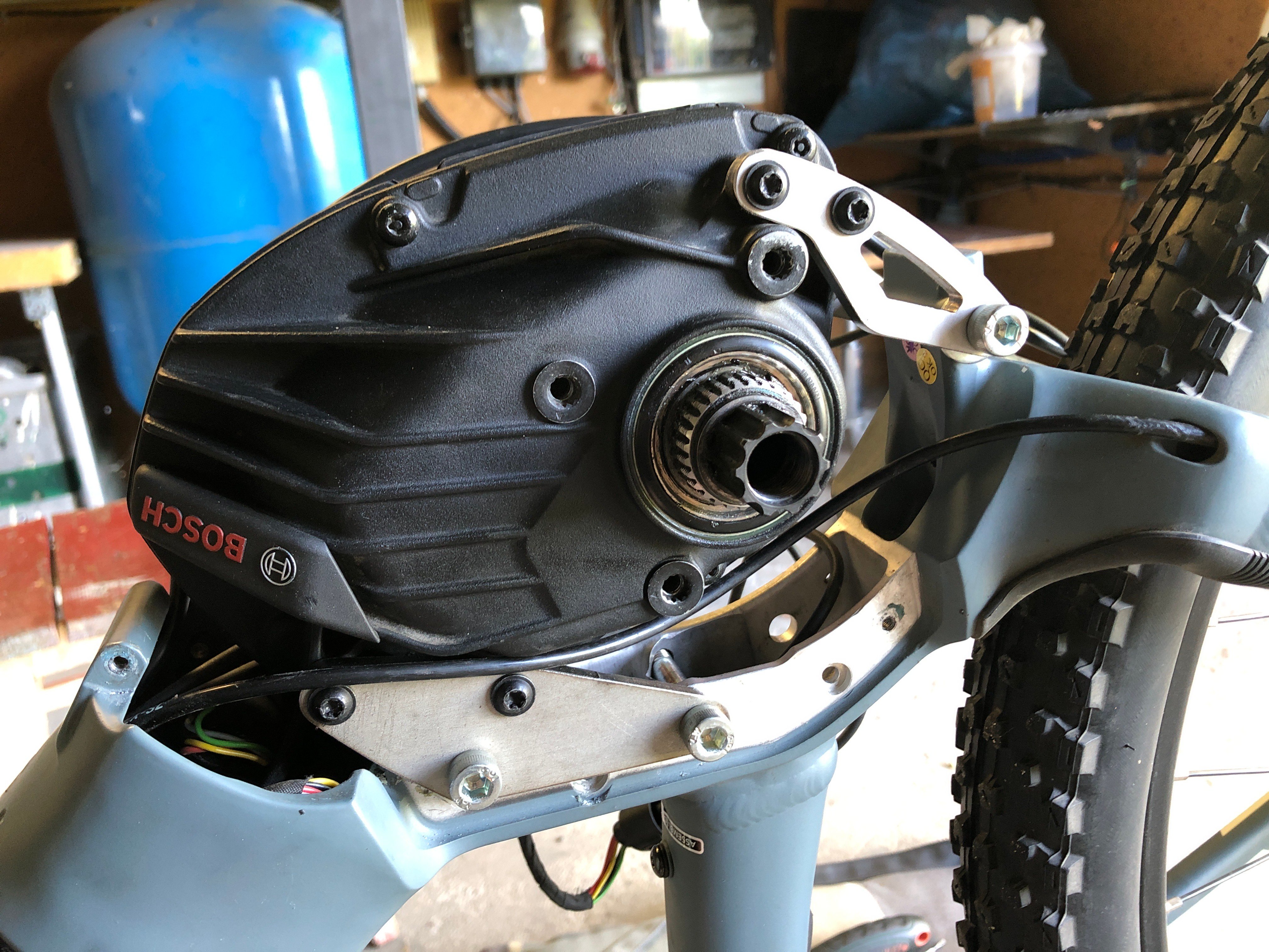

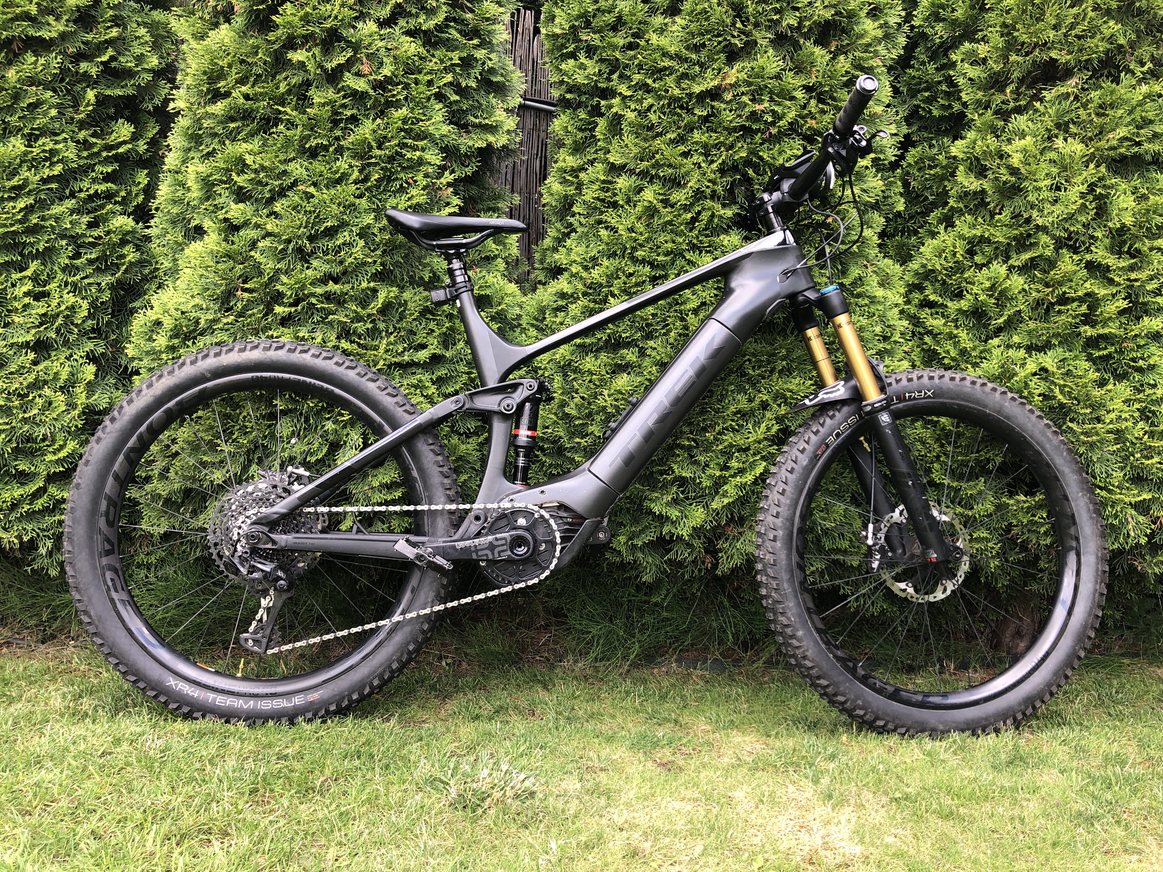

Please look on my gen2 to gen4 conversion in Trek Powerfly 4
Cobee
Apr 30, 2023
40
59
Poland

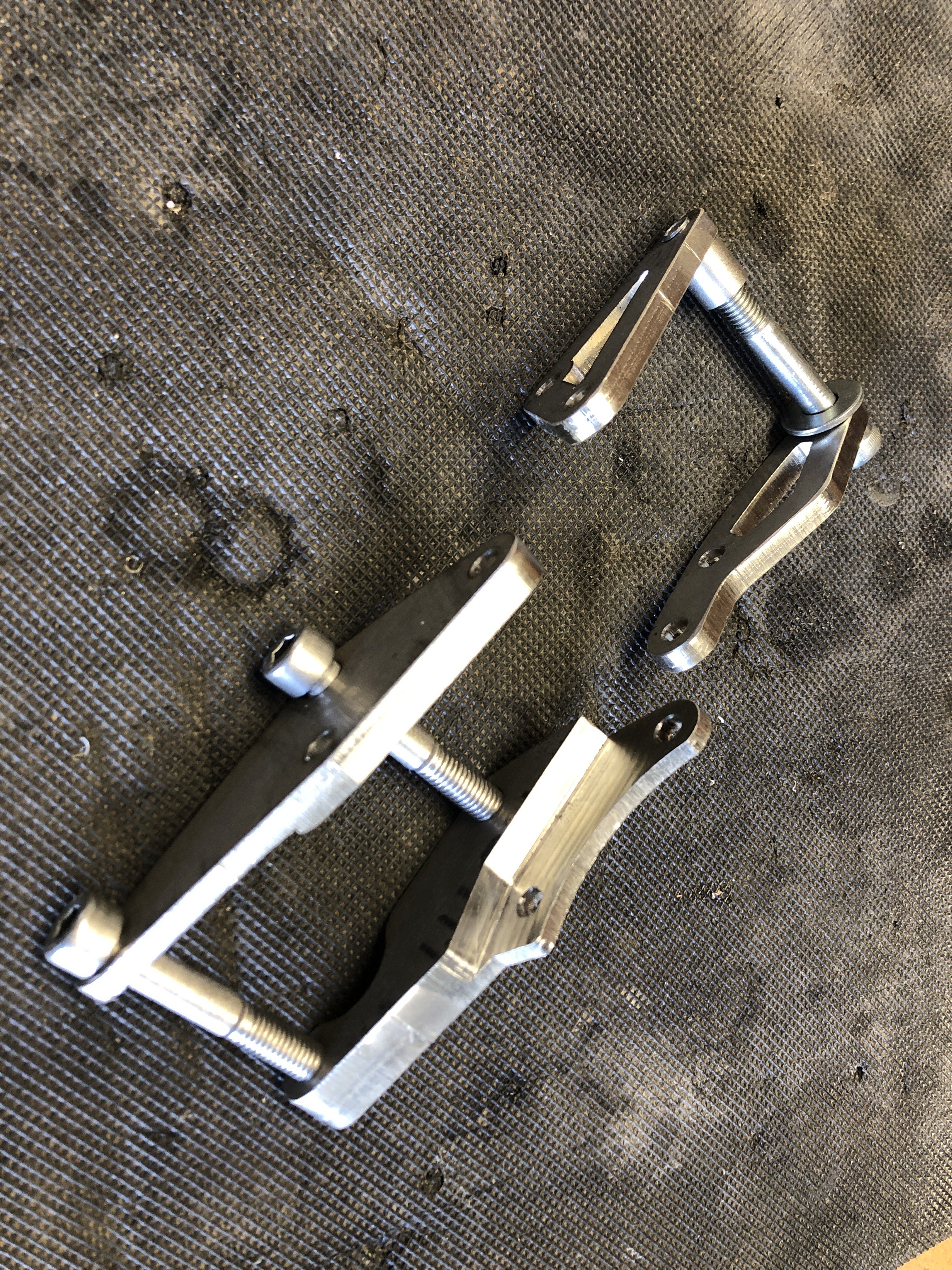

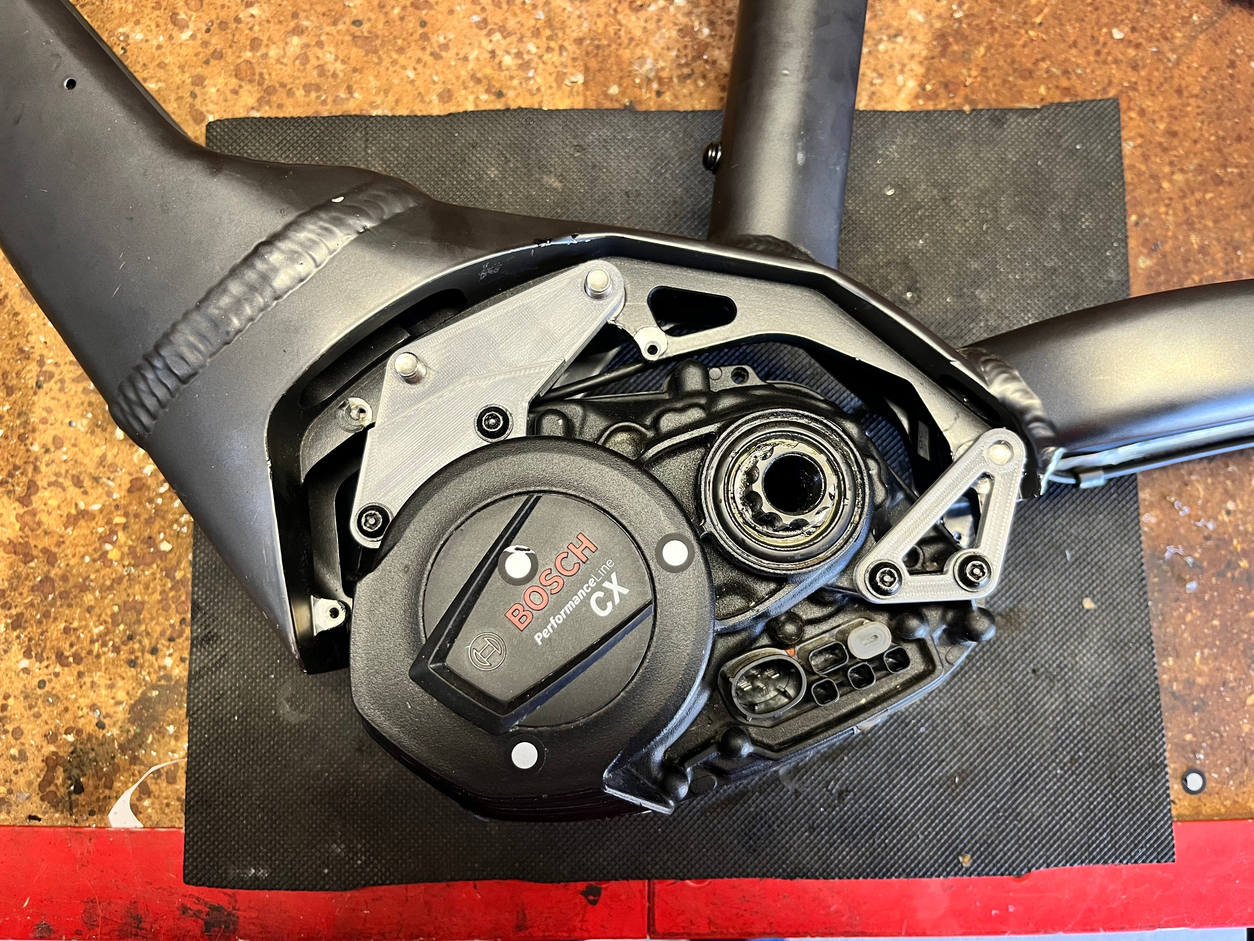

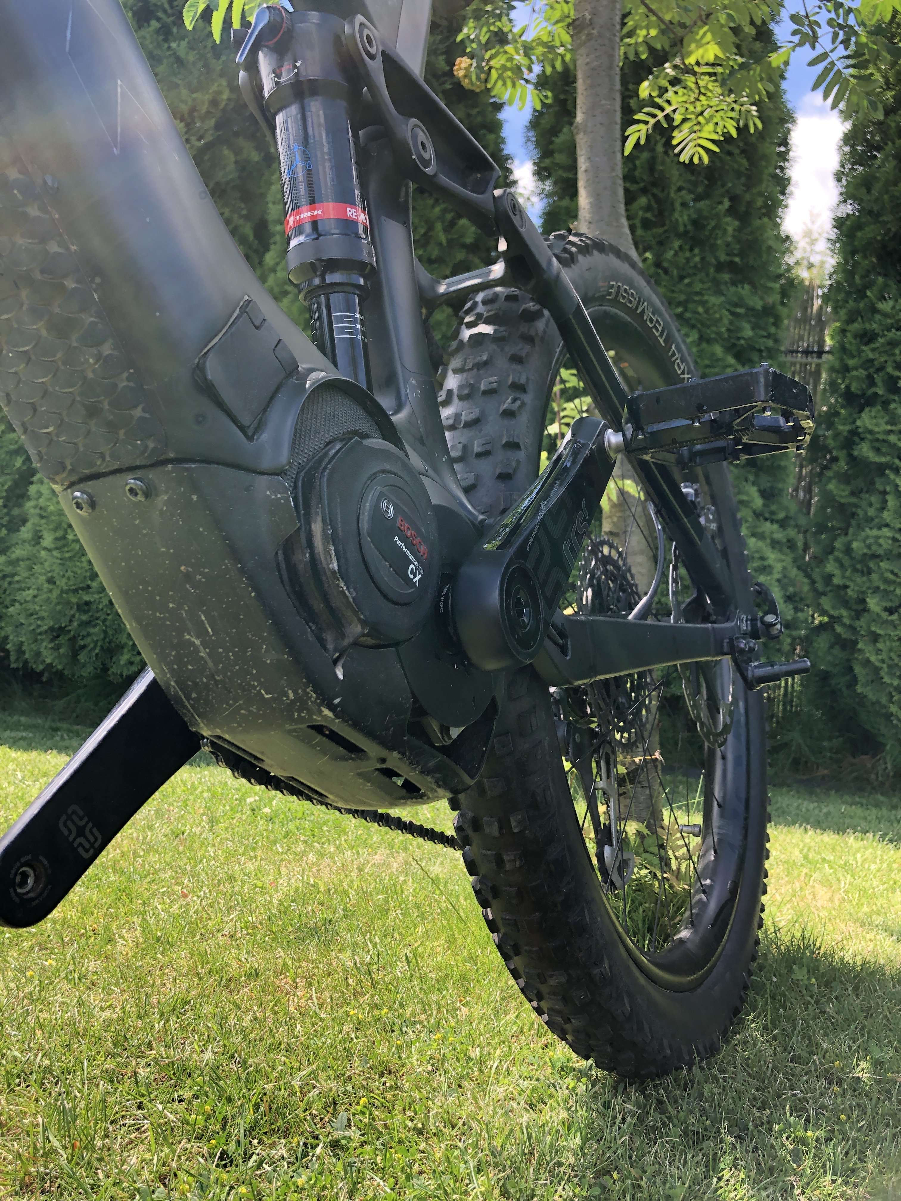

Let me know if someone need set ready to mount in Trek Powerfly 9.7 or 9.9 2019.
Set contain adapters + bolts , modified bottom cover, two sides modified cover.
Sending by FedEx 👌

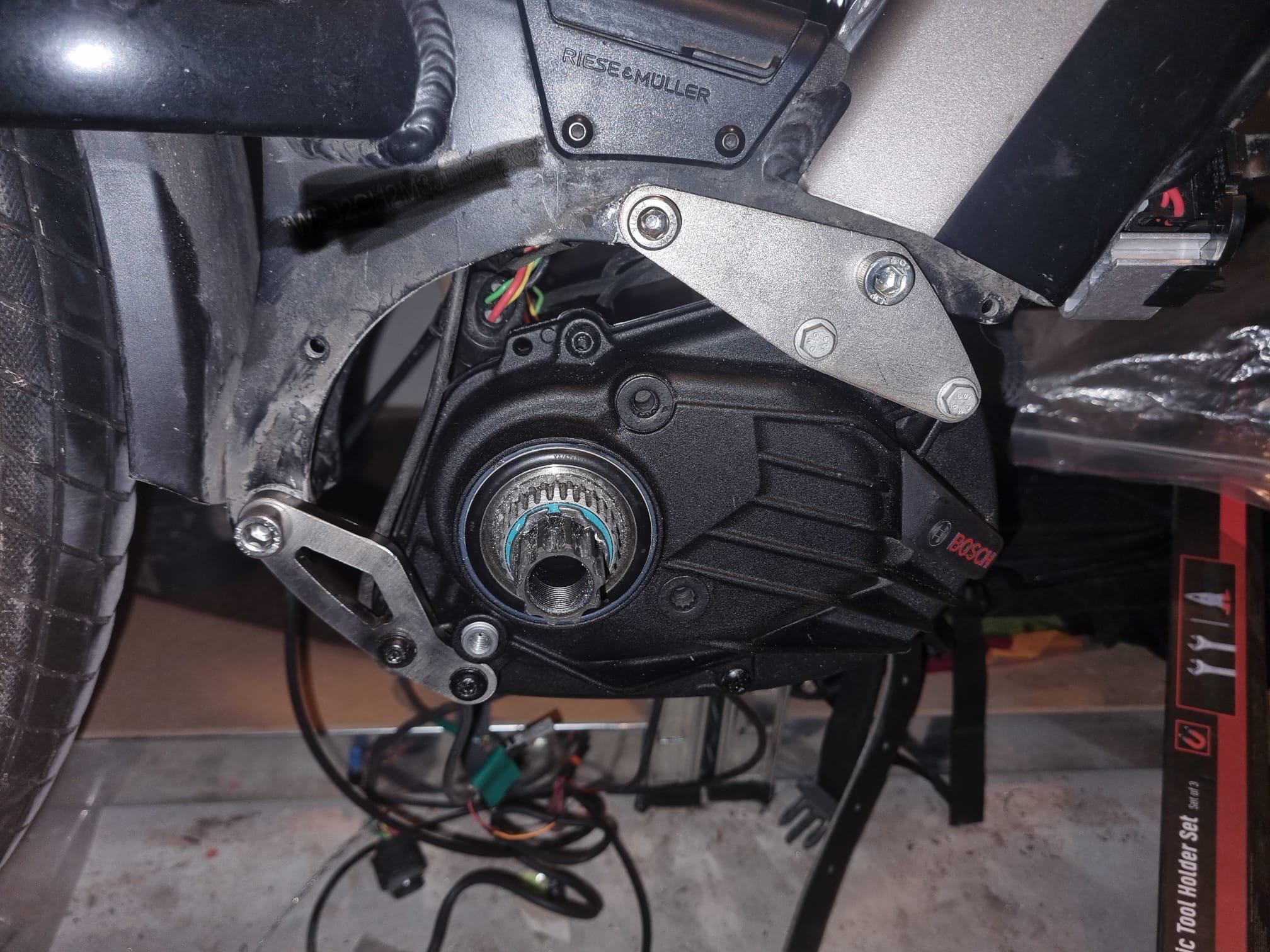

Hi, I will - the adapter was bolt on - but I have some issues to modify the original egg-formed cover used on 2017-2019 (by Cube, Trek, Riese&Müller and others) bikes, so I struggle with some esthetic details . After my vacation I will try to make a 3d-printed cover to make the conversion better looking. But as said - your adapters was bolt on - very easy to mount, and I can not see any better way to modify it to make it easier to adopt the egg-cover, so I will work more with the cover to make it fit better on my Riese&Muller Delite (2017).

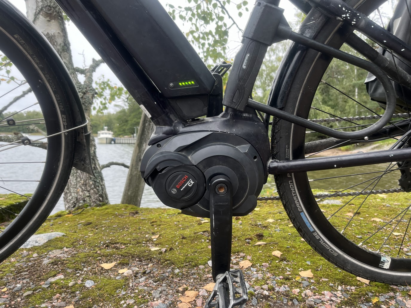

Hi! It is a city bike, Lapierre Overvolt Eden Park with a 2016 Performance Line (non-CX) motor and a Enviolo/Nuvinci N380 hub. It has an eggshell shaped motor cover so perhaps Trek Powerfly covers do not fit.
Thanks anyway!

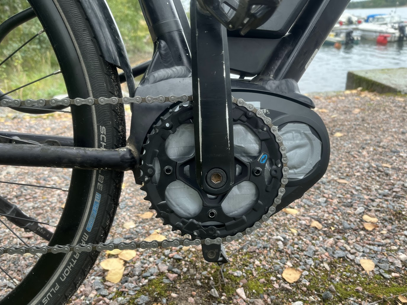

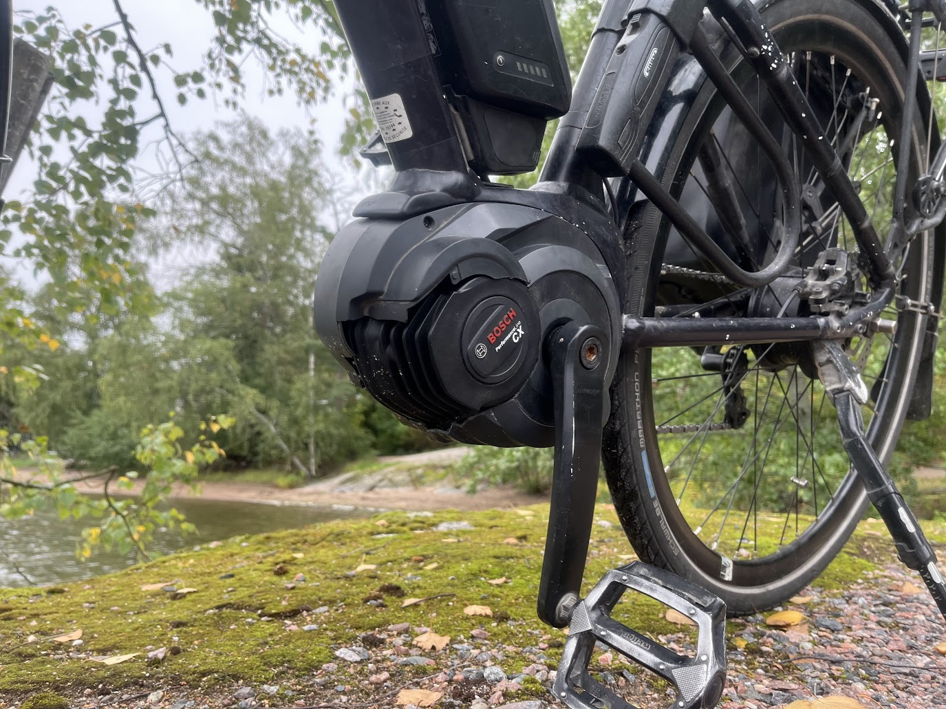

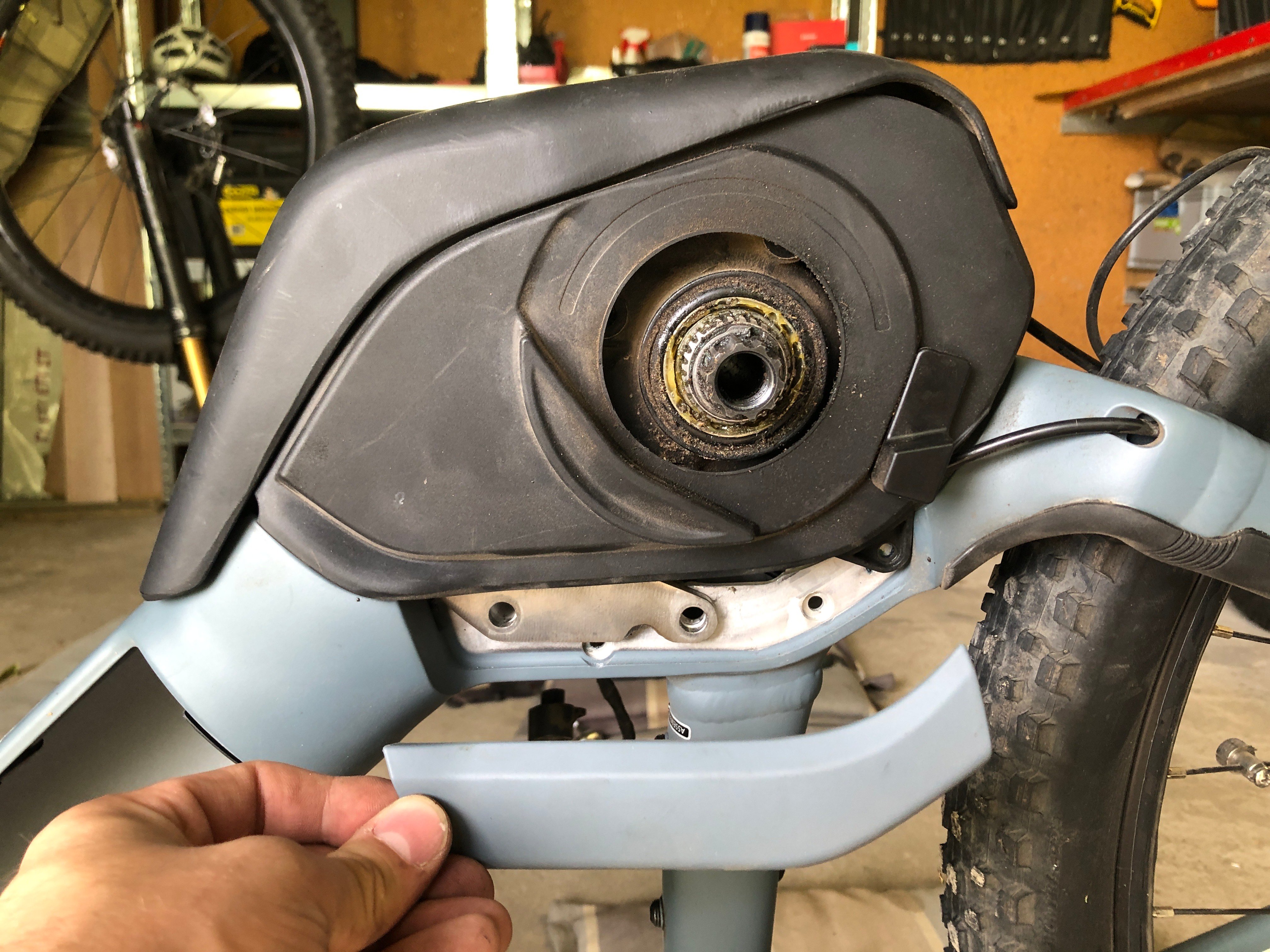

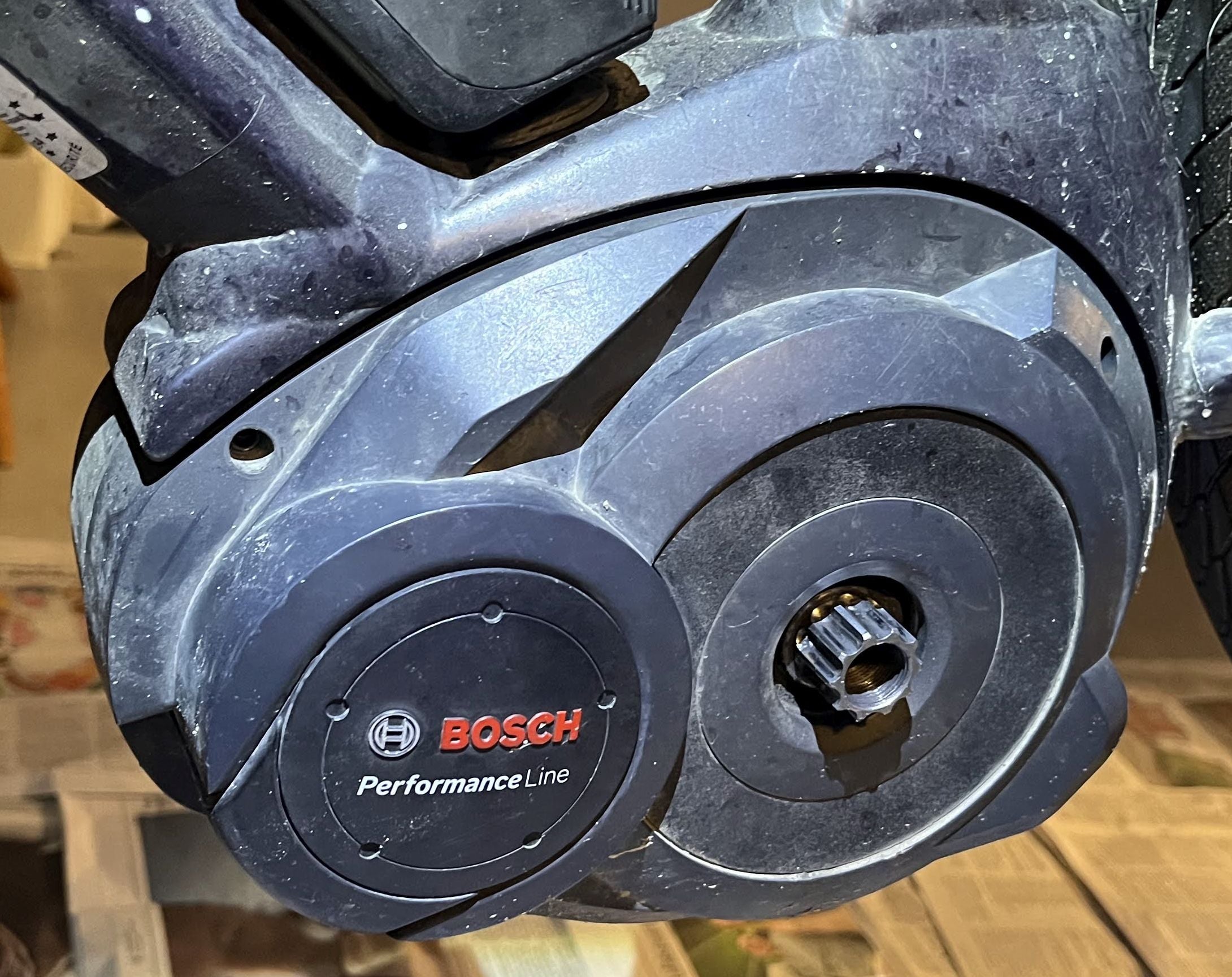

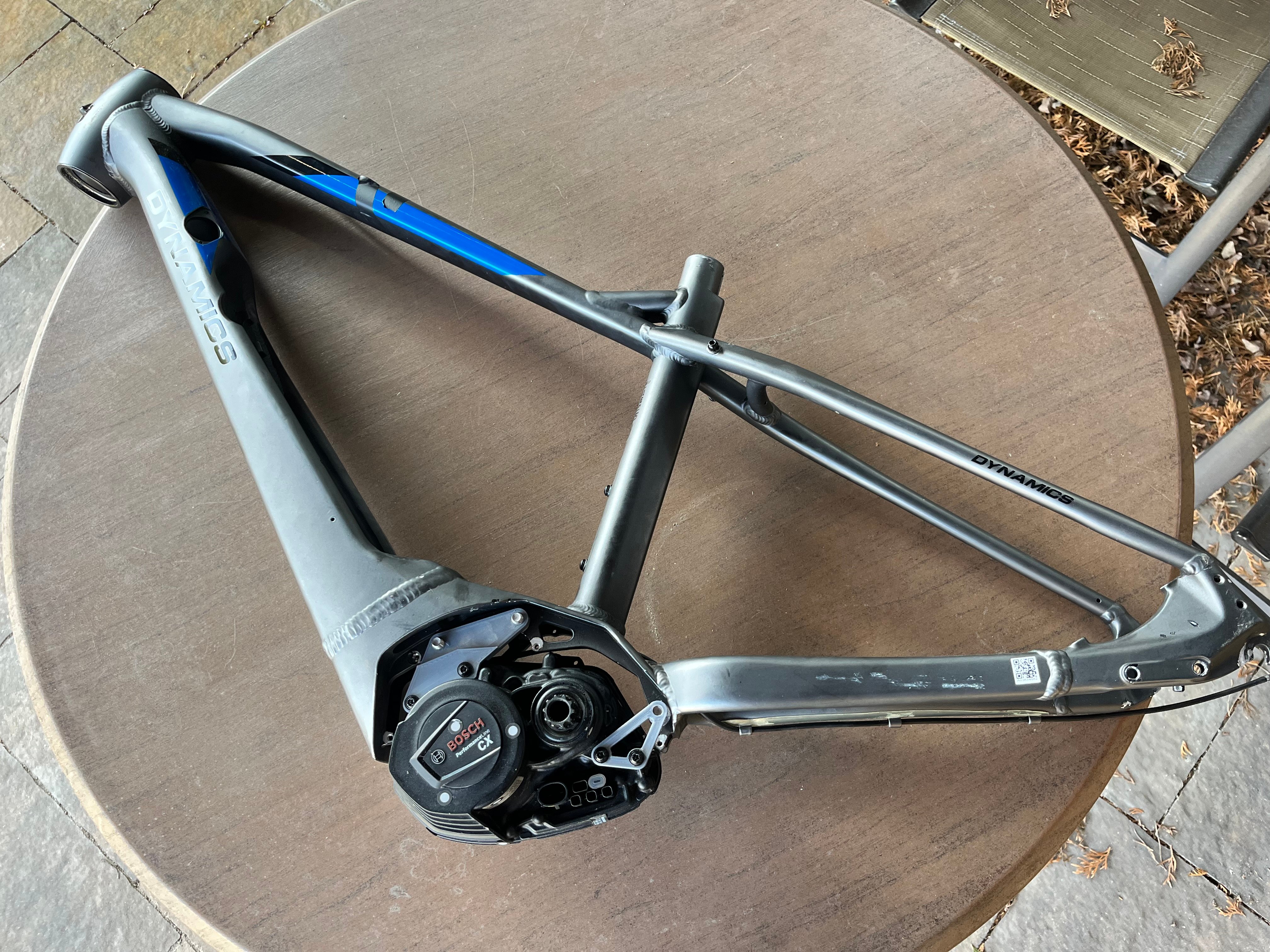

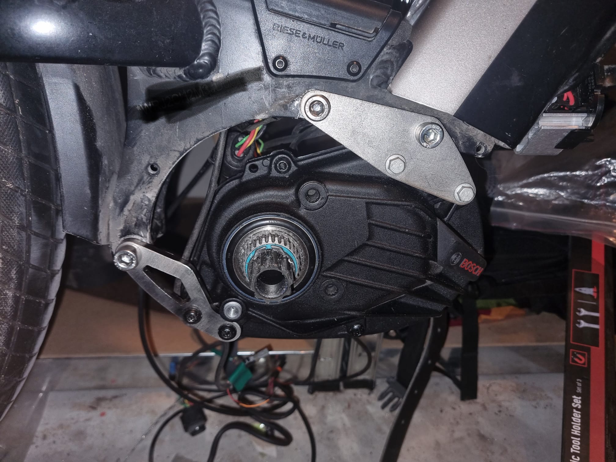

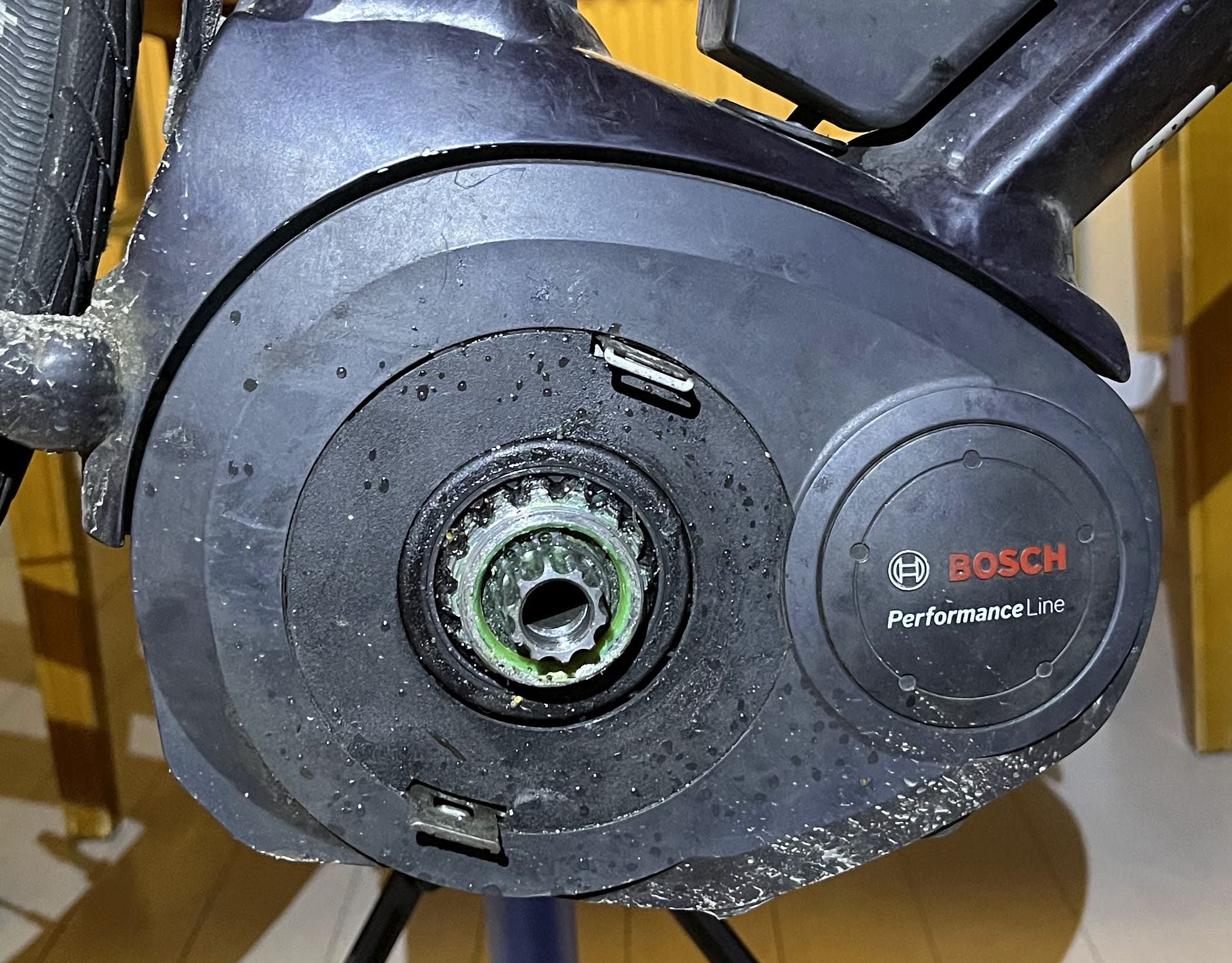

This is my bike with original motor, cranks removed.

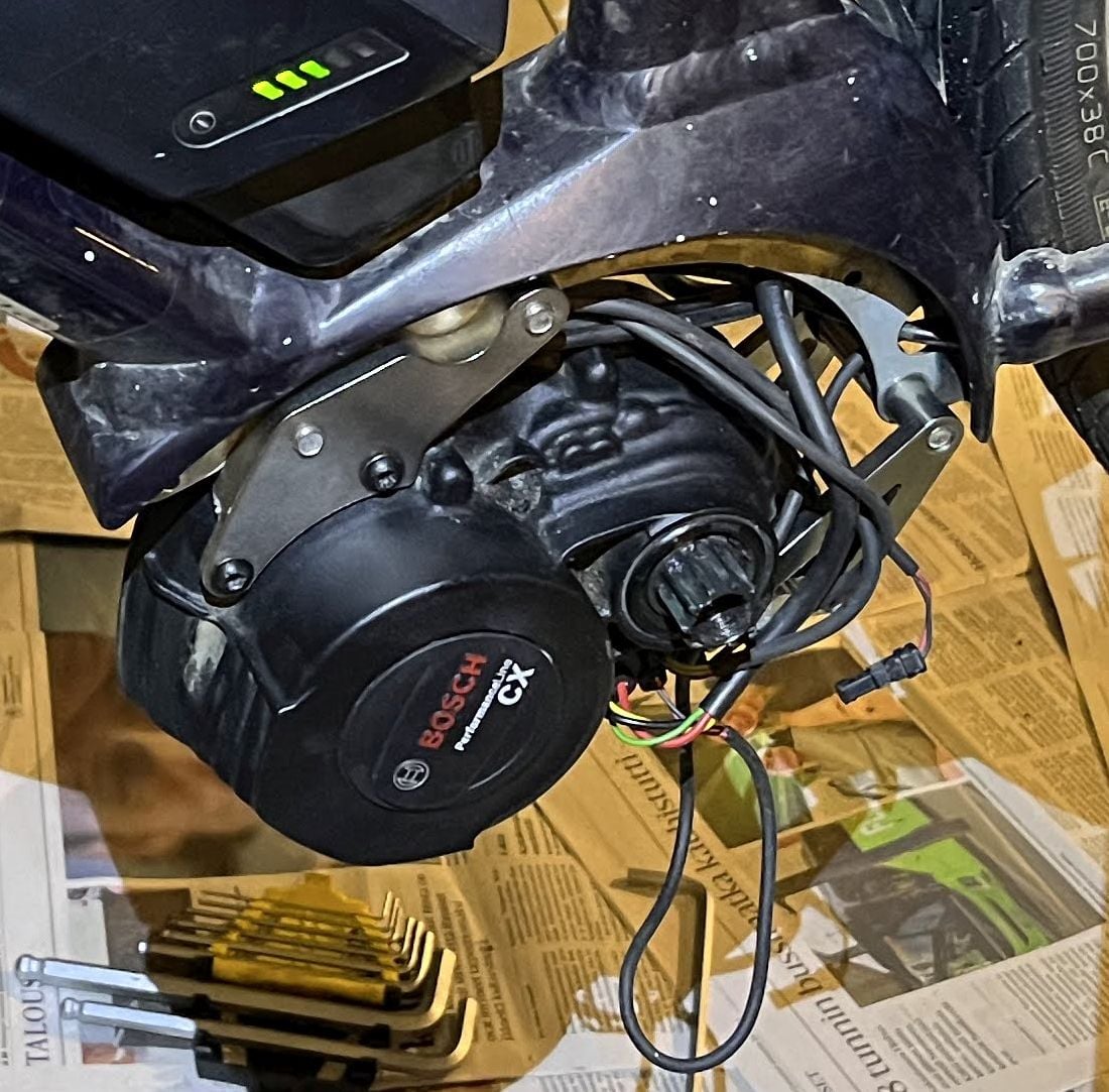

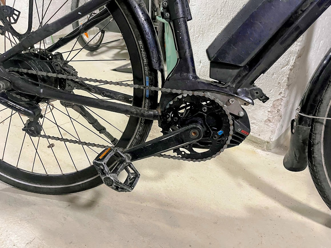

And Gen 4 installed.
Cables are not routed properly, yet. Right cover fits mostly but left needs to be modified. Or a 3D model designed. For now I think I'll just cut the left cover so that it fits and add some Sikaflex/sealant/adhesive if needed.
I will be able to test ride the bike tomorrow if I can find sprockets.
Anyway. Impressive adapter kit you have provided, @Cobee !

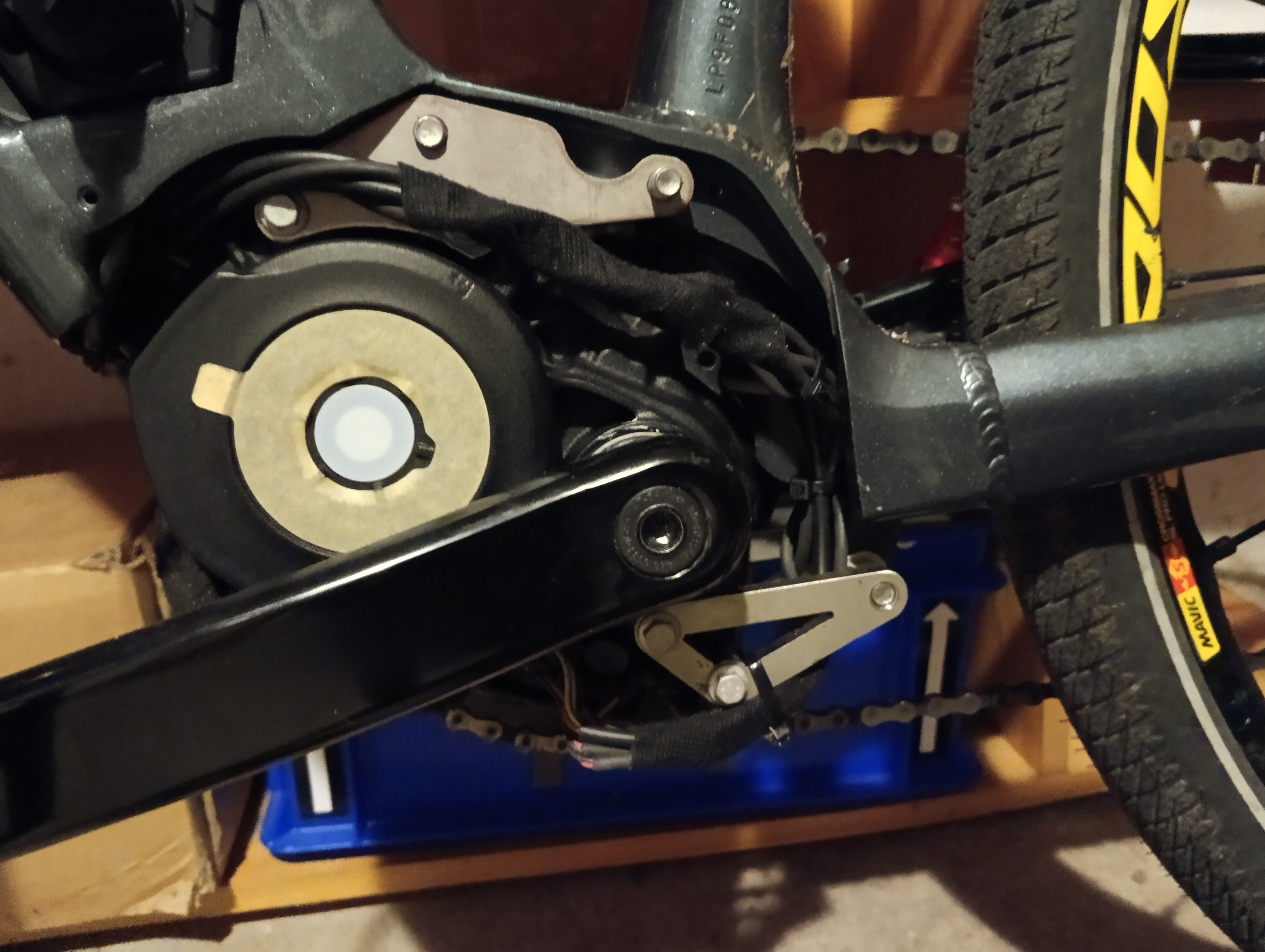

Finally managed to get the bike running. It is good. Pedaling past 25 km/h is not so hard any more. Added torque can be felt when going uphill. I need to do something about the covers. Maybe tomorrow.
Edit: Having 12 v lights is a nice bonus. Now I can get a headlamp with high beam.
Alavin
Aug 6, 2024
18
8
Helsinki, Finland

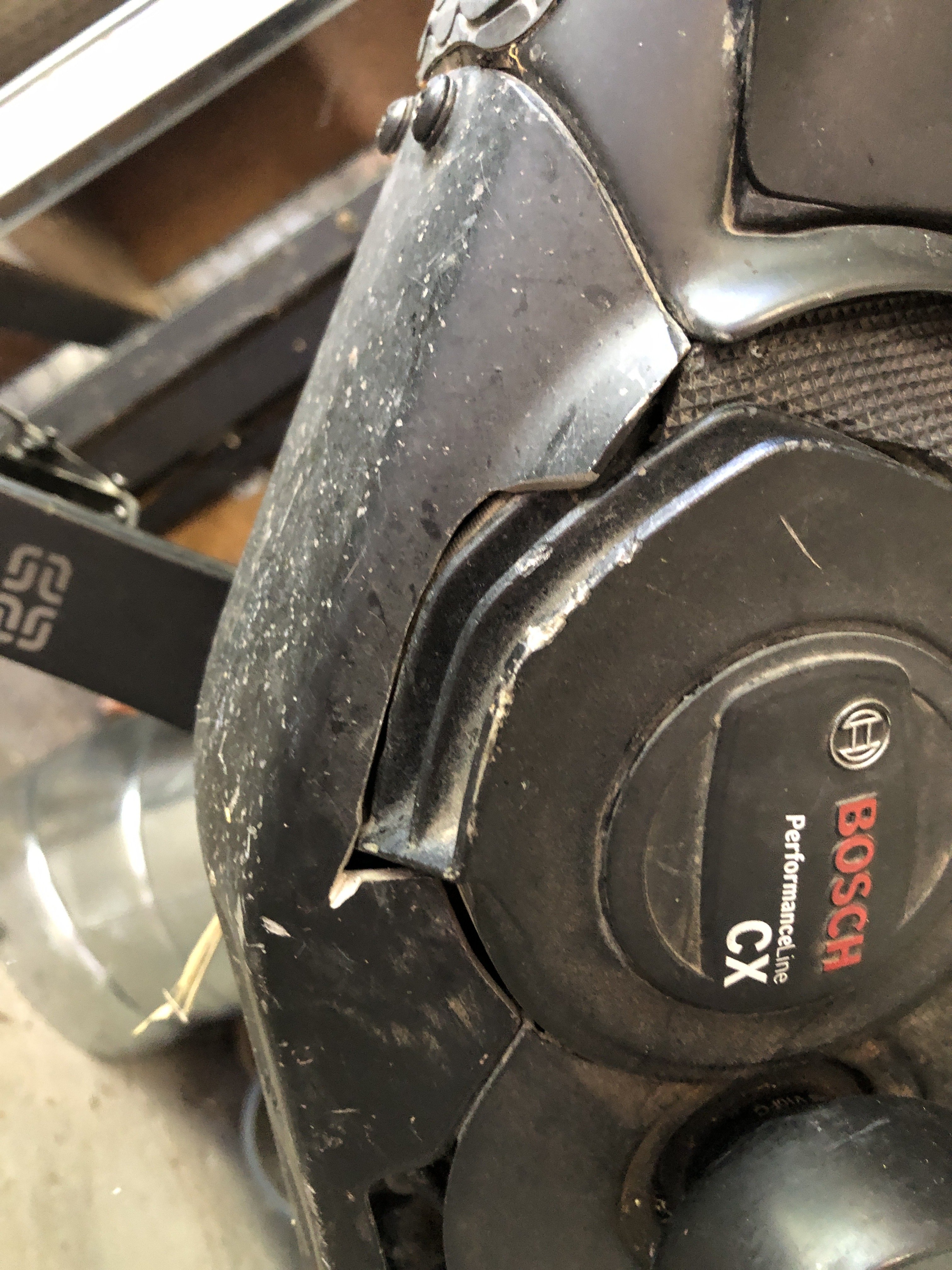

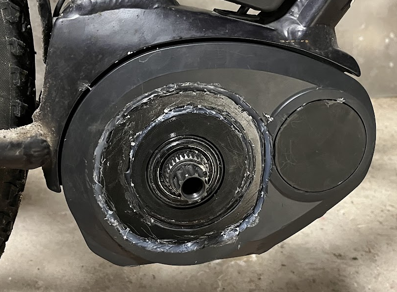

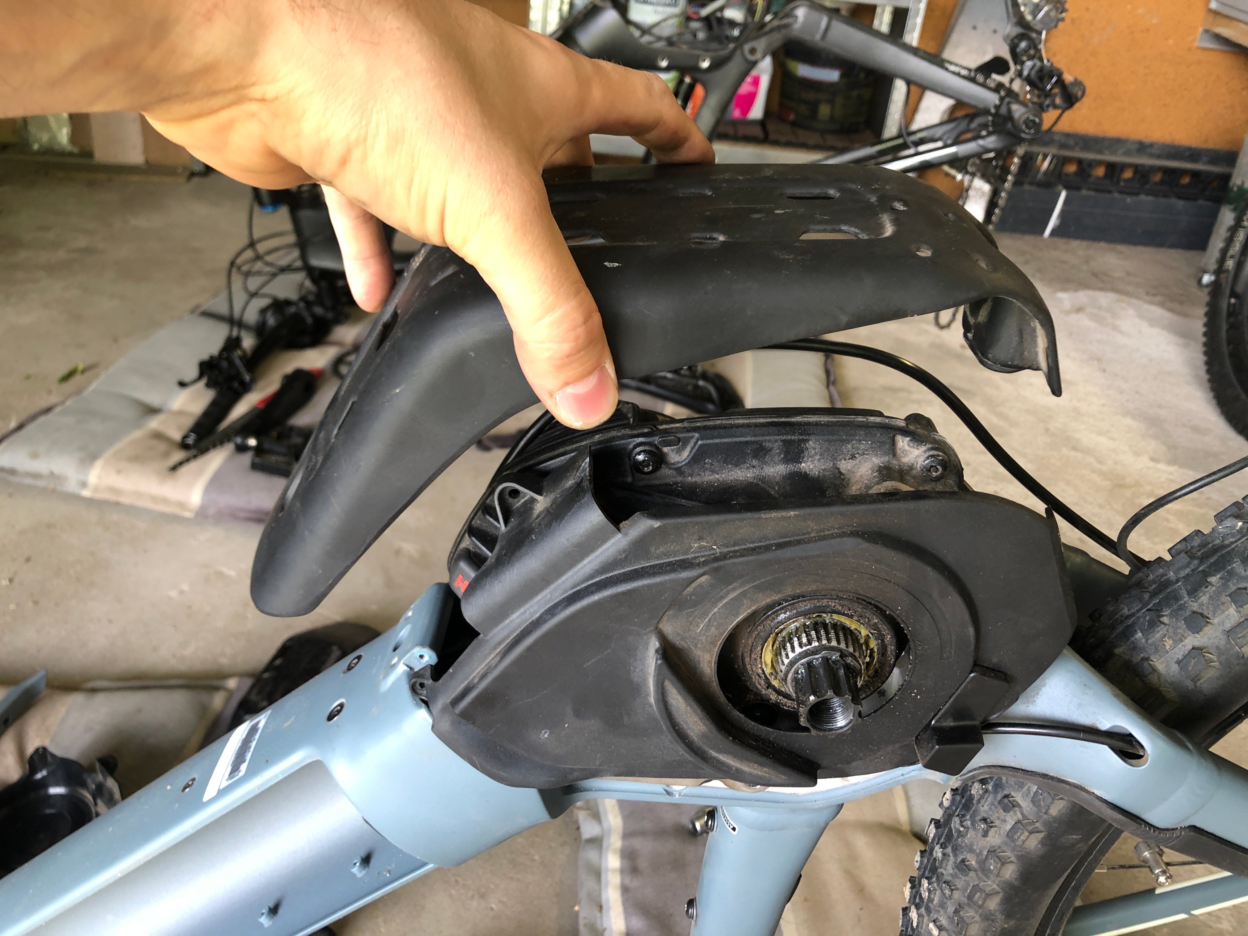

Cover fixed. It turned out better than I had expected.
Chainring side gave a surprise. There was not enough clearance between the the cover and the chainring bolts. So I cut the case and covered the holes with duct tape for now. Later I will 3D print black disc with a hole for crank and glue it to the case from the inside. Also same for the logo hole. Perhaps a spider with some offset would have worked instead. But it would have changed chainline and perhaps that could've been a problem.

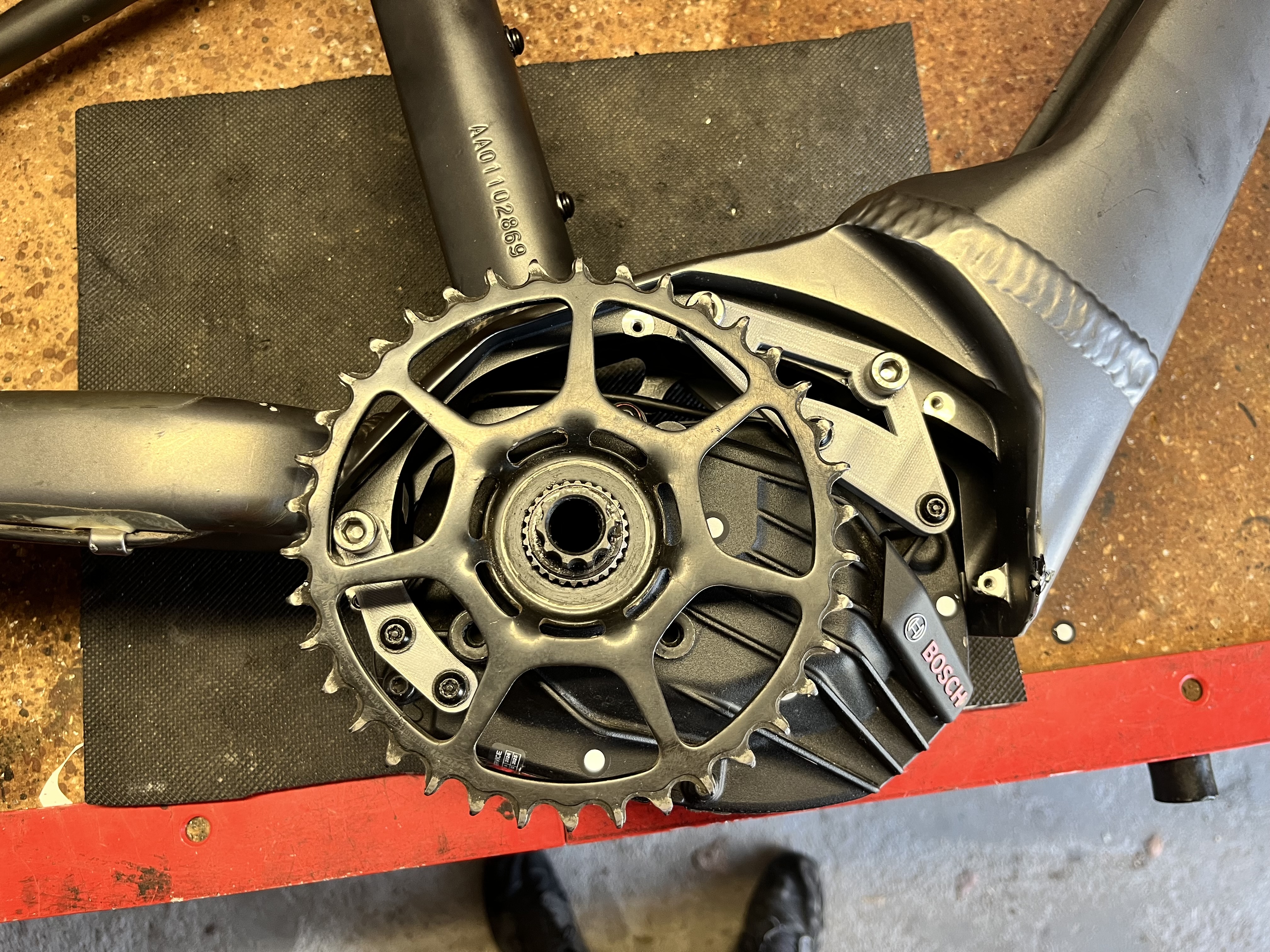

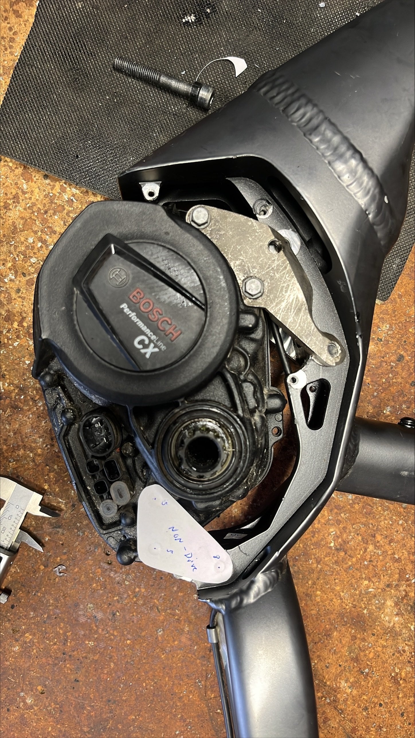

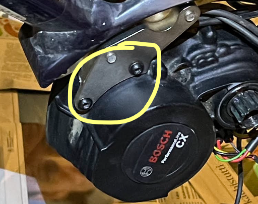

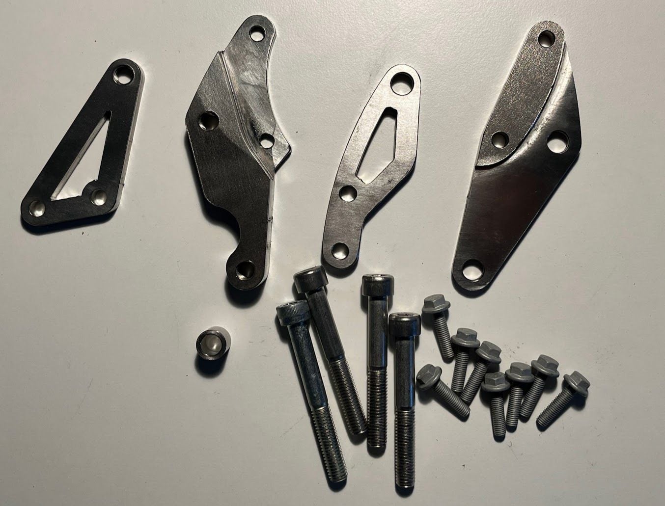

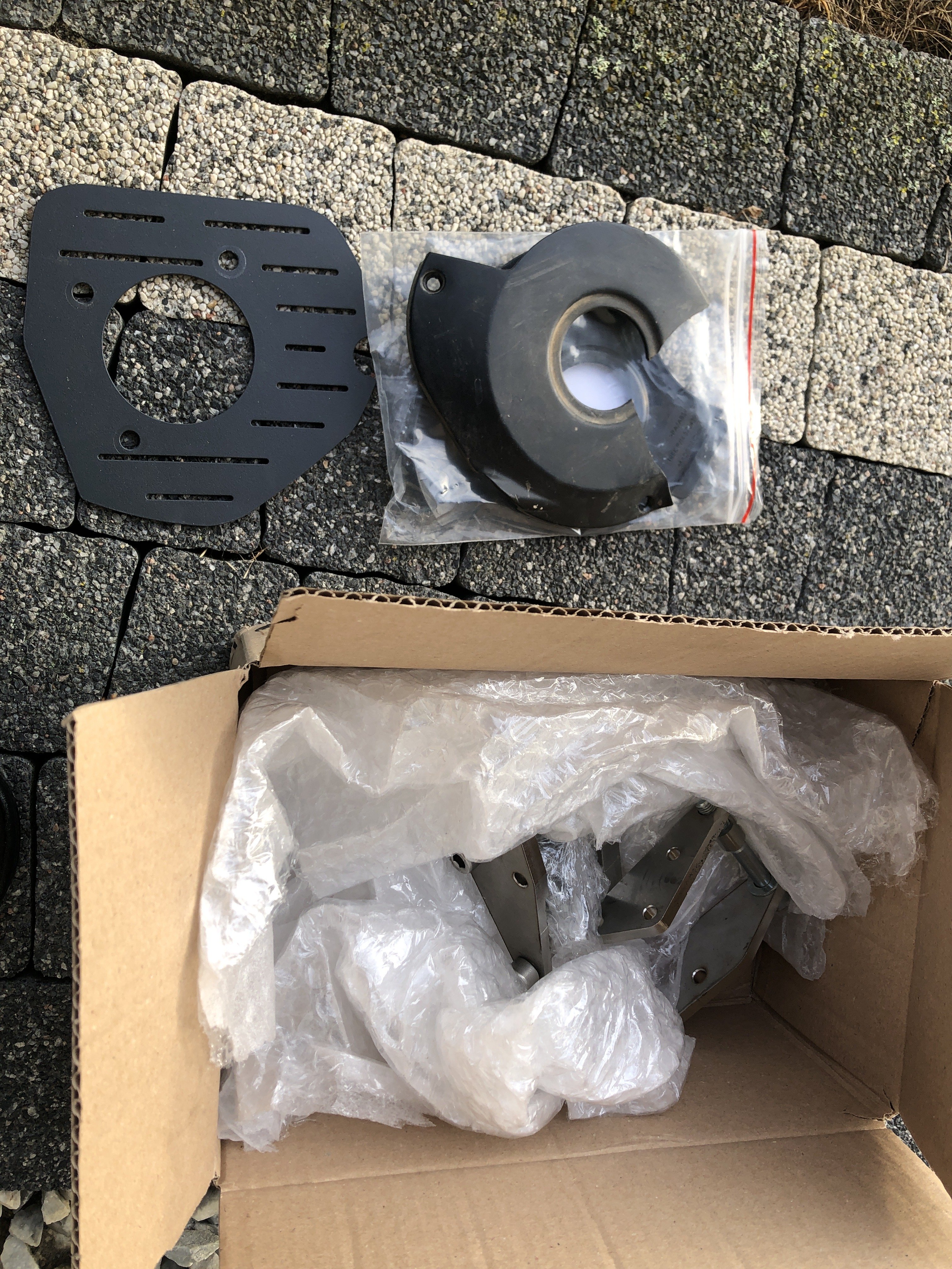

Bit for unscrew original bolts for adapters.
Please be carefully with threads in alu zinc material of housing motor. Not screw more than 9-10Nm. Is easy to broke this threads.
Thanks for providing hex bolts in the kit! They are much easier to work with than the odd Bosch Torx Plus screws. I did not have the correct torx bit but was still luckily able to remove the Bosch screws.
At first I thought I need two of the original screws as one of the plates is thinner:
I thought I would damage the motor as the hex bolts were longer than the original screws. But it turned out they fit so in the end I removed these two Bosch screws and replaced them with the ones you provided in the kit.

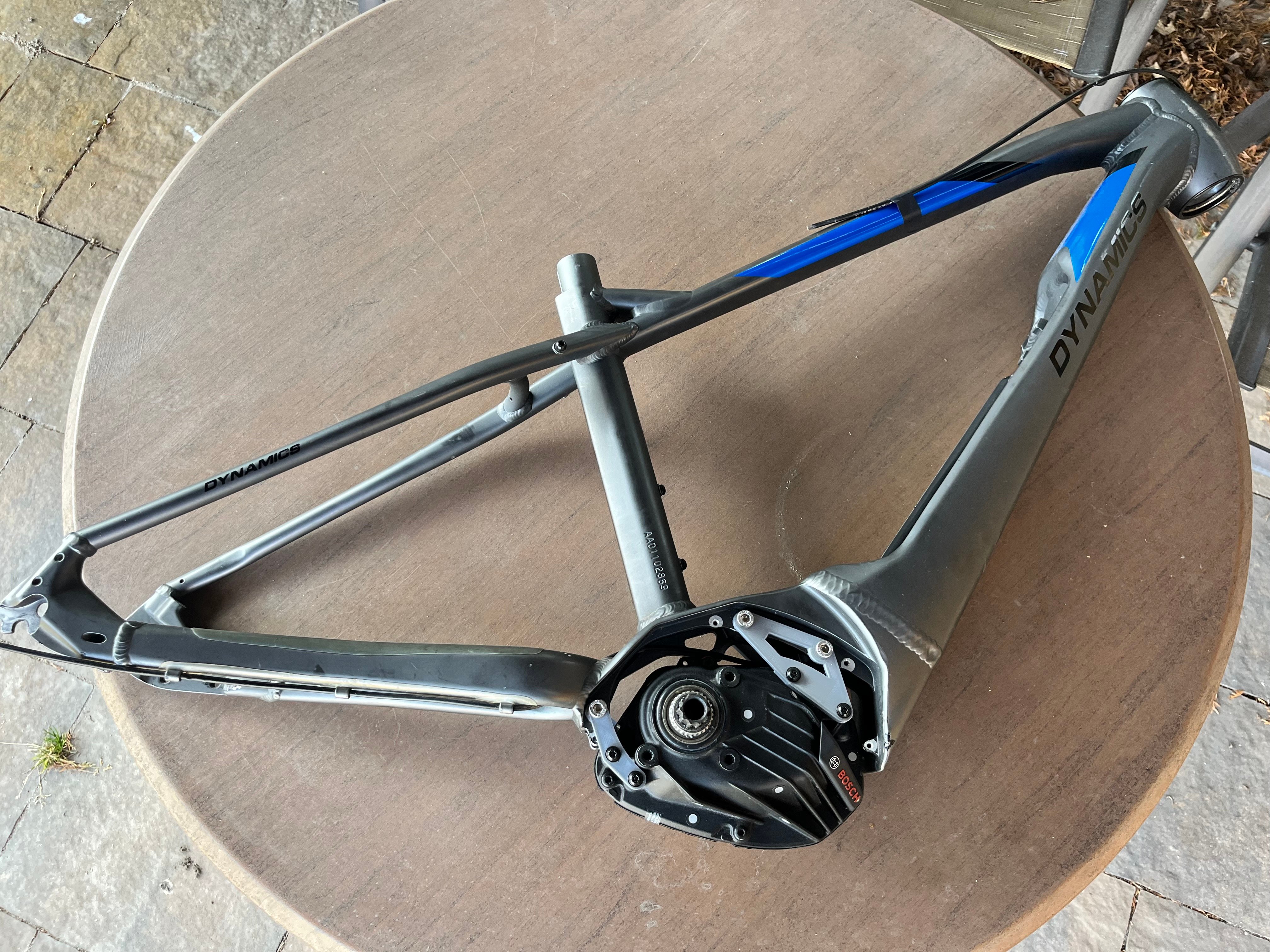

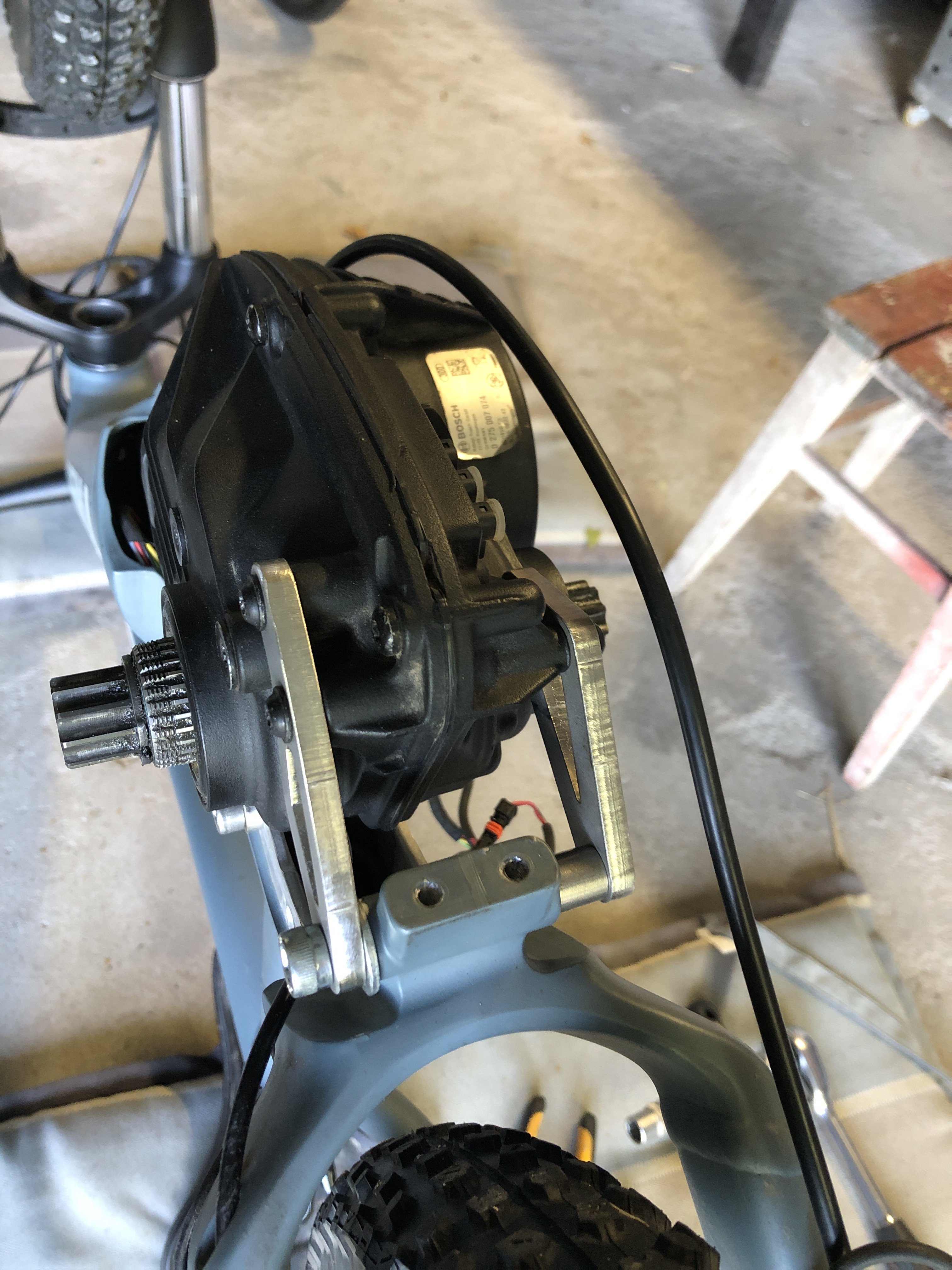

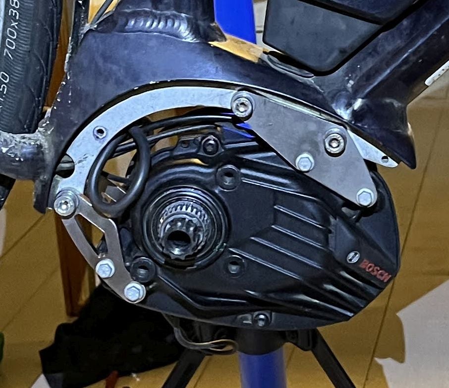

Another mod of my adapters in Netherland.
The bike is a 2018 riese Muller supercharger. Pedelec !

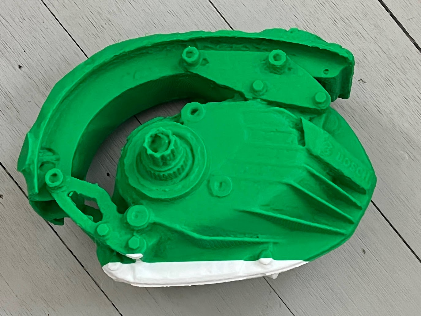

3D prints (PETG) and hot glue (too much). Not pretty but works.

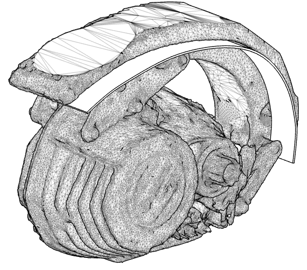

In case someone wants to try to design a cover for a frame with Bosch classic rounding, here is a scanned 3D model of a mounted motor without covers: Bosch Gen 4 Motor On Gen 2 Frame - Download Free 3D model by Alavin . I am learning Fusion360 but it might take a long time to get anything done.

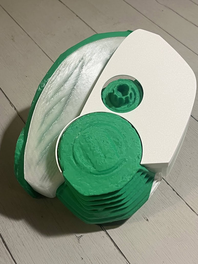

First draft of the left side. Used leftover filaments so it is white/transparent. I haven't started the right side yet. Completing this will take ages. :)
In the end it will not be this bulky. I plan to make roundings at later stages.
