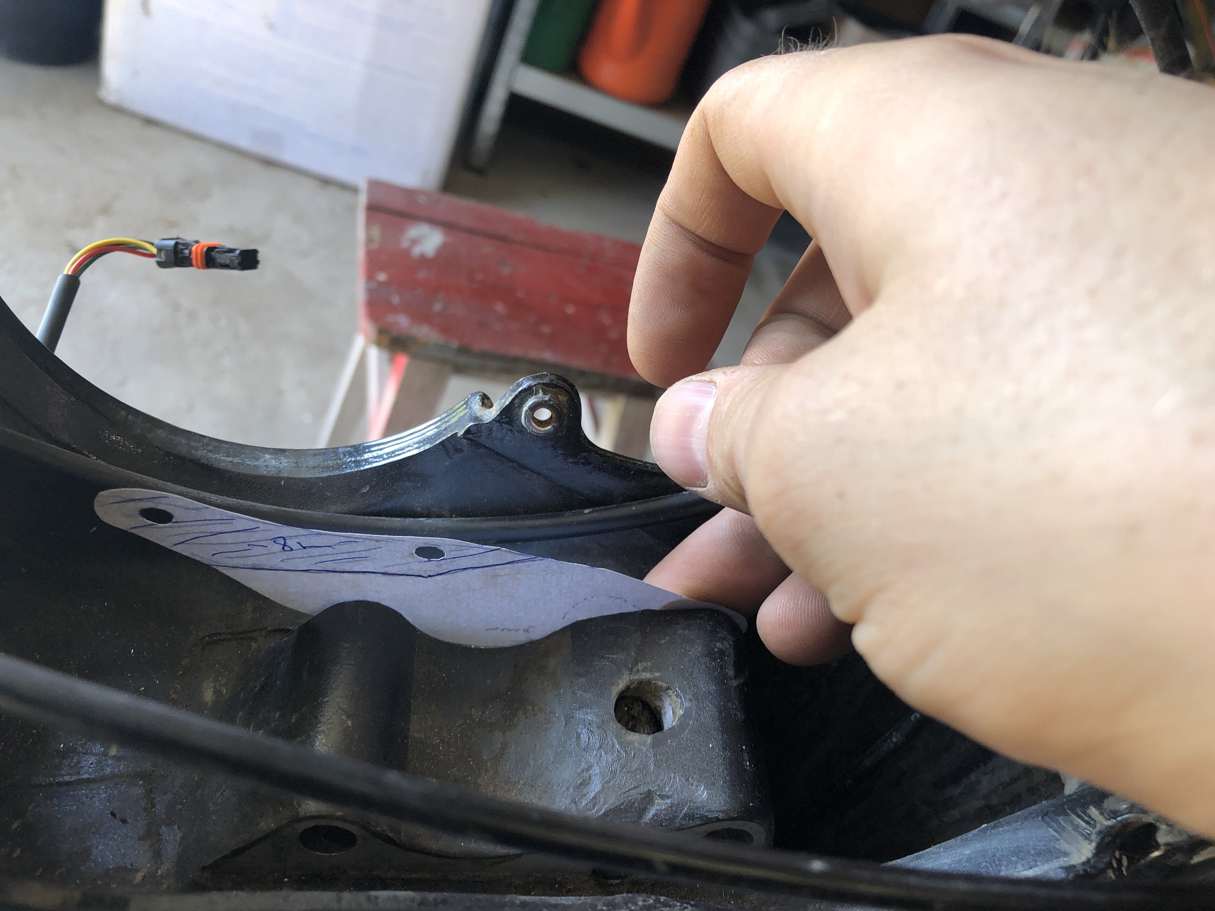

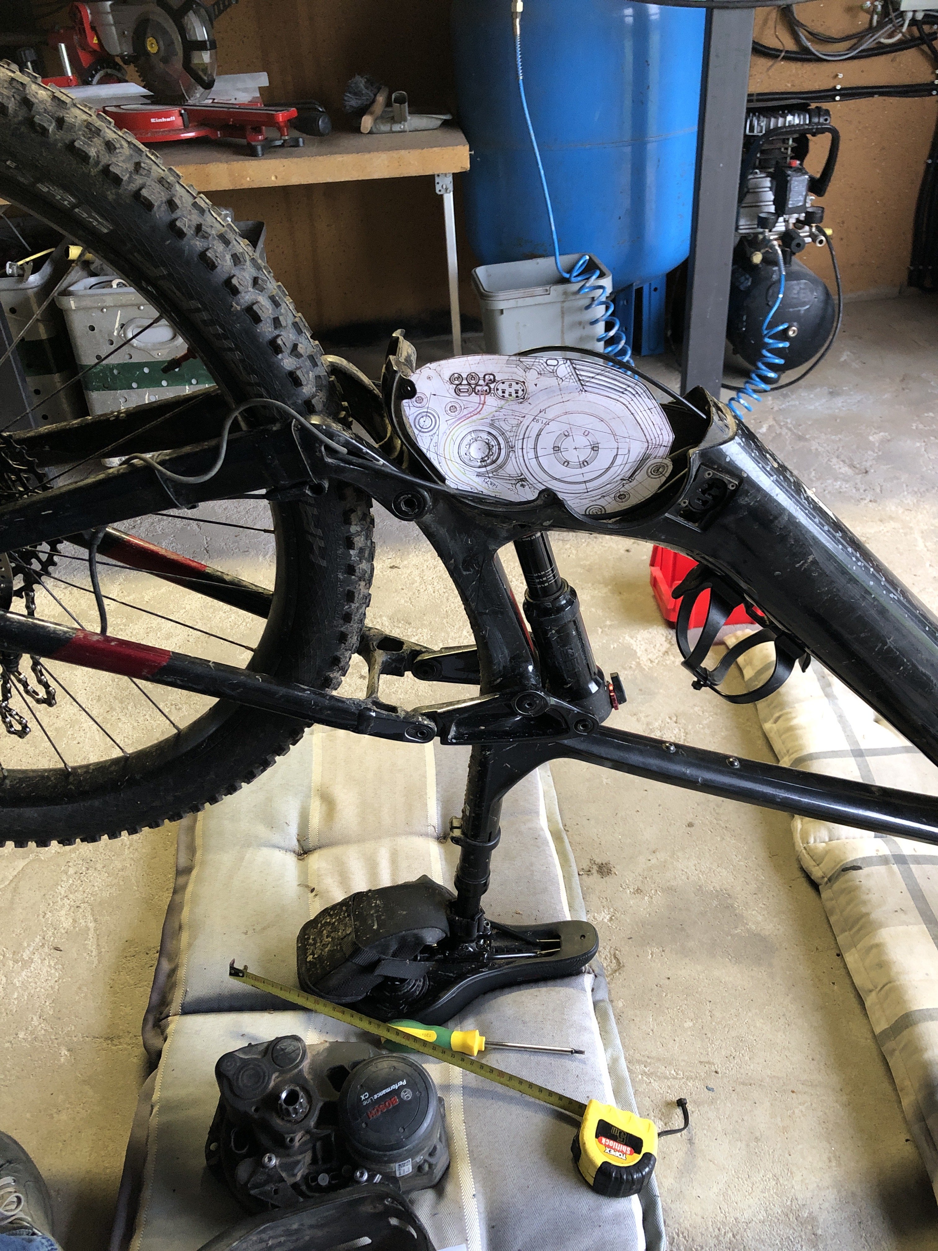

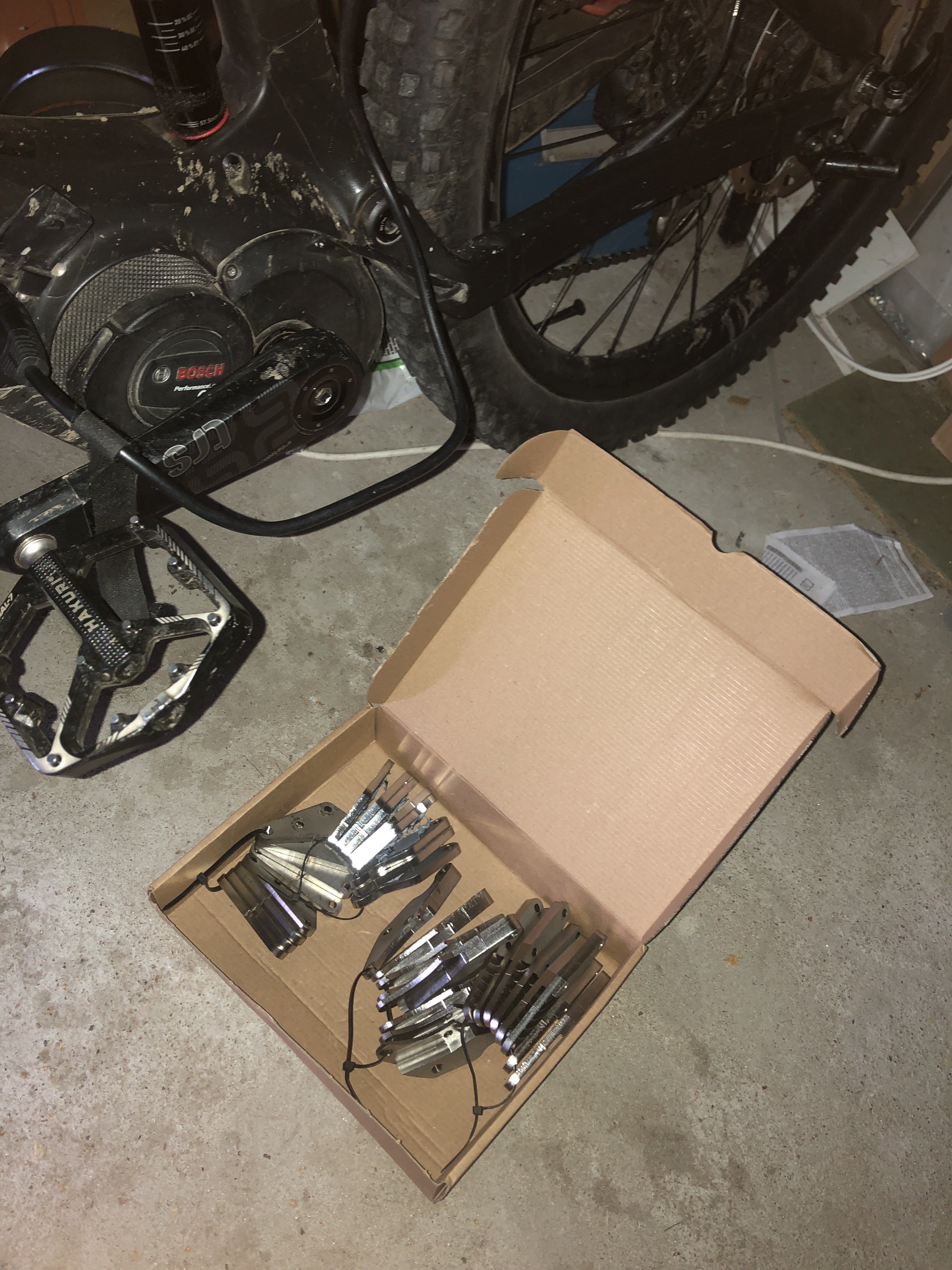

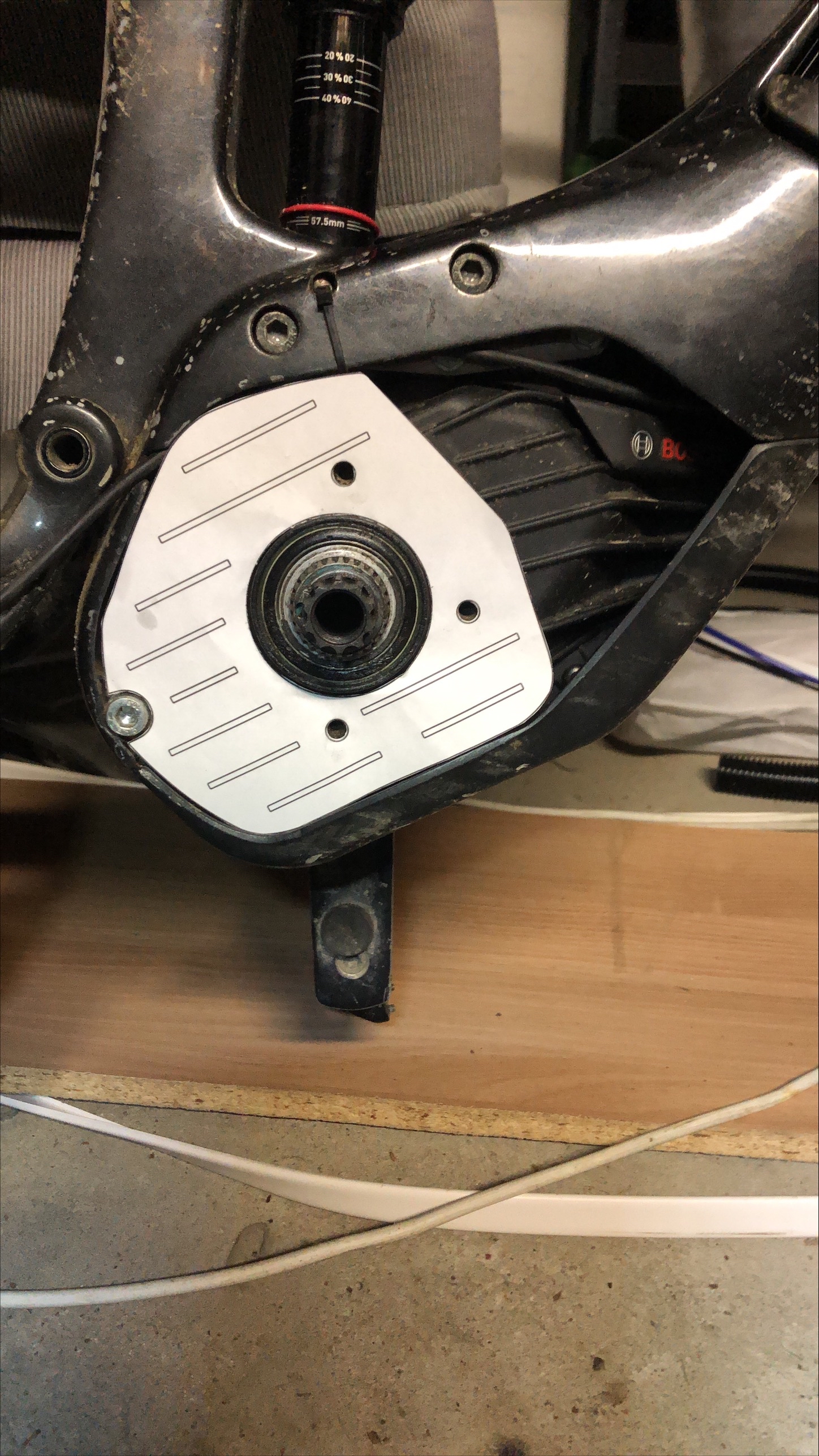

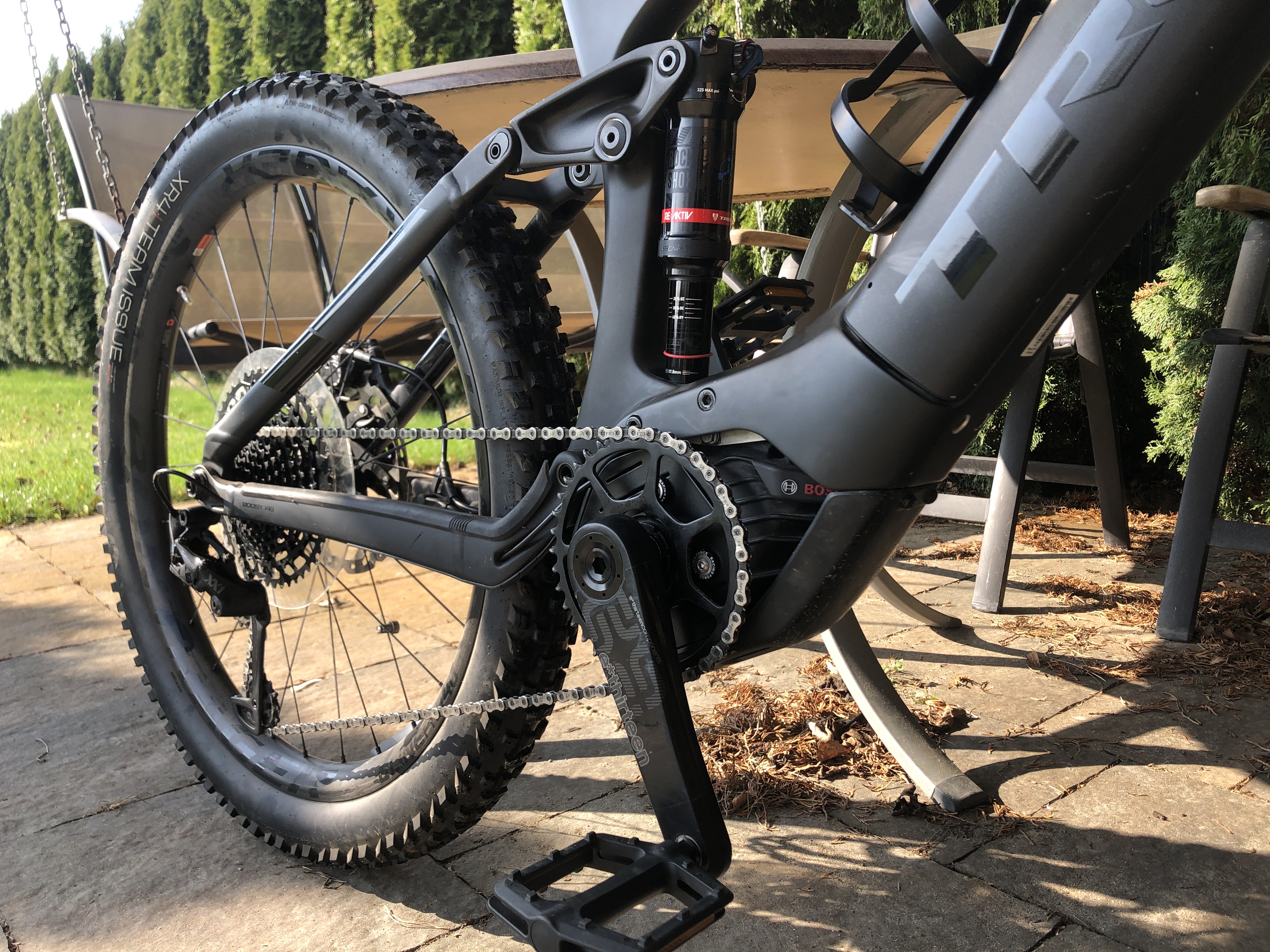

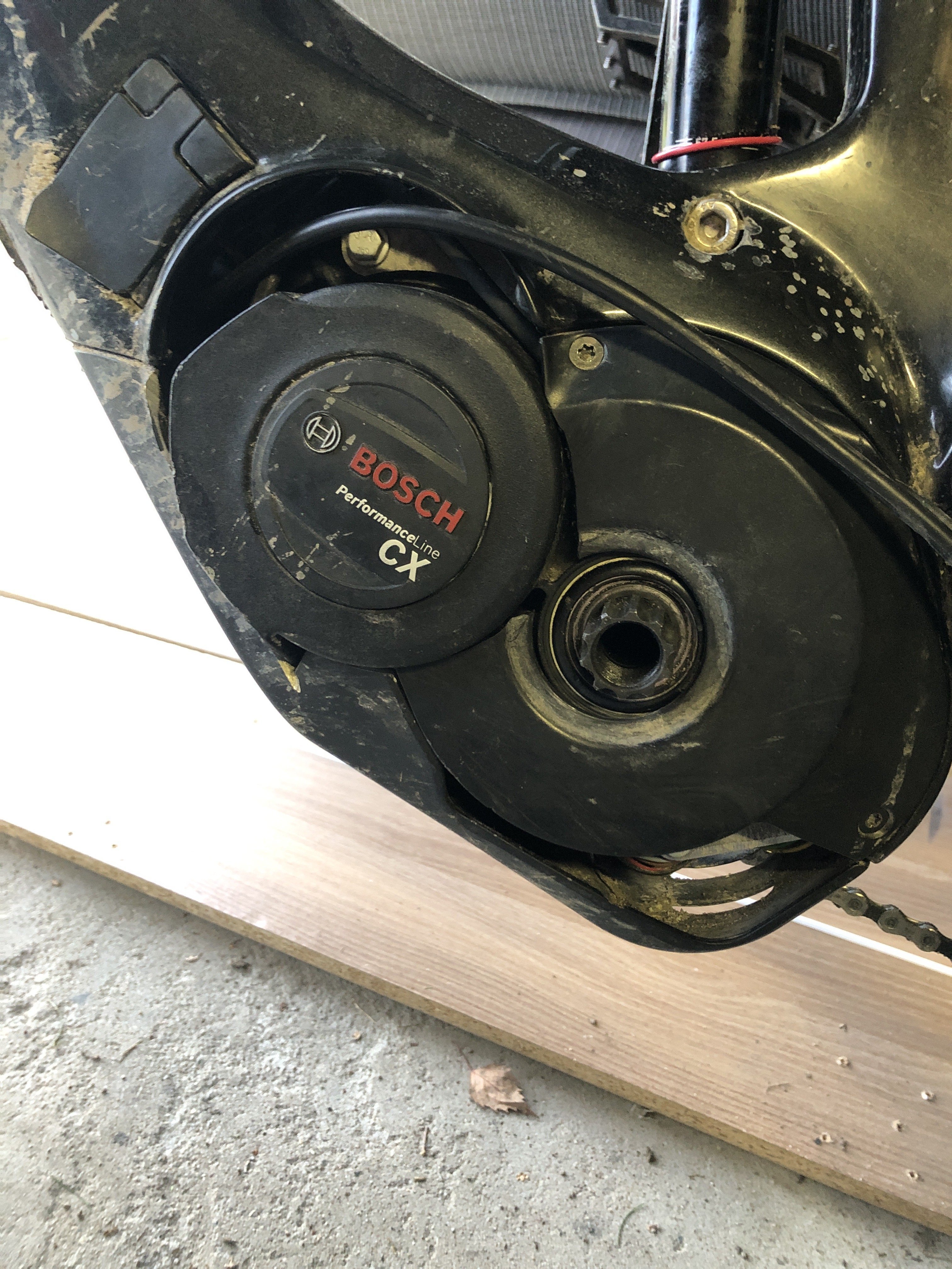

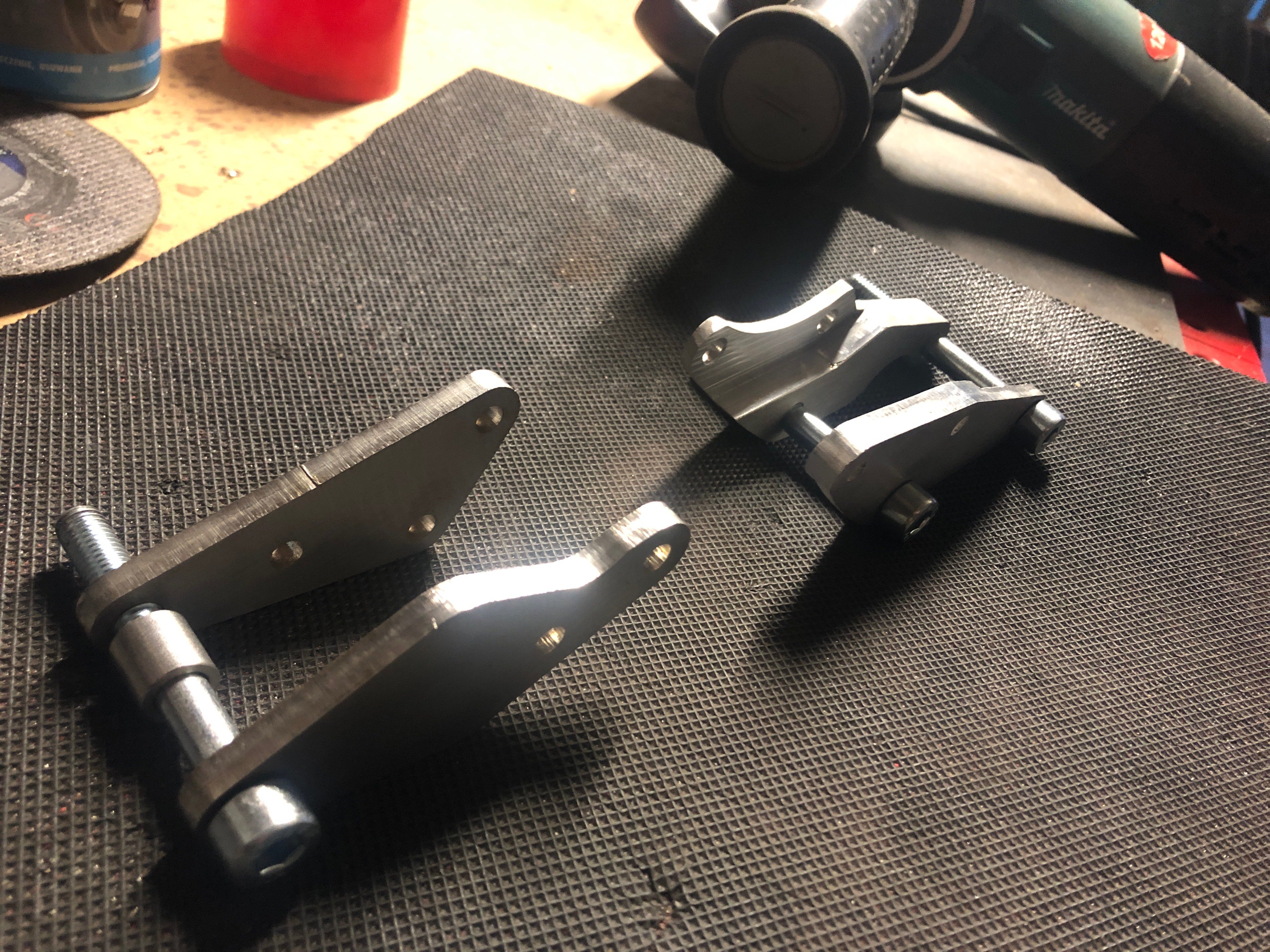

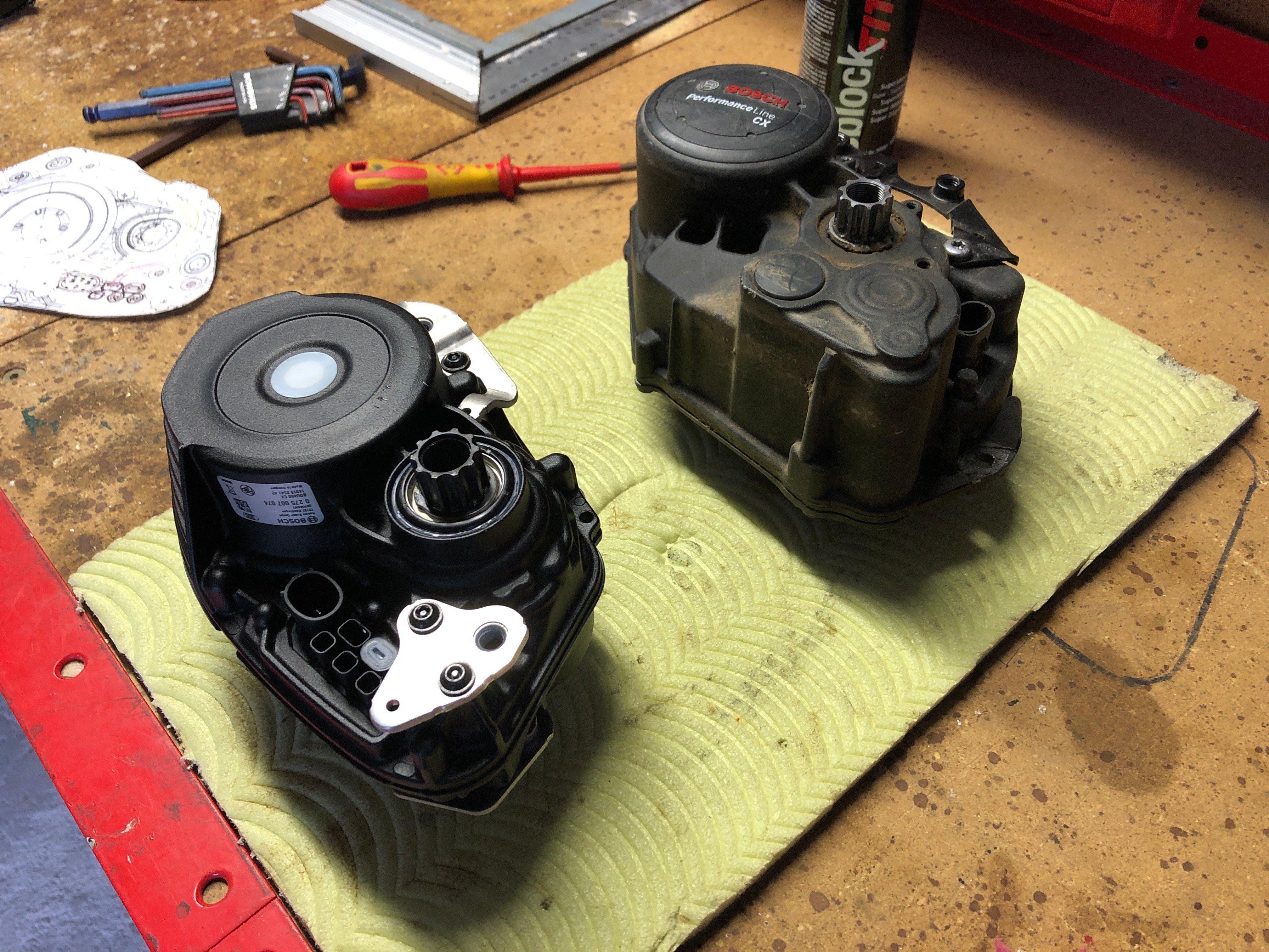

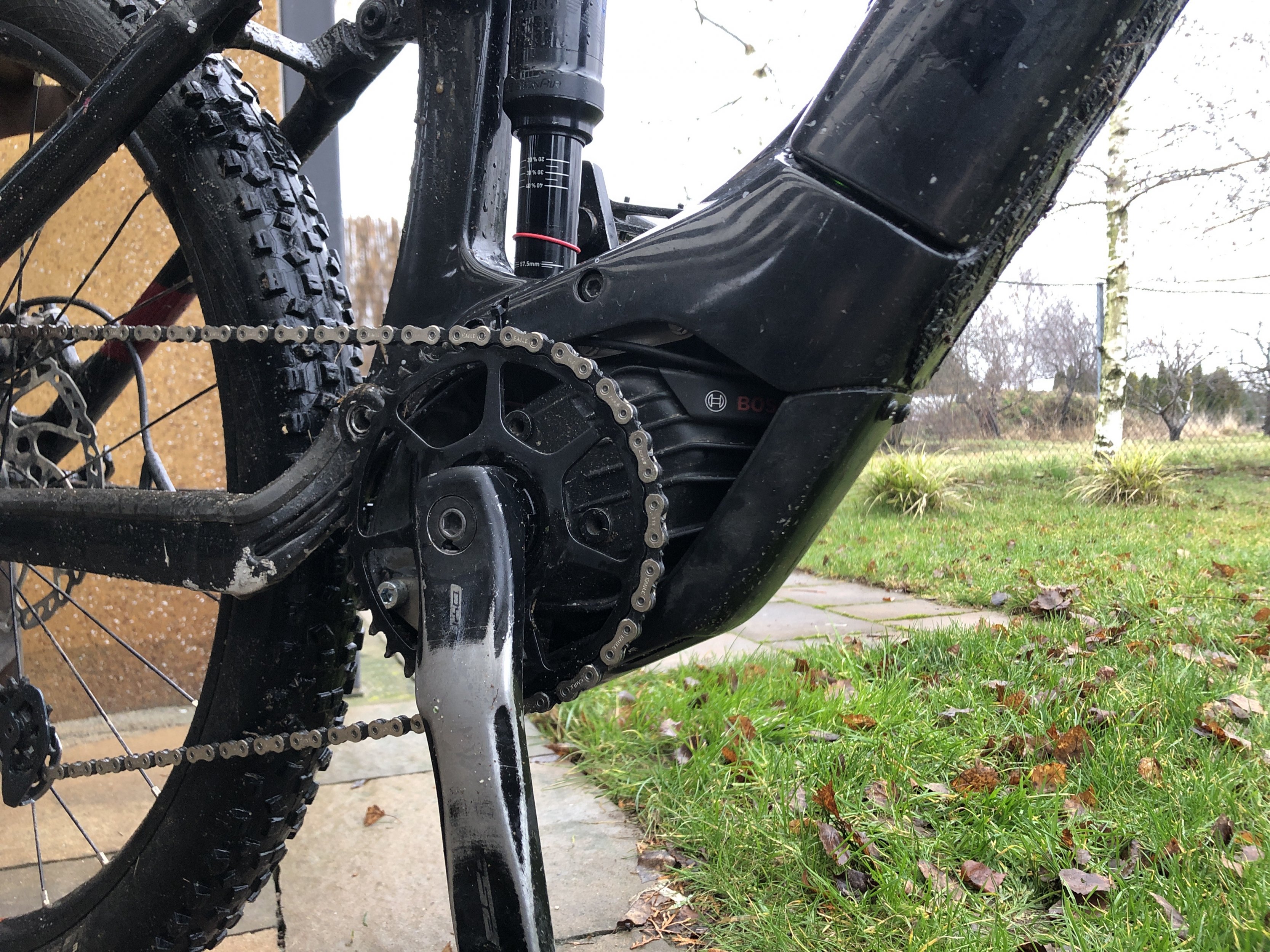

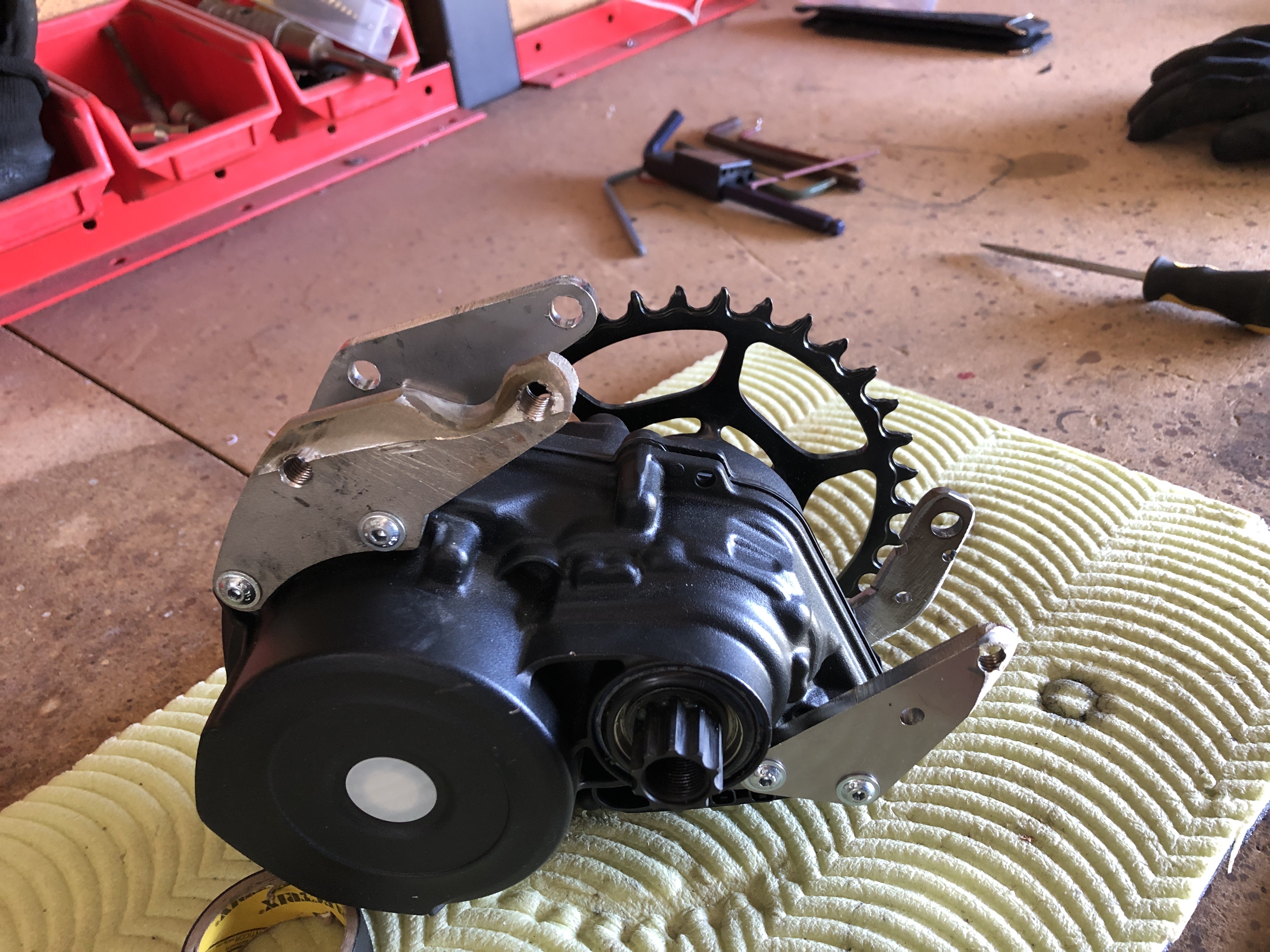

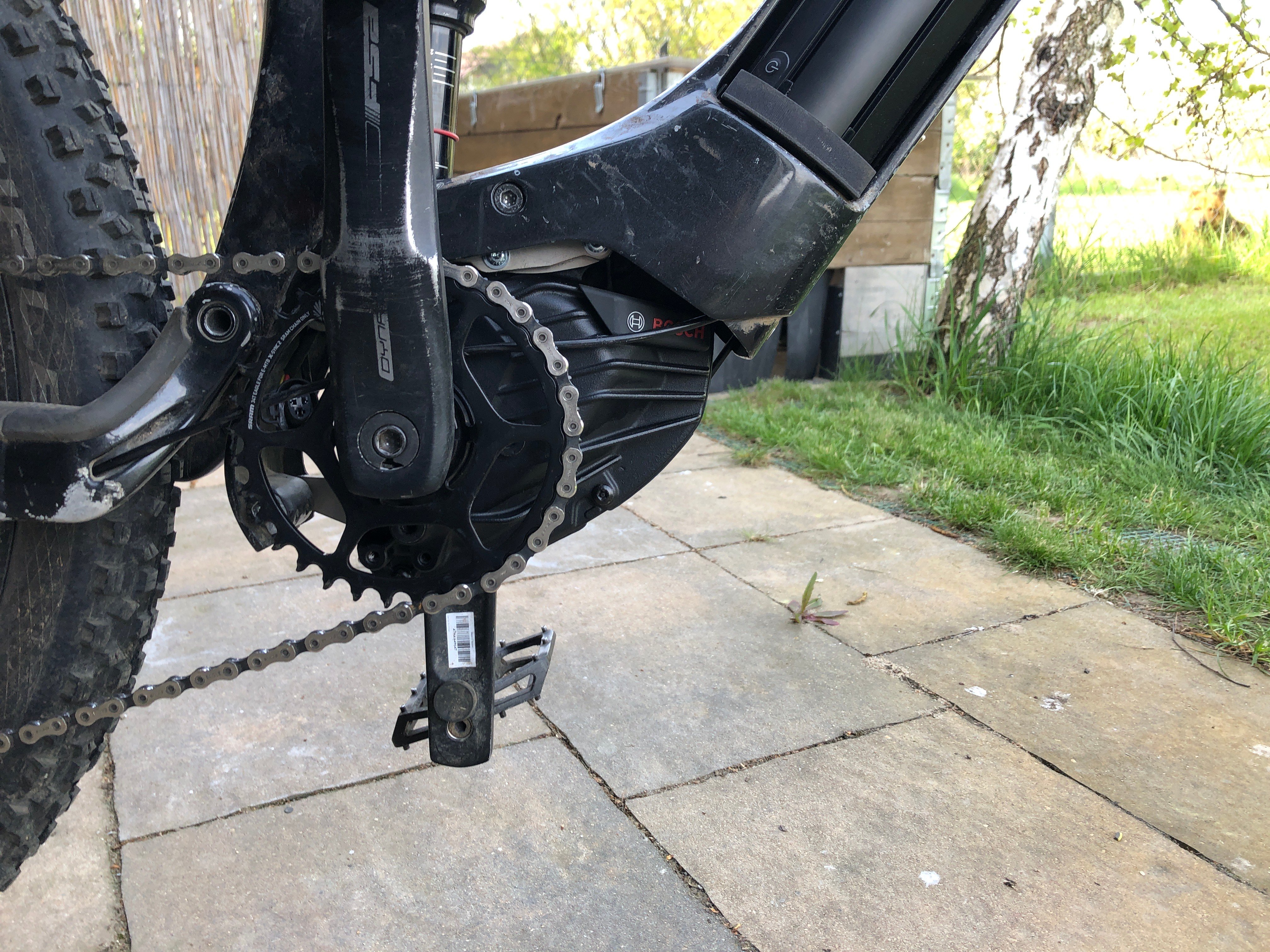

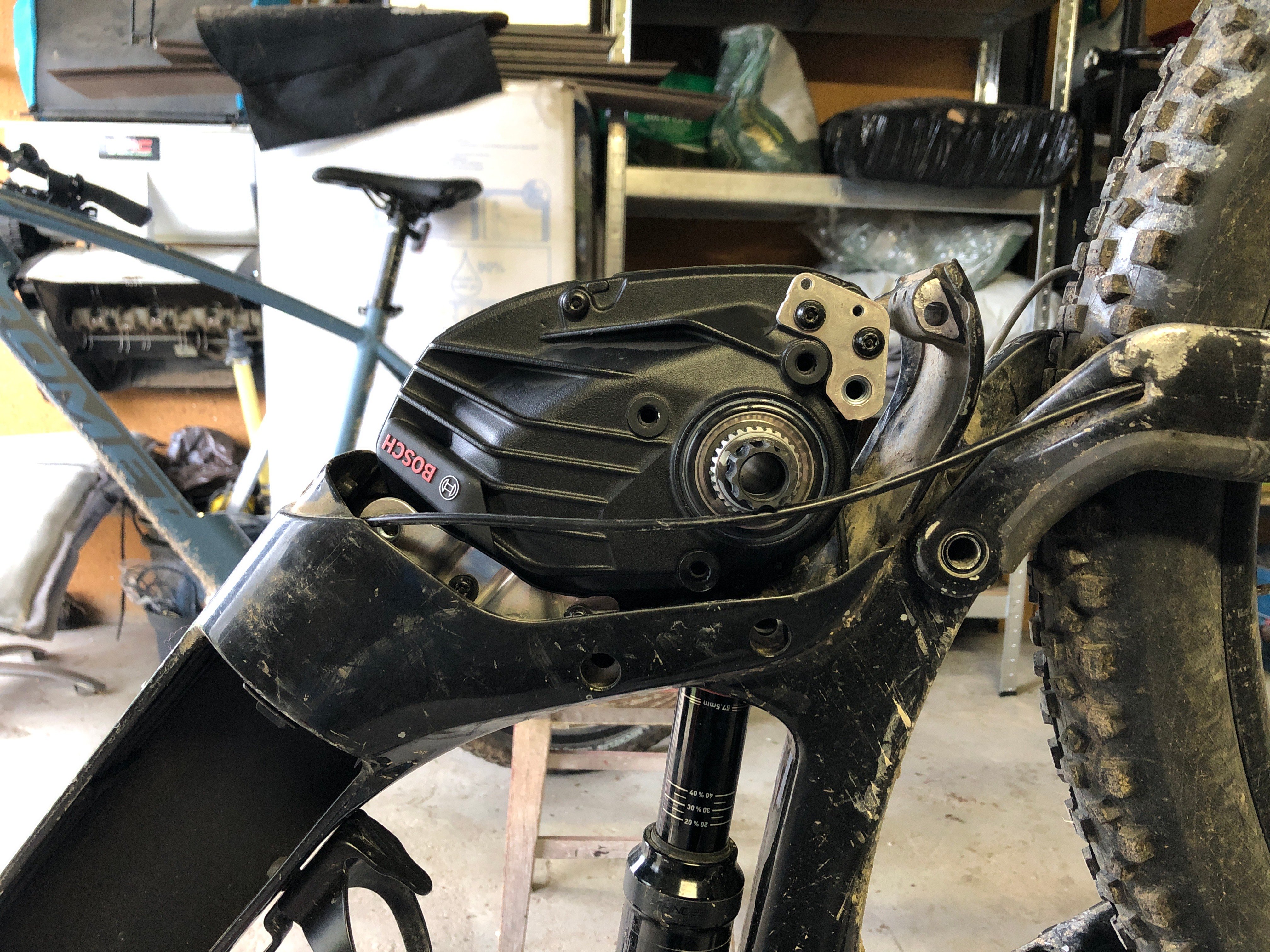

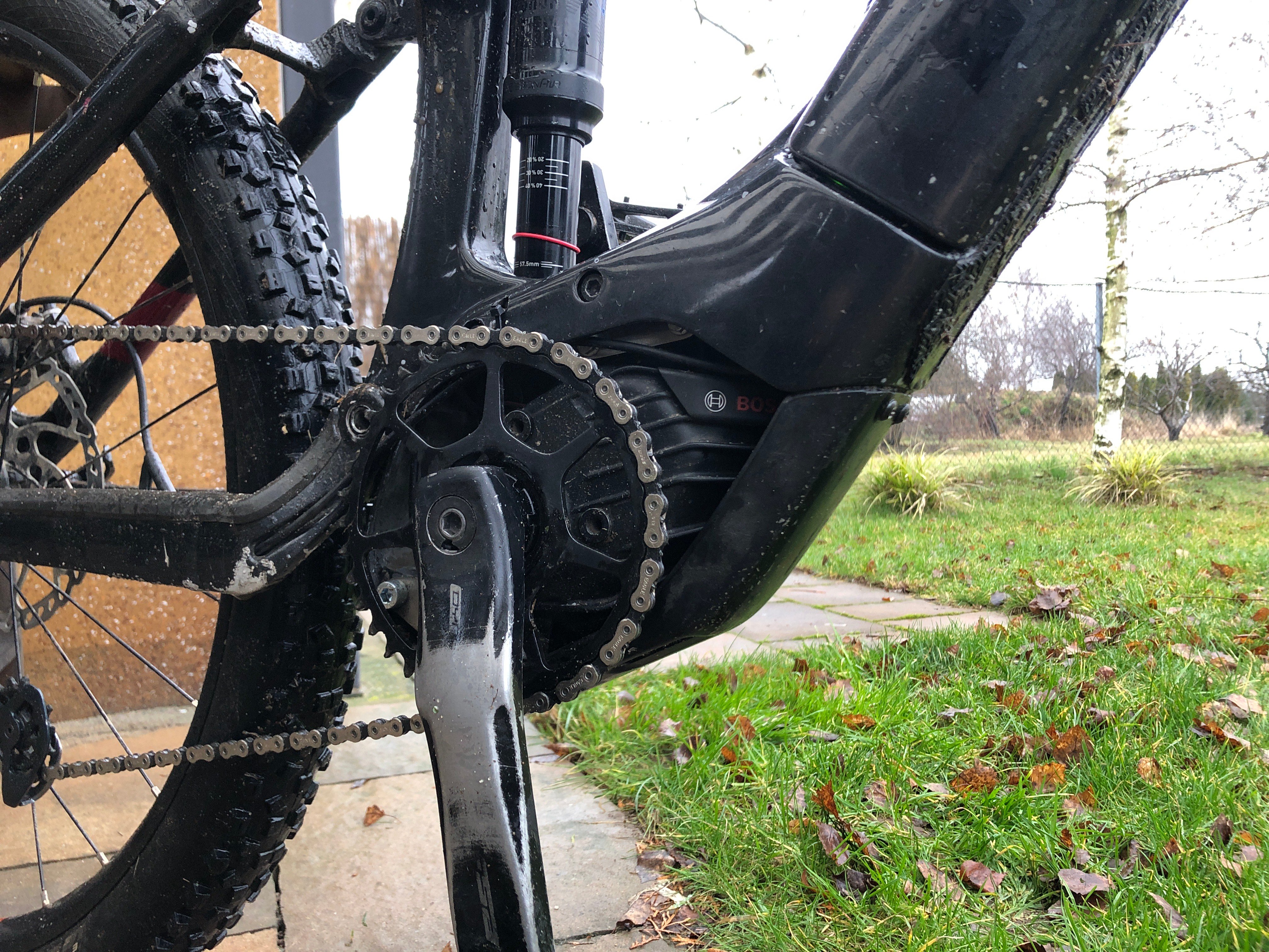

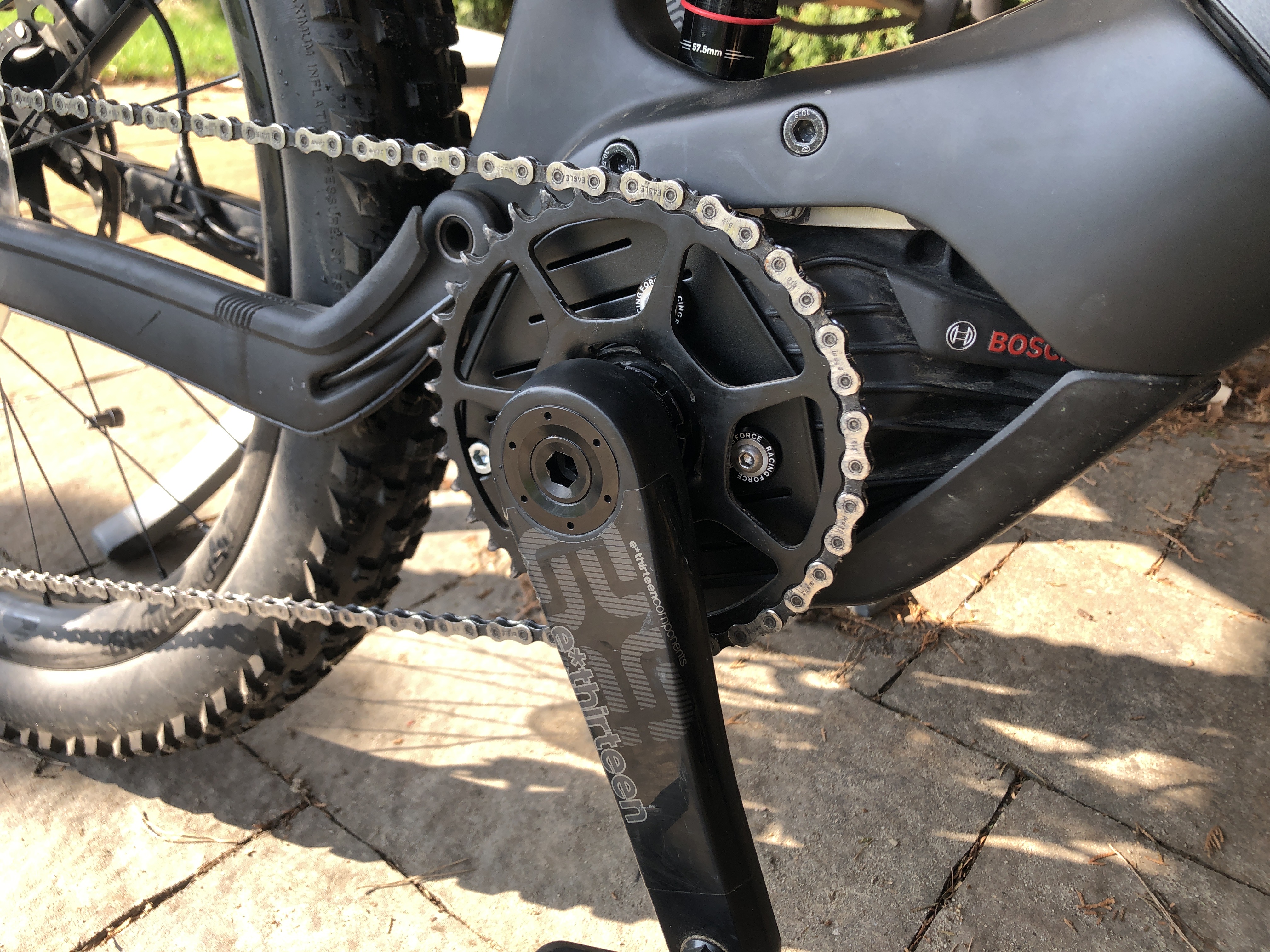

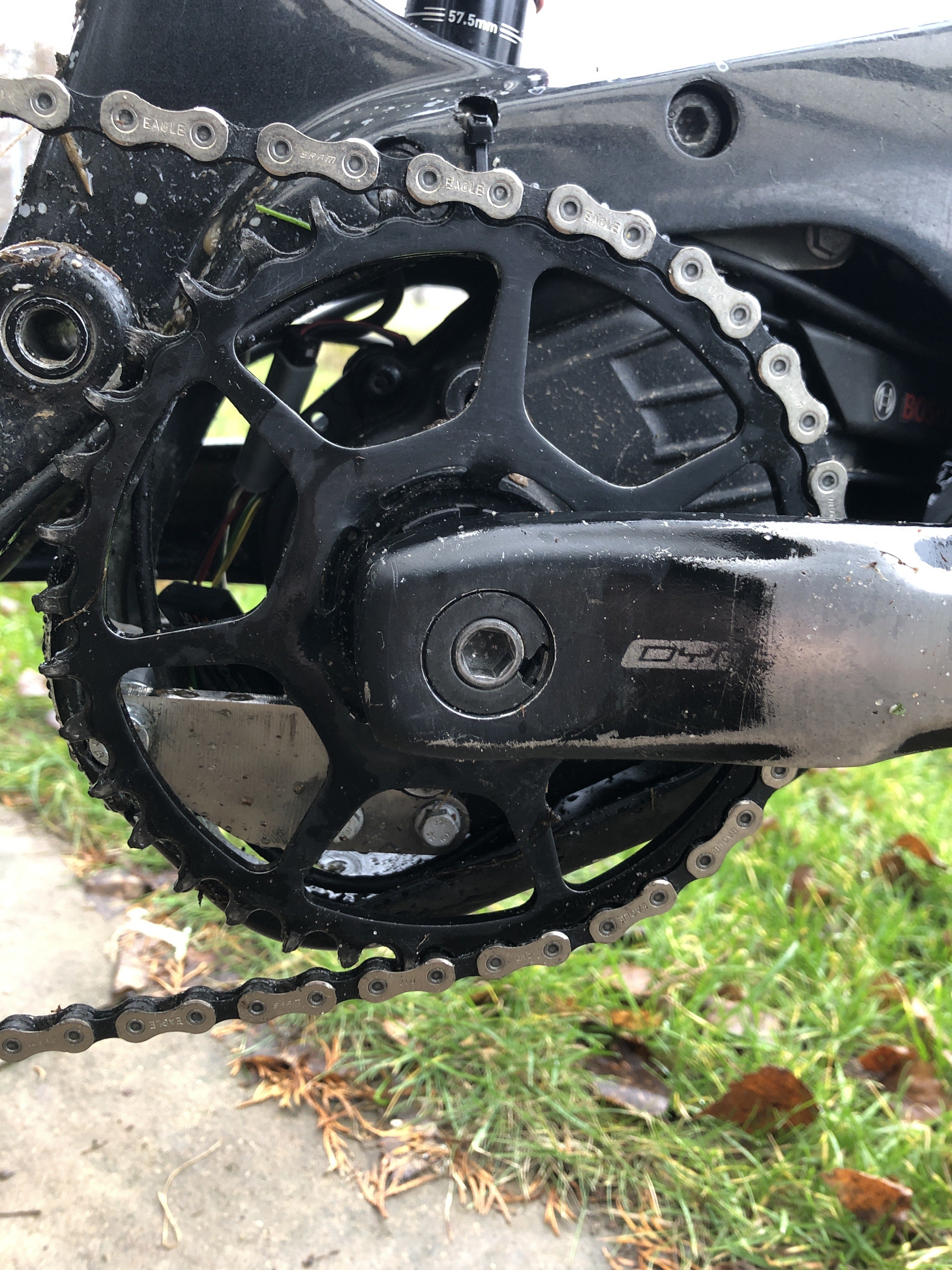

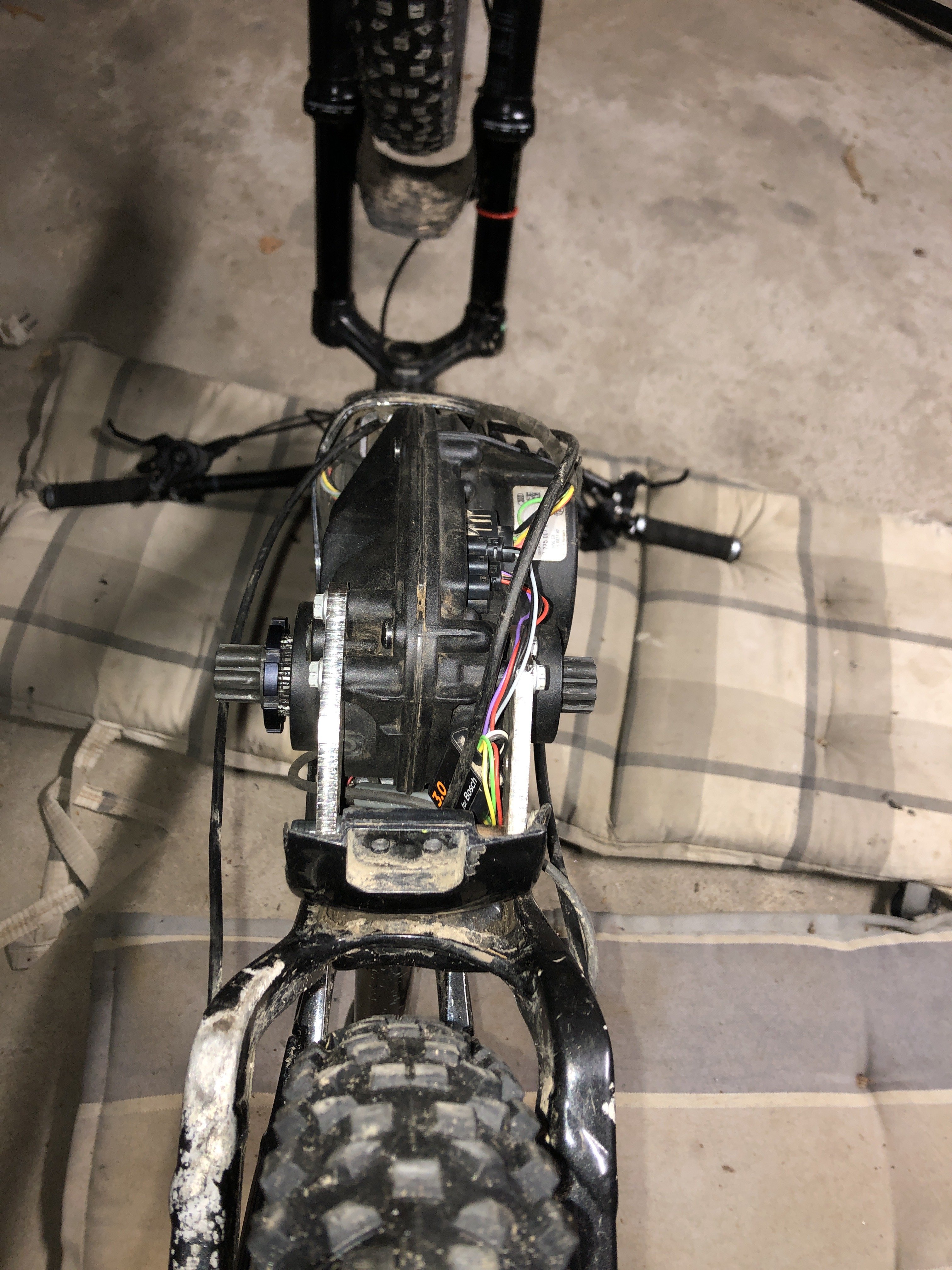

Hi, I’m in progress.
I’am not sure that will be work perfect. I will check it , I like it :)
Bike Trek Powerfly 9,7 lt plus 2019 in carbon.
Mount plates made from stainless steel 1,403 cutted on laser and milling.
Later I will design Alu covers.

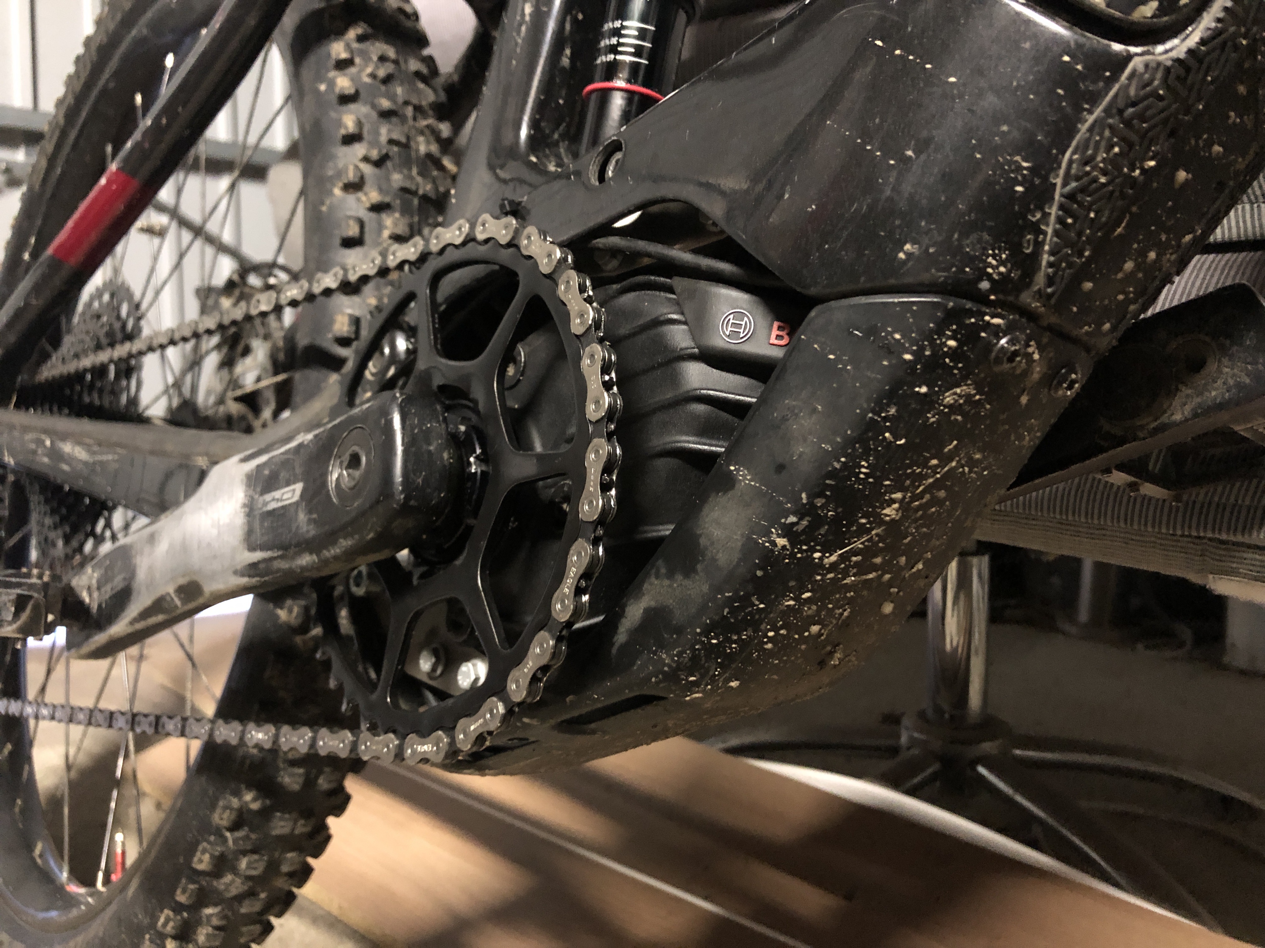

first feeling - quite ok. but I was try found which motor is stronger, more aggressive. I think that gen2 is very good motor comparing with gen4. I have a good comparison ( two motors on the same bike). and I’m still thinking to go with this far or back to old. Because is not big different with power.
Old motor have some disadvantages.
Noisy / sharp start stops / heavier /

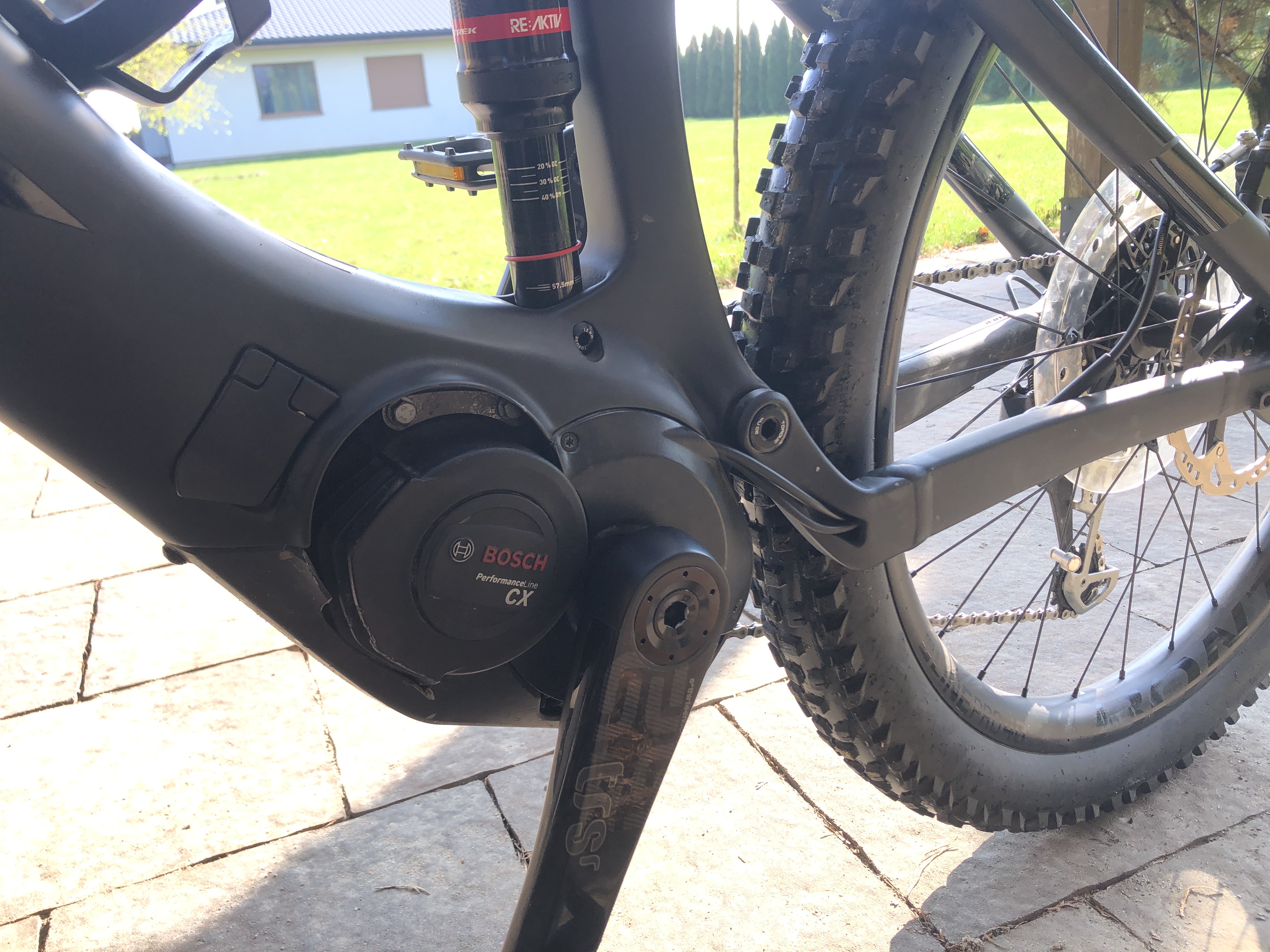

Bearingman. My gen2 have a ca. 2000km. On crank I feel small loose maybe 1-2mm on crank end. Noises are quite standard. When should I implement repair kit ? I found Zestaw naprawczy Bosch silników 2 generacji
Ca.100$
You are right - motor is like tractor 🤪
That is not a lot of mileage, so I would be very surprised if you need a service kit just yet, unless you spend a lot of time off road in mud and water. If the bearings were damaged or worn, you would hear a rough sounding noise! If you fit this service kit DO NOT fit the felt seals, they will destroy your motor, throw them in the bin!

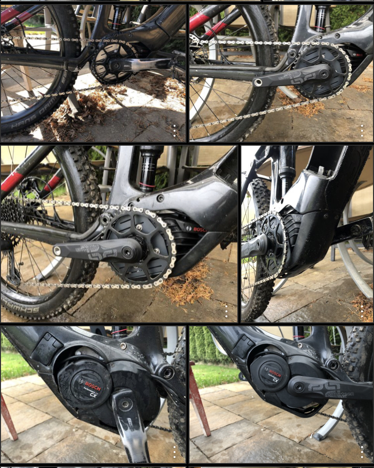

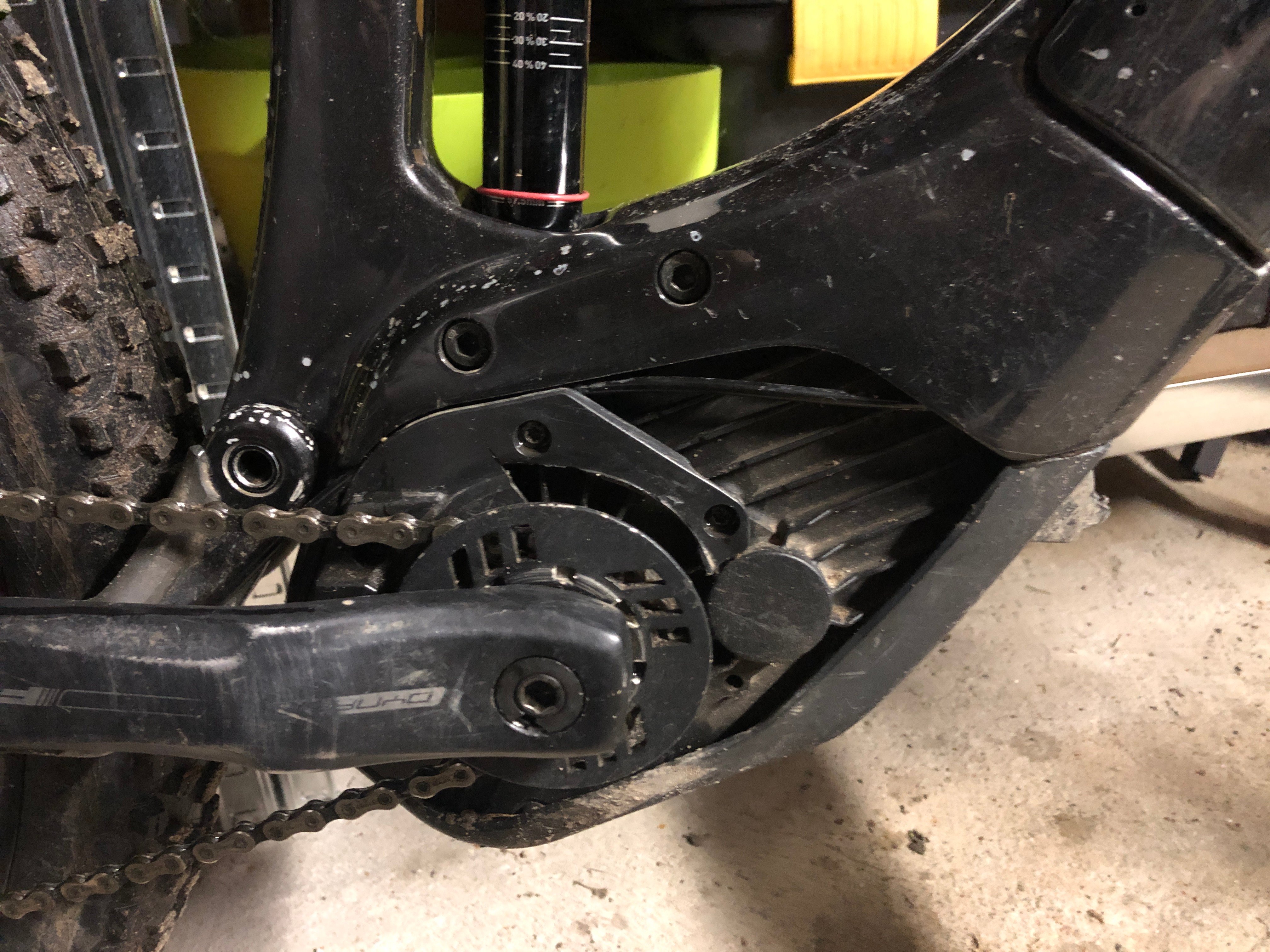

Thanks. Here are adapters on my second bike trek Powerfly 9.9. Right, engine mount are the same.
