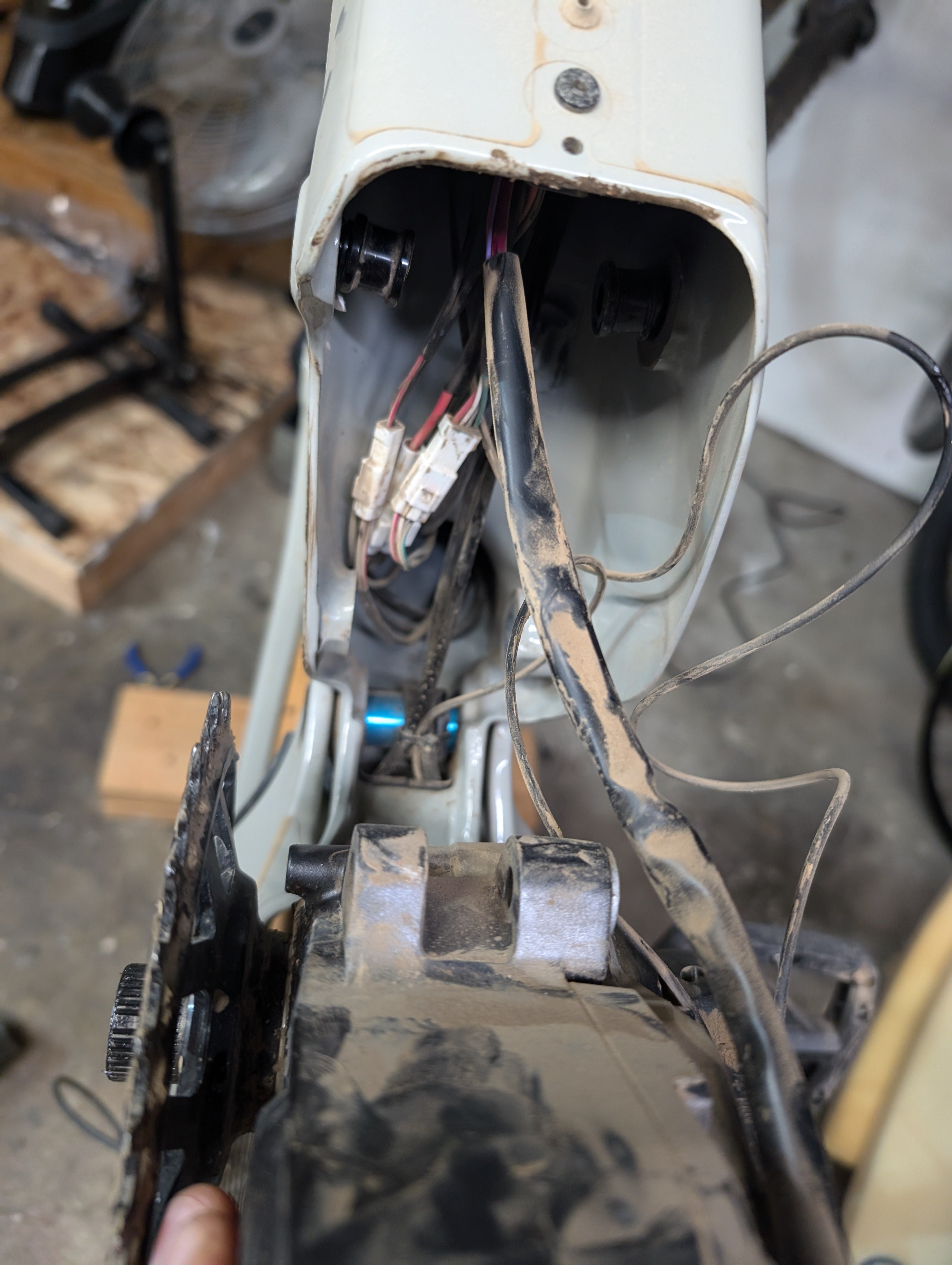

I got the Shimano e914 error code at the end of my last ride. Just pulled the motor to clean / reconnect / grease the battery to motor contacts.
This is really not confidence inspiring for long term durability. Everything seems to be "minimally made". My RC car has better connectors / wiring than this.

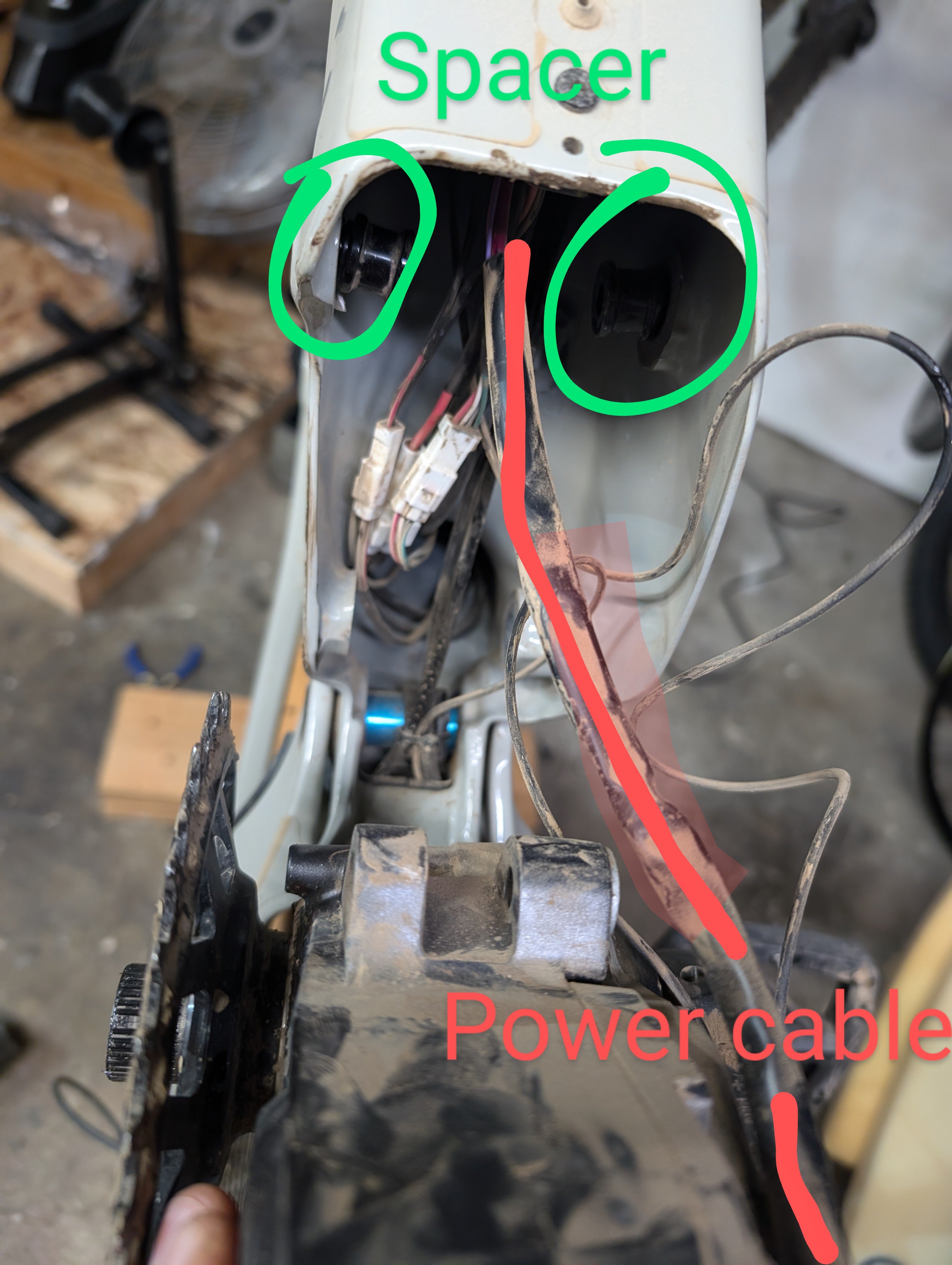

You can't see it in the picture. The power plug goes into the motor and almost hangs below the frame. I
You need to remove the chain ring (I used a chain whip) to access the motor bolts. When you remove the motor, bolt spacers yeet themselves out.

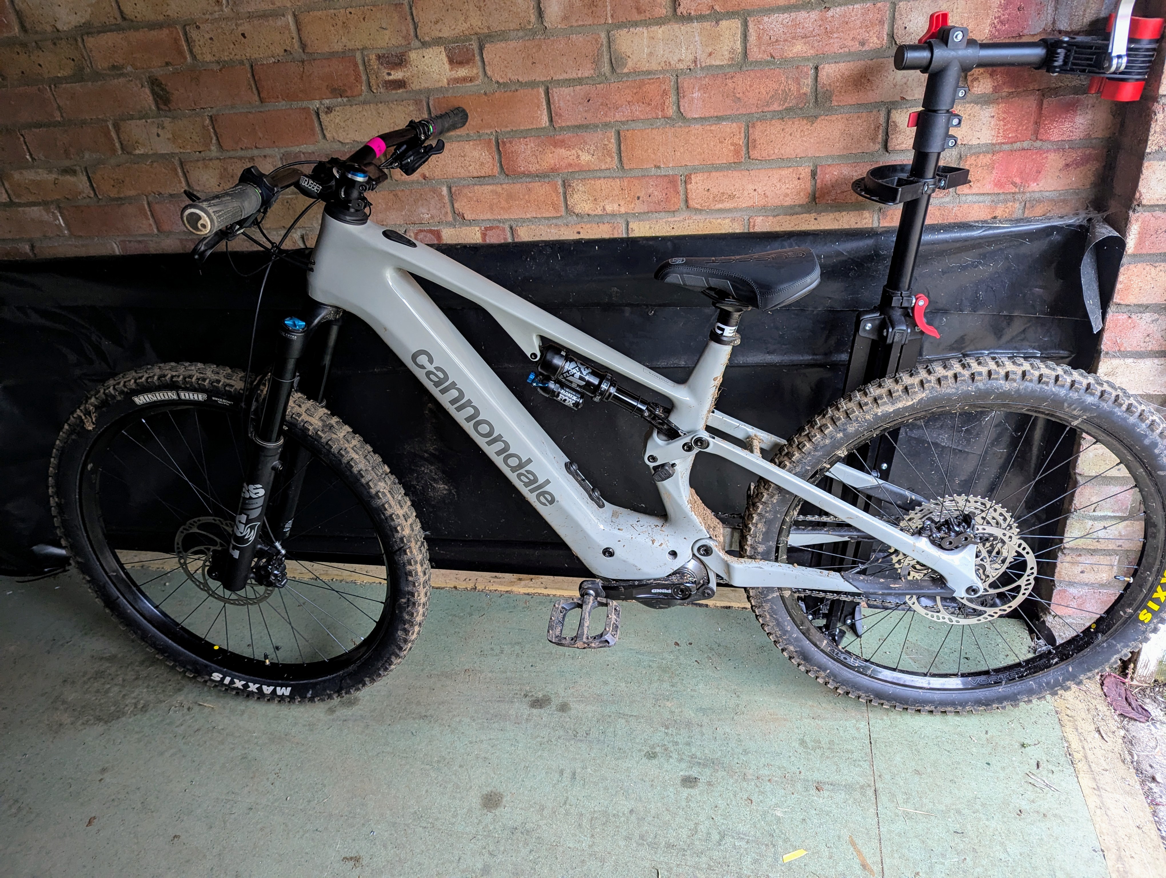

Sounds like an issue, my battery hasn't gone under half all winter, or had a single issue. Plenty of 0-5C rides. Tbf I don't do long distance rides but ride my version of hard for a good 3 hours, albeit with a rest break after every line and every climb back to the top, and do all my climbing in full turbo for health reasons. I descend at about 70% power on green mode, but it's mostly gravity stuff I ride so not much power use on descents I guess.
Pic of my moterra for fun.
