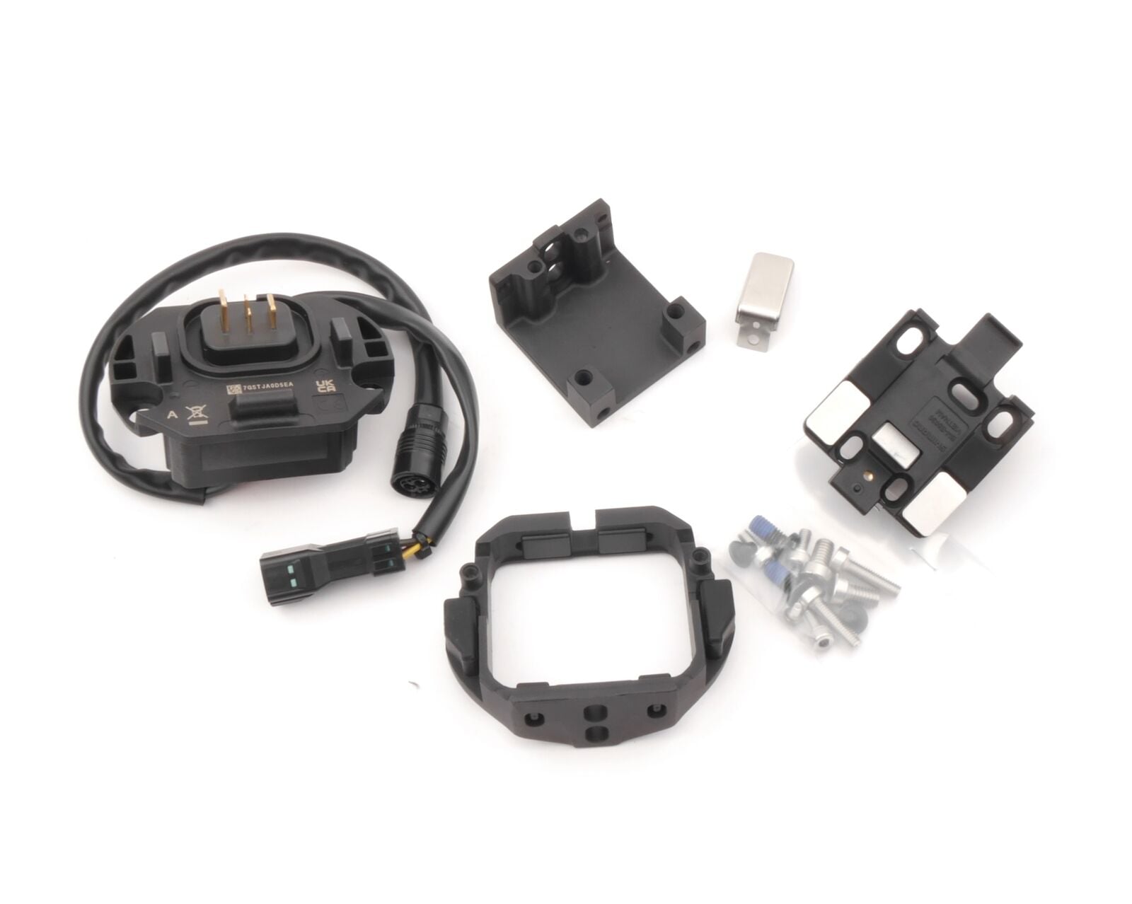

Do any of you guys know if the Moterra SL uses a standard Shimano battery mount/loom, or is it a custom one? I know it is a custom battery, but was unsure about if the custom battery was configured to use standard wiring. Here is a pic of what I believe is the standard battery mount and loom for comparison.
I don’t think it’s the same, i don’t recall seeing around connector inside
