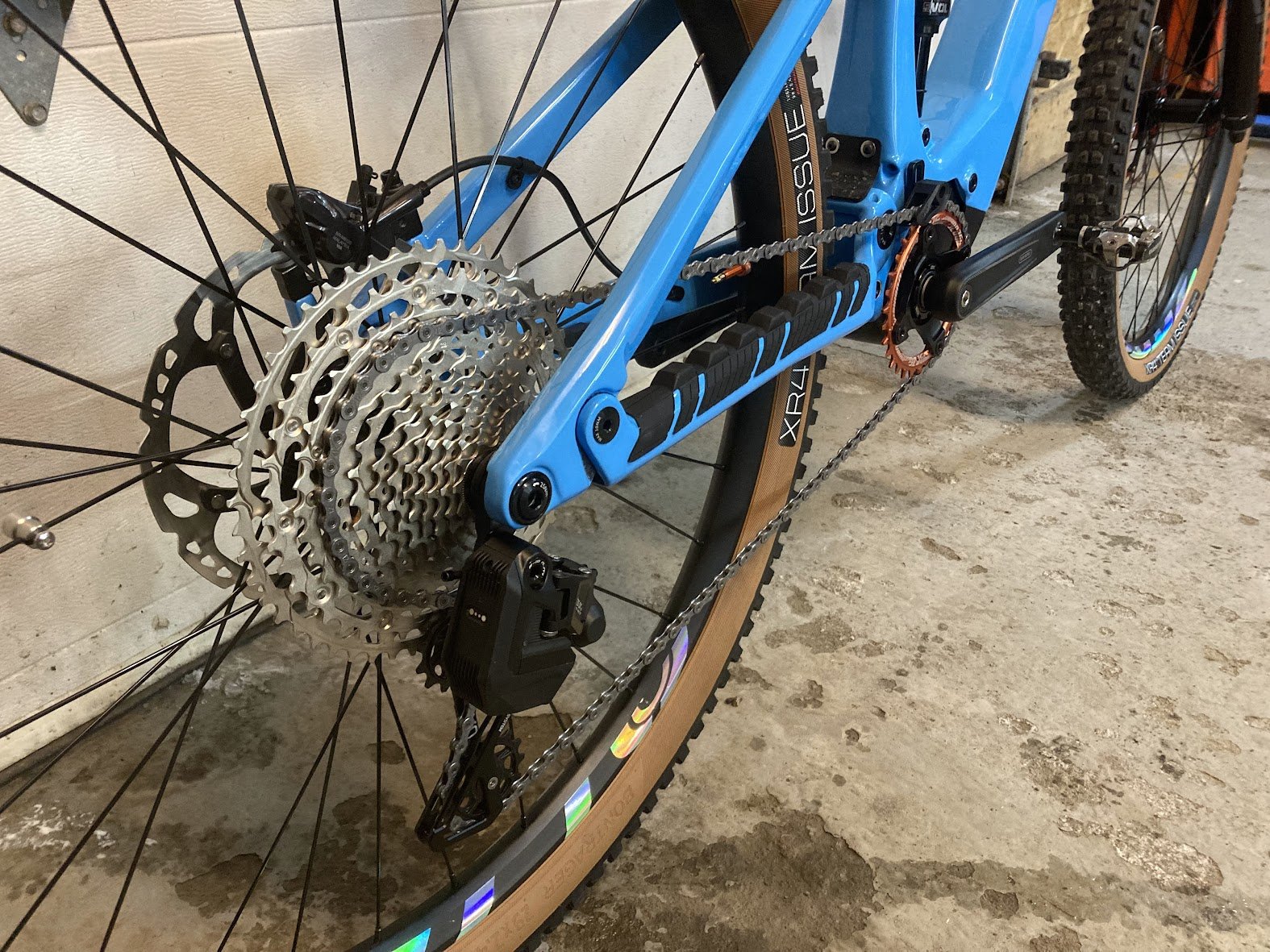

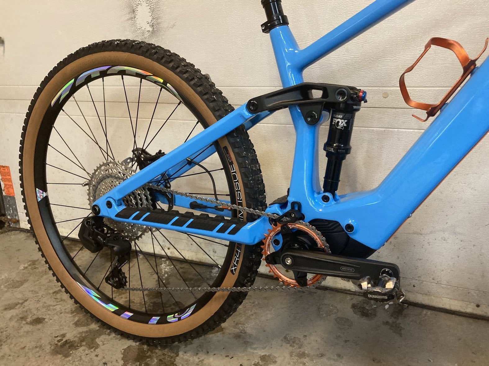

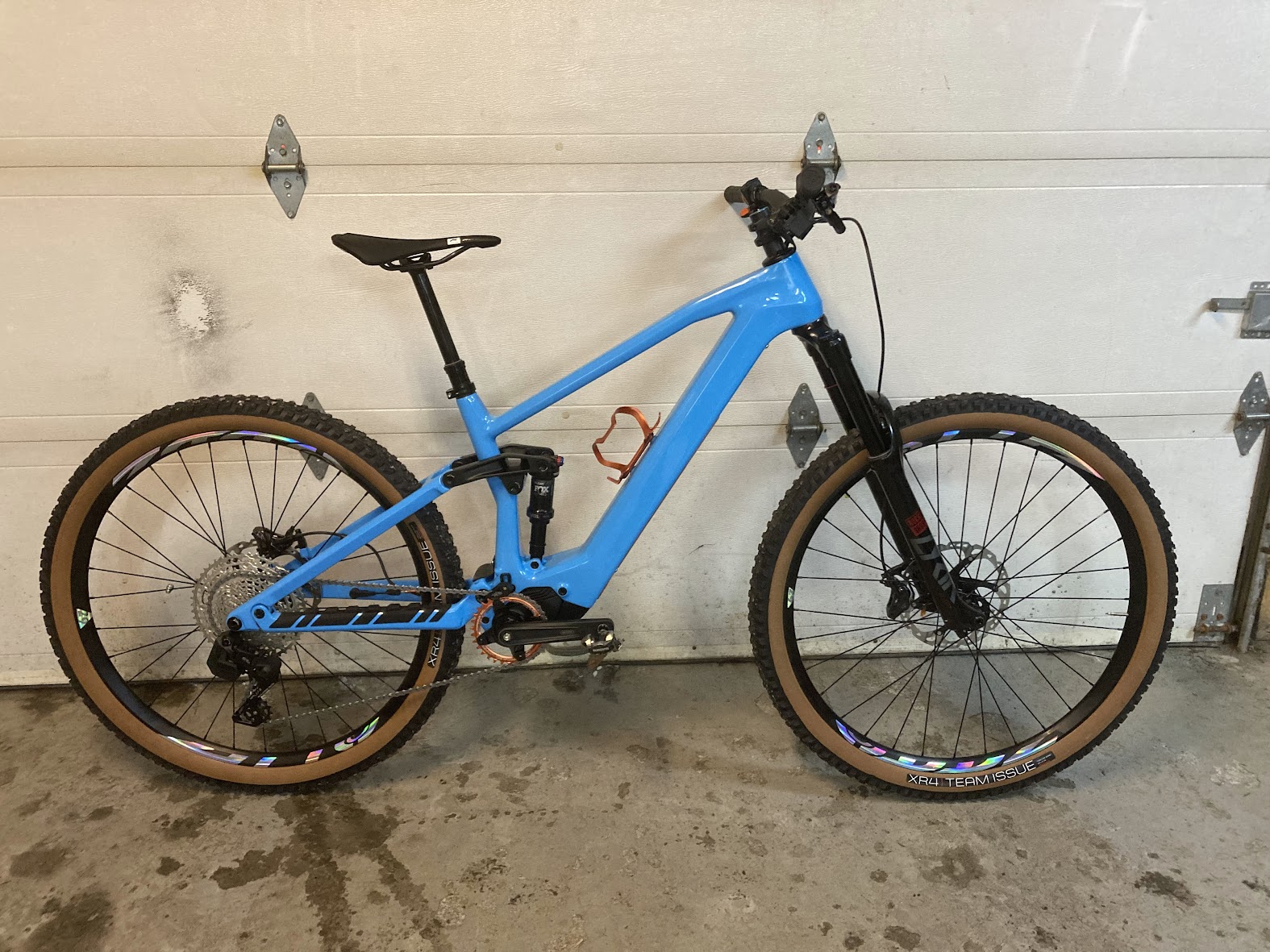

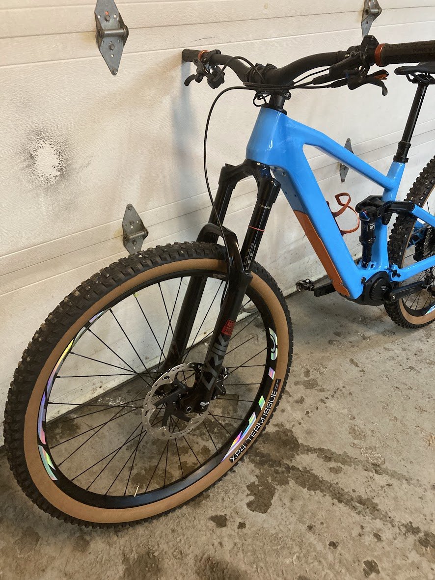

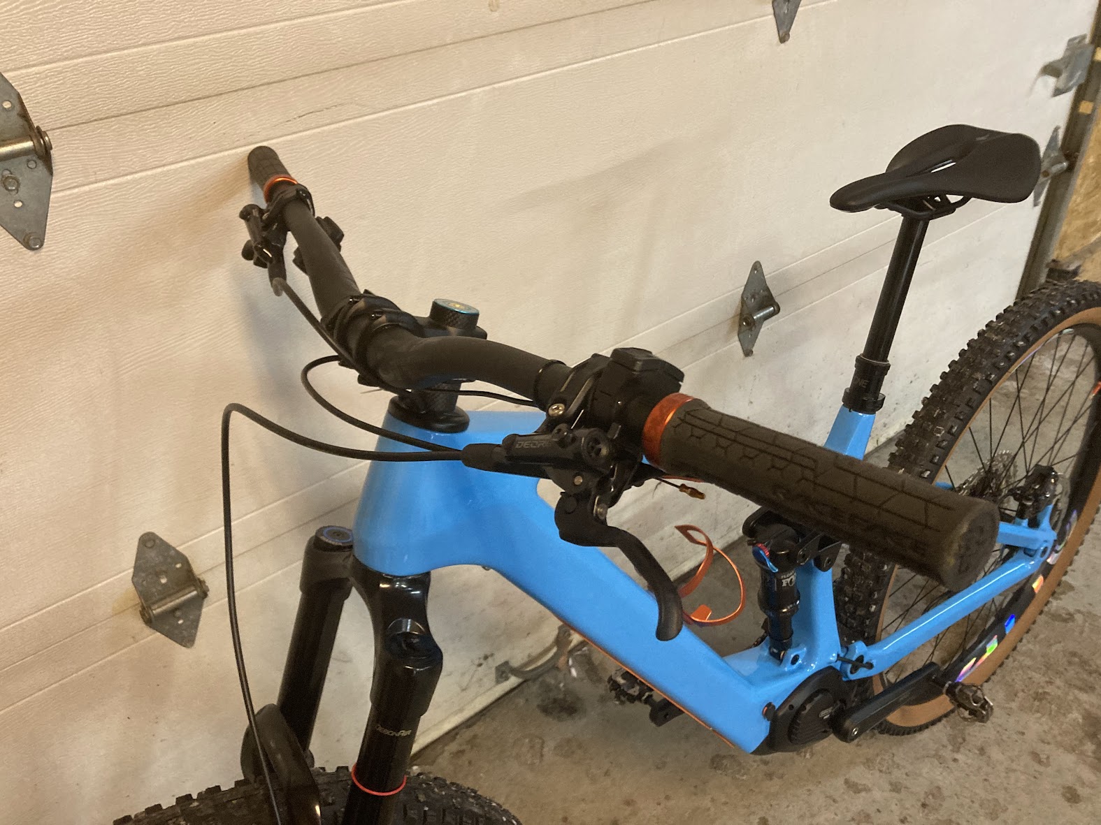

I just completed the assembly of my LCE930 and I'm sharing some pictures
A huge thank you to Jim at Lightcarbon for the great service and good communication.
Fit and finish on the frame is really nice.
The paint was done by Lightcarbon and looks really well
Complete built as pictured is 19.4kg, frame size is medium
Main build components:
Bafang M820 motor with Bafang 410Wh Battery
Aluminium 104BCD adapter + 32T aluminium chainring
Display is a Bafang DP245
Oneup V3 dropper 150mm and remote
Oneup Carbon handlebar
Raceface Affect 35 stem + RF grips
Rockshox Lyrik Select+ 160mm
Fox Float DPS EVol rear shock
ZTTO DR390 29er wheelset
Bontrager XR4 29x2.4 tubeless mounted
Casette and chain are Deore 12spd
Brakes are Deore 4 piston M6120 with 203mm rotors
Derailleur is a Wheeltop EDS OX
Pedals are Shimano PD-M540
It's only missing some stickers and I'm now waiting for the snow to melt here in Quebec, Canada to test my new bike!
