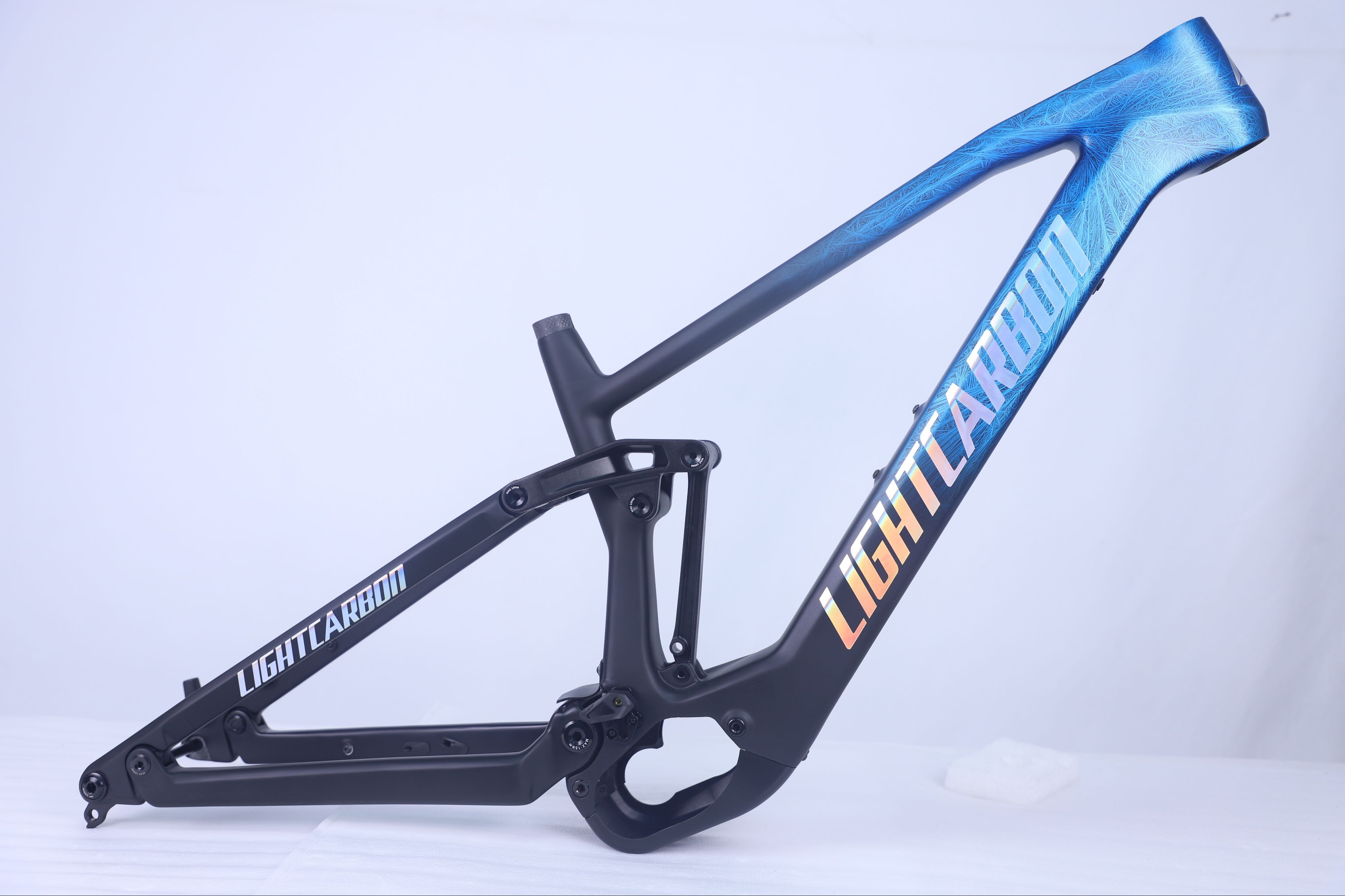

Also id like to thank Jim Lee at light carbon for the help in purchasing the frame and info on builds. picture below is the paint scheme i went with, was instock, looks great and should mean a faster delivery.

Frame is here!!! I'm very happy with the quality of the paint, fit and feel of the frame. No sharp edges inside, resin looks uniform and all in all great value. My cell phone picture skills dont do it justice, the paint appears to have a matte finish but still sparkles in the light and the stickers seem to change color based on light.

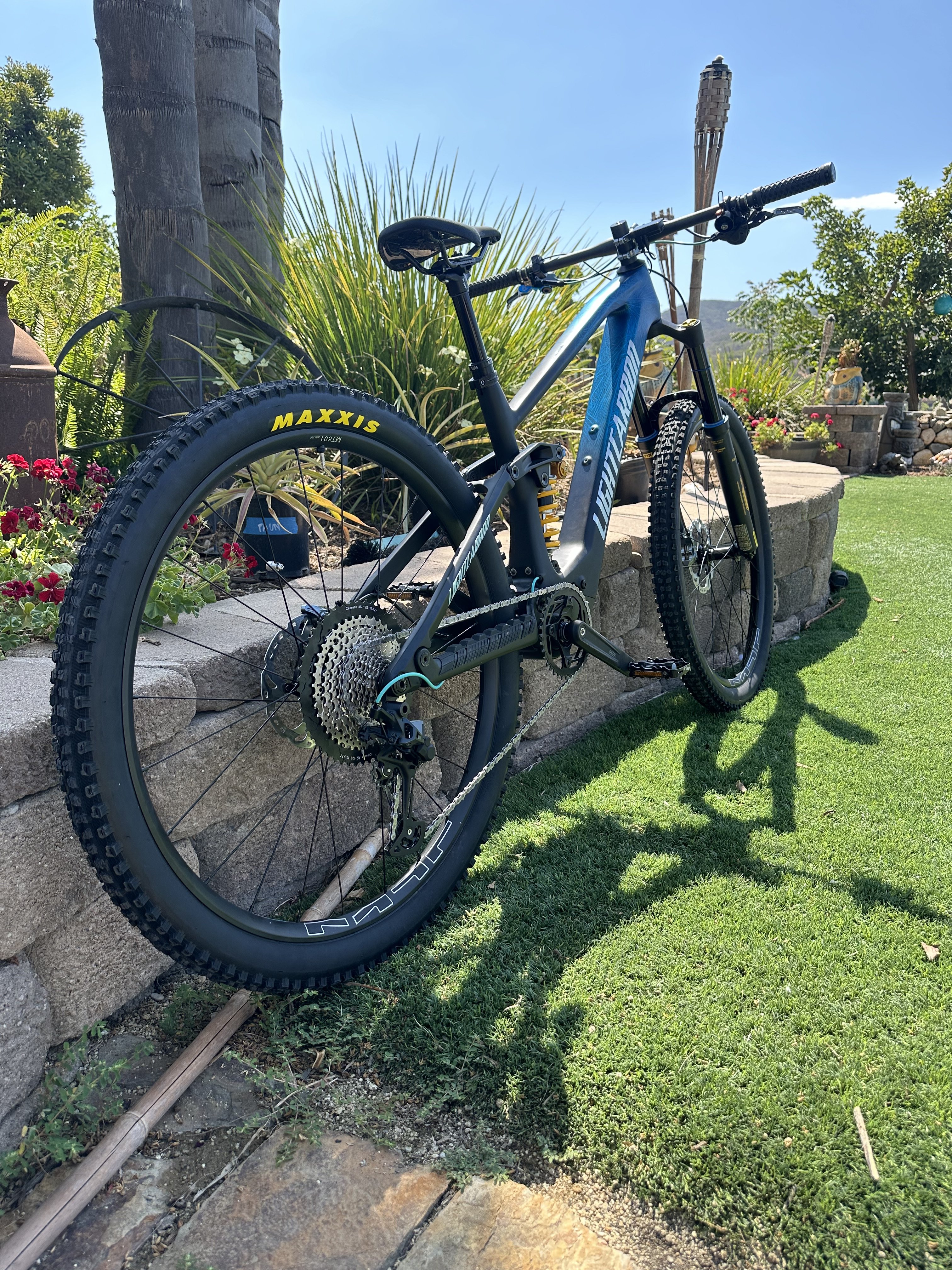

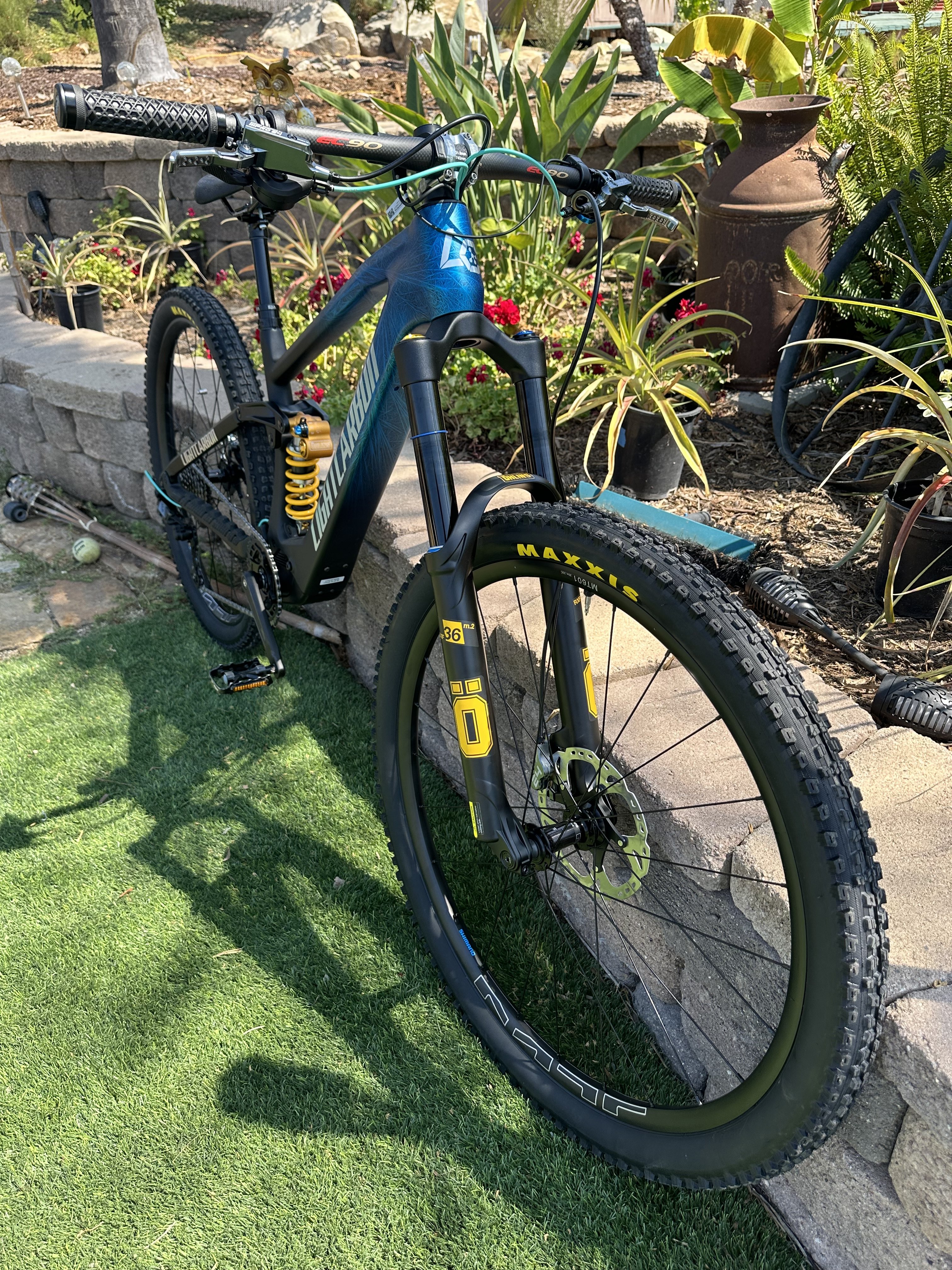

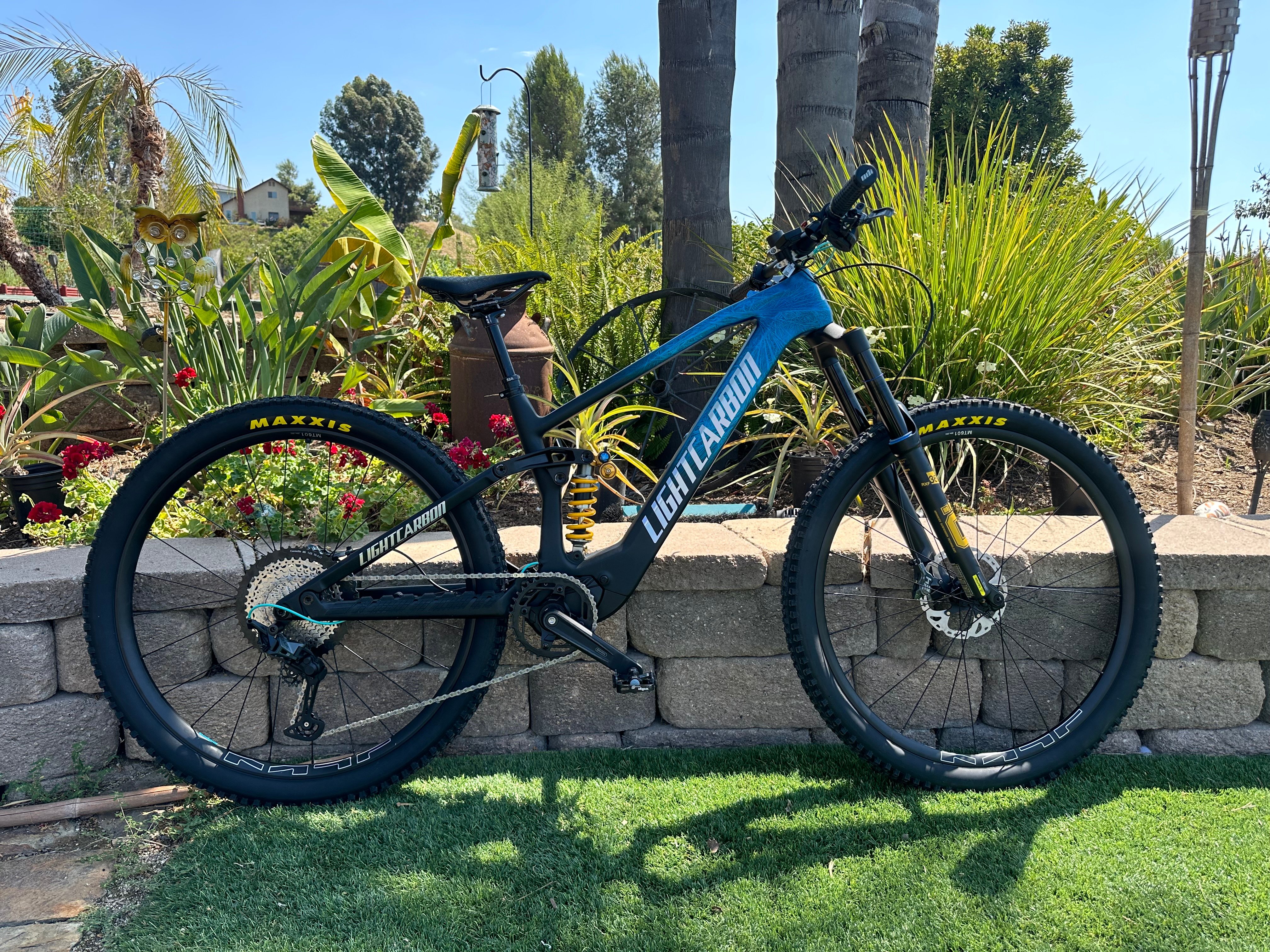

Its alive! Im fresh back to mtb, been maybe 6 years since my last mtb was stolen and i started riding road/gravel only as i was busy with life. Super plush, carves great and takes a set with alot of confidence.

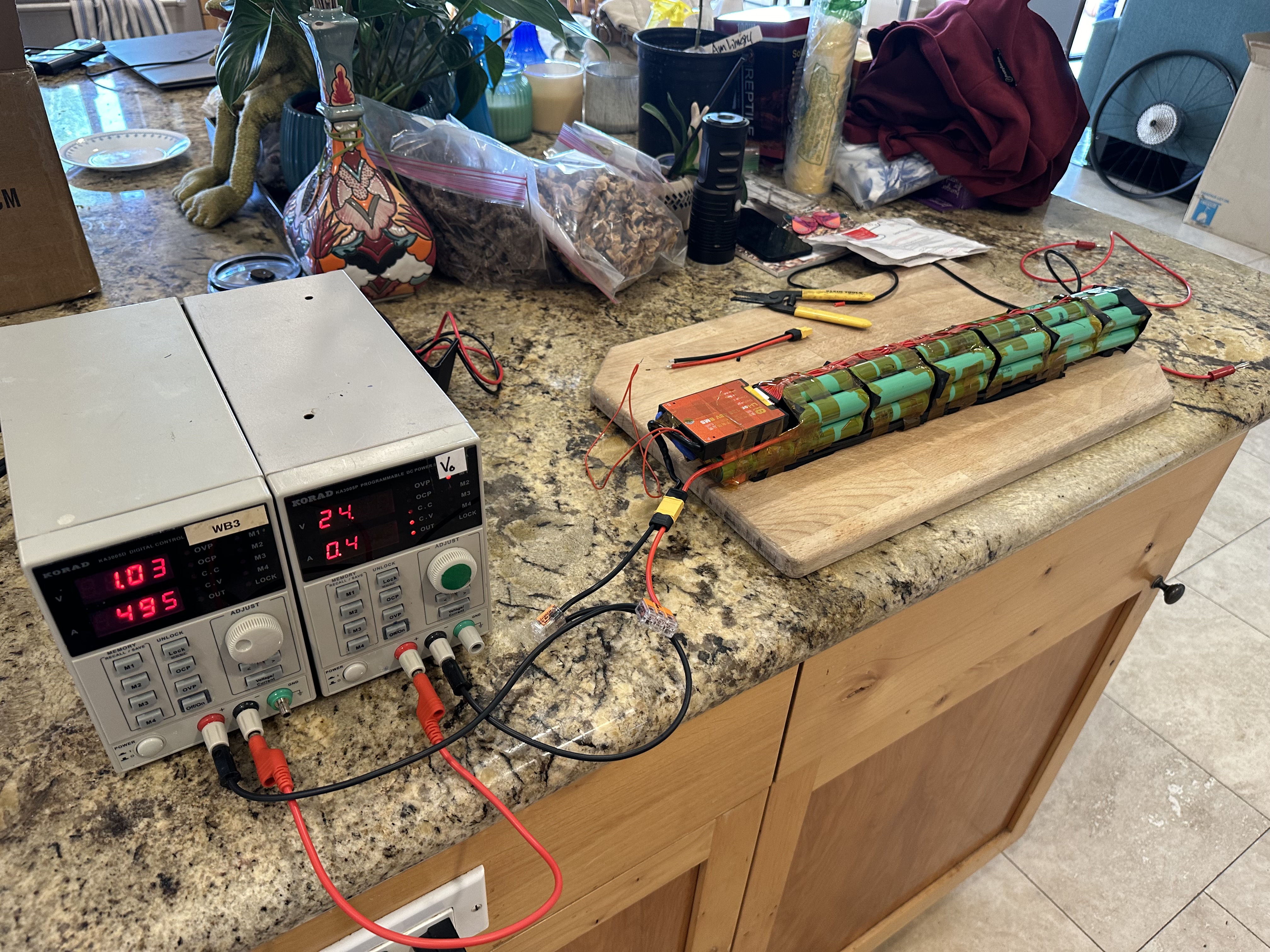

The battery pack is a home brew 2170 3PS13, it fits, but is snug. I wanted the cells to be able to expand with heat so i designed the pack to have a 20 tho gap between cells. I spot welded the cells in groups of 6 and then folded into a straight line, fdmed a spine like structure to hold each group of cells and then tieded them together with 1/8" carbon rod. After heat shrinking the pack its pretty sound, only fear is if i take a spill in water as its not water tight.
time to ride and start dialing in the bike!

Nice build! Amazed by the weight as well, with a coil !

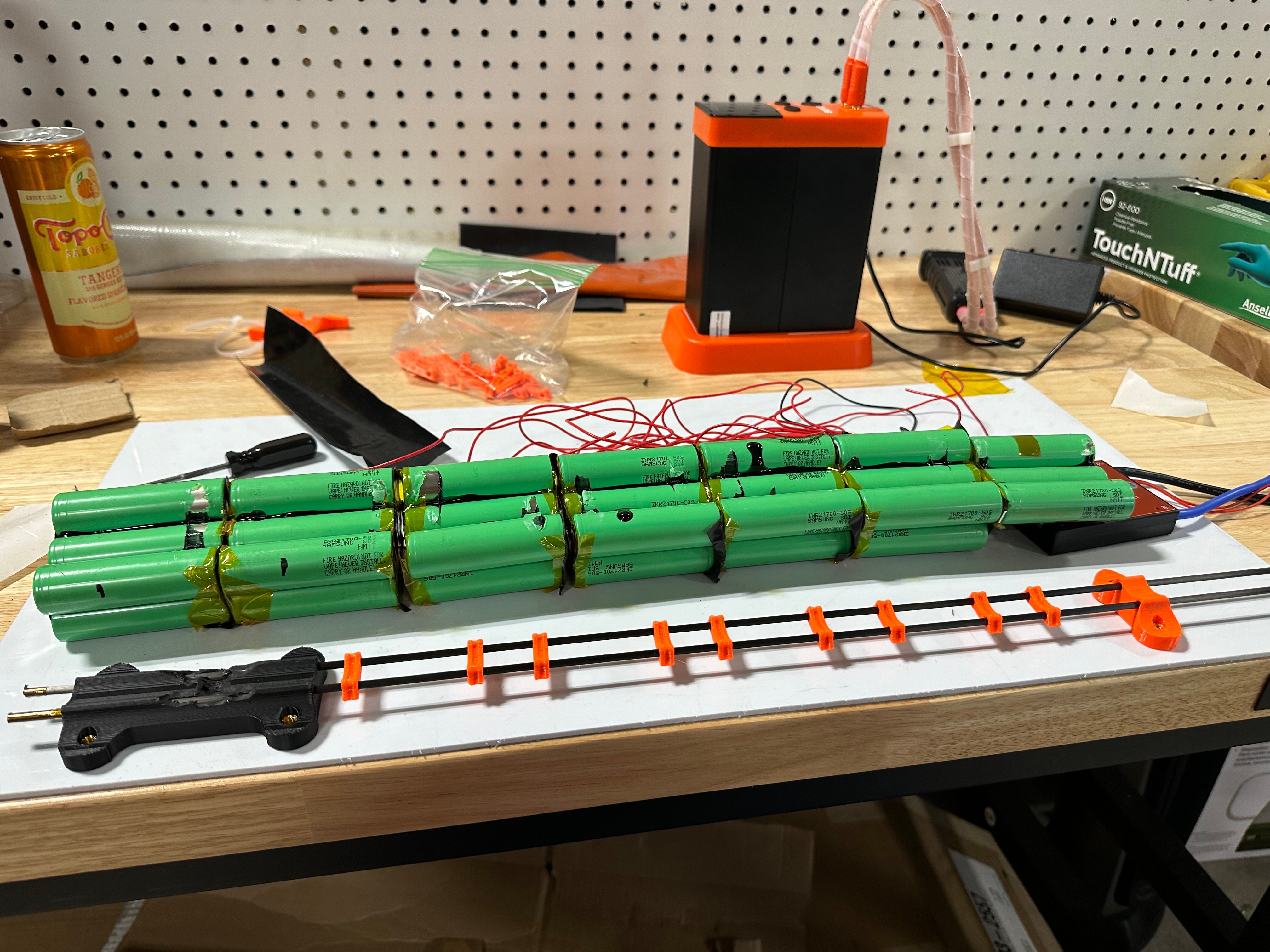

As requested here is the battery pack info and stls for the plastic 3d printed parts. I want to caution people that working with battery cells can be dangerous, please be careful and I in no way imply my design is safe or easy to build. If i make another battery pack i would refine some things and probably make a better alignment jig for laying everything up to the carbon spine. Do not over constrain the battery cells, they need to be able to swell if they get hot, i choose to use E60 potting compound because i had experience with it and i know it gets soft when warm, next time i would choose a more viscous potting compound with the intent of gluing the centers of the cells together but allowing air at the outer bits. The bms was the largest part of the pack and the trickiest to fit in the downtube, next time i would align it to the pack in the tube before fixing it to the fdm mount with e60.
Parts
39 x Samsung 50S 21700 5000mAh 25A Battery 1860 battery store
1 x pure nickel 200um thick, 8mm wide roll aliexpress
1 x 48" 1/8 od carbon fiber rod mcmastercarr
kapton tape 2" wide mcmastercarr
E60 potting compound Henkel
heatshrink 150mm flat width, 3m length Amazon
charger (untested at this point) amazon
charging port (untested at this point) amazon
bms amazon
6x burn in thread inserts 6mm tall, tapered od 7mm to 6.12mm (had on hand, no link)
all parts where printed on my prusa mk3 with petg and standard infill.
i had to clearance some of the mounts to clear e60 that ran in the previous steps. be carful working with carbon, its dangerous to inhale or get in your skin. I assembled the spine in 2 steps, i put the upper 4 hole mount on, with all the sine sections and let cure overnight, in the morning i put it in the frame and aligned the lower 2 hole mount so all 6 mounting holes would be accessible, marked the position, and removed to fix in place with the e60. I also charged the first cycle with a current limited benchtop supply and with out heatshrink so i could see if anything went wrong before i sealed the pack up. I would not trust the pack to be water tight, i may revise the heatshrink before winter. Do not over tighten fasteners into the cell, get short M5 fasteners.
This probably took me 8 hours to fully assemble, i was having fun and included cad time in that, if you take this on, have patience. Good luck!

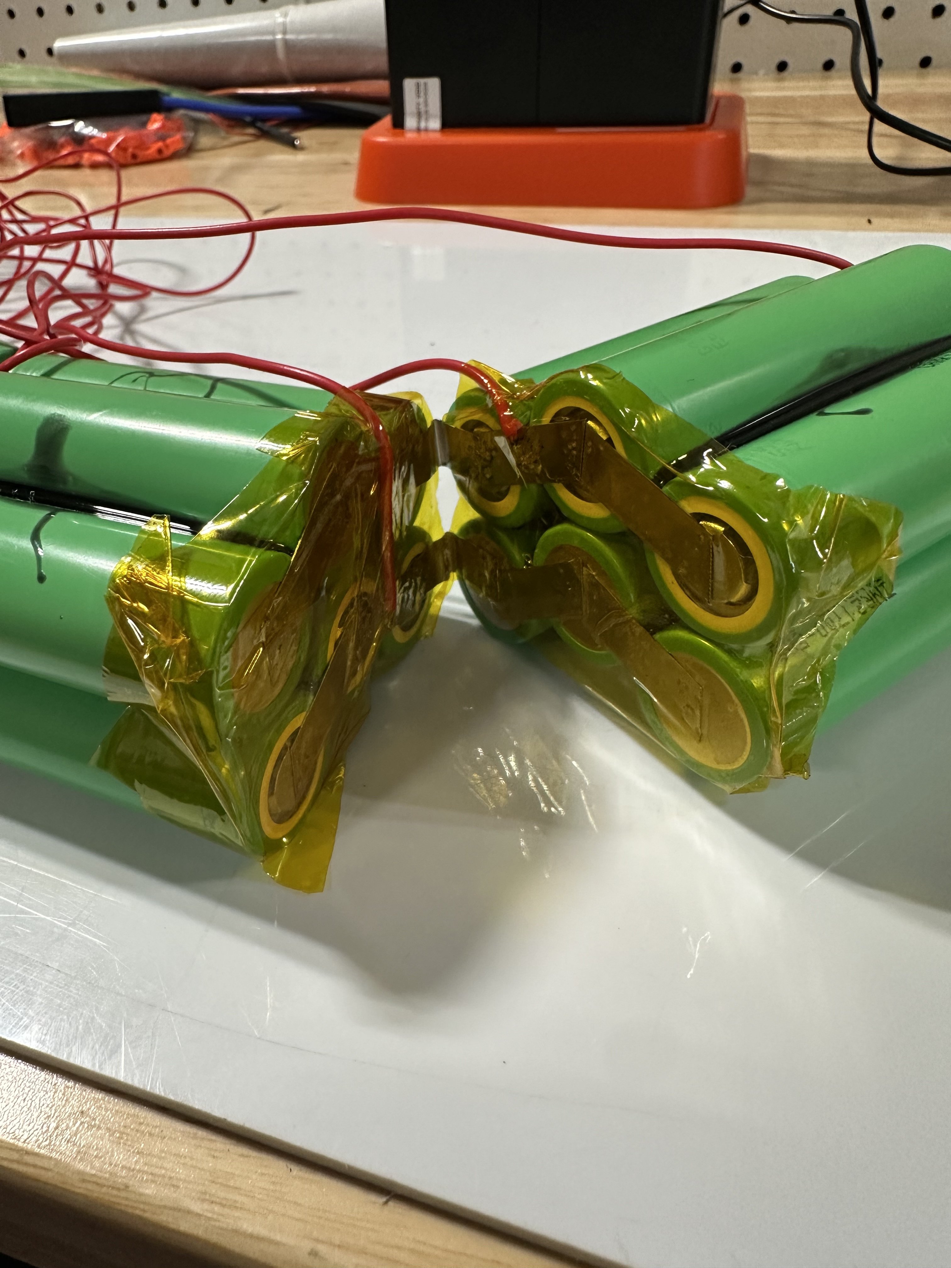

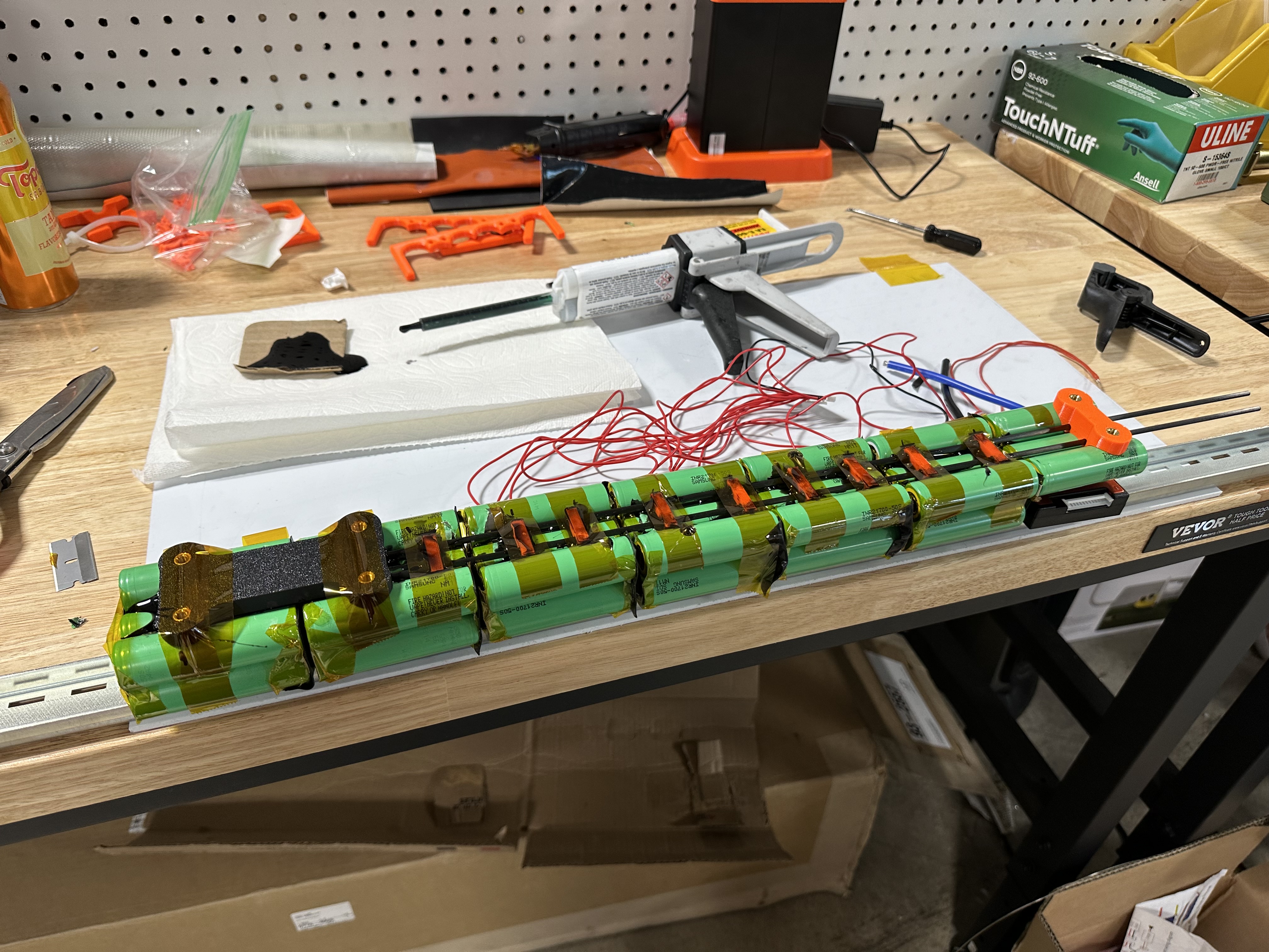

print atleast 2 6 cell jigs and square up the cells so the top and bottom are different polarity as in the picuture below. Use a dab of e60 (or more viscous potting compound) in the center to tack the cells together. do not use too much.
next i cut the nickle strips for spot welding. the nickle will weld to the cell metal alot stronger than to itself, cut in a shape that allows each weld to directly make contact with the cell.
assemble the 6 groups of 6 cells (12 groups of 3 stacked 2 high... ><), and 1 group of 3 cells. then when ready to put the whole pack together, use the 2 wide jig to align the cells before spot welding 2 groups of 6 together. (note polarity). solder sense wire in a way that it will not rub on sharp edges, kapton and fold long-wise before adding the next group of 6...

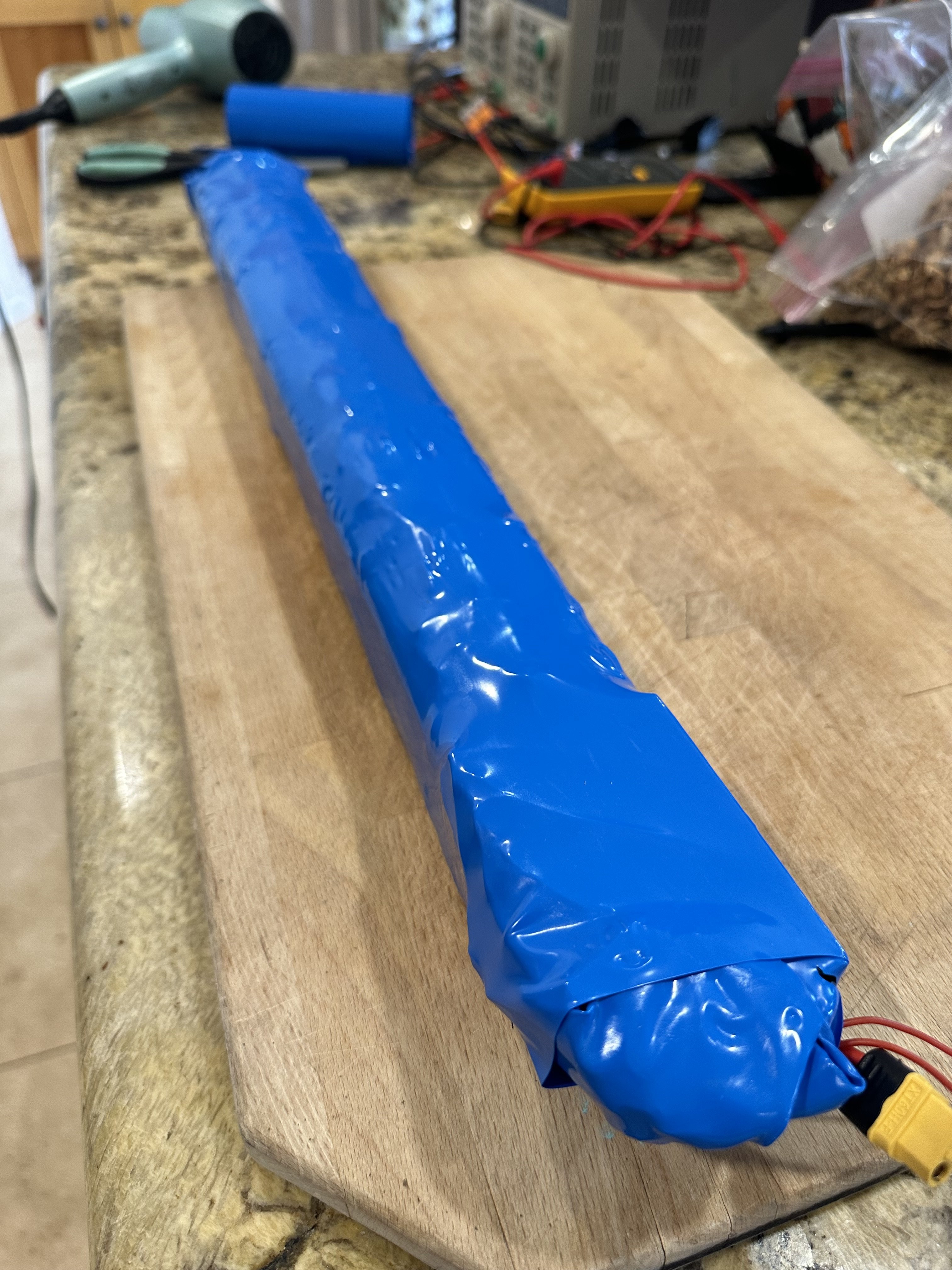

burn in thread inserts and print all the fdm structures needed. fixture in a straight line and e60 in place. i test fit the assembly and decided to overhang the cells above the top mount towards the steer tube for bottom clearance.
final assembly

thanks for the kind feedback, I did my first decent ride today, left the house at 81% battery and came home at 32%. 22 miles and 1200 feet of climbing, mostly in B and S+ modes.
