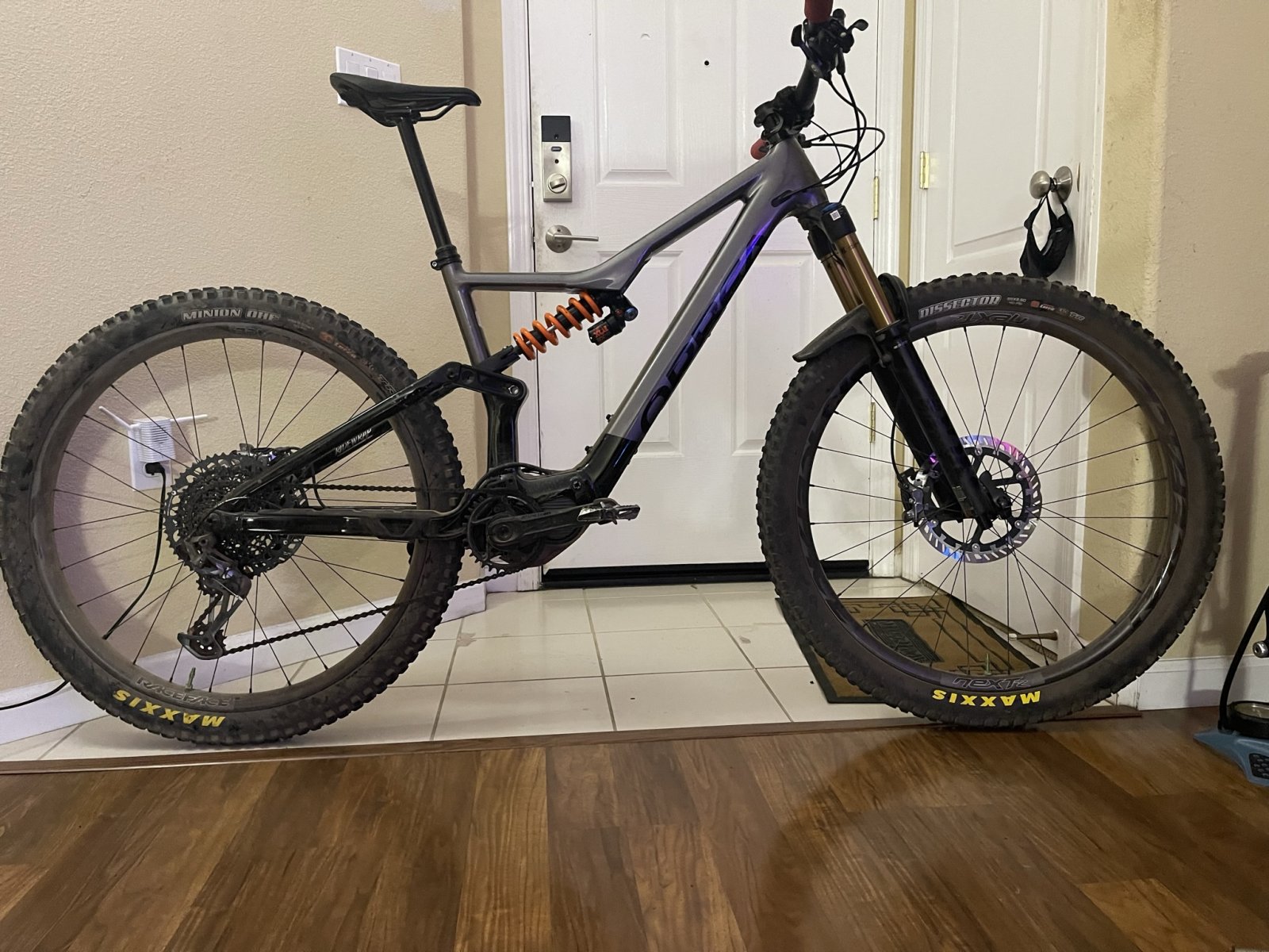

My XL m20 is now fully upgraded: Fox 36 factory, float X, wheelset, 29x2.5 tires, GX Eagle w/SLX Cassette, code rsc brakes, cushcore etc etc. and it weighs 45 lbs without the range extender (photo was taken before the float X went on, it weighs 45 with the float x)
