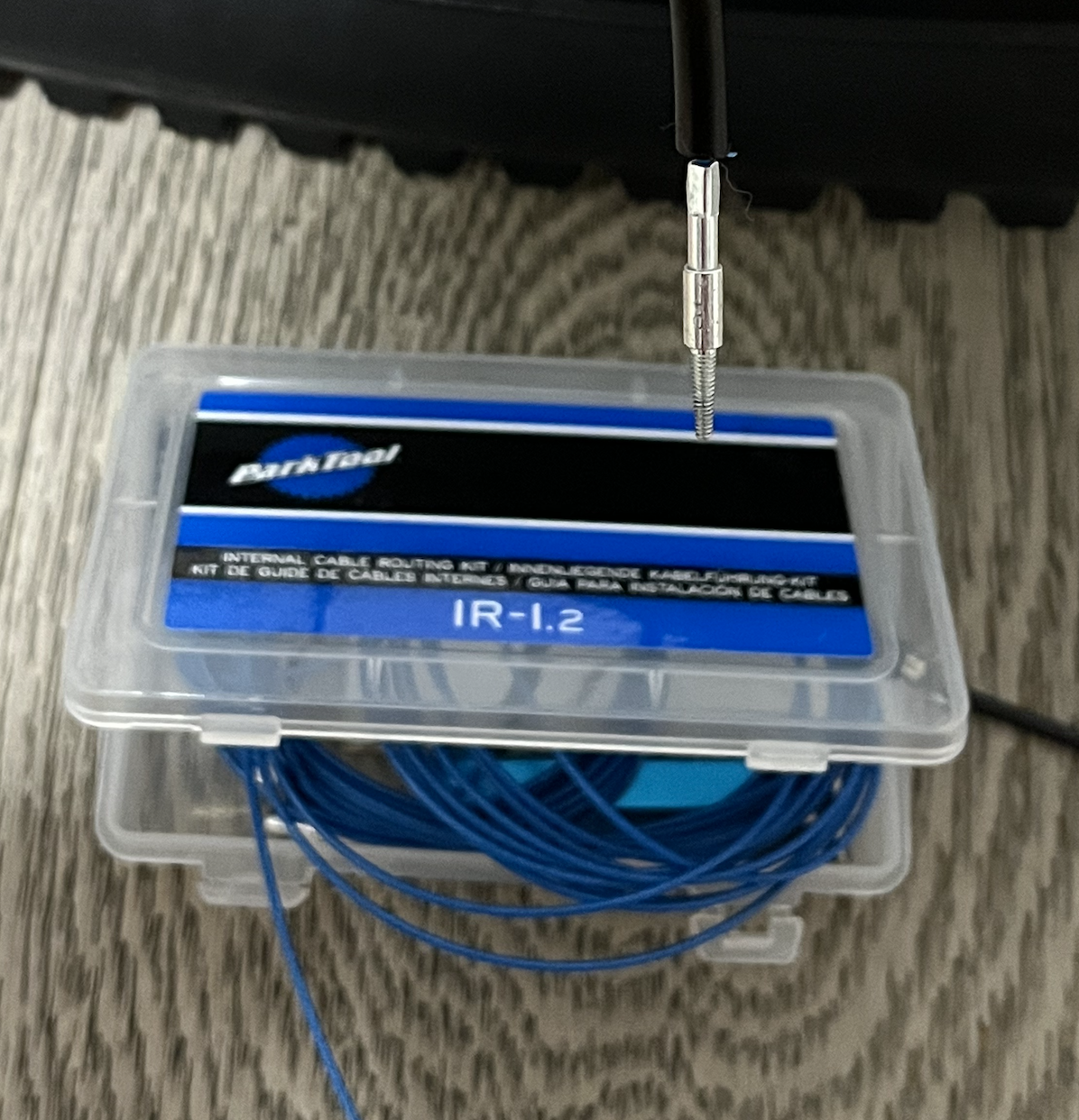

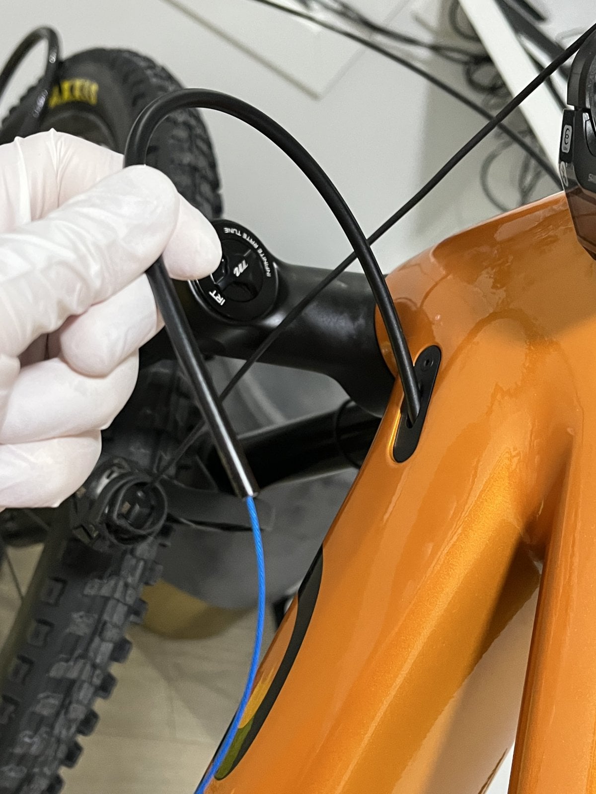

Brakes: Magura MT30 with 203 F/R < This one wasn't fun. Not sure how much assembly is required from say a LBS to do this, but I am sure the motor will have to be drop. I didn't drop the motor, but came up with this idea where I used the existing hose as a "tube in tube". Ran a modified Park Tool routing wire into the existing hose then connect the other side to Magura line.

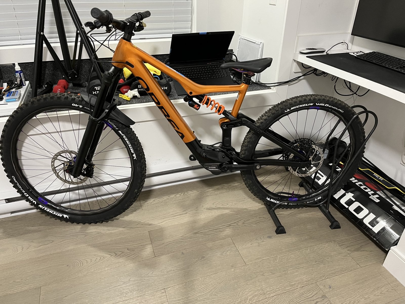

Boom - all built up

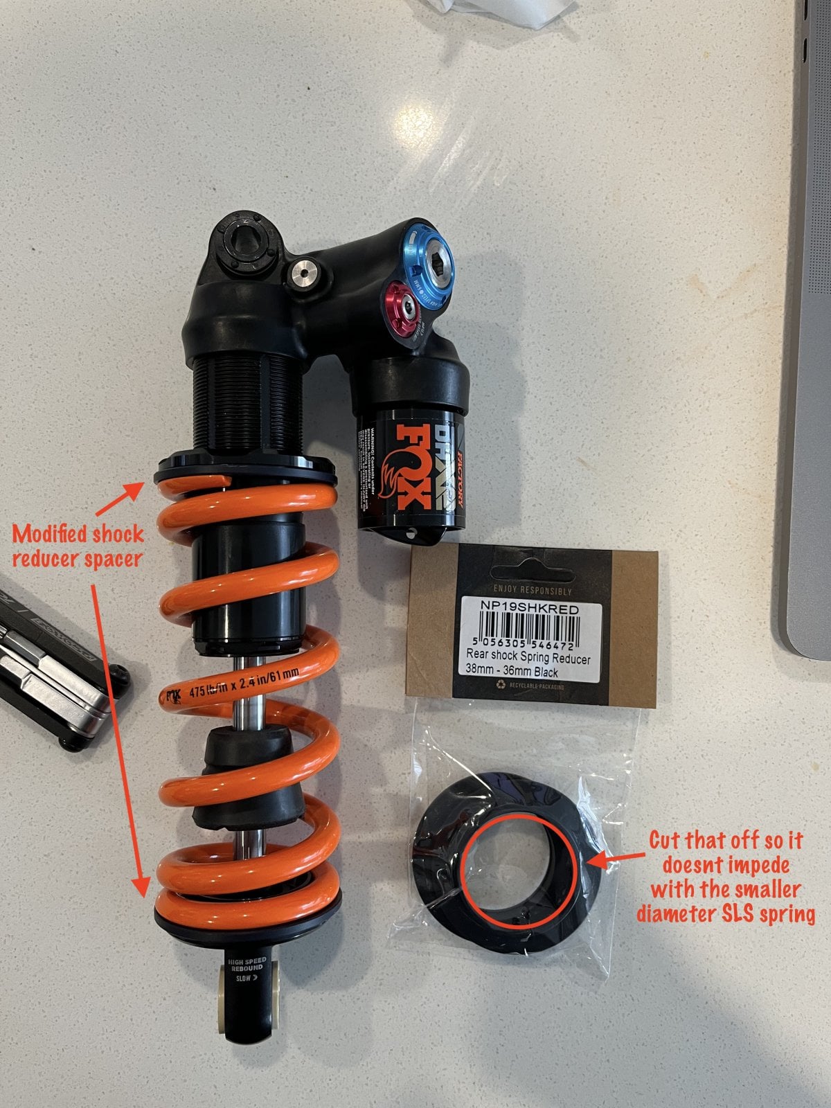

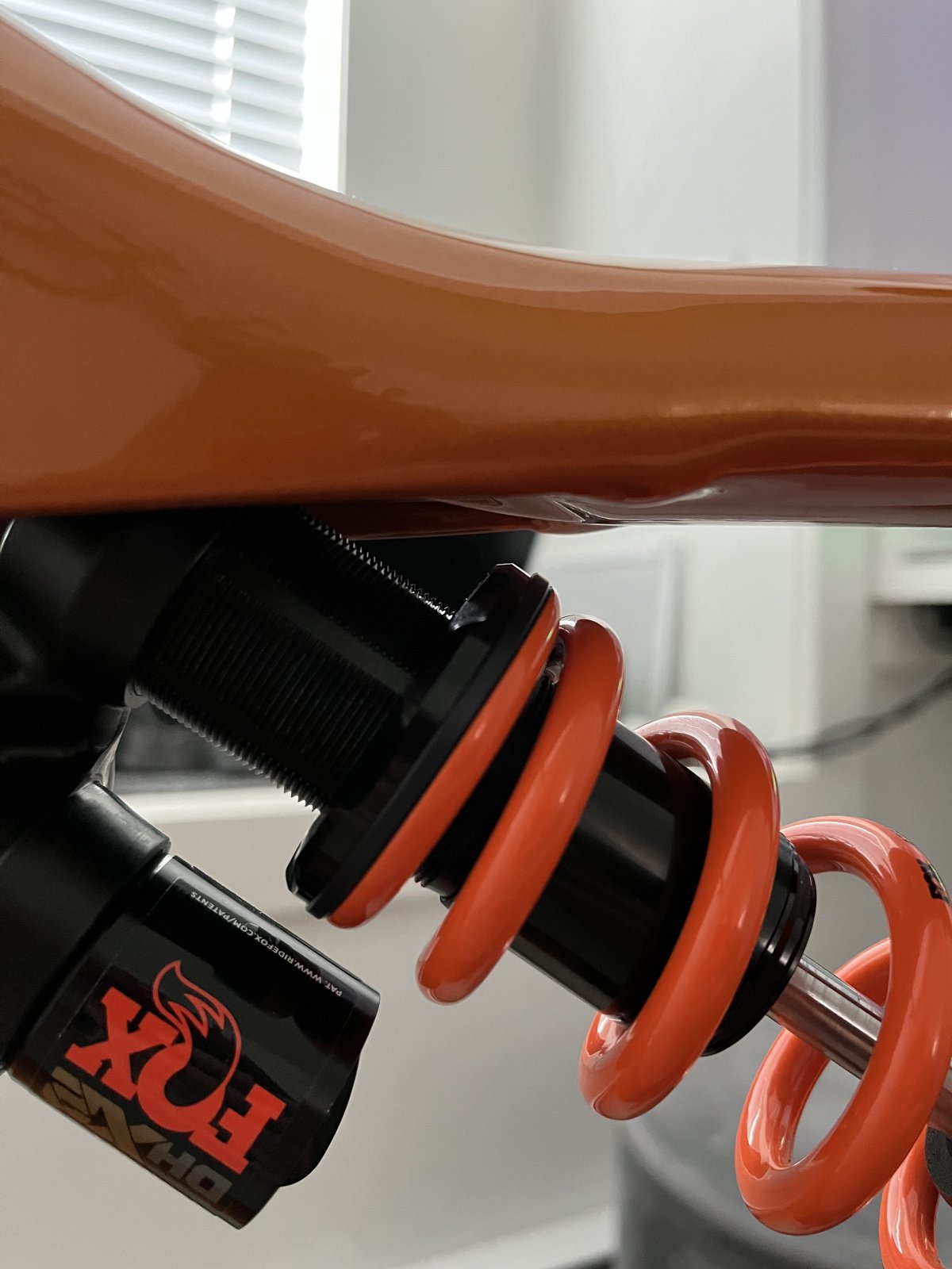

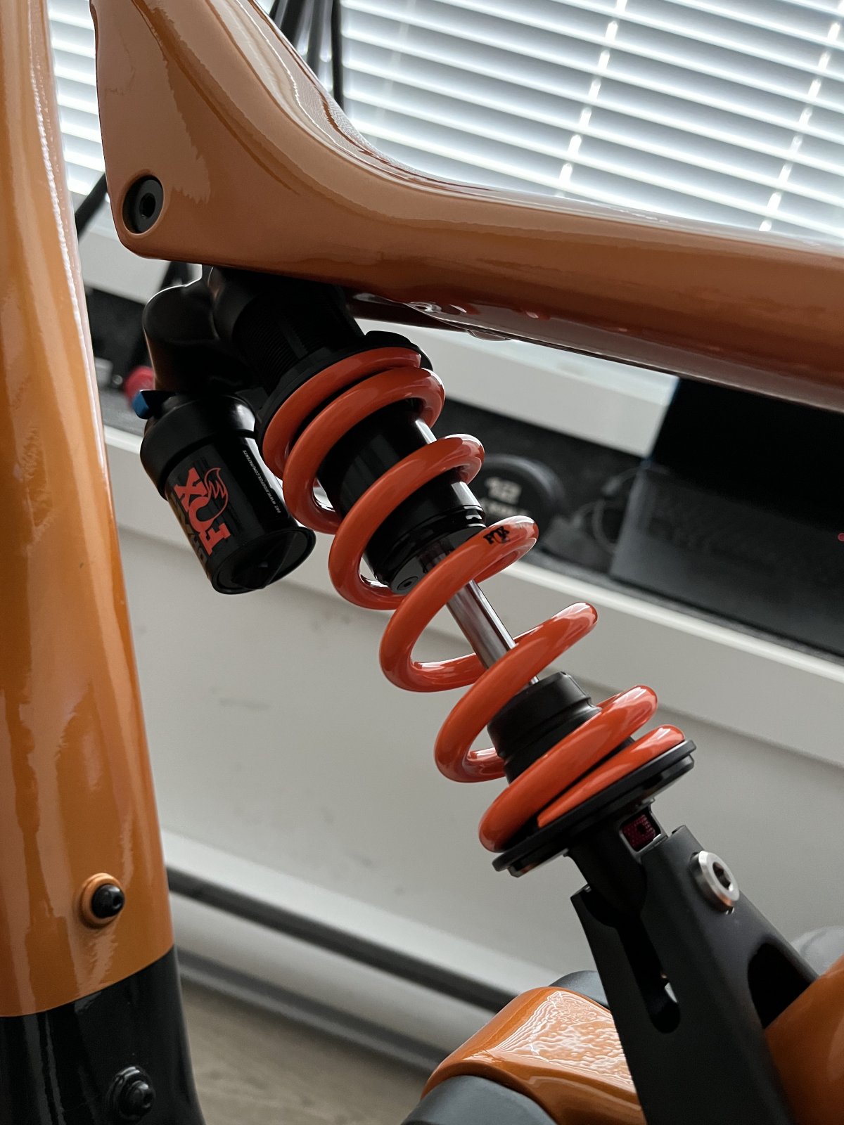

For anyone planning to upgrade to a DHX2 with the 216x63 (8.2x2.5) long stroke shock. You can actually get away with running a 61mm /2.4" SLS spring - the 61mm spring has enough space to compress beyond 63mm as it accounts for preload on 230x60mm shocks. Not only is this a lighter option, it provides better frame clearance. Should work with Medium frames much better - not sure about small. There is a caveat:
1) minimal preload on spring
2) shock reducer spacers about 2-4mm > i bought nukeproof and just cut the flange off for bigger diameter shock leaving me with a washer looking reducer. I put 1 on each end - each plate is about 2mm. This is required as there's not enough thread to keep the spring sitting tight. My setup contains another 2mm of thread for preload.

Current setup is 46lbs / 20.8kg but nothing is stock now.
Nobl Tr35s on Hydra i9 with Berd Spokes
Cascade Link with 210x55 sprindex'd Bomber CR Coil
Same Fork
Dominions A4 with 223 / 203 Galfer Rotors
160mm Shimano Cranks
XT + AXS GX
OneUp 210mm v3
