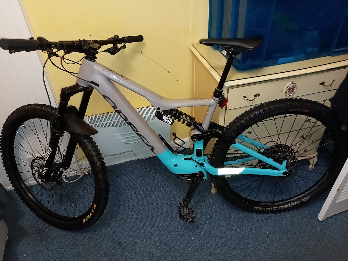

Hi all,
I got a new (Ex-Demo) Orbea Rise H30 2022 last week. It was held back stock in a friend of mines shop Rothar Ireland
It came with some previously installed upgrades:
Rockshox Yari 180mm, Rockshox Super Deluxe Coil (450) and some nice pedals.
All paid for by our countries Bike to Work Scheme. Nice.
Here are my planned upgrades, saving now, might take a few months. But although not essentially necessary I really want to get these parts. So far, loving this bike.
Schwalbe Magic Mary Evo Super Gravity 29x2.40" Addix Soft E-50 Folding Tyre: €36.17
Spank Spoon Shotpeen 785 Riser Handlebar, 40mm Rise: €40.30
Magura MT7 Pro HC Disc Brake Set + MDR-P: €358.65
SDG Bel-Air 3.0 MAX Lux Alloy Saddle (Turquoise): €76.48
DT Swiss XM 1700 Spline® 30 CL Boost 29" Shimano Micro Spline wheelset: €516.80
Bash Guard, and maybe a Shimano XT Linkglide drivetrain overhaul.
Ultimately I'd also like Hope Pro 5 hubs F/R,
And a Three Rock Components Headset in Silver.
Gen 1 Battery Expander.
PNW dropper lever (also, what's the maximum dropper post that fits on this bike?)
What have other people upgraded their Orbea Rise H30 2022 with? Very interested to see ideas, comments etc.
Best Regards :)
Dara (Dublin, Ireland)
