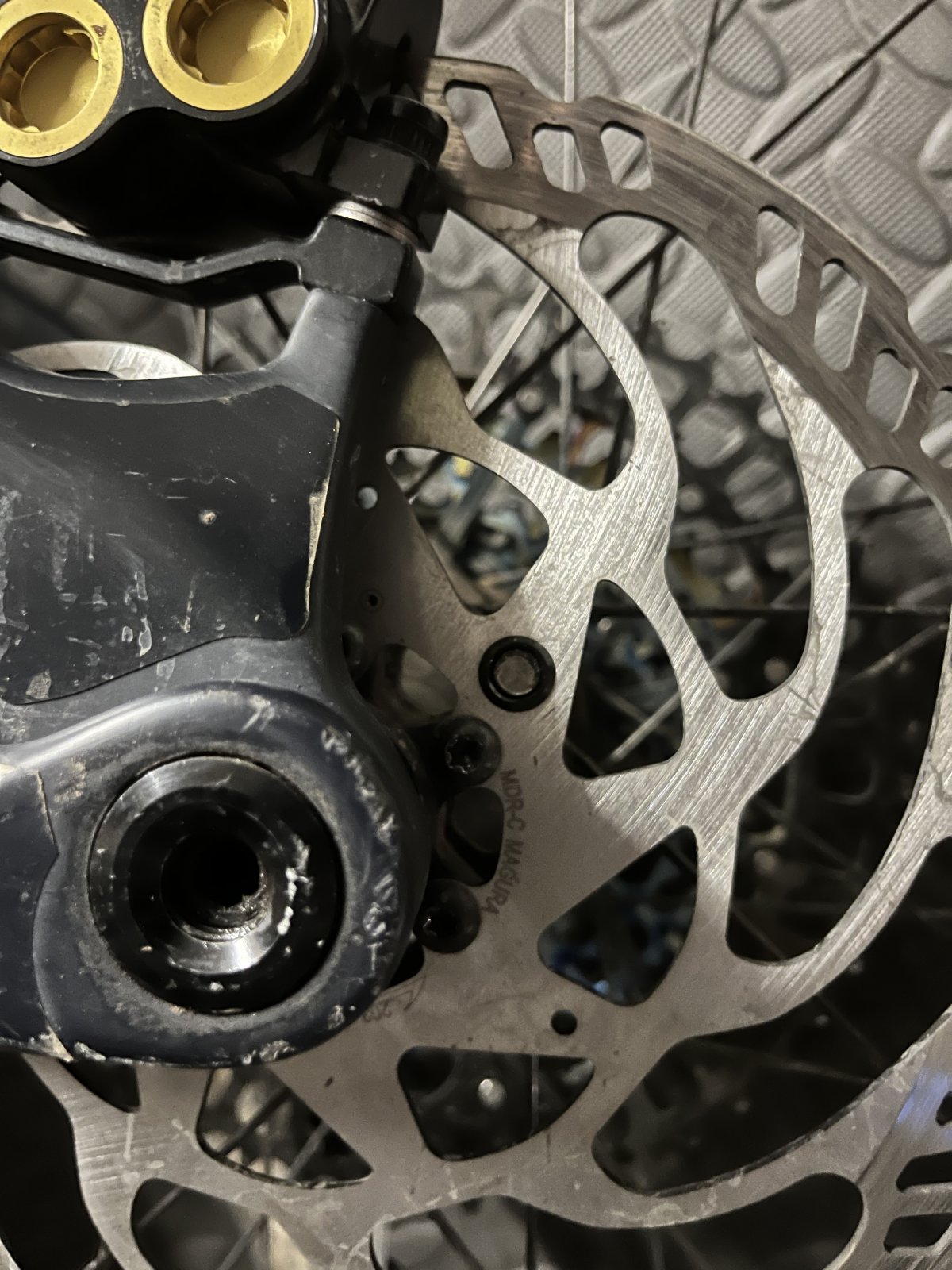

I replaced cable to fit my MT5s & dropped motor, as I am running different wheels on my M20 I have 6 bolt rotors 220 front 200 rear MDR-Ps
Shjay
Apr 30, 2019
835
491
Kent
This is an MDR-C rear 6 bolt rotor with the Magura magnet fitted in the hole works perfectly on the Rise, I have spare magnets & rotors
