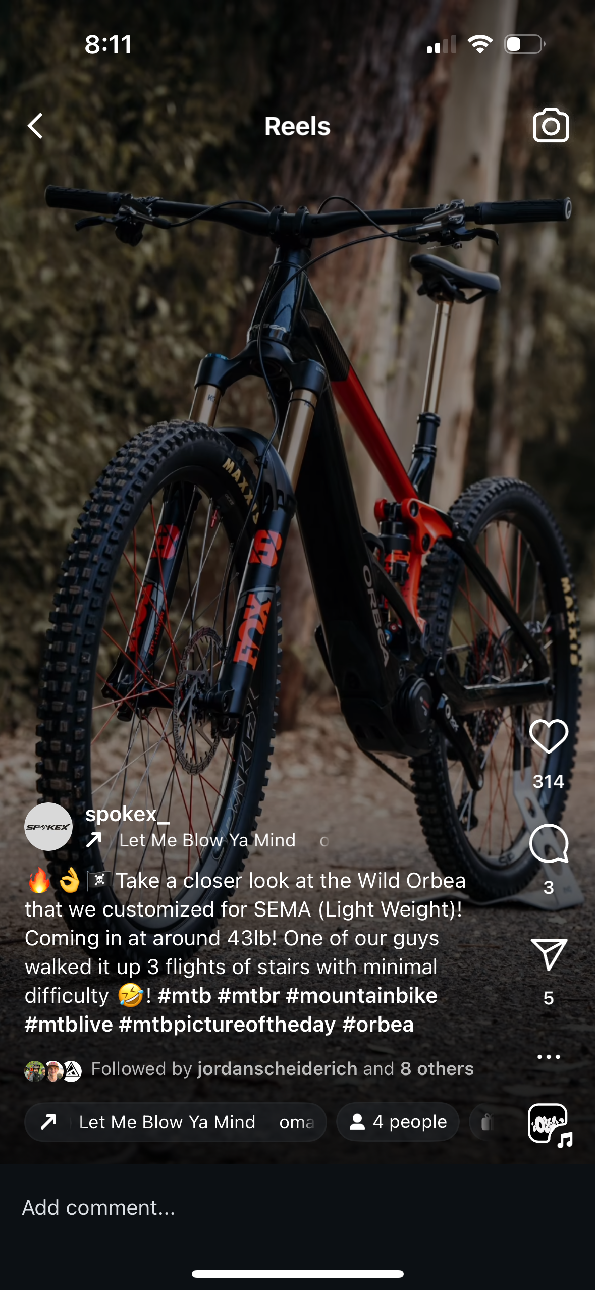

Not sure where to post this but assume this is a 2025 Wild. They’re claiming 43 lbs. I call bullshit. Anyone think this is possible?

Orbea is so annoying with not posting weights (even 'as configured' weights would be helpful). I think there is a zero percent chance that a 2025 Wild is 43 lbs.

They’ve probably done what they did with the Rise when it first came out and weighed it with the lightest possible tyres, no sealant, smallest size frame etc. It’s disingenuous but seems pretty standard.

someone on that spokex_ instagram asked how they got it down that light and their answer was 'nothing its a lightweight model'.... very sus...
(honestly if orbea has even a 20-21kg equipped wild I'd be pretty interested but thats into Rise SL/LT territory so very sus...)

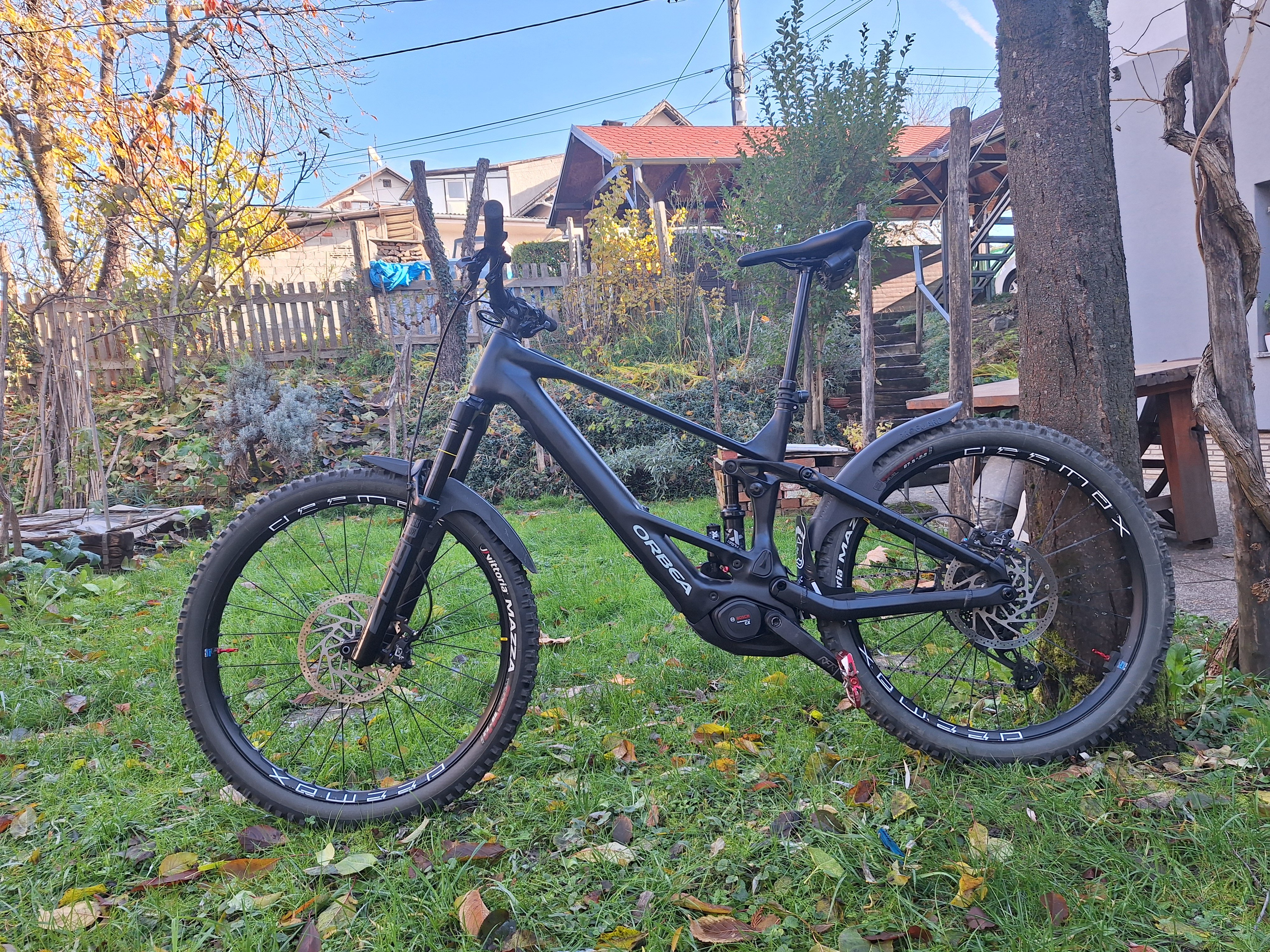

Hello everyone. I'm Tomislav from Zagreb-Croatia.
I received my Orbea Wild st h30 2025 on Friday. I installed some of my own parts (zeb170, float x shock, hayes dominion, mavic e deemax mullet wheels and mullet link. The bike is like a full orbea wild.
What size shock did you install? The ST has a 205x57.5, if you install a 205x65 the bike will have a 170mm rear travel like the standard one, at least that's what I believe from looking at the one we have at our shop.
There's no chance you could get to 43lbs. An M10 with the 600wh battery will weight in at 49-50lbs depending on the comments. I've weighed a 2025 M10 with the 750wh battery with pedals and it's exactly 53lbs on our scale.
hello. I put a 205x65 shock and a 170mm fork. so is like full wild . weight with 600wh pedals and everything as in the picture is about 53 lbs. H30 st model
Totally possible with careful parts choices, but will be expensive! I do agree to call BS on that build though, and the 38s and rear X2 are WAY heavier than competitive alternatives like a Mezzer Pro and a much lighter piggyback shock.
I'm intending to buy a 2025 Wild M10, and rotate either a 57.5 light weight shock and a 65 bruiser, changing the fork travel on my Mezzer Pro between 150-160mm. My calls (based on real world weights) estimate 44lb quite easily achievable, and could go sub-42, but with prioritising weight saving and more flimsy weak components which will hold the natural bike back.
