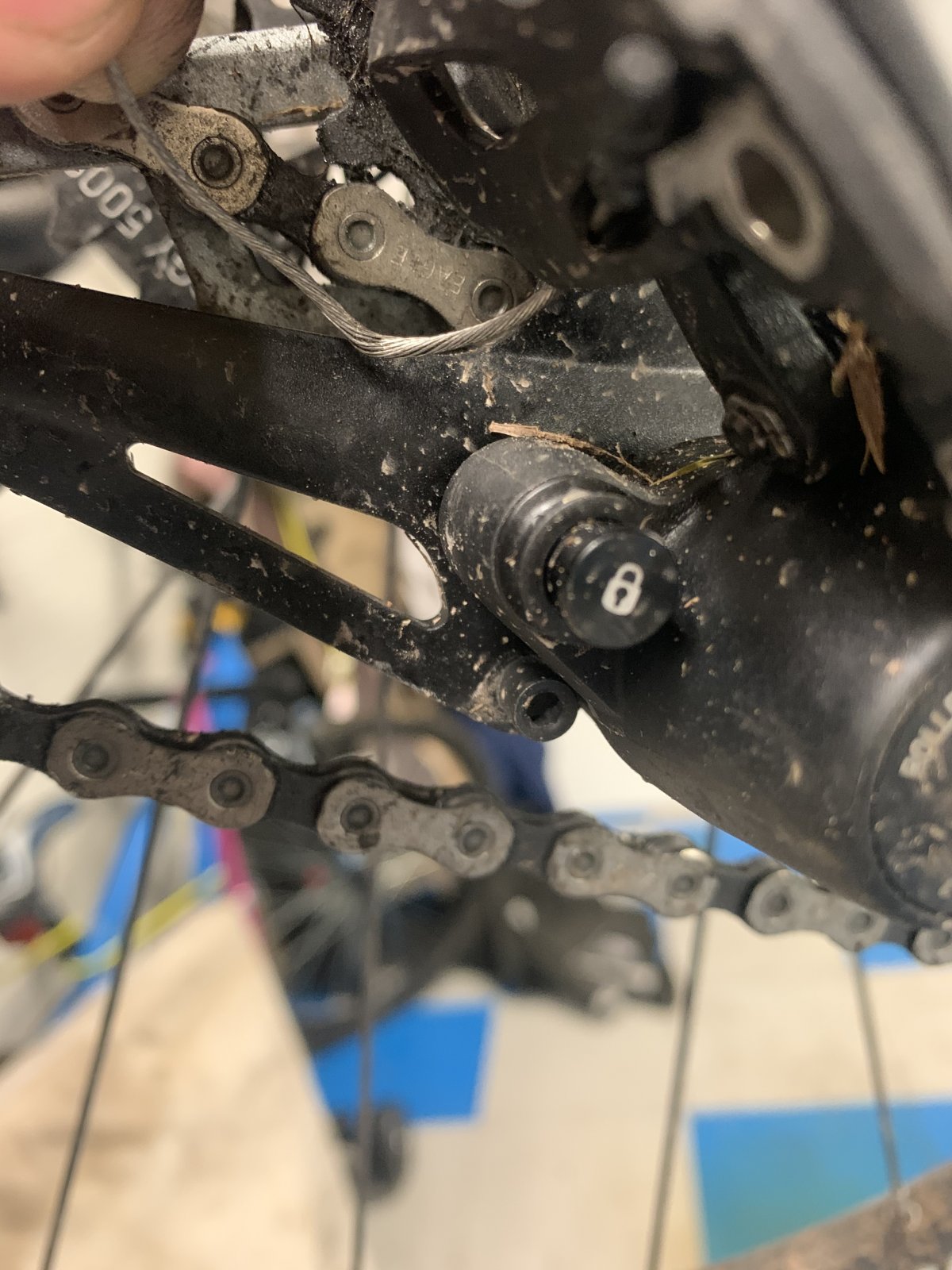

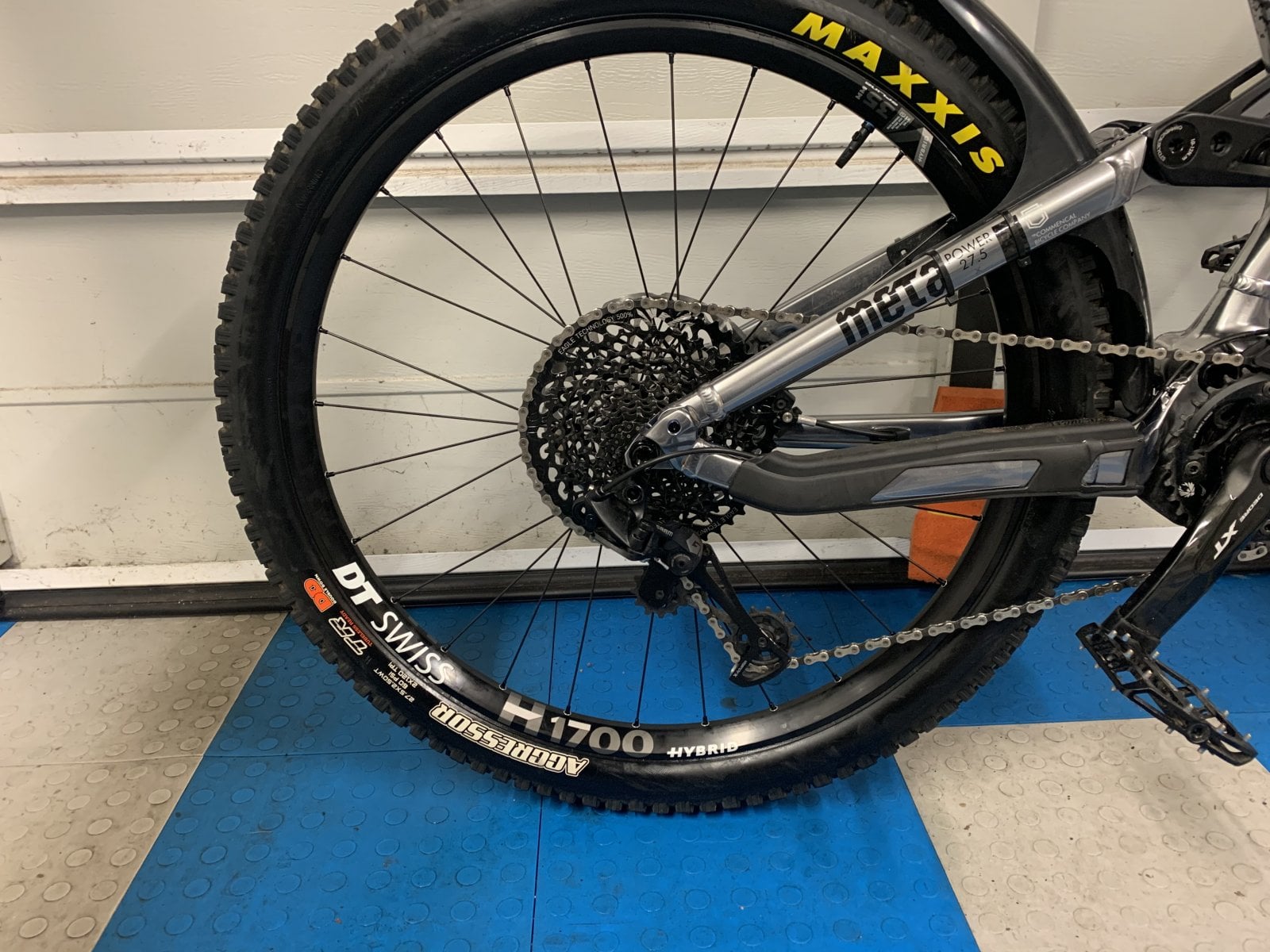

Thought so that kink in the cable was around the pulley wheel , I must admit I can see how easily it is done as when fitting new cable the gx is very snaggy until it’s all through compared to my last bikes xo1 where you can remove the pulley wheel. View attachment 22863

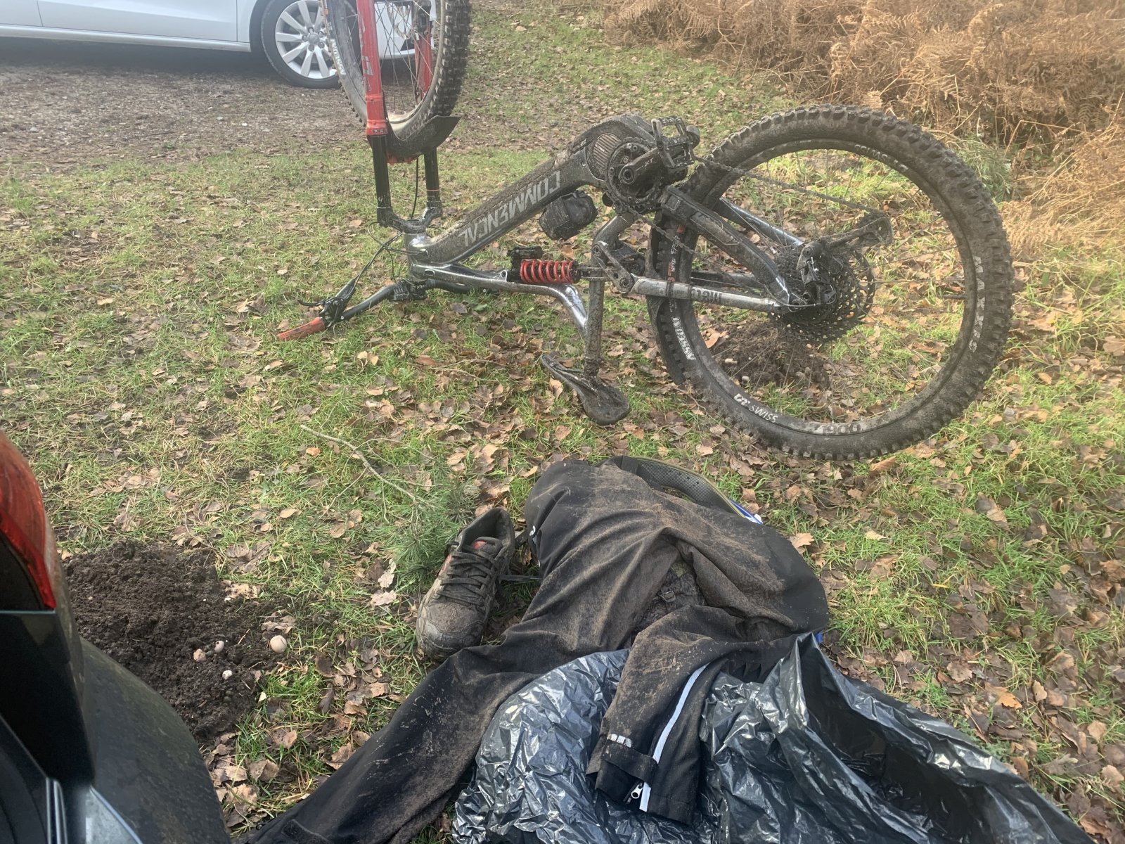

been out again today and although it was another slop fest the gears just started playing up at the end,going to look at the gx pulley although you can’t remove it I remember when fitting the new cable it didn’t feel that free,had a blast as I met some emtb riders and tagged along,starting to get me and the bike dialled in now? probably going to swap out the rear maxx grip tyre as it’s so draggy when rolling downhil,I had to keep on the pedals to stay with peeps.
Glad that I have the X01 on the 29’er. On my analogue Meta I fitted a Bike Yoke Shifty instead of the stock pulley on the X01, it worked wonders as it has a ball bearing. The option to be able to clean the pulley is so much better than on the GX derailleur.
Hope you get it sorted, it should be able to spin freely when the cabl is detached.

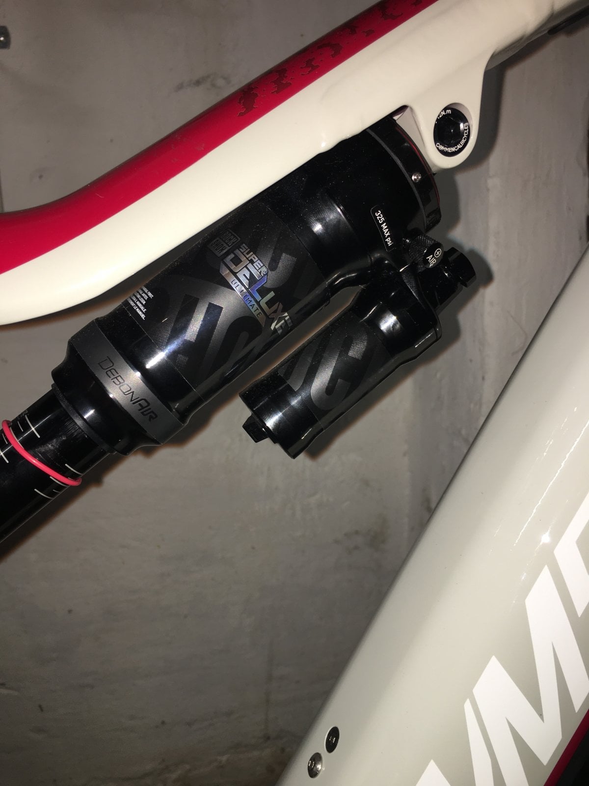

And, can anyone tell me how much clearance there is for the rear-shock? I mean between the shock and the upper part of the frame. Is there room enough to fit a Rockshox MegNeg? (is that even possible on a ultimate shock?)

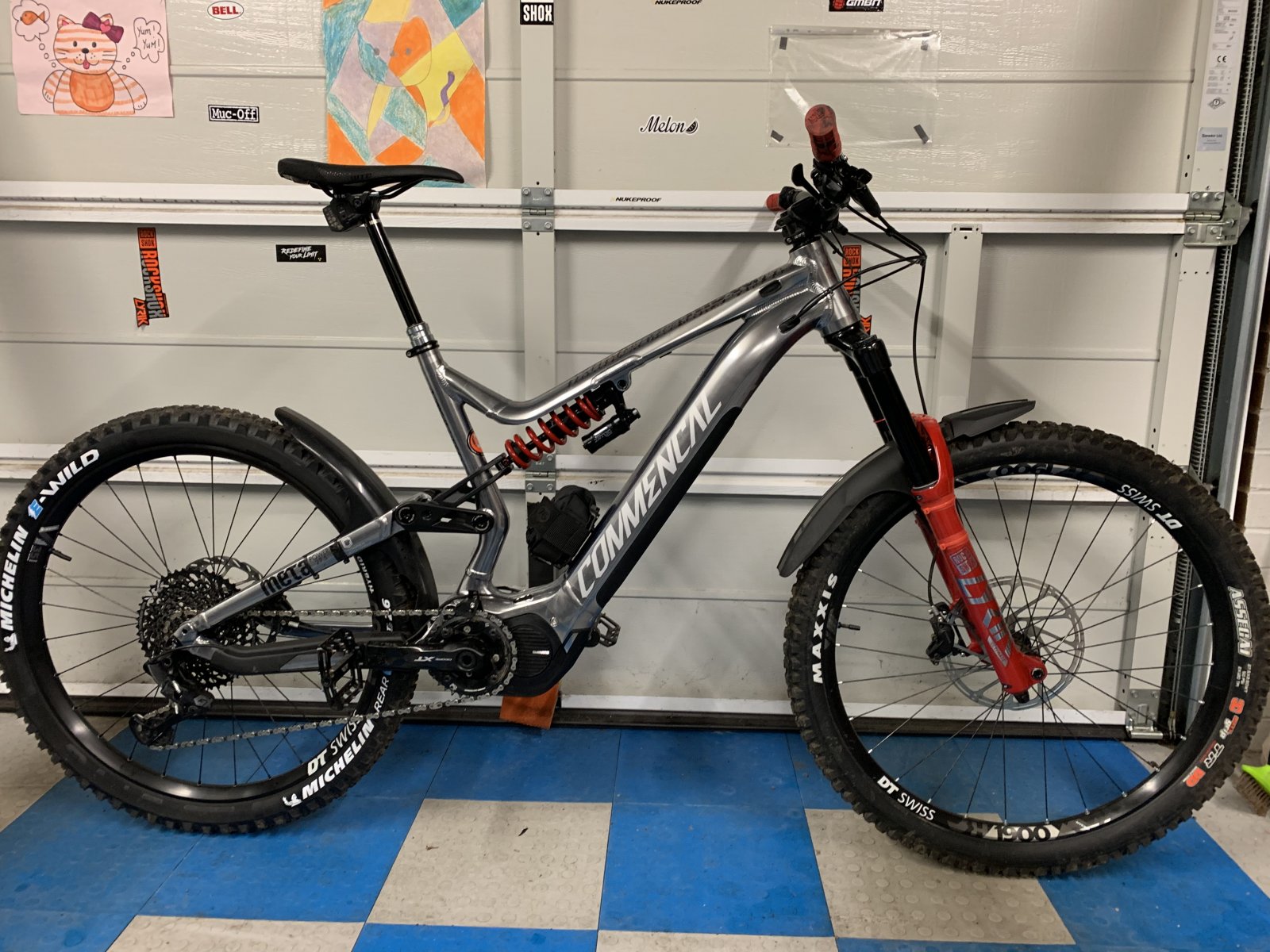

I have yet to receive my bike but I'm temping to see if the black battery cover could wrapped to red? I think it's a "RockShox Boxxer" red..
I’ve had the same idea but postponed it since normal vinyl doesn’t stick properly to it as it has a rubber like surface :(
I was told that you’d need some super sticky vinyl to make it stick, so I’ll have to see if I can find it locally.
There should be enough clearance for a MegNeg aircan in the frame. Standing without load I can pass a finger around the aircan and the frame, which is around 1,5 cm. Please note that the top tube above the shock is hollow. @renedis - this is how the stock shock looks like close up

There should be enough clearance for a MegNeg aircan in the frame. Standing without load I can pass a finger around the aircan and the frame, which is around 1,5 cm. Please note that the top tube above the shock is hollow. @renedis - this is how the stock shock looks like close up View attachment 23034
best to take the air out and measure the clearance.

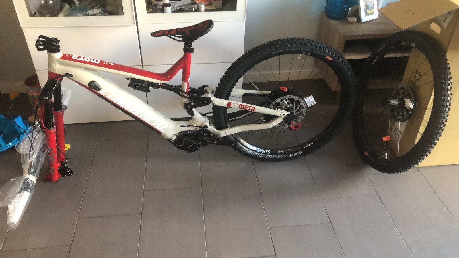

New bike day!
Charging the bike now and waiting for that to build the bike up for a ride.

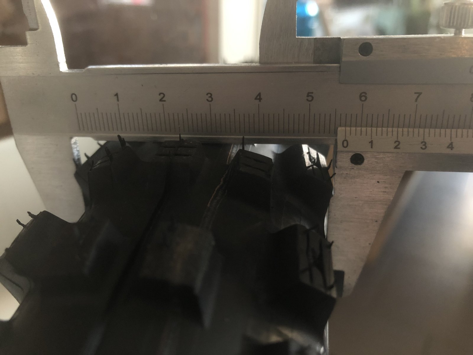

I've measured the MagicMary 2.35's... 57/58 mm. They look and feel very small and I'll swap them for some Michelins. I will be saving the MM for another time.

fitted my old 2.5dd aggressor to the bargain 35mm h1700,bleed the brakes and hit the trails again today,for saying the aggressor isn’t meant to be much of winter tyre it handled the slop fine,the braking traction isn’t so good but the bike rolled so much faster,I came back with an extra bar left on the battery too?

That's good to know, i'm going to swap the wheelset over this weekend and see what difference it makes. It's also a H1700 wheelset and I have to say the hub does sound much nicer! Going to order up some new discs as well I think. Tempted to give the new Magura 220mm discs a go on the front.

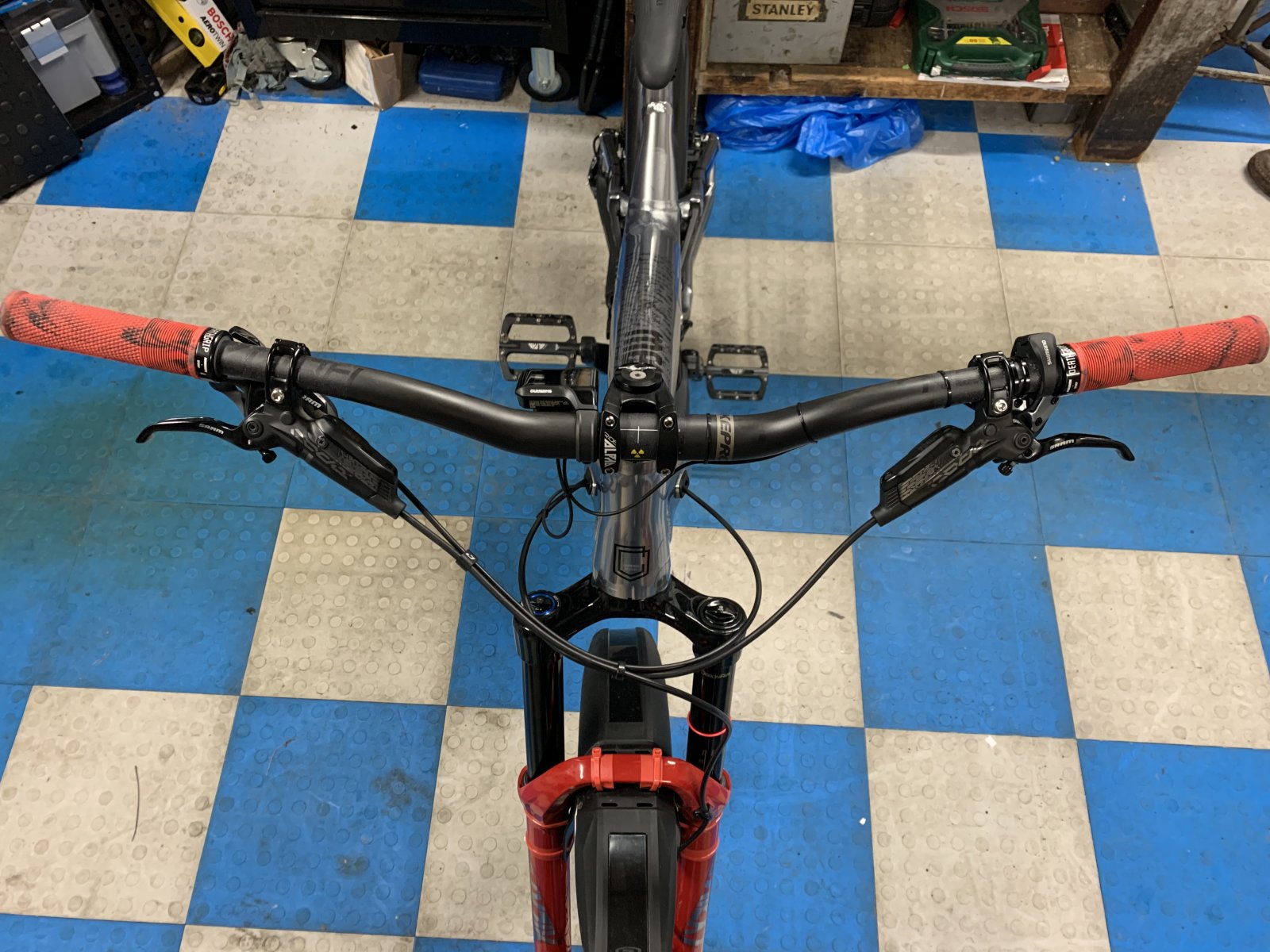

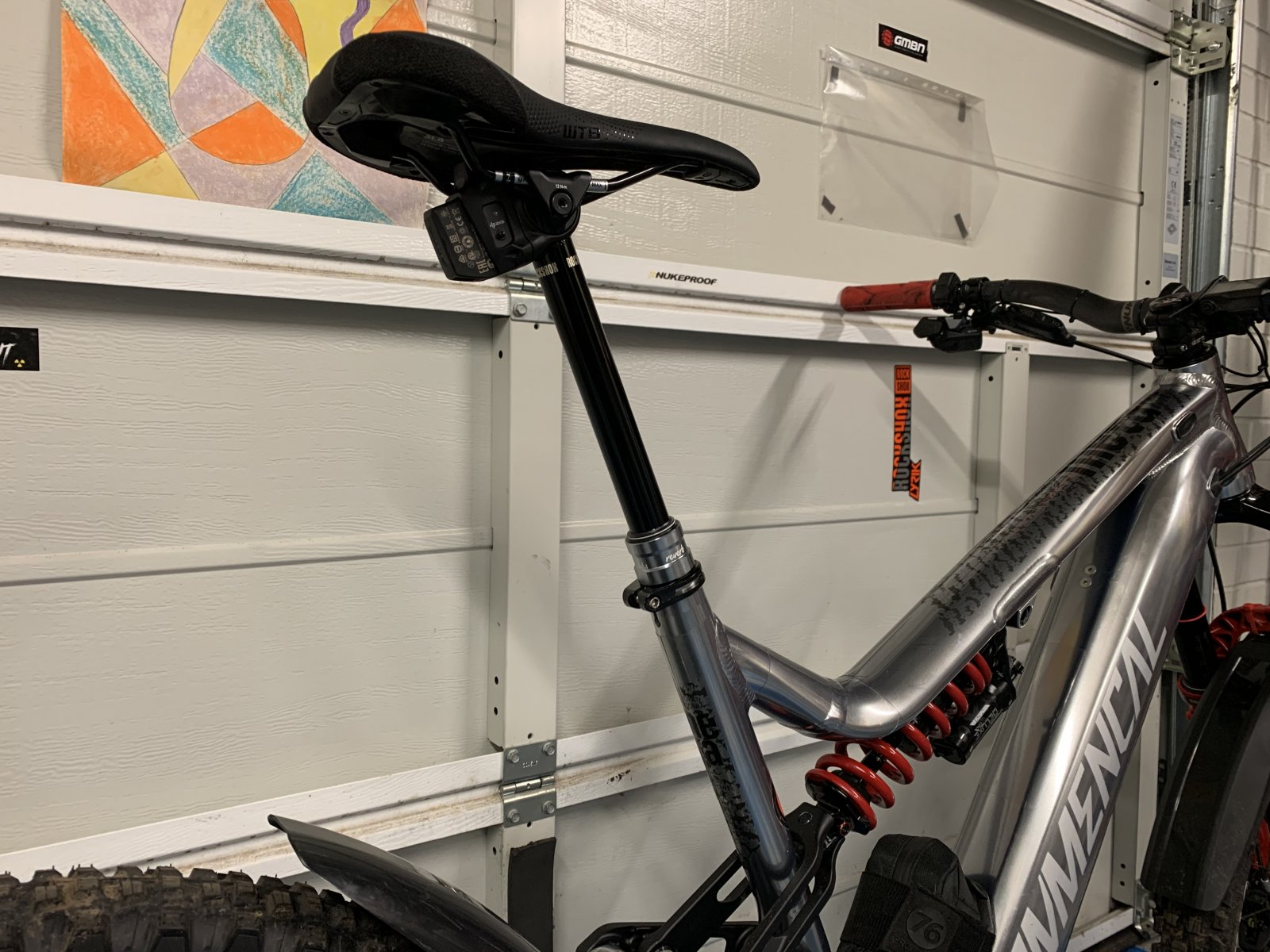

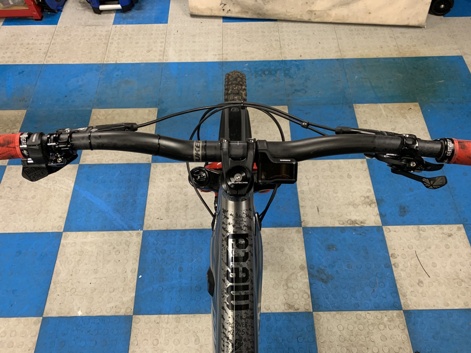

A bit more of a cockpit cleanup today as my new dropper came although I’m missing a matchmaker clamp as the kindshock one is not compatible so I used the supplied stealth clamp,super happy with the dropper but it was close regards to stand over height,it’s 170mm but with it all the way down im about where I was with 175mm kindshock one 15mm out of the frame!saying that though with my 5-10 impacts on I could comfortably lift up another 10mm still having optimum leg stretch and just tiptoe the floor,worth noting if anyone is thinking about a reverb axs?
