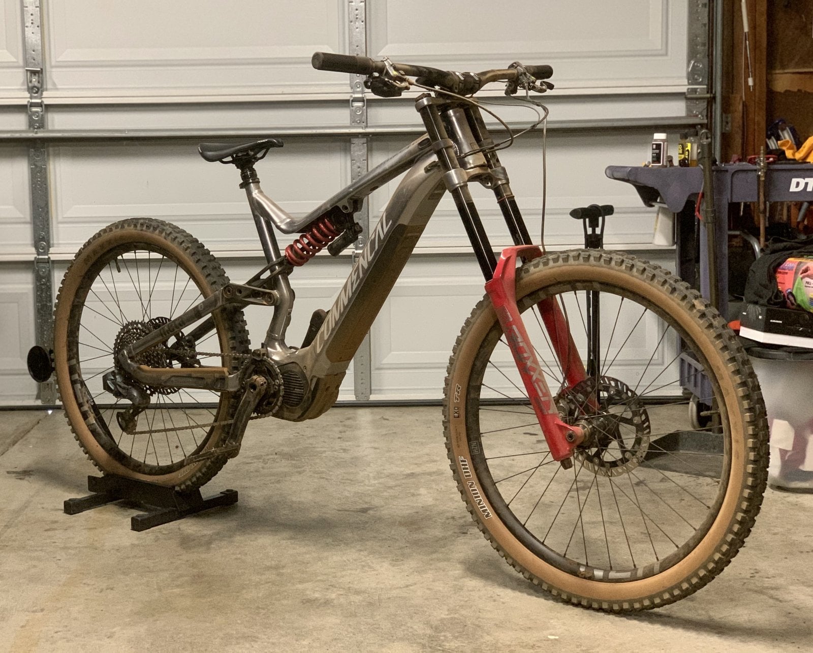

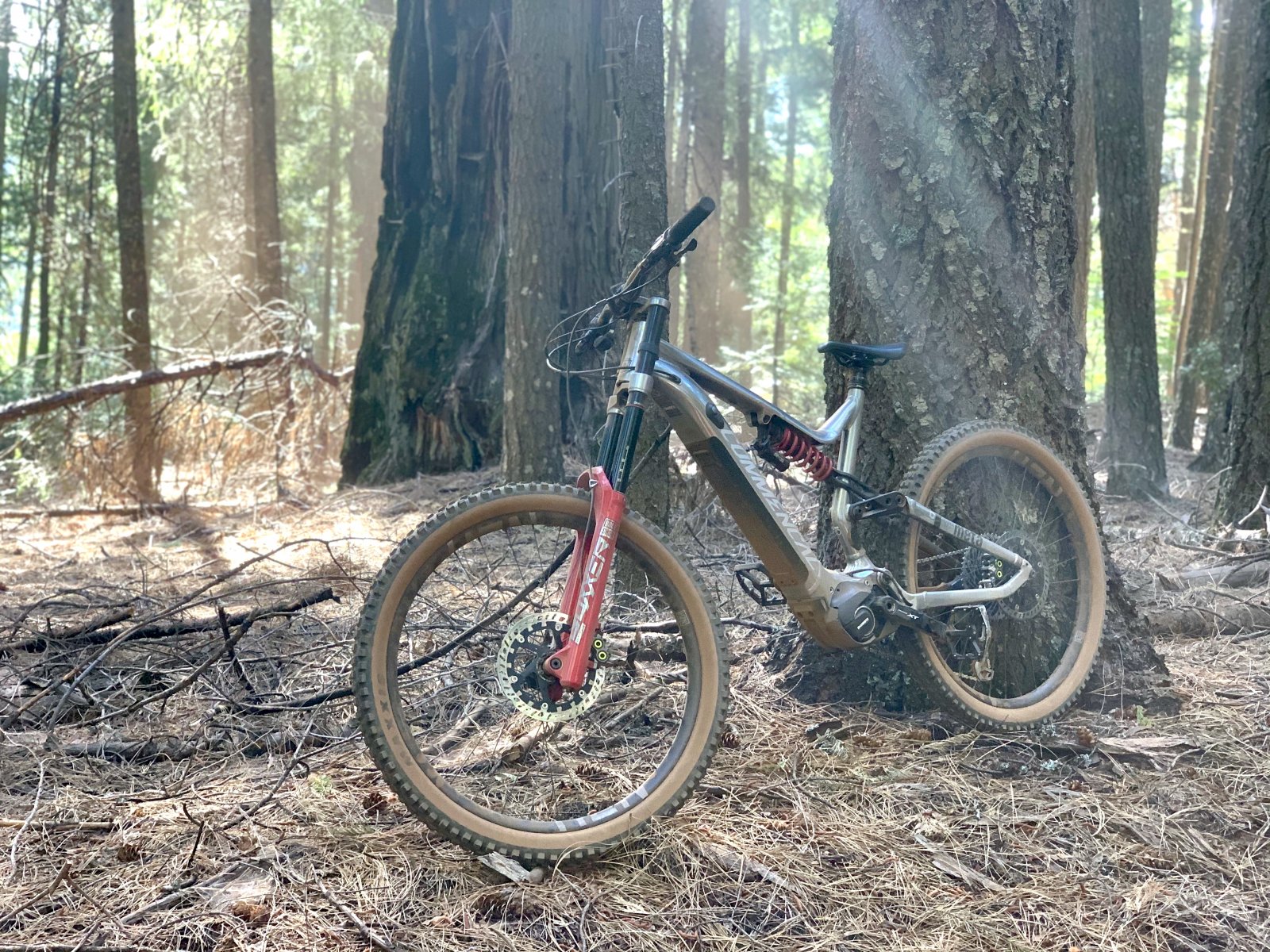

My 2020 Commencal Meta Power Sx with a Boxxer 200mm Fork DC, SRAM AXS, Nukeproof V2 HZN Wheels, Oneup Cockpit, Magura Mt7 brakes with floating MDP rotors.

Thanks fellas, the tires aren't the greatest. I prefer the Assagai's it came with but I do like the way the tan wall looks haha.

BEAST , Mono level : expert .
how is the geo though ? Extra 20 mm would lift the front , wondering how it feels on landing jumps .
Does it want to wander off line a bit .Does the front want to come up when pushing hard on up hill peddles ?
Looks like it belongs .

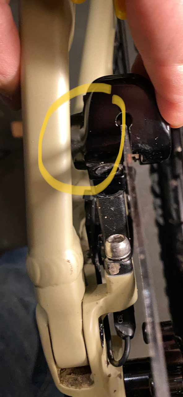

What rotor size are you riding at the back?
I wanted to install Magura brakes with 220mm rotors on my meta power 2021 and it does not fit.
See the picture below trying to install Magura brakes. The pistons interfere with the rear triangle.
I am wondering if 200mm would fit or if the 2021 model is different and Magura just won't fit.
Sergi
Jan 8, 2021
Vancouver, Canada
In case anyone wants to install Magura MT5 / MT7 brakes on a Commencal meta power sx 2021, the 220mm rotor does not fit at the back, but a 200mm will fit.
Sergi
Jan 8, 2021
Vancouver, Canada
I almost tried sanding it a little bit but I finally preffered not to damage the caliper and install a 203 rotor. I would have provably worked as it touched by so little
