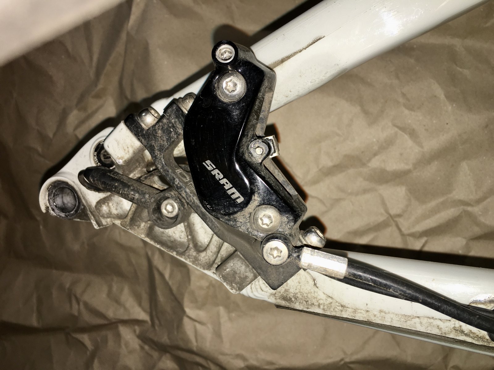

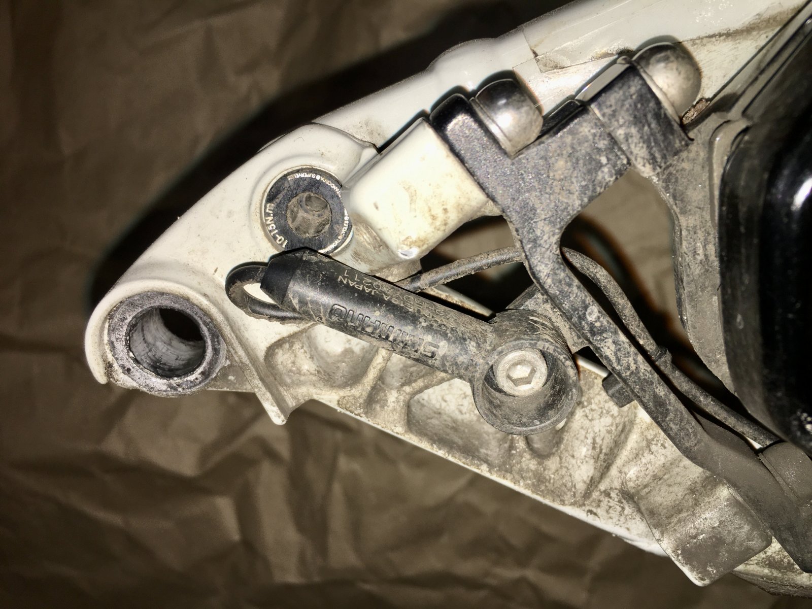

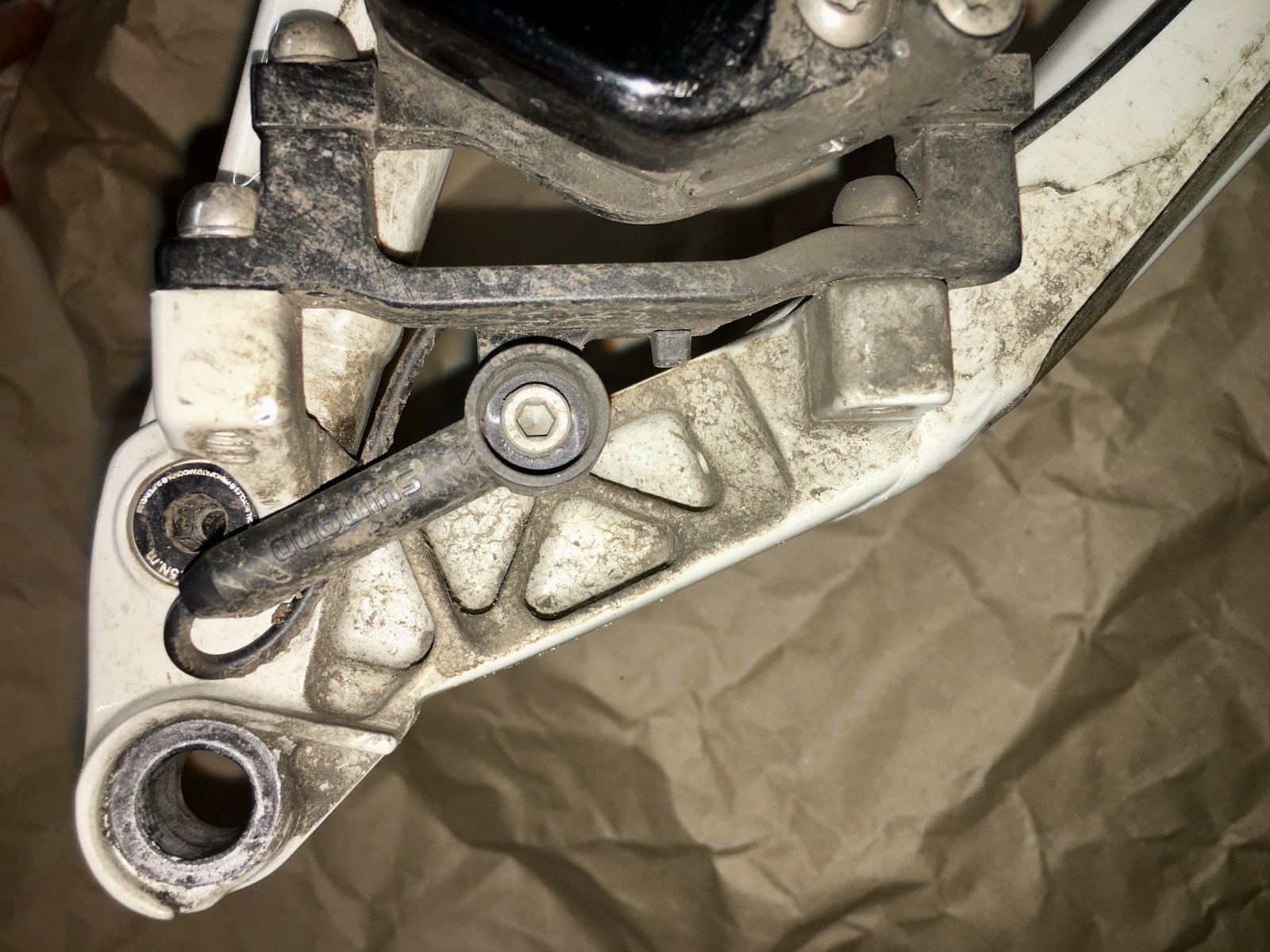

Can anyone with a 2020 SX take a couple of photos of how the magnet sensor is mounted under the rear brake? I've seen diagrams only, but I'm curious as to how it's actually mounted and how the wire is routed. If someone could attach a photo from the inside view (looking at the inside of the left chain stay with the rear wheel off) that would be great.
Well I don’t have the 2020 SX but the 2020 Team, and as far as I can see on Commencal Tech, they should be identical in that area.
