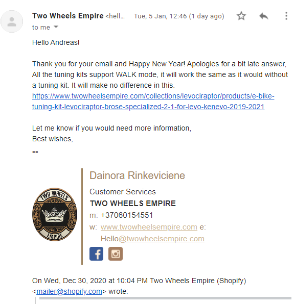

I wrote to a Levociraptor distributor over a week ago and now they have replied that:
"All the tuning kits support WALK mode, it will work the same as it would without a tuning kit. It will make no difference in this."
(I attached the screenshot about their answer)
I specifically asked them about Levociraptor that if it supports walking mode or not: "Do I have to run in walking mode after my bike or can I walk at 5 km/h next to it when the Levociraptor is installed?"
To this they responded back to me with this general answer :-D
Levociraptor has good product support :confused:
They respond slowly, but then they write nonsense :oops:
Then Can you confirm that it is as you wrote and not as the Two Wheels Empire answered me?
If I set Levociraptor to mode 3 (divider 1.5) then the speed of walking mode is 7.5 km/h instead of 5 km/h, in fact if I set it to mode 4 (divider 2) the speed of the walk mode will be already 10 km/h and can I run after my ebike? :unsure:
