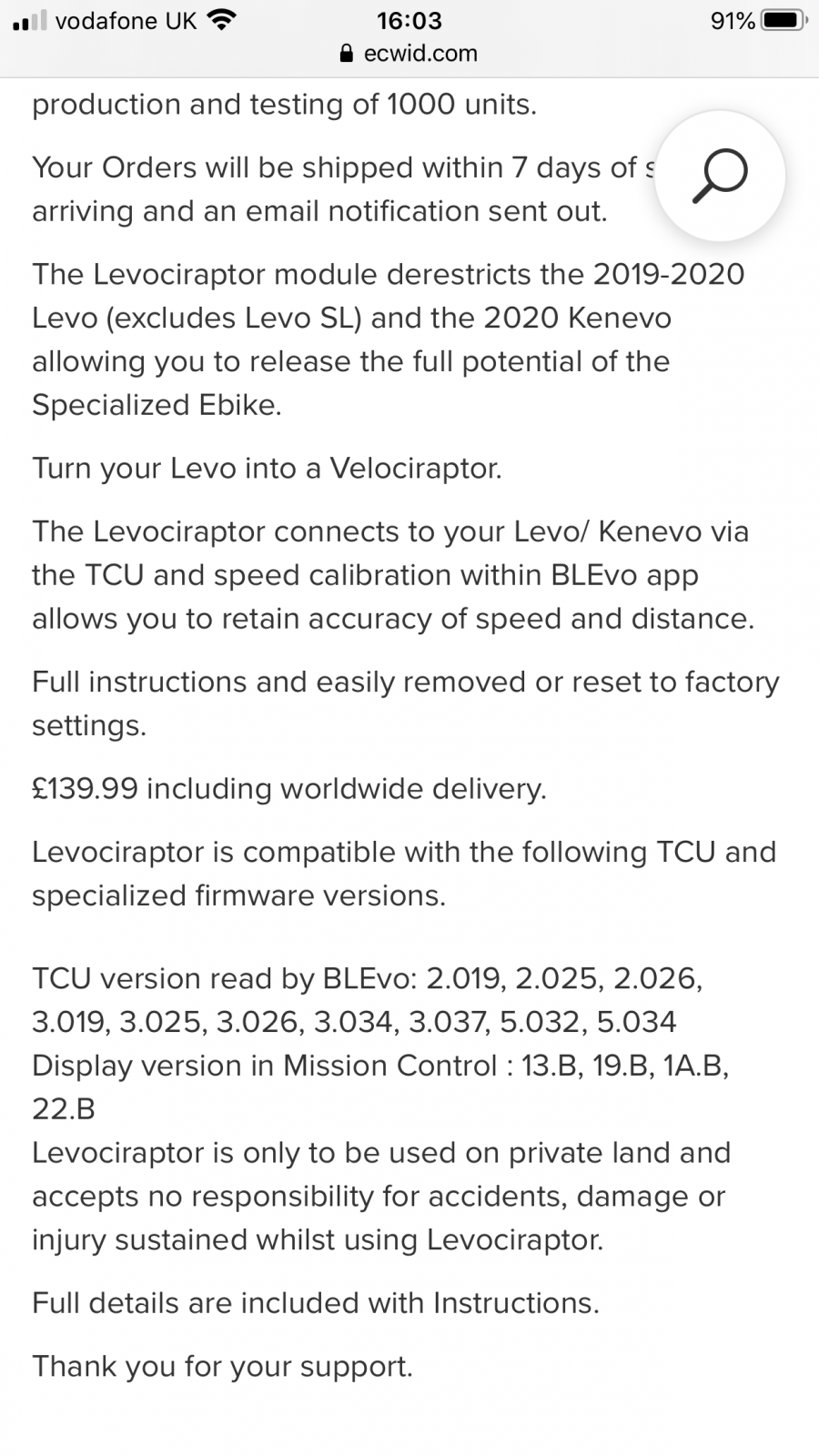

Hopefully @TrailwattsUK can help you out. I noticed that their website does NOT list 26.B.0 as a tested firmware, considering how long this firmware has been out I’d have thought they’d have made the effort to update their website if it has indeed been tested and confirmed to be working as advertised. I don’t own one YET as I’m waiting for my warranty to run out first but if the website doesn’t list my firmware (or can’t be bothered to update it) then I’ll be leaving it alone ?

@TrailwattsUK
22b is the last display version (MC) listed as compatible on the website, there are newer versions now, when will the website be updated with newer versions?
So far there has been no issue with all new versions. Newest firmware allows use up to setting 5 on Levociraptor unit.
Relying on customer feedback to update website. If you have a version that is not listed, please get in touch with your feedback. [email protected]
